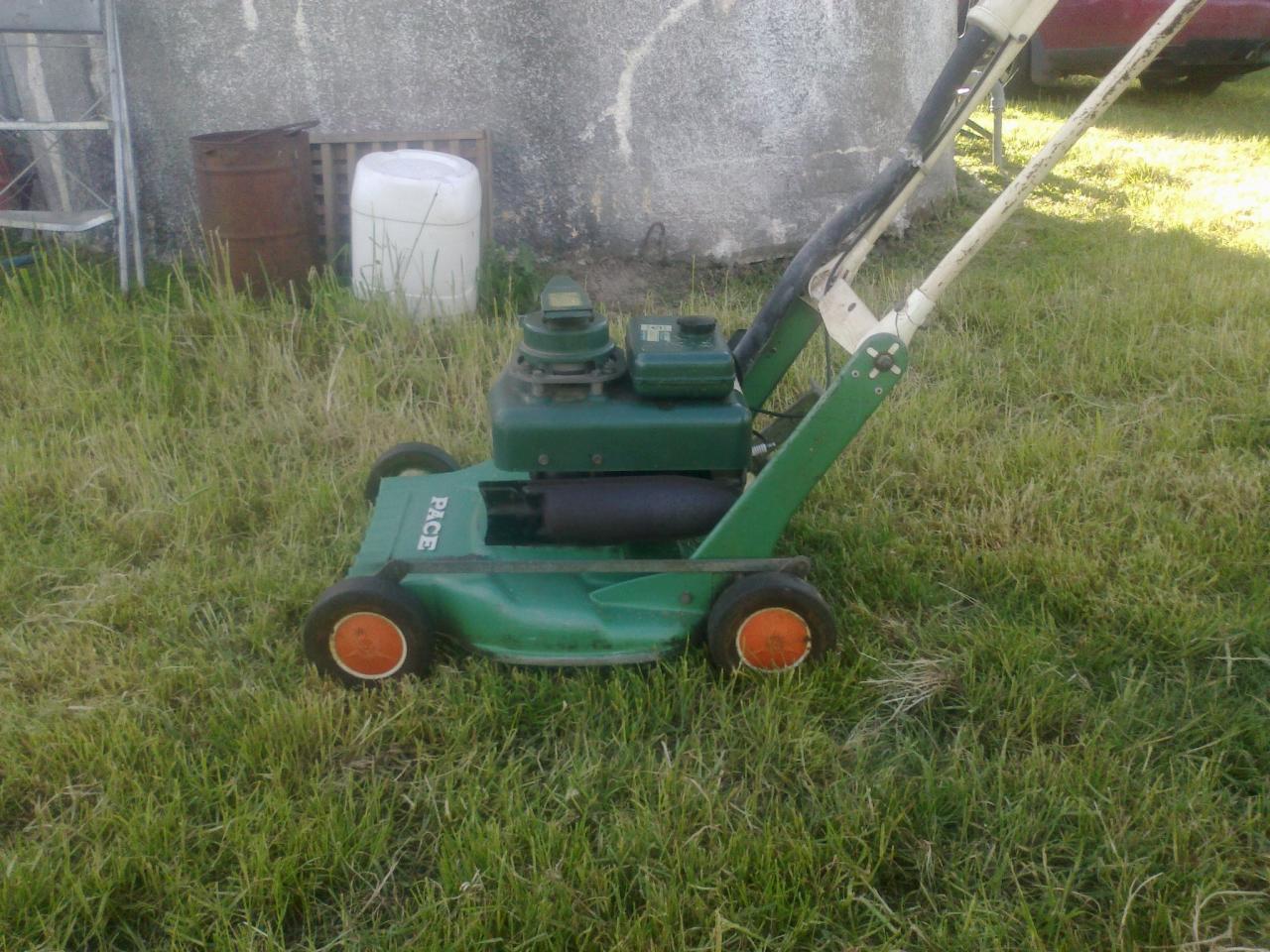

I have just bought a mid 1960s pace special 2 just trying to work out the correct age of this machine engine number is 5671276 paid $150 at a local mower shop and starts 1st go

hope these pices help can you still buy blades for this model or will i need to fit a disk from a later model (eg mid 70s utility)
Without seeing the blade plate one cannot be certain what blades to fit, chances are its a victa blade plate of some kind and blades would be available.
shouldnt be too hard to get blades , you might need a few sets laugh looks like it has its work too do . nice looking thing though looks like its made up of a few different parts ? but looks tough enough
Well not sure as I'm not home as to whether everything is correct for that model,but the engine was made in 1967. When I have a look (at home) ill tell you if it is correct for that model.

Hey all , looks to be a V48 pace special 1966 - 1968 the V48 were the later model and had a long snorkel and handle mounted filter, rather than a 7j air cleaner mounted on the crankcase. looks original .
Being a pre G3 carb 125cc it should have the shorter crank shaft which means it will have a blade plate similar to the victa consul & cortina rear discharge mowers
http://www.ebay.com.au/itm/victa18-...mowerAccessories&hash=item3a7bd9f833
These blades should suit the holder however if your mower shop can get you catcher model blades for 1960 -1970 catcher models they throw better.
don't attempt to fit a 70 series plate to a short shaft 125cc motor , there isn't enough thread to accommodate the larger boss and the nut loosens and strips the thread.
hope this helps .

from the victa quick reference guides. the pace brand was around until 1971 at least. some models came out with G3 carburetors and also the 160cc engine came out on a few pace mowers. so the name was still around.
Joined: Apr 2006
Posts: 64
thank you for that bit of information will pass this on to my mower mechanic who is looking at a possible solution for this did try a disk from a mid 70s utility however too much vibration occurred and another mower shop tried to sell me jetfast blades and told me to use the old bolts and new nuts
