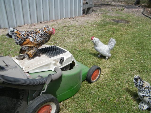

We have ignition! fired 3rd pull what a sweet mower to use lots of power and its not even run in yet...Even my Chooks approve! haha[Linked Image]
now a wash before the poolroom ! great job , good the chooks like it too lol
Darn you got it all dusty.
Not really into this model a bit to new for me,but hey you've done a very good job.Well done,oh except for the chickens of course.Now you could have chicken poo in the carby.Well done it looks great before using it that is.

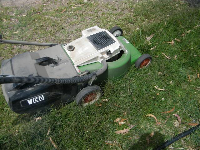

Looking a little 2nd hand now haha ...I have got a few hrs up on the Mustang now, and its not missed a beat...Time for some new blades im in Granite County its very sandy and hard on blades....Cheers Chris [Linked Image]

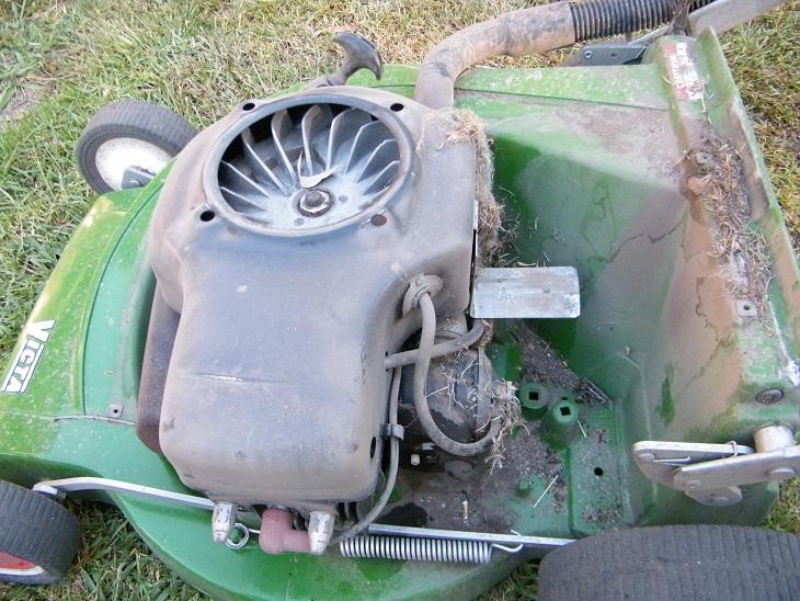

G'day all.. Some time has passed since I did the Mustang and in that time Ive worked it hard and it's not missed a beat that is until just recently...It has been losing power slowly the last few times Ive used it, to the point of it has no power now but still runs just!.....
So I went looking as to why? thinking maybe fuel side things I gave the tank/carby a good clean out but it all looked fine as did the air filter, sparkplug was not giving that much away to me apart from not that great of a burn being a little oily but nothing major as in dripping with oil or white from running lean....As I was refitting the carby I spied the decompression valve so gave the hose a suck and bingo! I just got air could not pull the valve up...
I did not change the valve just yet as I prefer the process of elimination one thing at a time so just to be sure it was not the fuel side of things and after about 15 pulls it fired up and was no better so next thing to do is change out the valve (ran out of daylight today)...oh yeah I found a new tenant had moved in as well lol...Cheers [Linked Image]
Posts: 104
Not that it is the problem but the plug is wrong. Nice spider though. The best spider I found was a huge redback. Can't love em!

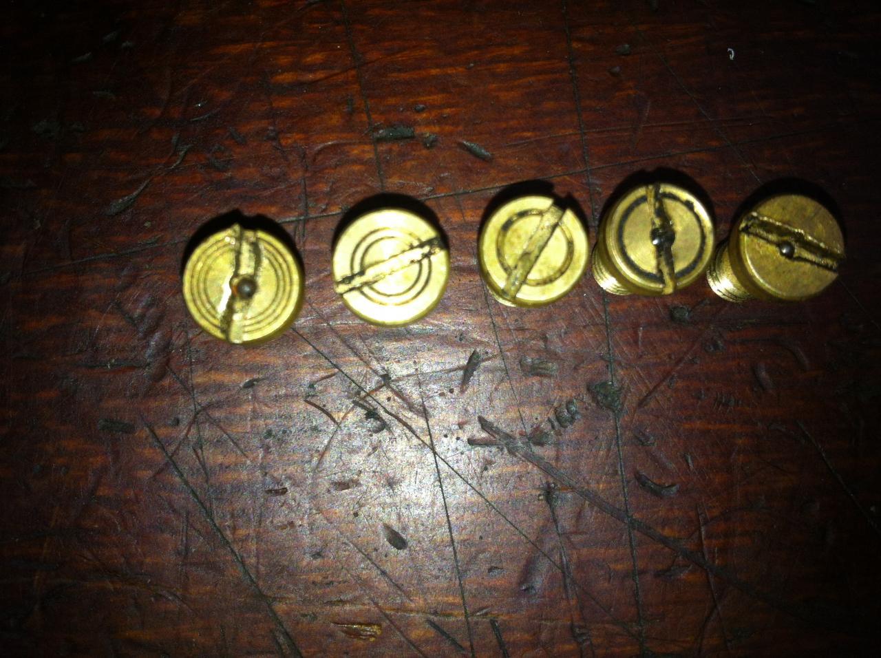

G'day Chris and Deejay,
Chris, could I ask what carby jet you sorted out for this machine?
Deejay, did you ever manage to find out about the plug?
Posts: 960
Hi Bushie, the jet for this carby should be the plain faced one.
It's the one on the far right.
