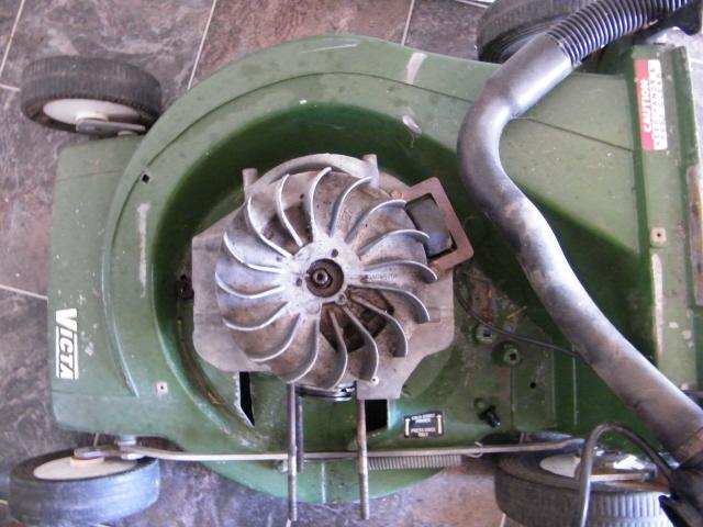

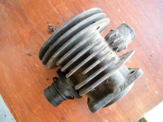

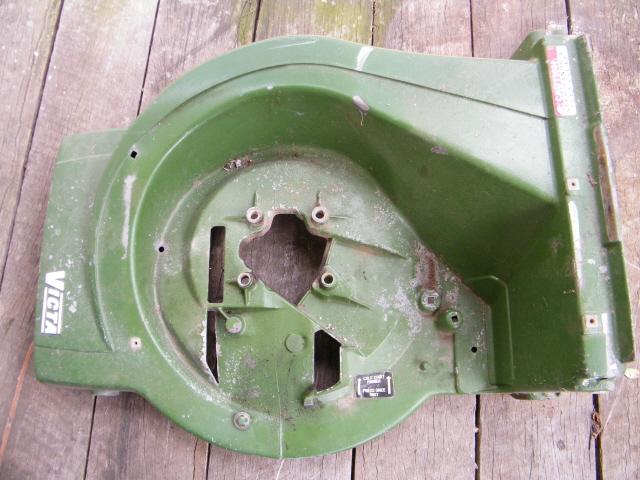

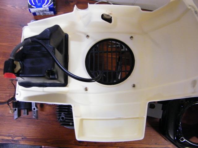

Hi all here is my 160cc Mustang Victa im working on,about time i got it done..Im going for as it left Victa with this one to look at anyway haha...The engine is a powerplus and im going to see if i can get a little more out of it with porting and such,only very mild porting as it will still have to mow for it's keep..I will just have to see where i go with the porting when i do it...And yes there is more to a powerplus than just the head.. here are a few before pic's....[Linked Image]

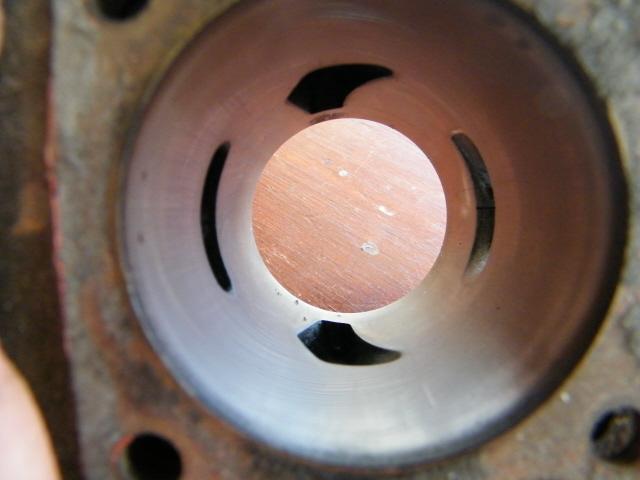

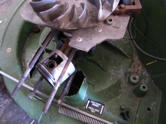

The bore is in great shape not much work needed there...I've already done the head i was going to shave the head but this kind of head it seem's there is not much room to work with its ok as is really....[Linked Image]

Yeah it's not bad for age whatever that is? seems old haha like 80's maybe? ...I don't know how hard the Powerplus is to get.. This is the only one i have not that i look for them.. And there is nothing on this mower to say it's a Powerplus..I got it from the tip for i think 5 bucks i have used it for about 1 year to mow with...With my porting on this im going for more torque not RPM will have pics of everything i do...it's the carb that will hold it back as in it's easy to get more fuel but air not so on this kind of carb....Cheers

chris your engine is indeed an 80 series engine as itt has the side starter and the coil isnt under the flywheel, they were a tough mower and have survived well those 80 series motors never seemed to wear much.
mark the power plus heads are quiet common victa mowers with a power plus sticker has one some of the super 24's had them , utility's but make sure you have the muffler or you will find the standard muffler will restrict any extra power the head gives you.

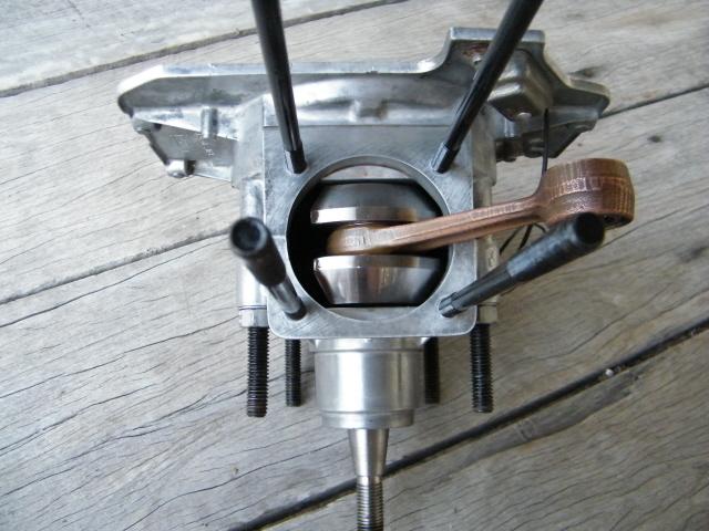

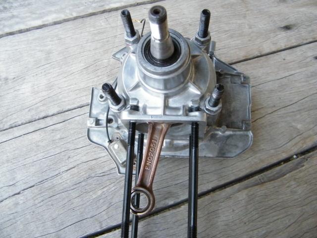

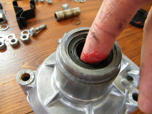

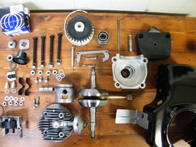

Hi guy's im getting there with my Mustang its looking good so far,Im putting in new big end bearing's and seal's while i have it apart...here are a few pics...cheers.[Linked Image]
looking fantasic so far smile i wish i was that organised ! mine seem to end up in a mess then work out well . might be wrong but those heads seem more common on the 80 series ? had 3 here, 2 of them were powerplus heads . just broken off in the case sidepull screws . cheers2

Very well prepared and organised Chris, excellent.

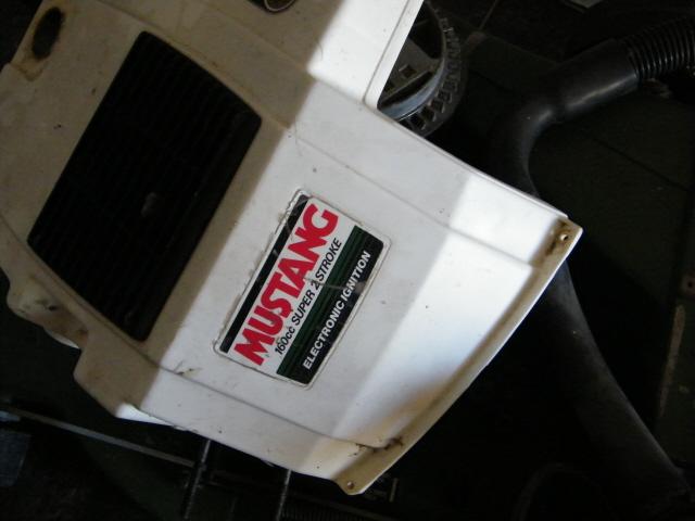

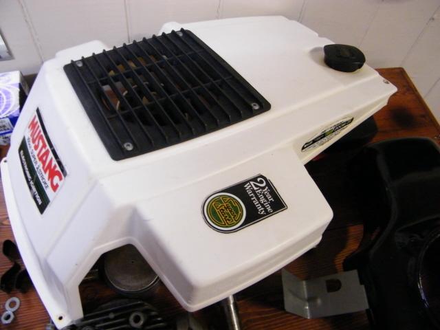

What have you done to get the white cowl looking so good?
Joined: Sep 2012
Posts: 418
G'day to clean the cowl all I did was degrease it,then use the little soapy steelwool to give it a good going over.....

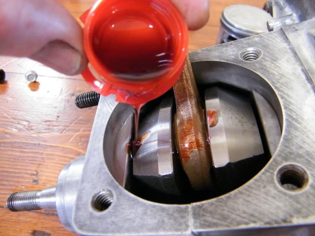

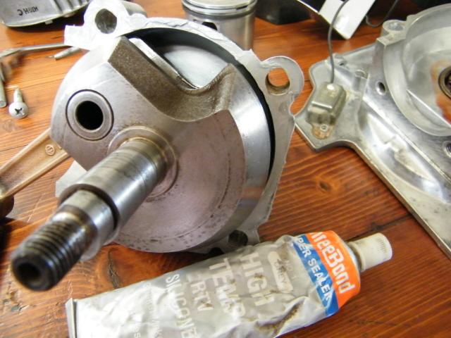

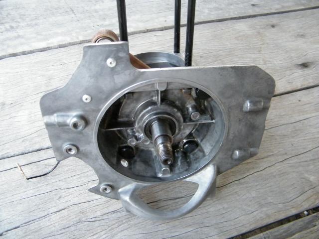

Ok Ive got the crankcase back together,one tip is to wipe some grease on the lip of the seals and also use plenty of 2 stroke oil on the crank bearings and bigend bearing when reassembling...I use ThreeBond to seal the crankcases... [Linked Image]

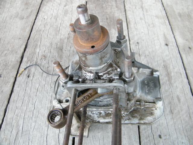

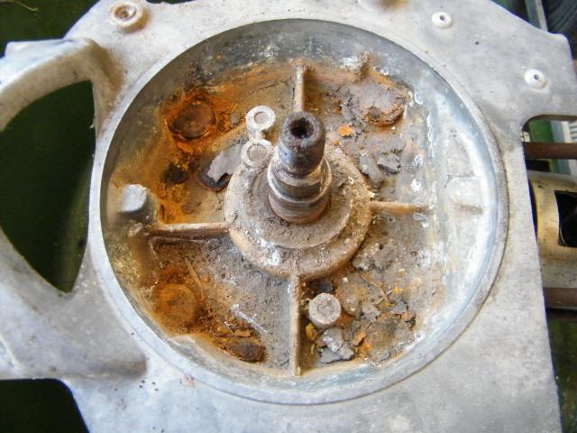

it was quite a mess under the flywheel but cleaned up well..few before and after pics...[Linked Image]

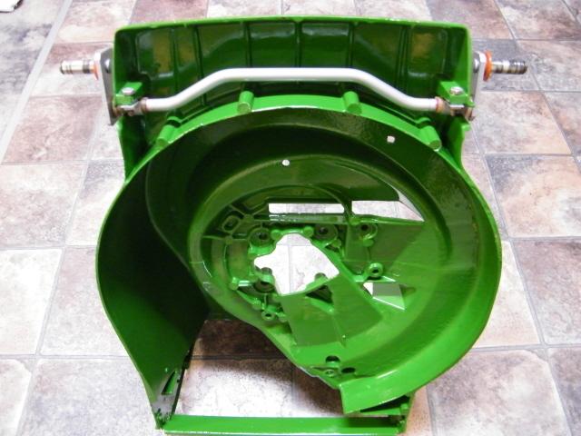

Few before and after pics of the base..The colour is John deer green it goes great with the white cowl...I just have go over the Victa with white and its done....[Linked Image]

Looking awesome. Did u brush paint the base?
Joined: Sep 2012
Posts: 418
Thanks, yeah looks even better in real life...No I did not use a brush I used a can of spray paint was about 12 bucks and it only take the one can..And also I warm the can in hot water for a few min to help it flow,I do that to any paint in a can works great in getting a good paint job...cheers

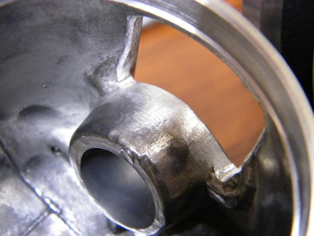

Hi guys im done with the porting...I worked all the ports over for more flow, and worked the transfer ports to flow more to the back of the cylinder..Its only mild porting just to try and get a little more flow and better mix of air and fuel, might work just have to see how it goes...cheers [Linked Image]

Good stuff.
Be interested to hear back how the port work works.
Not sure it will amount to a hell of a lot without a jetting change.
Joined: Sep 2012
Posts: 418
Yes your right there to port a two stroke engine you realy have to know how to jet one..With the work Ive done on this one id say stock jetting will be fine but if not i will mod the main jet for more fuel..if you where to port one in a bigger way and not tune it with jetting it would be seized in no time...The biggest restriction on a mower that ive seen is the air box they let stuff all air in and I think its more a safty thing to stop it from ever running away with hi revs,and also a big restriction is in the fuel system the carb can only get what the pin hole of a feed will let it, also a safty thing id say to stop it ever getting a little to rev happy and running away...With this mower i hope to have picked some torque up not looking for more revs..Cheers
