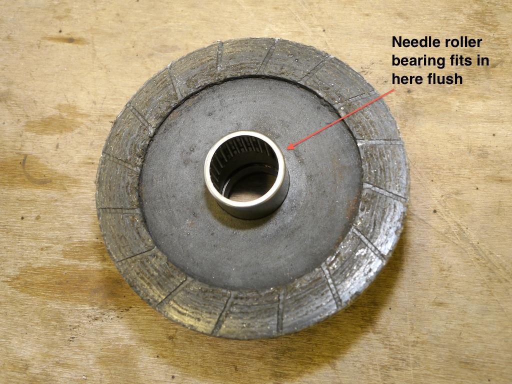

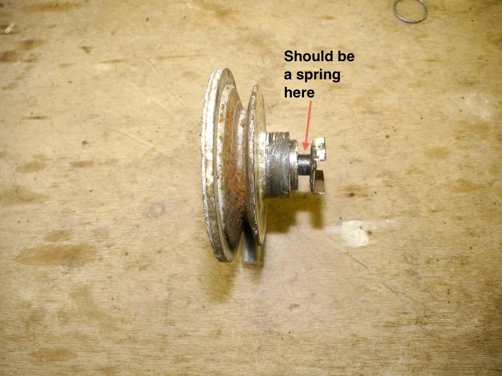

Stripped the rear axle down today and can see why one of the wheels has bolts going through it. At some point the wheel must have broken so it was machined to remove some of the inner face and the centre has been machined out removing the taper fixing. A steel hub has been made and the axle machined with a new, smaller taper. I must admit that whoever did the work made quite a decent job of it bur it does leave me with a dilemma. To get it back to original I will need a new wheel and rear axle. The axle isn't a problem as I can machine a new one but the wheel will, I expect be almost impossible to get hold of unless Greenfield have one laying around! So I'm just going to replace the axle bearings and maybe make it so that the bolt fixings for the wheel are less obvious.
I've also taken the clutch off the engine and the good news is that the clutch lining is still in very good condition so doesn't need replacing but the bad news was that the clutch / pulley was cracked and had been welded (badly). I've now rewelded it and machined the face so that it runs true against the clutch lining. It's a very simple and clever mechanism and I'll be taking some photos of it tomorrow together with the rear axle.
I've also ordered new belts for both the drive and cutter, and will post the sizes once I know they are the correct ones!

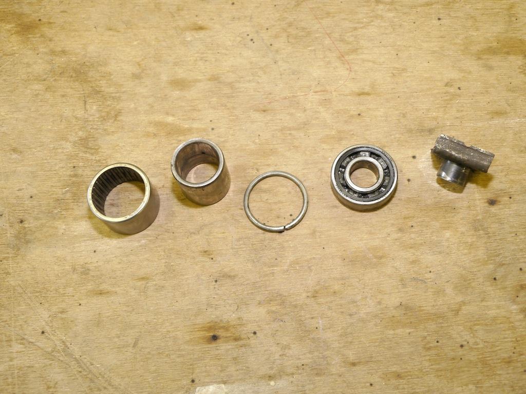

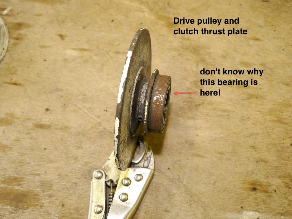

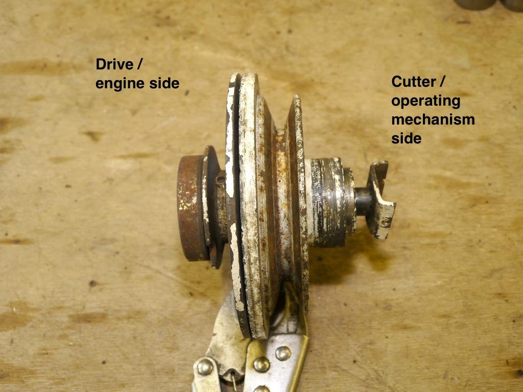

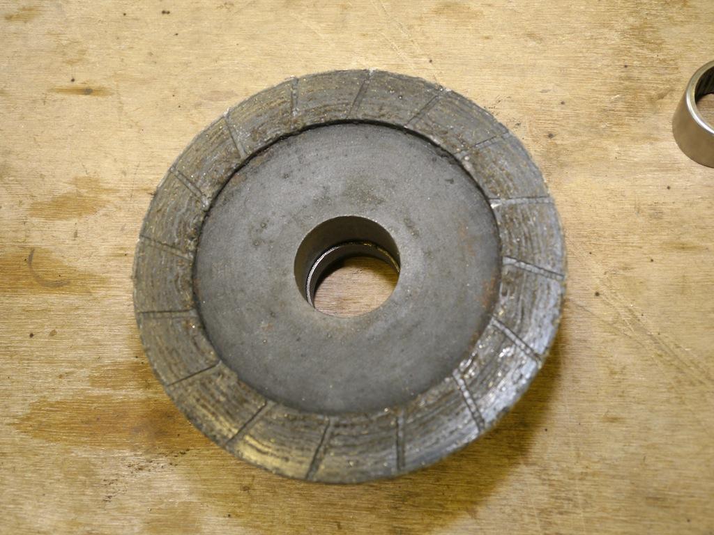

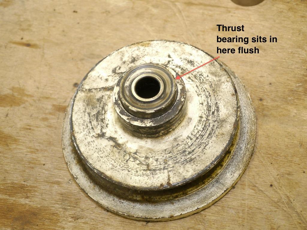

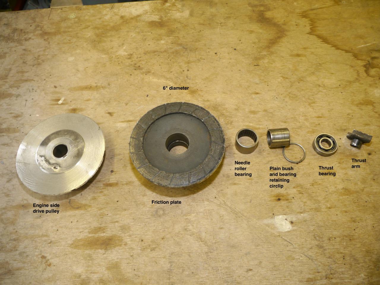

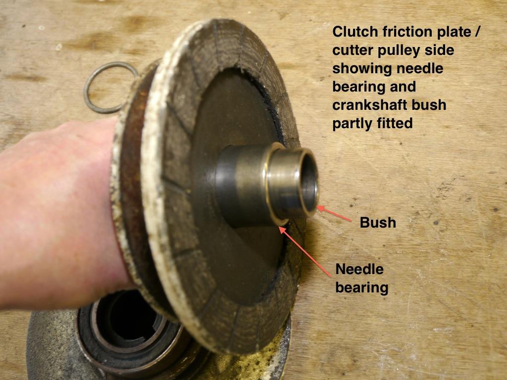

Here are the photos of the crankshaft clutch arrangement most of which I think are self explanatory. I'll take some more shots of it as I re-assemble it on the crankshaft. I'm taking the opportunity to replace the 2 bearings, the needle roller S2016 and the thrust bearing which I think is a LJ 5/8 (the existing bearing markings are not clear).
When I stripped the clutch down I noticed that as well as the repaired crack, the drive pulley has a piece missing from it and whilst this may not cause any major problems it could cause undue belt wear. So I may make a new drive pulley / clutch arrangement from a standard pulley welded to a piece of 6" diameter x 1/4" thick steel for the clutch drive plate and to make fitting it easier mount the whole assembly using a taper lock.

I would guess the inner bearing is just there to space the pulley out from the crancase.
The pulleys are all steel???
I thought they might have been alloy. Well the outer with the clutch on it.
Looking at the red ones i have here i thought they were alloy. Might have to grab a magnet and check.

The pulleys / clutch parts are actually cast iron which I guess is why the inner part cracked maybe when someone tried to get it off the crankshaft (there's a grub screw in the V of the drive pulley and I nearly overlooked it).
It would be fairly simple to machine a new clutch up as per my notes above and would probably be a lot cheaper than buying another machine!

Working on the clutch has also proved to me that the engine is definitely replacement. the crankshaft is higher than the original engine (Honda G65) and the clutch operating arm has been modified to suit. All I have to do now is find Honda G65 for it!
