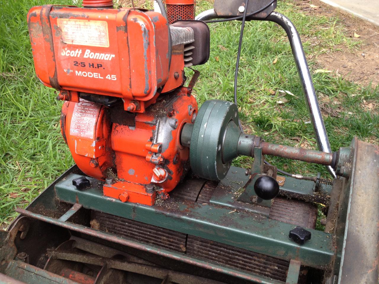

I have a Scott Bonnar 45 with 17inch reel.
https://www.outdoorking-forum.com.au/forum/u...amp;Main=6404&Number=30812#Post30812
The Kirby (2.5hp)is on the way out so would like to understand if i could fit the 2.5hp B&S from my SB diplomat. Would it be a straight swap or require much to change it over?. Or am I better off looking to a new engine(and what would it likely cost)
I'm relatively handy but haven't done much mechanically so not sure if it would be extending my ability!! I've seen the you tube footage of removing the reel, but not an engine!
Any advice or info would be much appreciated....
Thanks
Barry

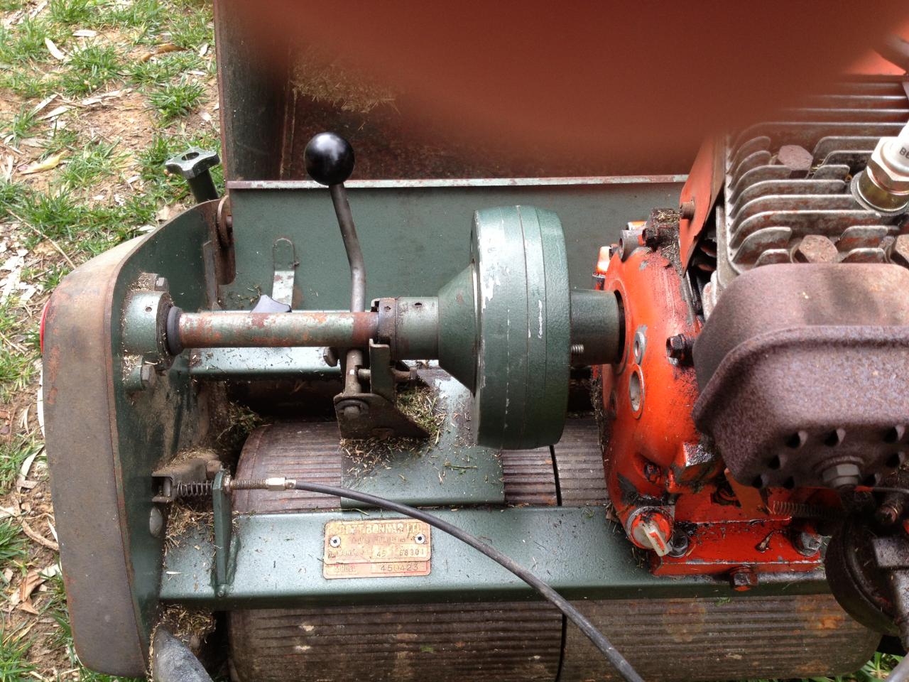

Hi Barry, this is a curly one....presuming that the output shaft free end of the Briggs is the same diameter as the Tecumseh; that the mounting holes for the Tecumseh line up when the Briggs is placed in the same position, this would not be a difficult swap. grin
Before we get the tools out, can you please post some pics of both engines and particularly the cutter clutch attachment to the engine shaft of the 17" machine and how the Diplomat is connected .
We can then work out a plan for you to proceed. wink

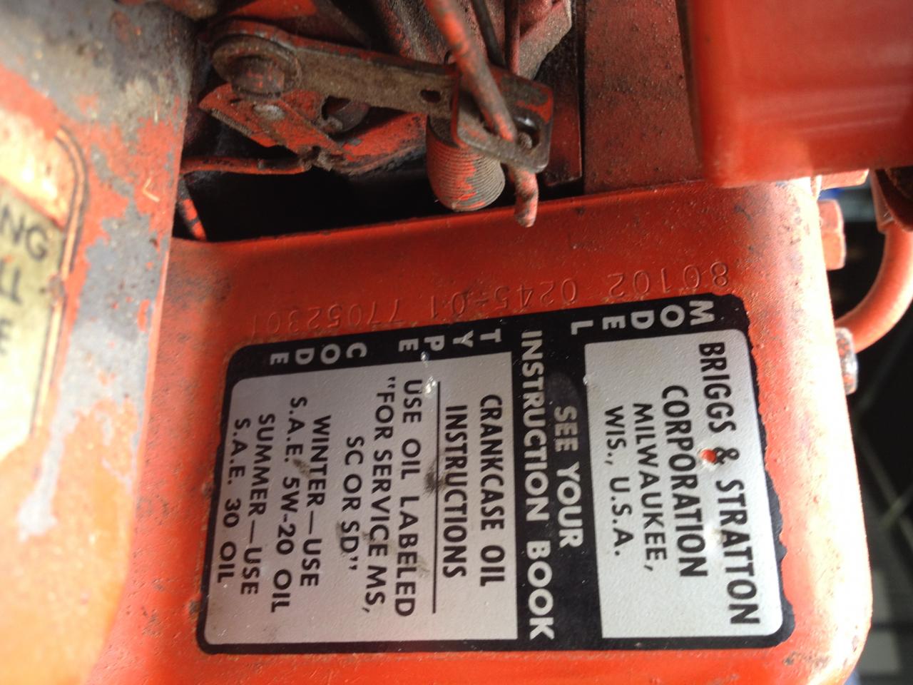

Barry, Briggs have two different engine output shaft sizes in the 2 to 3 hp range. Essentially, the 2 hp 60102 has a 5/8" shaft, the 3 hp 9 series engines have a 3/4" shaft, and in between is the 80102 which is probably the engine on your Diplomat. I don't know which size that 8 series engine has. I suggest you add these items to the pictures Deejay has requested:
- full series of numbers stamped on the cooling air cowl of your Briggs engine
- measure the output shaft diameter of your Kirby-Lauson engine where it goes into the clutch
- measure the output shaft diameter of your Briggs engine where it goes into the clutch.
Note we need the smaller diameter of the output shaft at the free end which slips into the bore of the clutch. We don't want the larger diameter of the shaft right up against the engine, where it goes through the oil seal and into the engine.
Hi grumpy, if you click on the link to pics in the first post of this thread, you will see that without removing the motor, measuring the free end of the output shaft would be nigh to impossible because of the position of the cutter clutch being so close to the engine. If the output shaft of the Tecumseh is stepped down, it will be full contained inside the inner clutch half. wink
Barry, it sounds as if it will be necessary to at least partly remove the engines from both mowers to measure the shaft sizes. Taking a good engine off a Diplomat to replace a bad engine on an SB45 does not, on the face of it, sound like the most economical way to replace the sick Kirby Lauson on the SB45, since it leaves a partly wrecked Diplomat behind. The engine SB fitted to the 17" Model 45 was the Briggs 80102, but I can't guarantee that it had the same output shaft size as the Kirby-Lauson engine, because SB seem to have had clutches with both 5/8" and 3/4" bore sizes. It will be useful for our archives if you measure both output shafts, and post the results here.
To measure the shaft sizes, you will need to loosen the clamp pin in the boss extending from the clutch on the engine side, if your model has a clamp pin. (Some had a grub screw holding the clutch boss to a key - if you have a grub screw, just loosen it a turn.) If you have a clamp pin, do not try to remove the pin, just loosen the nut and tap the nut end of the pin with a block of wood to loosen it. Then remove the four bolts holding the engine down to the mower deck. Hopefully you can then slide the engine half an inch away from the clutch to measure the shaft. Sometimes the engine shaft has rusted and jammed in the clutch bore. If that has happened you will need to put some Penetrene on the shaft and wait an hour, then try again.
Hi grumpy, this is why I asked for pics to be posted in my first post...to ascertain which clamping method is used by both machines....I have just posted in another thread how to remove the engine simply, step by step, and can re-post that here once we know the shaft diameters. wink
Regarding the swap, I feel that he wants to get the 17" Model 45 machine up to speed, and he may be able to source another serviceable 80102 for the Diplomat at another time. Providing the engine mounting point on the twin rails is the same for both the Tecumseh and the Briggs, even if the shaft diameters are different, all he would need to purchase, is a new inner clutch half. wink

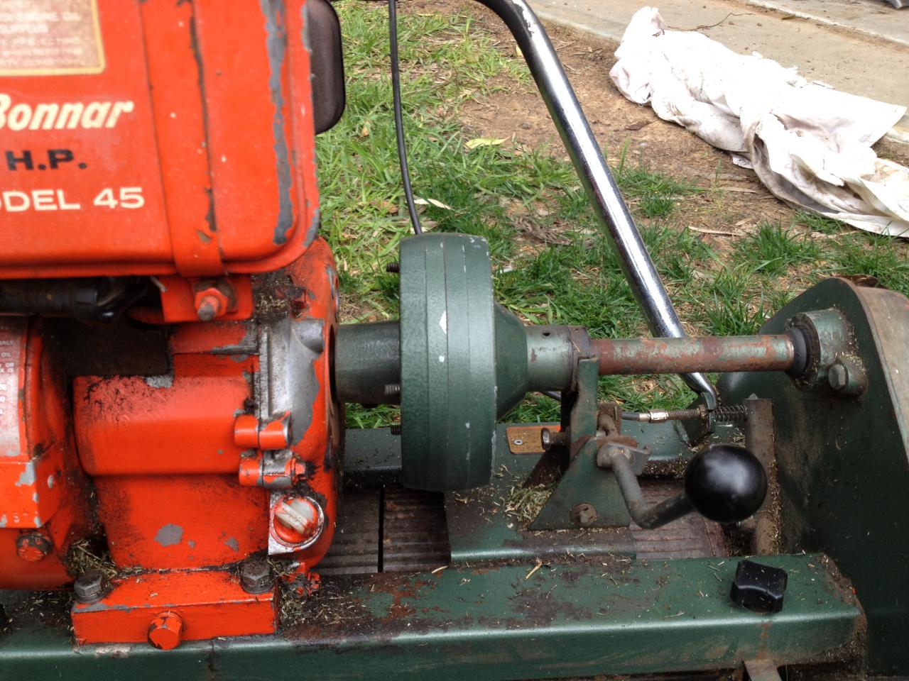

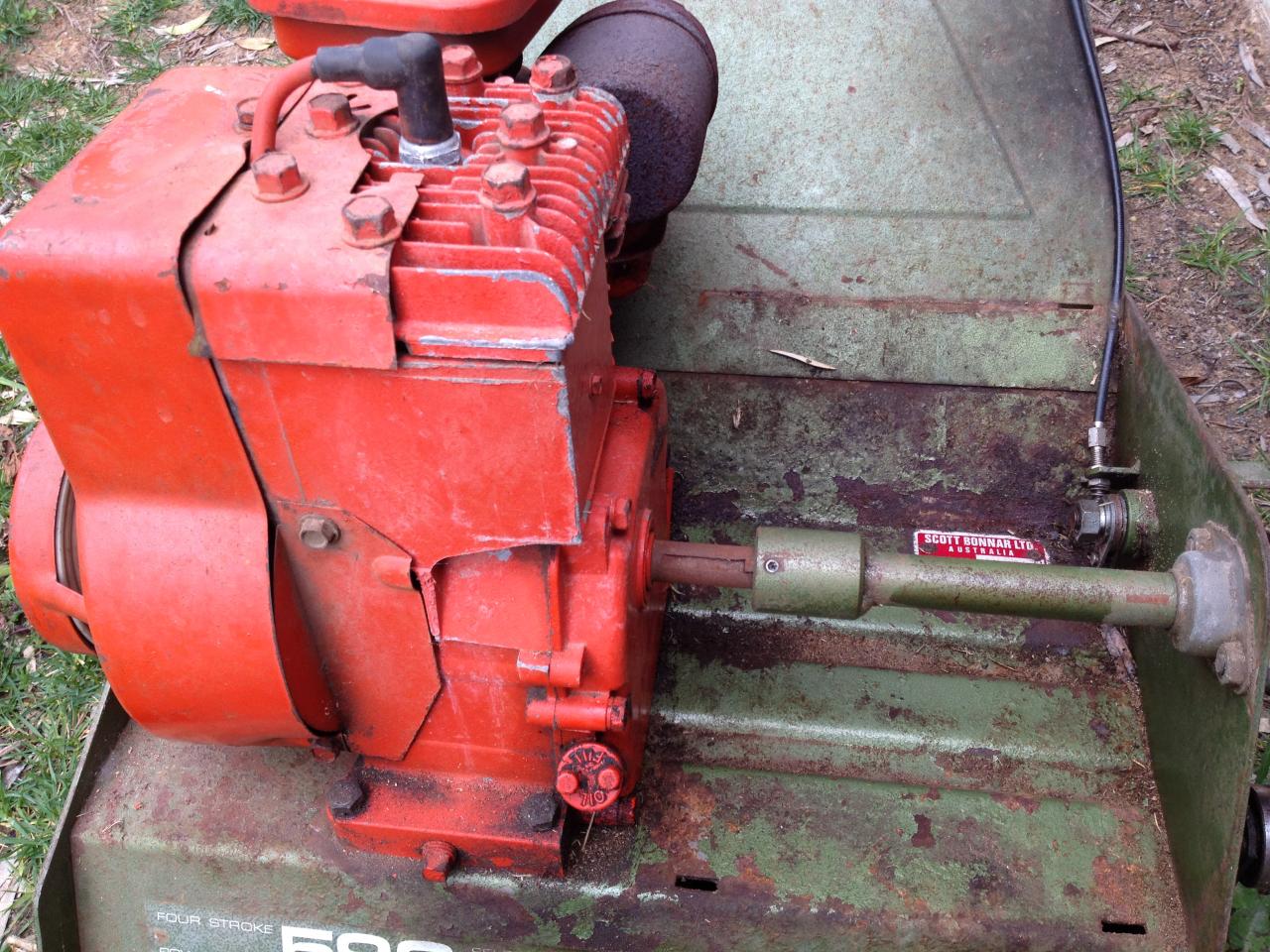

Well, Ive had a bit more of a look and taken pics.
Pretty sure the Kirby is a 3/4 shaft and the Briggs a 5/8...
You cant really see from the pics of the Kirby's.
So am really not sure if its worth the effort or the new LHS piece to put an old B&S on it...
Ive seen a few new engines on evil bay, brand new, thoughts ?
http://www.ebay.com.au/itm/Briggs-S...pt=AU_Lawnmowers&hash=item1e706759a1
Most of the ebay engines are Chinese ones. So far the cases we've seen suggest that the Chinese-made genuine Briggs engines are not yet as durable as the American Briggs engines we are used to. I haven't seen enough reports on Chinese-made genuine Hondas to reach a view on their quality. The unapproved Chinese copies of Briggs and Honda engines so far seem to have fairly serious issues that lead to short operating lives, or a lot of new parts, or both. They don't necessarily run badly when new, but there are reports of early problems with fuel system and ignition parts, and rapid wear on starters and engine controls. Most likely all this will be sorted out in due course and the engines will become desirable, but we don't seem to be there yet, based on the reports both here and on other sites.
There may be an alternative to buying a new clutch-half if your existing one, from the Kirby-Lauson, turns out to be 3/4" bore. You may be able to bush it down to 5/8", depending on whether it has a captive cotter pin or a key and grubscrew. However that kind of rework mostly appeals to people who have a lathe at home and enjoy making things.
Unfortunately the pic of the SB45 does not show the captive cotter clearly, I think I can just see the nut of the cotter, underneath the inner clutch half in the 2nd and 3rd pics. I would still like to know the exact diameter of the Kirby shaft free end...but I have a feeling Barry will be right, and it will be 3/4"....I have just checked the output free end of my Honda G100 and it is 5/8" the same as the Briggs and Stratton.
So....we may need a new inner clutch-half in any case (or modify the existing one) to fit a new (or second hand) engine....Honda, Briggs, Chonda, et al.... wink

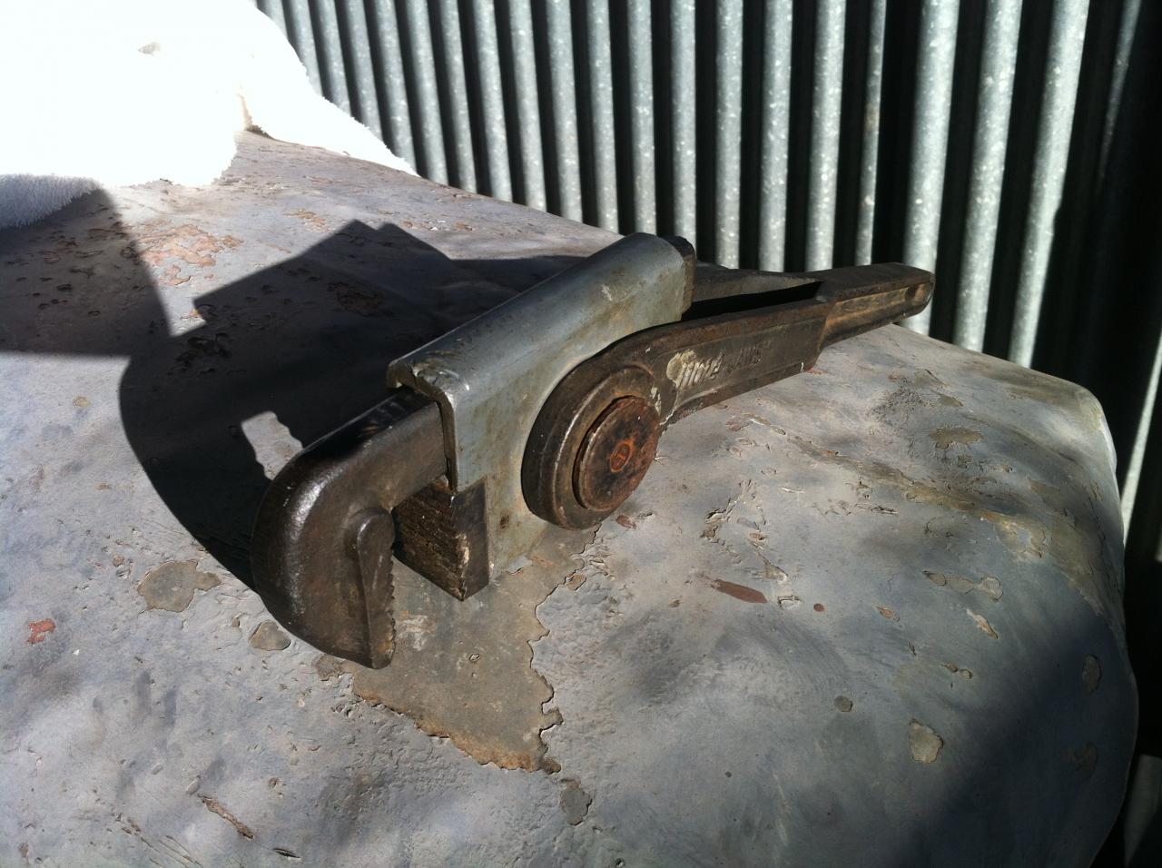

Stripping The mower has been fun! Well mostly... I've got the reel and rear roller out, but engine is proving slightly difficult. One of the engine bolts has\was\is rounded and hence can't get it off... Ive enlisted the help of Neighbour and going to try and weld a nut ontop of the rounded nut to try and get it off.. Not sure there is any other way?? I've tried wd40 with different spanners and vice grips to no avail..
For bastard nuts, I have a tool here I use, not exactly know what to call it, but it has "jaws" stamped on the handle.
its like a stilson wrench, with sharp hardened steel teeth and a built in ratchet in the handle that makes it clamp down harder the more you try and turn it, Since enlisting this tool nothing has been a real issue.

There is some writing on the side I forgot to write down, dont let its size fool you I have undone bolts as small as 8mm in fairly confined spaces without too much drama.

Joe, I agree it should work very well as long as the teeth on the jaws are sharp, but I don't see what advantage it has over an ordinary Stillson. The demonstration test on the prototype Stillson that convinced a tool manufacturer to licence and produce it, was proving that if you clamp a piece of waterpipe in a pipe vice and apply a Stillson to the other end of the pipe, you can easily twist the steel pipe until it breaks.
Stillsons are rather clumsy in my opinion, so I seldom use one until one of my trusty gas pliers has failed to do the job. Either a Stillson or a gas plier will easily bite into mild steel to the depth of the teeth on its jaws, then tear off that amount of metal right around the object it's gripping. Of course that is rather uncomfortable on your hand in the case of a gas plier.

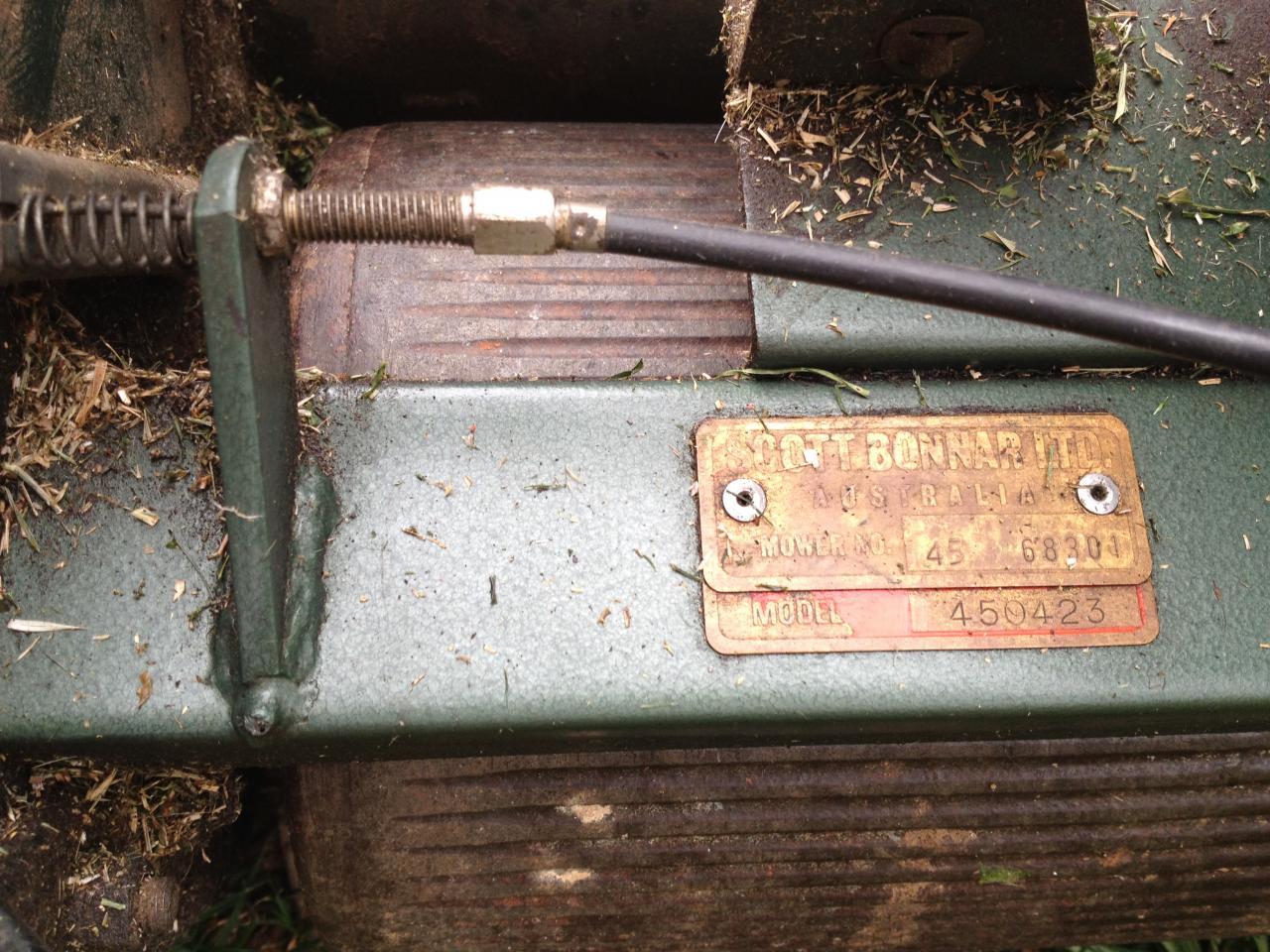

Had a question, how have people restored their body plates. Mine is the older style which has two overlapping each other

Hi guys, Scott Bonnar ID plates were etched from brass originally and had a bright red painted background. When the plate is in very good condition, this could be restored by masking the larger section where the numbers are stamped, spraying the whole plate in bright red enamel, and when completely dry, after removing the masking tape; rubbing the plate on wet and dry paper, on a flat smooth surface.....to reveal the lettering in brass.
When the plate has been damaged ie. dented, bent or abraded, a polish to a high shine with 'Brasso' will do the trick and look great....showing the heritage of the machine. wink
The later Scotties/Rovers had an anodized aluminium ID plate and restoration is nigh on impossible if damaged. cry
The 2 plates that Barry has riveted together were brought about by the inclusion of the new Model number sequence. This info of course carried over to the anodised future plate. wink

Thanks Deejay, sounds logical in theory however my lettering doesn't seem to be raised that much, feels very flat in fact..
