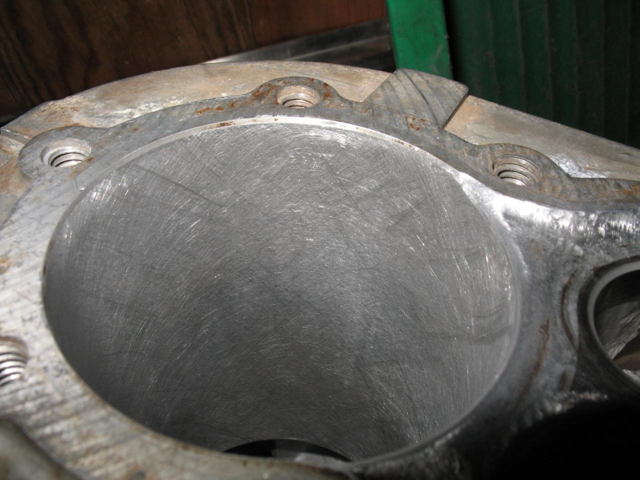

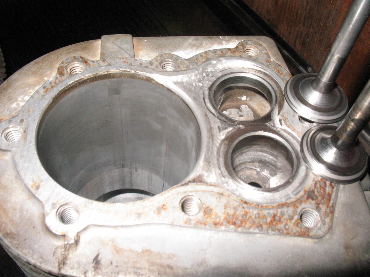

See Pics... After umpteen litres of solvent and hours of cleaning I finally got the Tecumseh stripped down. Top ring gap is way too big at 0.026" so I guess a set of rings are on the menu, the bore needs a hone and really think it could do with a re-bore but if a blind man could see it he would be very happy with it lol (no funds for that) frown
I can't help myself with the die grinder and the lathe got fired up to give the valves some attention (it was a fun night in the man cave yay) Were mods required? no.... was it fun yes... will they help? yes a little better breathing... (The sharp edges were just radiused a little). I left plenty on the valves really for a future rebuild, but I think by the time that happens it will be well and truly an historical oddity..
The bore marks are barely discernable to feel, however the long wide one (photo 3) is the one that bothers me, frown we will see how it looks after a hone as per grumpys method in the drill press.... wink
That bore does look worn, with the classic vertical stripes. It looks as if there may also be a ridge at the top of the bore, above the highest point reached by the top ring. If the ridge is small you may be able to remove its bottom edge with a scraper, rather than doing the job properly with a ridge remover. The problem with leaving a ridge in place is that it has worn to match worn rings and ring grooves. If you then turn it over with new rings, unless the ring grooves in the piston are worn to excessive width, the top ring will hit the bottom of the ridge and mangle the bottom of its groove slightly. Before doing anything, though, you should measure the side clearance between a new ring and the top ring groove. If it is more than the specified amount, you will need a new piston (as well as the loan of a ridge remover). If you turn out to need a new piston, it is much better to rebore the cylinder at the same time.
The usual method for evaluating bore wear is to measure the diameter, at right angles to the axis of the crankshaft, 1 cm below the top of the cylinder. There is usually a wear limit specified by the engine manufacturer. It is probably around 0.010". In practice the wear is concentrated at the top of the cylinder, on the major thrust side, so there is a taper in bore size of about the amount of the wear. The rings have to expand and contract each stroke by the amount of the taper, which causes wear in the ring lands (the sides of the ring grooves in the piston), as well as preventing good oil control. Also, if you are using steel rail rings like those used in cars, the oil ring expander is likely to suffer metal fatigue and break in a fairly short time. I once made the mistake of choosing the wrong design of ring expander when I put new rings in a V8 with 0.010" of cylinder wear. After 3,000 miles, five of the eight oil ring expanders were broken, and oil consumption (which had been considerable right from the overhaul) became so severe that it smoked and oiled some of the spark plugs.

Yeah Grumpy it does look worn, fortunately not as bad as it looks smile. The last photo most of the lines there are gas blow-by marks I ran the hone over it and they went by the way side after 5-10 seconds of honing grin. The wide groove (mark) was "I think" caused by a burr/sharp edge above the gudeon pin bore, which may have been wiping the oil away???
I had to finish off the honing with a hand drill as the pedastall drill was too quick for me today at 210 RPM to get the hatching just right, although I have perhaps over compensated and ended up a bit steeper < than ideal. The wide mark which did worry me greatly goes from not there at the top to faint towards the bottom of the "usefull" stroke. I will try the camera again now have cleaned up, for your parusal and comment. I will mic up the bore too. I dont think (hope) it would be anywhere the 0.010" I guess maybe 0.003 - 0.005"? Give me an hour or so and we will see how good the estimation is.. eek

I'll be interested in your bore measurement - if it is only 0.003-0.005 oversize, taper should not be an issue, and ring gap will probably be reasonable as well. I'll also be interested in what the bore looks like, of course, but it is sounding positive at the moment.

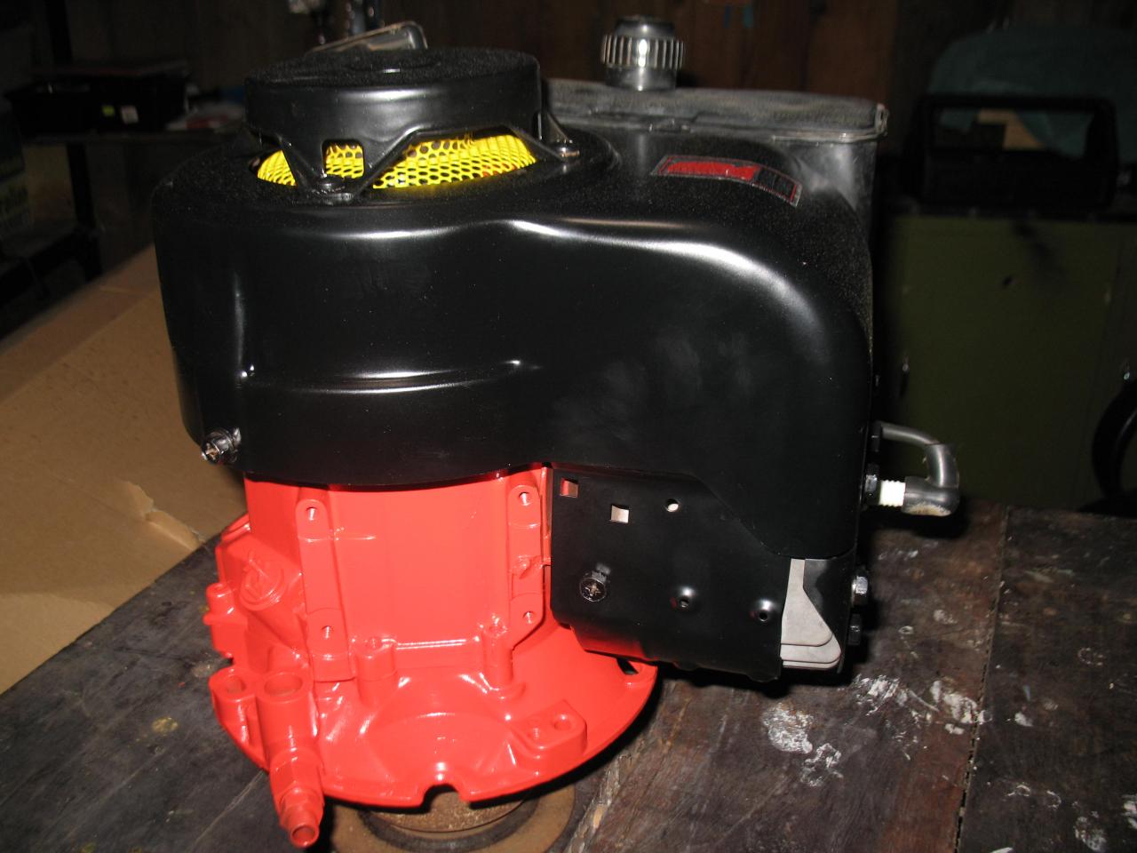

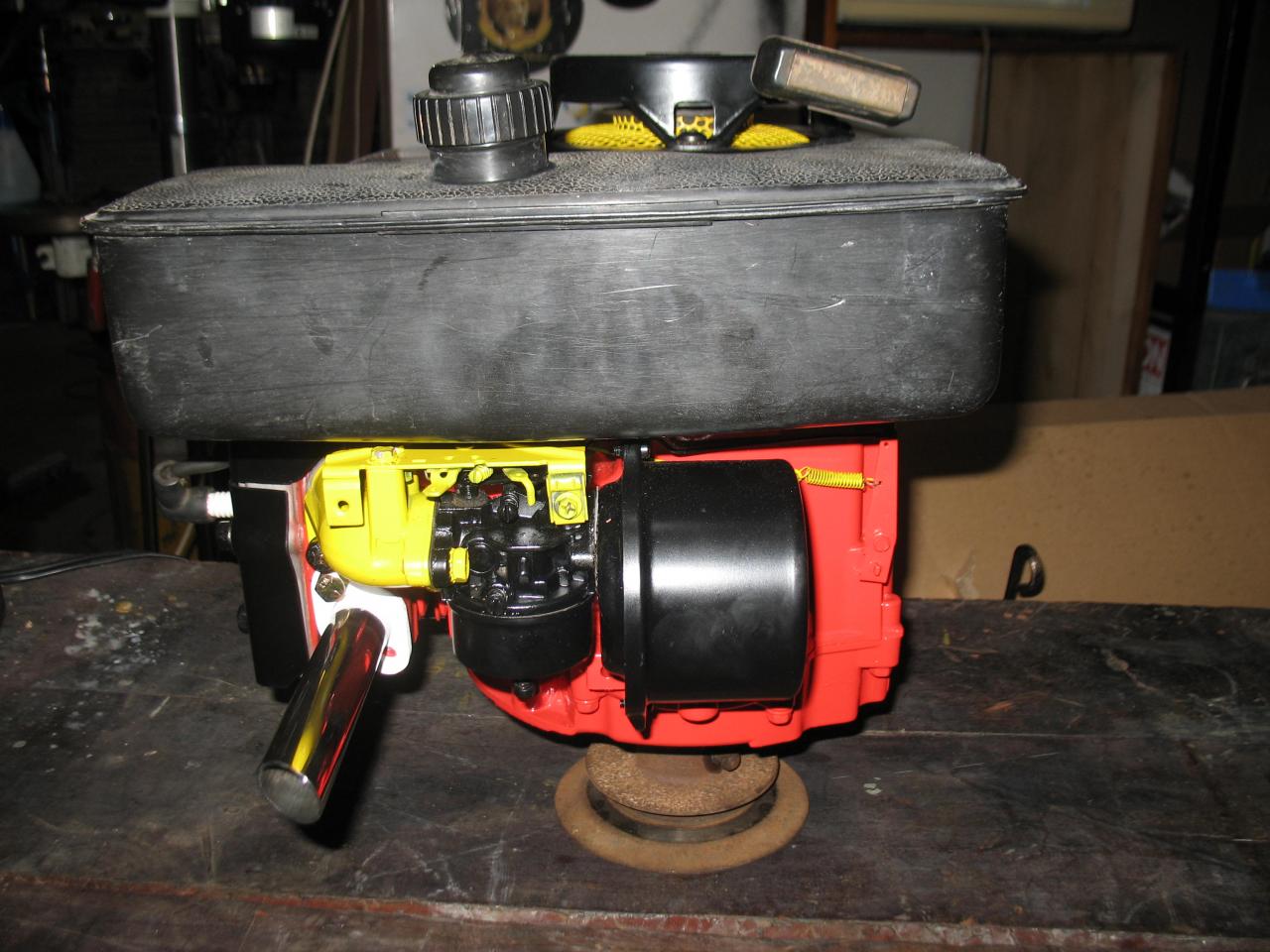

She's all painted up nice, complete with a short straight through Polished stainless steel ex-pipe.. grin a heap of compression too; prior to the decomp action on the valve!
My lad is happy that his "tractor" motor is together and he even helped with the painting (he is 6) He informs me that I now need to make a trailer so he can take grain feed to Granpa's ewe's and lambs...

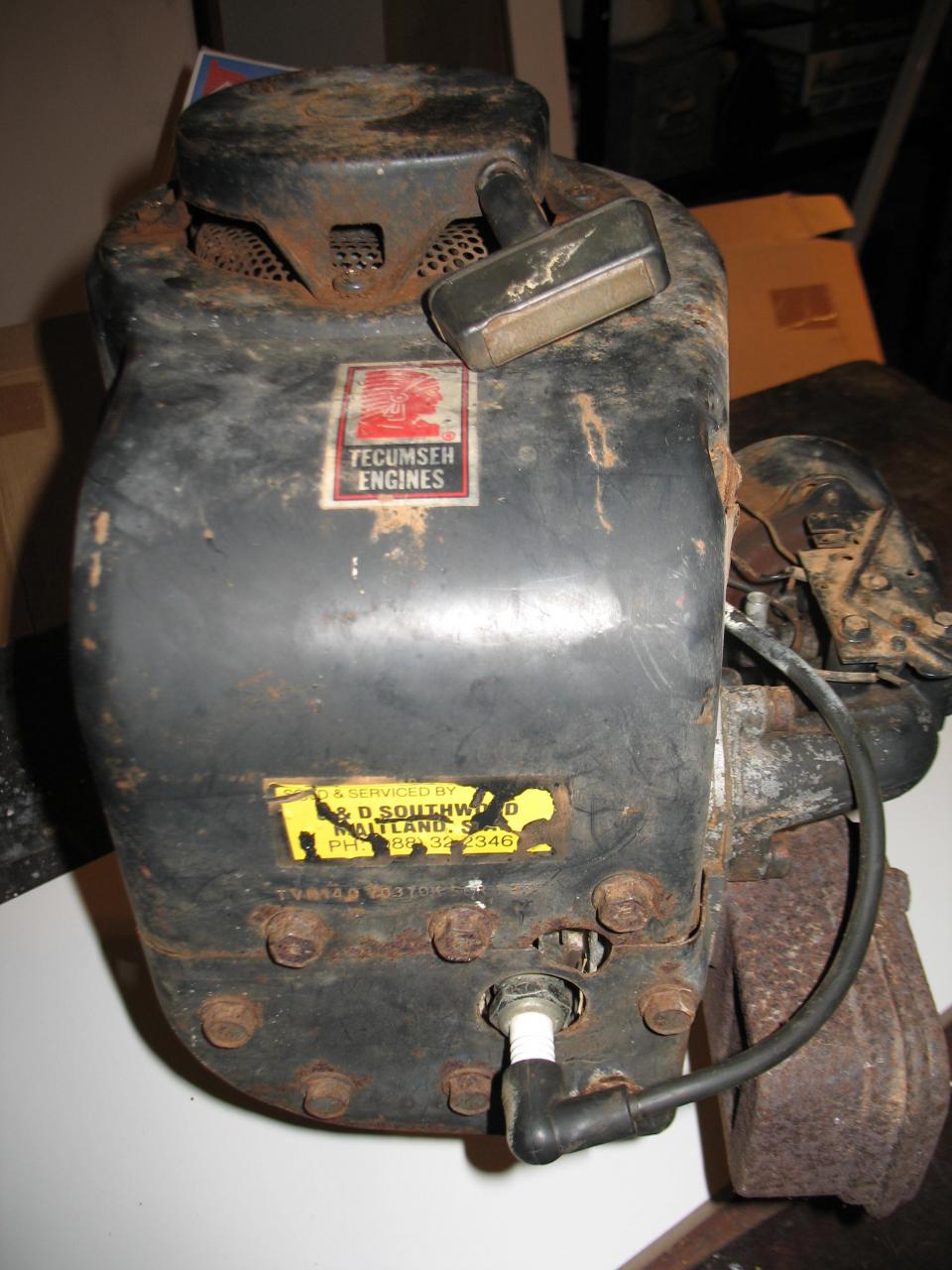

See before and after picks Engine # for the record is TVM140 70370K SER 12660
