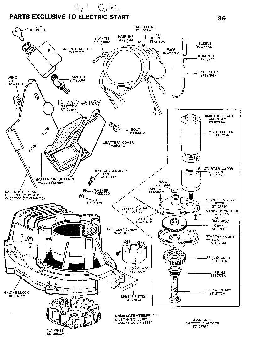

Image of the wiring as requested below. [Linked Image]
Bruce #38333 16/07/12 05:24 PM
Thanks Bruce for posting the parts list ....unfortunately it doesn't show which wires go where....and their not colour coded in the diagram either. frown

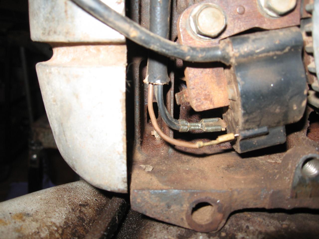

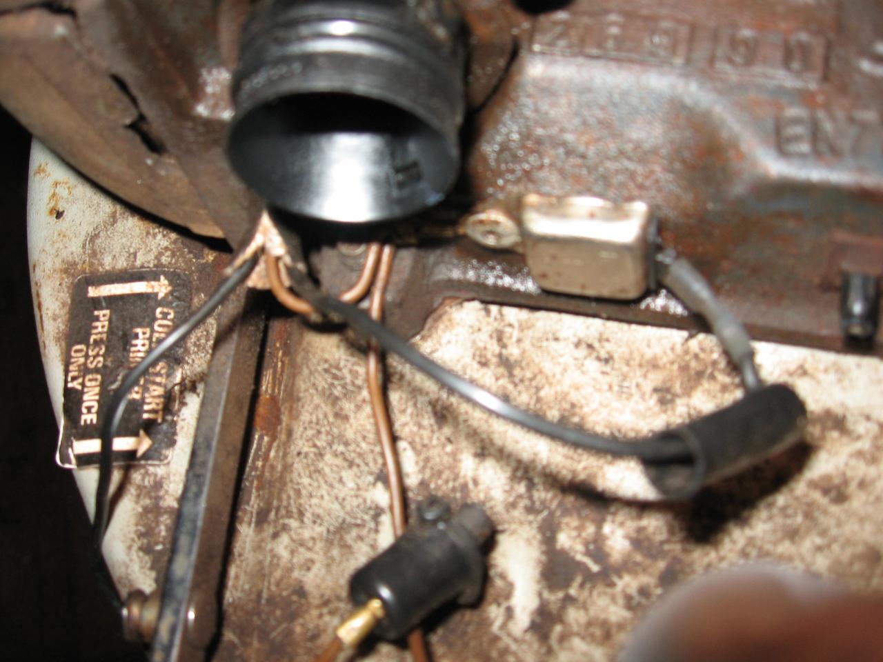

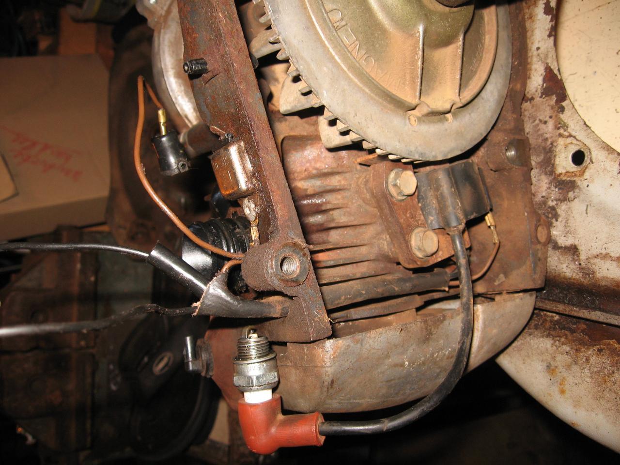

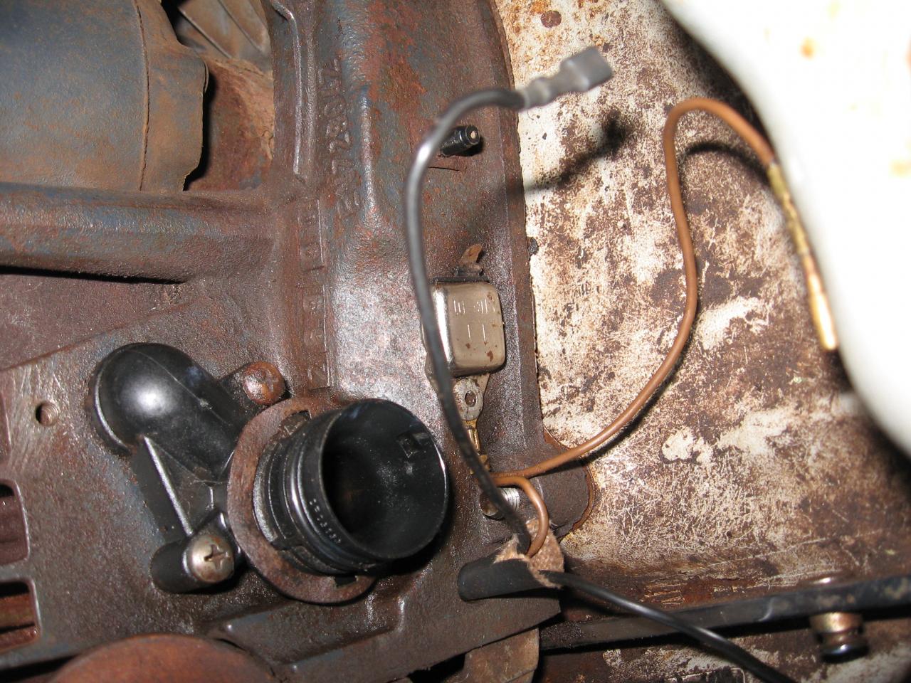

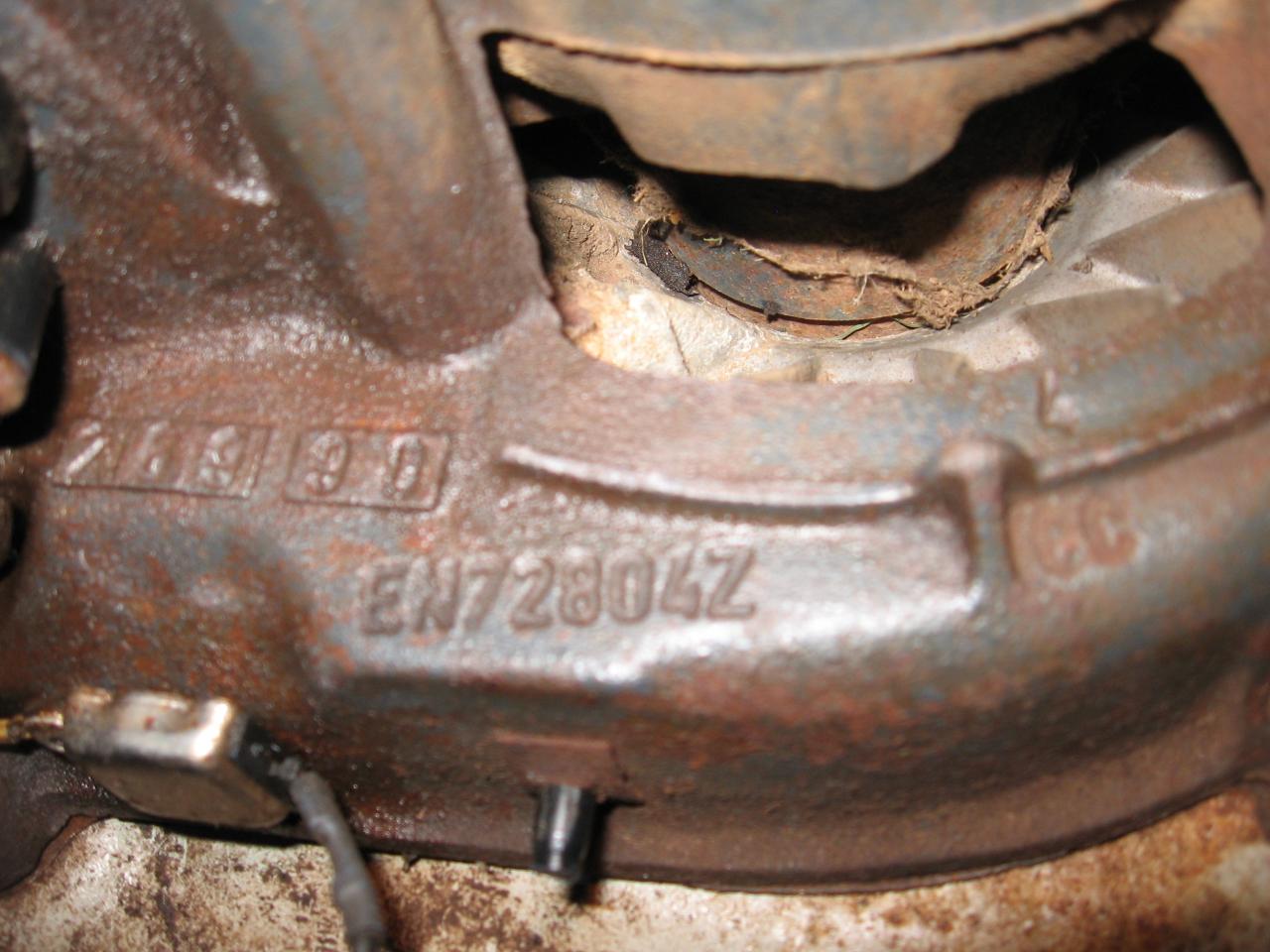

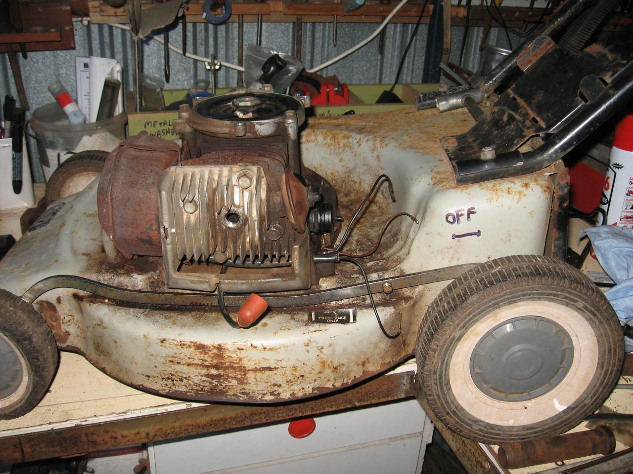

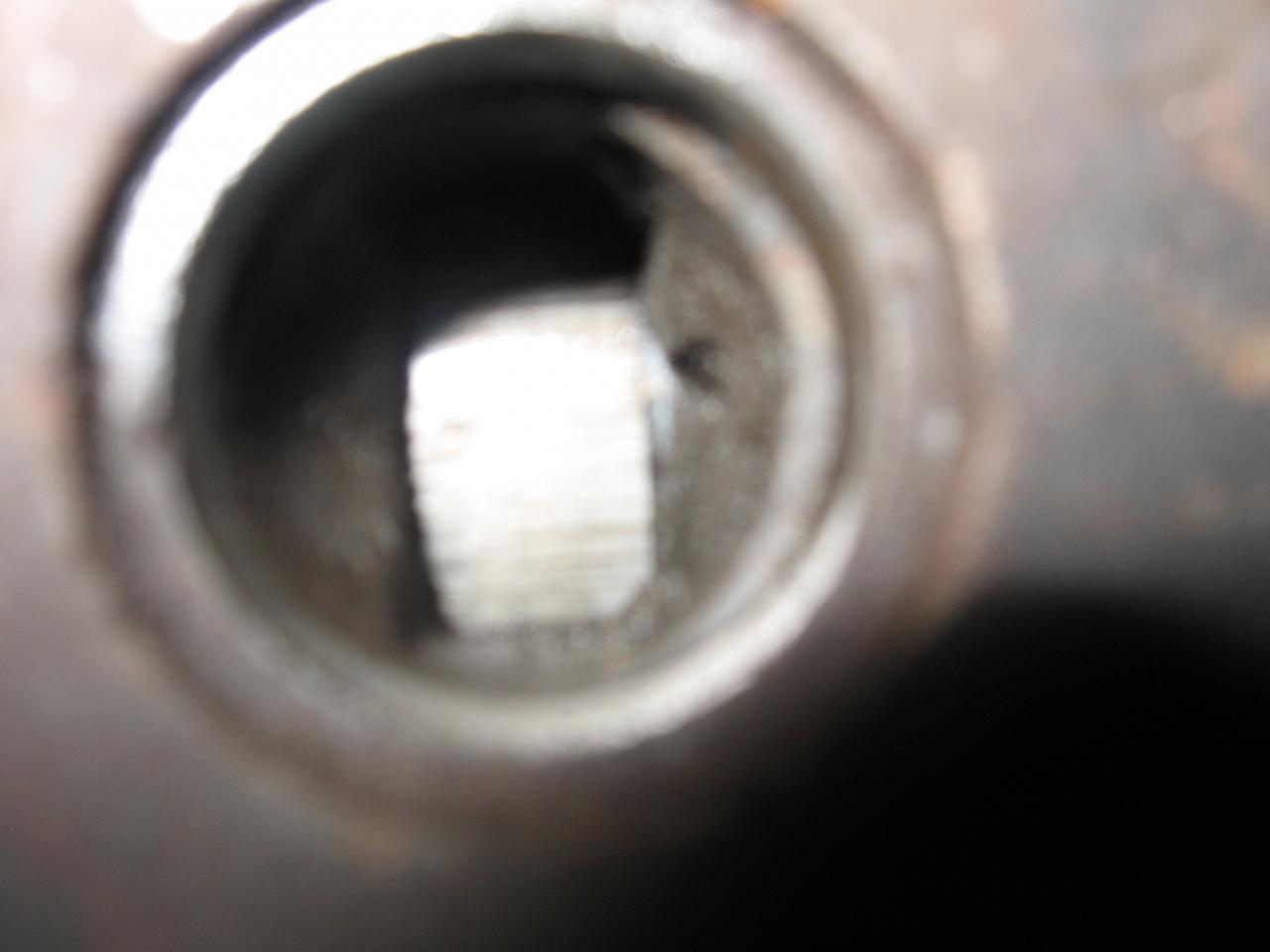

Yeah thanx guys for your replies .Apologies for the bump if it came across as an impatient twat.I'm not usually.....well heres some pics Ive [Linked Image]
got of the culprit- hope they worked & thanx again
Joined: May 2012
Posts: 467
Hey there bob

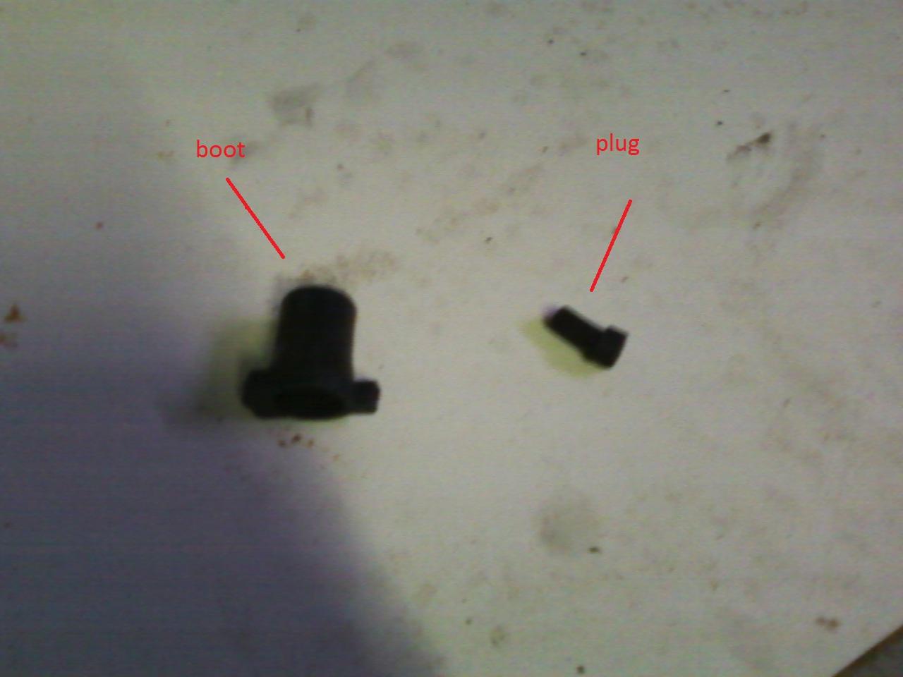

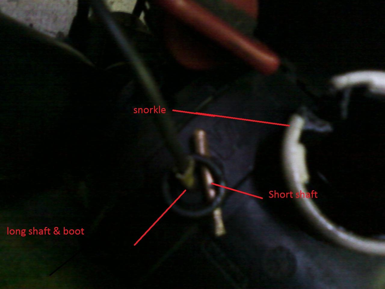

the spade terminal does go to the ignition module if its loose just give it a light squeeze.

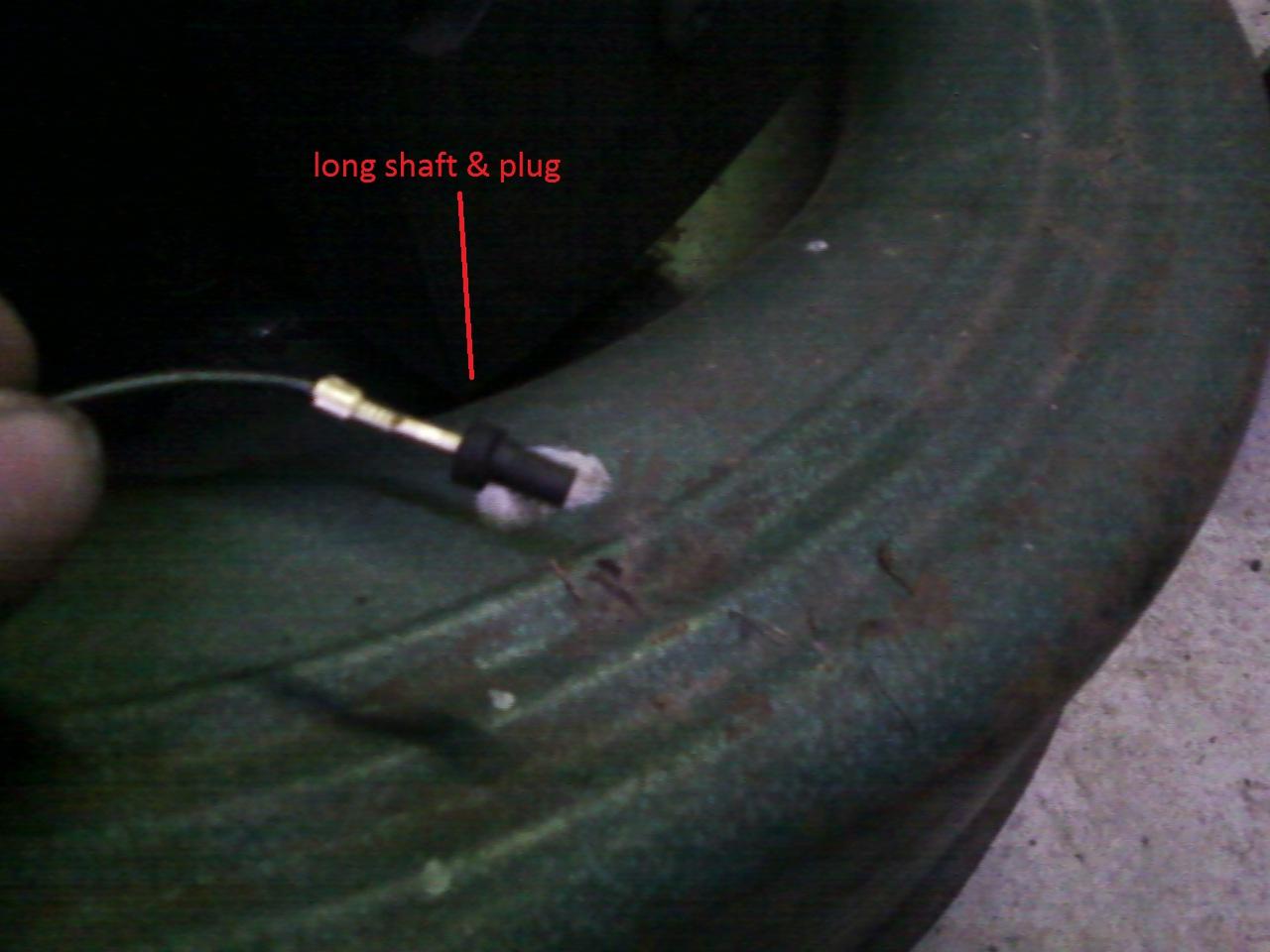

the longer of the remaining "long shaft" terminals (brown wire) goes to the kill switch of the carb you would have had two
rubber parts from the kill switch one is like a little plug the other a boot ,
The longer shaft presses into that boot and then the shaft into the kill switch hole (carb set in run position)

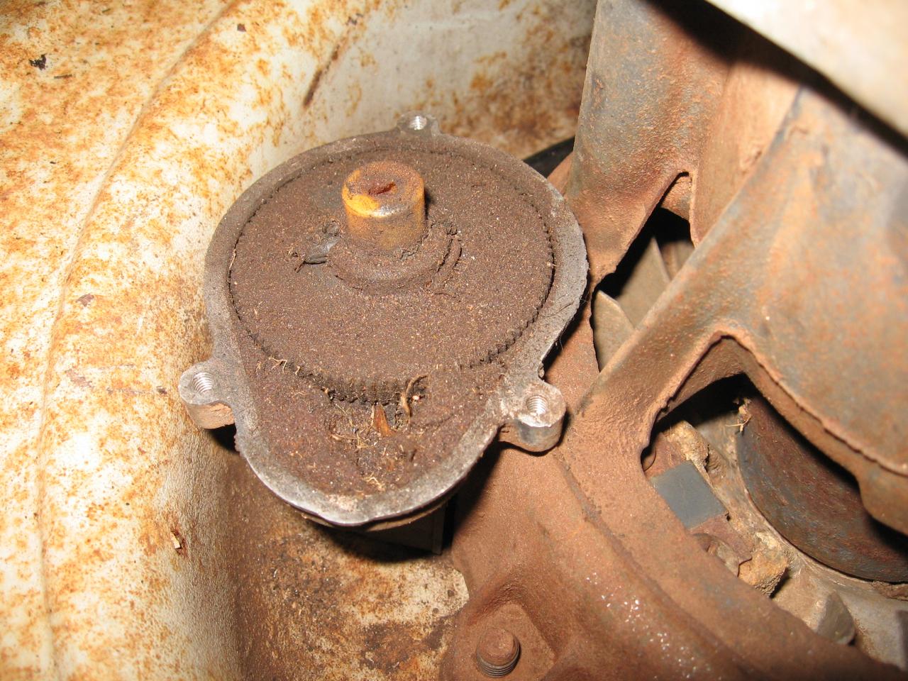

, then the other rubber cover slides over the switch hole then The shorter shaft passess through the switch hole longways . From the look of your fuzzy muffler port pic,
the hard starting is more likely scoring and worn piston rings.
