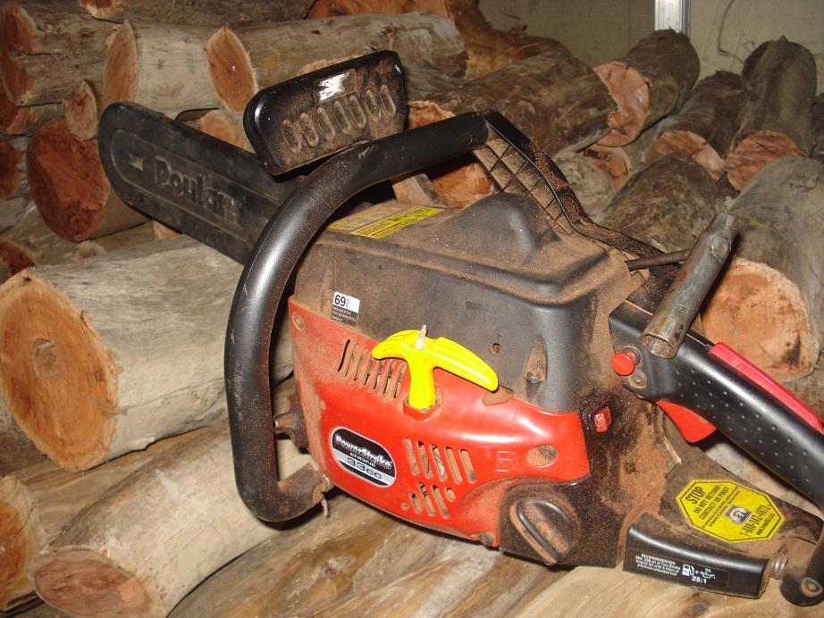

A couple of the guys I have been speaking to on the phone have asked about my saw I have been using So here she be.
Story goes, my wife was sick of me being lazy and paying somone to drop off a load of wood pre done, it was cutting deep into the shopping money and then one weekend about 8 months ago she brings this home from a garage sale for $50.
Initial testing and inspection netted a few minor problems:
- It was gutless
- It couldnt cut straight to save its life
- The clutch cover was leaking all the oil out when it was running.
- Wouldnt start when hot.
So after testing I did the following.
- Throw the spark arrestor mesh in the bin.
- Replace the chinese spark plug with a NGK variant
- Richen up idle circuit
- Flip the little metal thingy that goes between the bar anc chain cover over. (no more oil leaks)
- Throw out the crap OEM chain and put on a genuine stihl unit.
- Blow the air filter out with my little air compressor ( cheers Grumpy)
Since then the only problem I have had is the start rope snapped. It is a great little saw and has cut a lot of wood, we have had the fire going since april and this unit has cut all the wood so far, all I have to do is roughly run over the chain with a file then go to town against anything, I mainly burn orange trees or in the colder months I use redgum.
Now some pics......

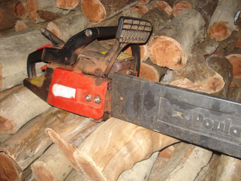

Cutting in a curve always means a blunt chain, Joe (blunter on one side than the other), but I'm sure you know that. If you keep the chain sharp it should cut well, but if you let it get blunt it burns the chrome off the teeth well back from the cutting edges, and from then on it won't hold an edge until you grind or file the edges right back to where the chrome has retreated to. That is especially a problem when you cut hard wood like redgum, a blunt blade runs really hot on that stuff. It is a bad idea to keep cutting when the saw stops being really sharp. Congratulations on never hitting dirt with it - I could never achieve that, cutting up fallen rotten trees. Could easily sharpen the saw three times in an hour's cutting, in that situation.

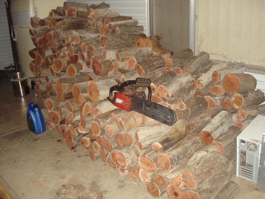

So its well into that time of year again, this year I managed to get a little bench sharpener from a garage sale for $5, its sort of like a compund mitre saw but tiny and has an abrasive disc.
With the proper sharpener I can get two decent sized loads of wood out of one chain rather than have to swap halfway through.
The saw itself, has been pushed very very hard this year, compression is down a bit from what I remember, but so far we have hauled in 9 loads of wood (approz 700kg a load) I gave it another proper service after 2 loads this year and noticed that I had flogged it hard enough the carbon on the piston appeared to be flaking off, there has never been a shortage of oil in the fuel but its had some decent runs at wide open throttle.
The little sharpener I got takes so little off the chain and leaves a razors edge, it needs to be shortened but will probably get another year out of the shortened chain.
I have to haul another load tomorrow and we'll see the size of what I pull in smile
