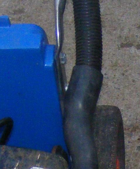

hi again . does anyone know what type of inlet setup this should have ? it seems to be half n half now , top part is newer type convoluted snorkel and been cutnshut at the bottom i think ? on the search for correct parts now as it seems to be a little different . or do the standard older vc160 parts / full rubber type snorkle fit ok thanks Dave [Linked Image]
and more pic's of it soon , ready to paint now just waiting for time .. cheers

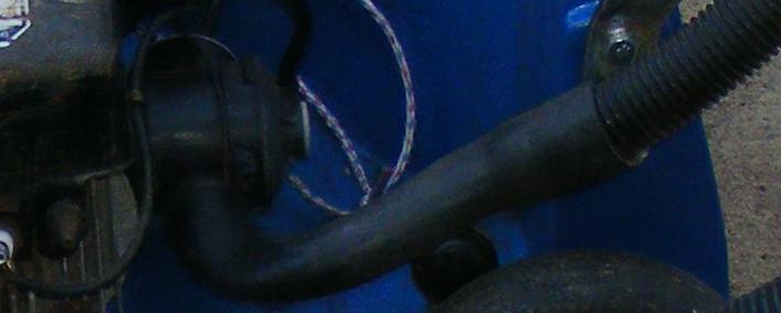

Acually that fella would originally have a 2-part setup, just not like that.
Although this one is slightly kinked from the throttle box being ositioned to hight it shows the setup correctly.

AAAAH thank you for that , saves me a lot of time looking for the right one . i didnt think they came with pvc in the middle ! but thought it might have had full rubber instead . seemed a tad old for the later plastic type but the air cleaner still has a pointy cap but looks too new confused for the condition of the rest of the machine . thanks Dave

No worries mate!
The full rubber hose was phased out along with the Alloy G3 Carby, plastic hoses have been used from the start with the plastic G4 and later LM carbies.

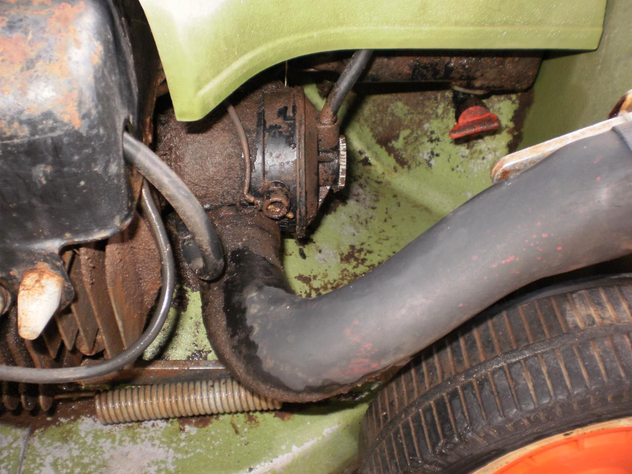

another of the vc , i hope oneday i can get the colour needed should look ok i think . lucky it isnt a full cowl job ! [Linked Image]

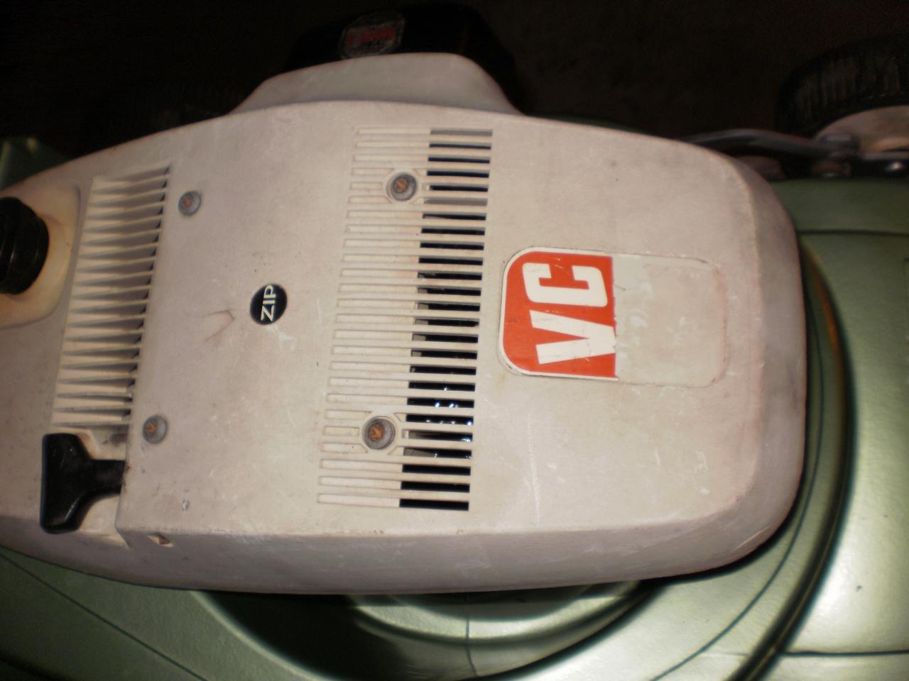

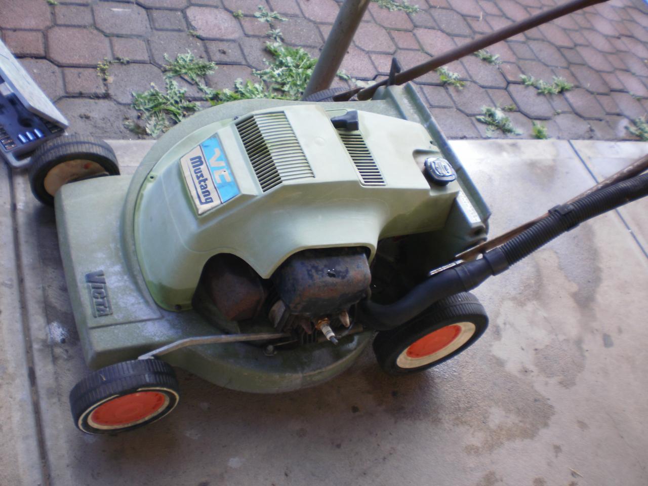

a little bright huh eek . and another couple i found today at a garage sale , maybe the mustang is the covered versoin of the old vc ? and someone has cut the ht' lead on the corvette but he said it did run not long ago ?! [Linked Image]
it has no primer i can see on the mustang , normal for these ? and i think i saw someone was looking for a purple vc ? this guy has a higharch and i think it was a lowarch too , one of each and a catcher but didnt seen to fit either ! anyone remember who it was ? sorry i dont have a pic of it though .. thanks Dave

The Corvette is a 1967-1968 “V40” 160cc Corvette 2 (yours is 1967), what’s really interesting about the one you have is the carby (They used a few on that model, it was an experimental time) what you have there is the Victa 3Q carby, which is quite a unique, and hard to find carby.
It’s non-governed like the early 3F/3L/3S carbies, however it uses a plastic cap and slide, a revised venturi and jet set up, and a new float system (with top screw bowl)
It was only used sporadically from 1977 to 1979 and due to this it is quite a tricky carby to track down.
I’ll get some pictures together of the catcher and wheels for this mower, and see if I have any here, is there anything else missing?
As for the mustang, it’s indeed a relative of your “Mustang S” the green one with the full dress cowl is the standard style of Mustang, used on all mustangs (except the s) from 1973 to 1980.
The one you have there is second generation (“V206”, 1974-1978) and yes many of these did not have a primer, others had a remote primer, and later, on the third series (“WA 174 A8” 1978-1980) a slot was made in the far side of the dress cowl, to accommodate the air hose, and the carby was turned around and given a normal primer face (White)
Yours would likely have a grey “no prime” face, which has a small, angled vent instead, although it could have a remote primer face (also grey) which would indicate it may have once had the remote primer.
However, there is no sign of the mount for a remote primer in your pic’s, so I would guess it did not have a primer at all, which to me suggests it’s a little earlier in the run, say 74-76.

thanks ty , a little more looking tonight at the corvette (been soaking in diesel rags to get the crud off ) and yes it does have a plastic top and slide on the carb now i can see it ! a cover on the side sort... of utility style only thing missing is the catcher i think ? and the top cowl is broken where it bolts to the head but all pieces are there though so it can be repaired . a square ish type of muffler too but odd looking torpedo sort of ???? the mustang i cant find a hole where the primer would be bolted and the throttle is reeeeeeeeeeealy notchy too , but its waiting now keen on hearing the old 'vette run woot thanks again ty, your such a help

The cover on the side of the corvette is an edge cover, it's designed to let you get the blades right up to the fence.

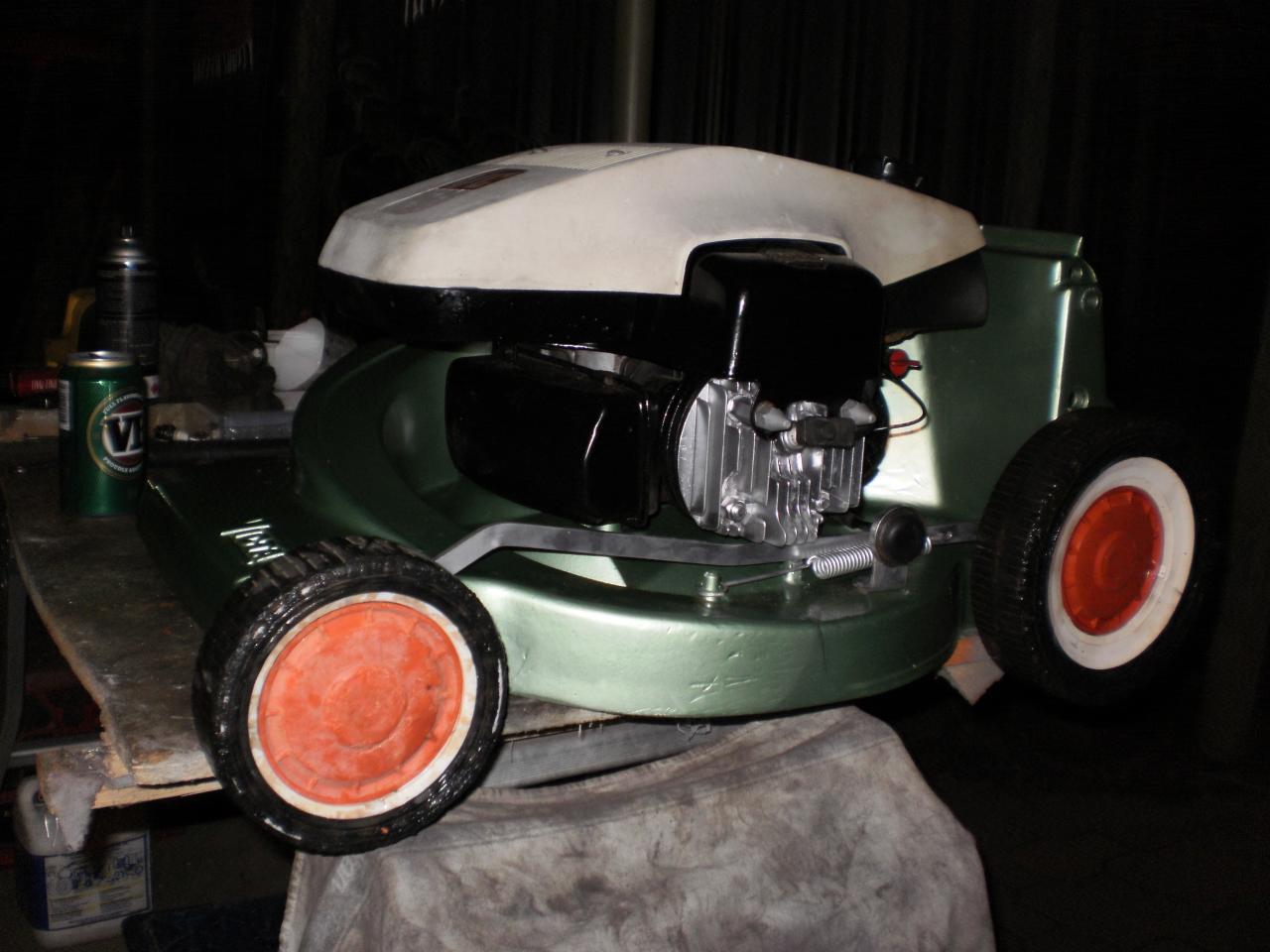

a little more on the vc"S" still trying to find some parts though , better wheels new stickers maybe a better top cowl one day ! but so far so good . sure looks better than when it got here [Linked Image]
should have filled the scratches in the side i think ? i will know better next time now blush but seems ok , camera makes 'em worse than they look in daylight . cheers , Dave
