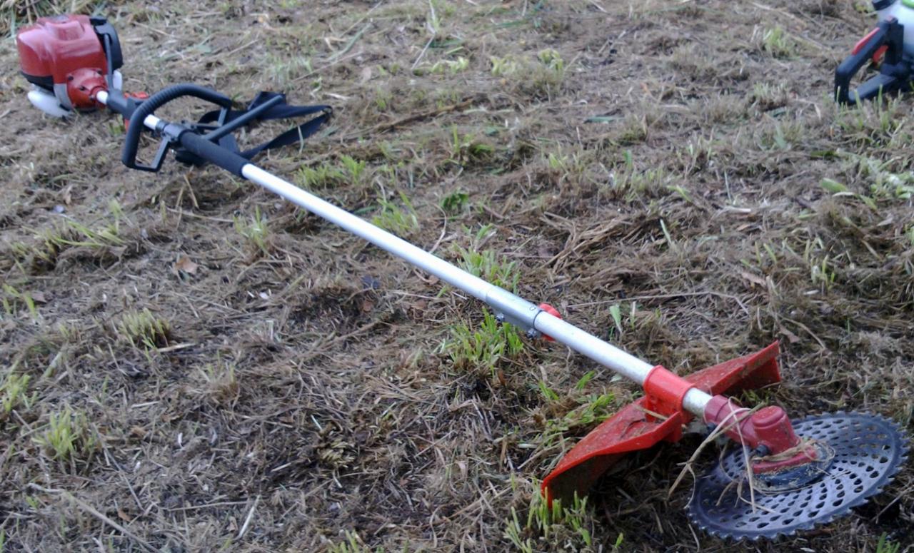

I'm doing some clearing work for a friend, she just bought a property out at Collector which has been neglected for over 40 years, and has grass up to the shoulders to prove it, as well as shrubs and blackberry bushes!

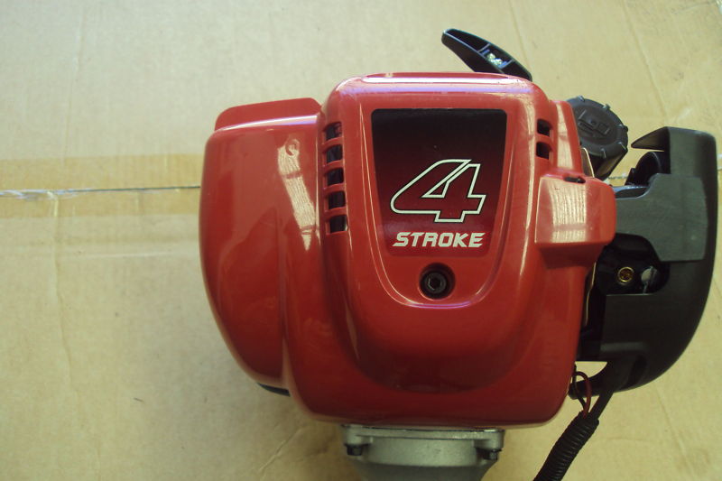

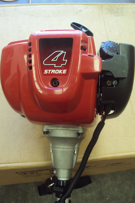

For the Job she bought A Honda powered brush cutter off ebay, with pole saw and hedge trimmer, and some 40 tooth Carbide tip blades.
So far I have been pretty bloody amazed with the machine, there has been nothing it has not been able to eat straight through, even small trees (2" stump) and knocking down the old grass has been like running it through butter!

So far I can say I have been exceptionally impressed with the Honda 4-stroke brush cutter, the Husqvarna 359 Chainsaw, and the Carbide tip brush cutter blades, as well as the 1976 Victa 2-stroke Utility (but I was already aware of how much it could take on)

The Honda has been quite good as a pole saw, only had the chain come off once, and that was my own fault for forgetting to watch the tension during the initial "Stretch In" period.
Apart from that, it's been good, helped a lot with the higher blackberry sections, and vines, and on top of that, it helped me take down a 3" tree that I could not get to easily with the chainsaw (needed to be taken out that day, but with little light left there was no time for the necessary limbing, so I poked the pole saw through, and did it that way!)
The ROK Hedge trimmer is still impressing me, it's done a good 6 hours of work now, well and truly above its paygrade, and far outside it's specs, and is still going strong, my biggest issue with it is the cut of switch, it's in a place that is easy to hit by mistake while working, apart from that there's just the soft guard tines that need reshaping here and there, which is no big fuss.
I'm growing more concerned with the Ozito chainsaw however, I think it may need some work tomorrow night to modify the tensioner, and overcome the slacking issue (quick google search reveals this as a common issue) apart form the tensioner playing up, it's running fine!
The Honda has been the star of the show so far, easiest to start, and very good on the power, combined with the carbide tip 40T blades, there's not really anything it can't get through, it's taking on the 1m+ grass as if it wasn't there, and the blackberry's are no match what so ever!
I have a spare GX35 engine I got some time ago from Redeye, which I lan to get up and running and fit to the backpack brush cutter Gizmo1993 gave me, as I find the Honda really low on vibration, which is my biggest issue with the backpack brush cutter.
Most area's of general scrub are slashed down easily with the Honda/carbide mix, then I swap to line head to get it down lower and tidier, and finally it gets a quick run over with the Utility to even things up (the line head also helps prep for the mower by exposing bricks)

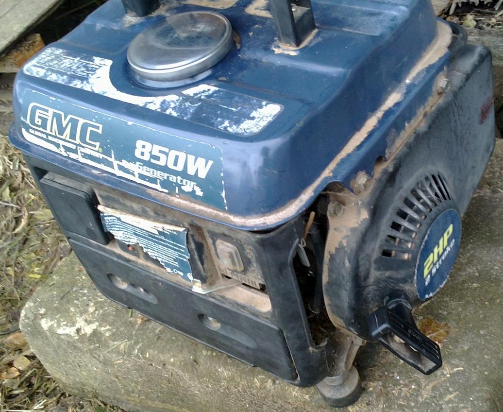

The GMC generator has died, I have a feeling it may have swallowed some dust at some point, and has a blocked jet, it's a temprimental little one, and takes alot of choke fiddling to warm up, however once it's going it's gennerally quite good provided you use something above 150W and of corse below 850W, if you use something on it with low wattage (such as the 55W Black and Decker 'Mouse' Sander) the mechanical governing system struggles to register it. Once I have it back online, I will report back.

Ty if you have any intent of fixing the GMC generator let me know i have a homelite with the same engine that would be good to use as parts for the gmc.

If you could spare the Homelite, that would be great, just send a PM with whatever you would like for it, and we will work it out!

Ive heard those hondas are a good thing, just no good for edging, extended running them on the side starves them for oil and they die.

i've heard the honda motors mounted on the atom edgers have a fairly big problem with not getting oil.

The honda engine I have spare came from an atom edger, so hopefully it does not have damage from oil issues!!!

Yeah I hope that spare engine doesn't have scoring on the cylinder walls..... A 4stroke on an Atom just sounds like your asking for trouble...
