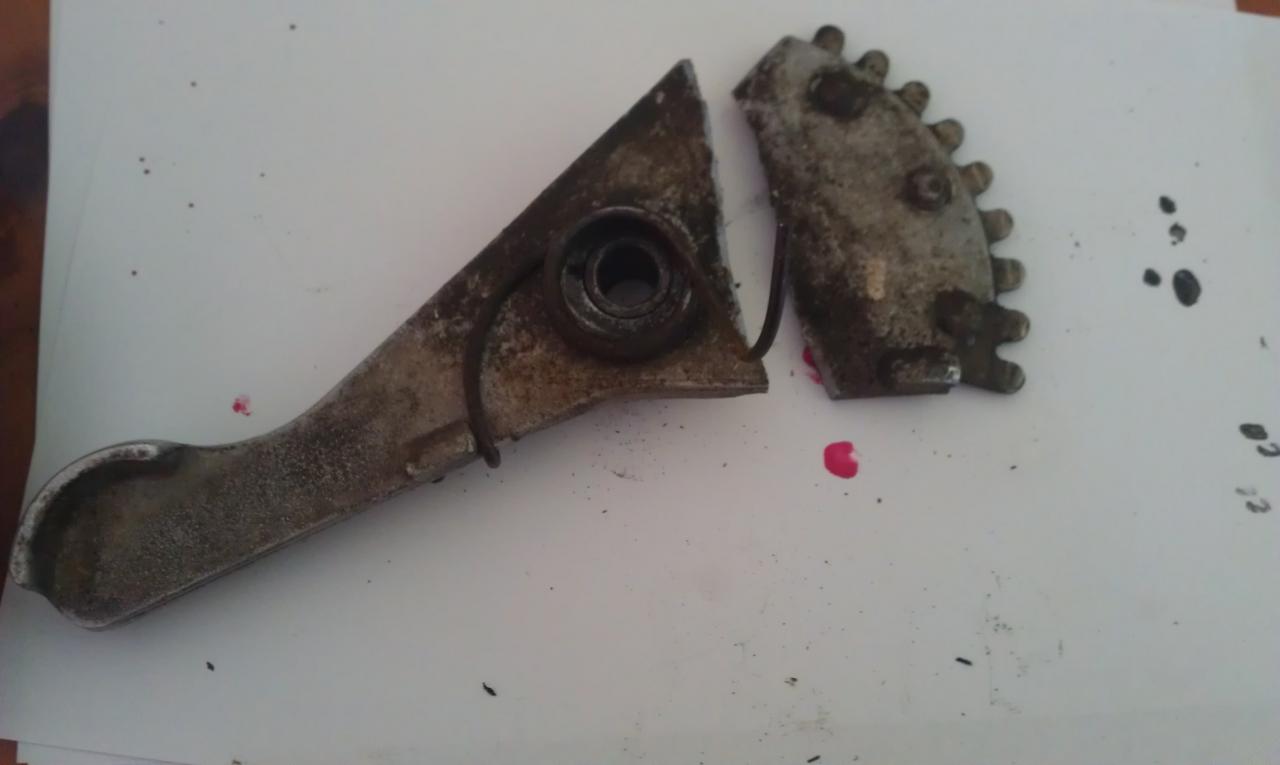

I picked up a Atco 1454 lawn mower,Got it started today after changing the spark plug and cleaning out the cab,but just after it started the kick start lever snapped,any one know where I can get one on the cheap.Also where I can get a new spark plug cable and the coil that it plugs in to.

I would suggest that you get it welded by someone that does alloy welding otherwise you will just hunt around as that part is hard to get hold of second hand and on the cheap. cheers2
Welding is the easiest fix. If you want to start a home business of extremely low volume, after it is welded, take it to a good jobbing foundry and get them to sand-cast half a dozen, using your repaired one as a pattern. If the foundryman is any good he should be able to cast the teeth, from memory I think they may have been sand-cast in the first place. You could have them cast in either aluminium or iron. I think I'd prefer iron, since there seem to be a few of them around that are either broken or have lost their teeth.

Thanks for those pics Mick. I hadn't realised that there is a steel gear sector riveted onto the aluminium pedal, I had always thought the teeth were part of the aluminium casting.
I have the impression that is a sought-after item: one of the key parts needed in restoration, and one of the most frequently broken ones.
