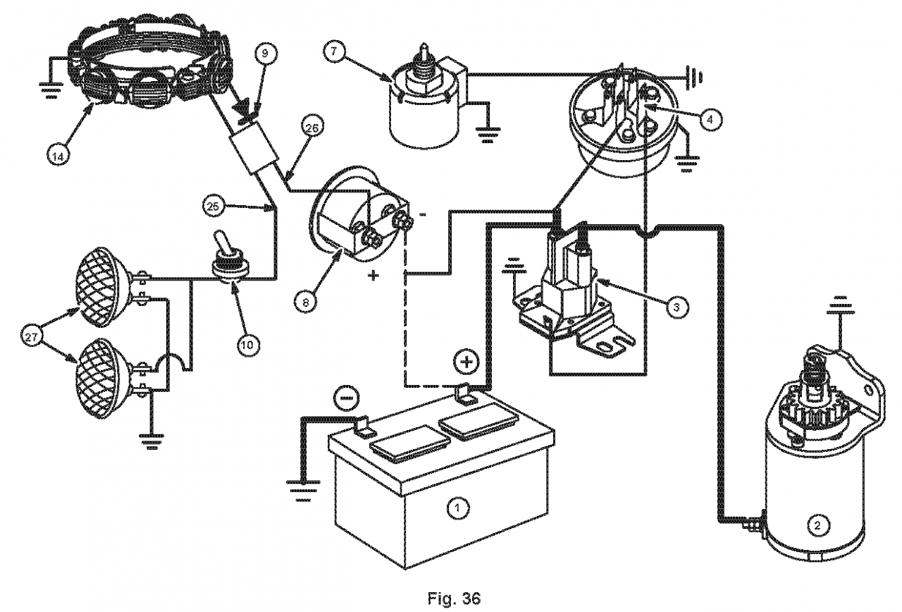

hi all , chasing a wiring schmatic for an elec start briggs 12hp I/C (281707-0128), Got some basic info from briggs-dioded wire and earth to charge ,but really need diagram showing keyed start, battery and relay if needed
It sounds as if you may need Figures 36-44 in the Briggs Single Cylinder L-Head tech manual, beginning on page 269. These cover wiring for either 5 or 6 terminal ignition switches supplied by Briggs and Stratton. This is Figure 36:

great diagram thanks Grumpy
