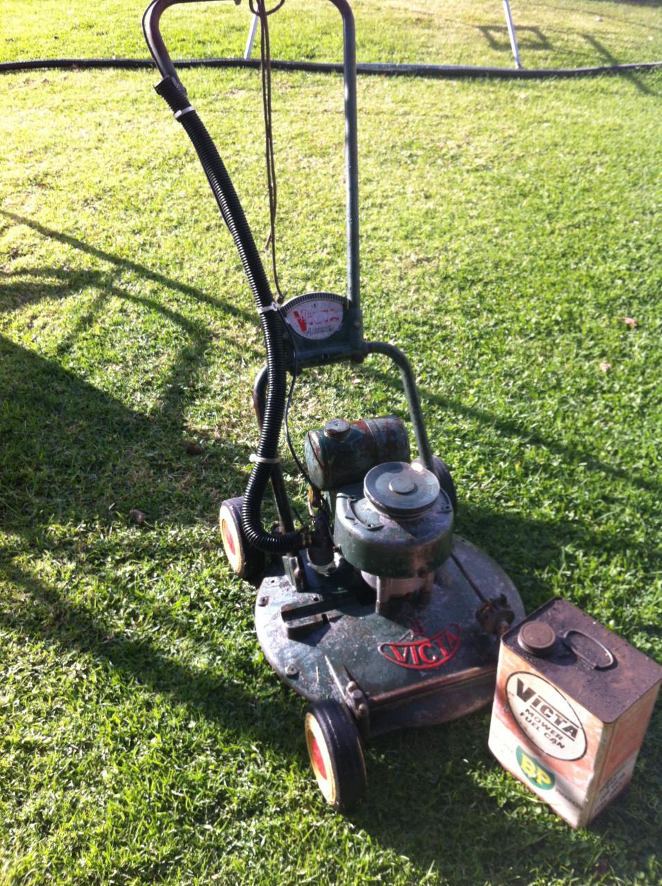

so from what I can gather from the little bit of info i've found on the net it's a victa 5??? with a seriel number of
I AAA
18423
can any1 help me figure out what type of victa I have please smile

Hi helpwithmy victa, and a warm welcome to the forum. We all like to learn new things and tinker here. grin
Re: your model ID, you are correct with your assumption, yours is a Model 5 Special...and is the 3rd of the model line out of 5 different bases manufactured for the Model 5 including the store brand, that was without the Victa logo.
Yours is a fairly late machine that has the edger slot, 2 side skirt holes, and no "Predicta Automatic" extensions on the height adjusters. The number and letters in front of your engine n umber supports this. wink

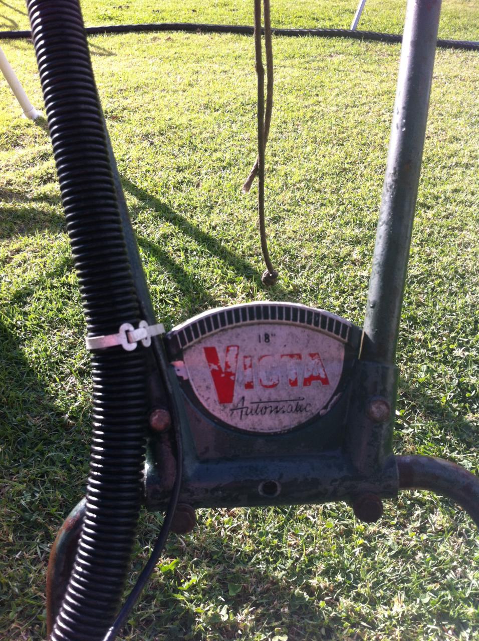

thank you for that it does have automatic on the name plate, we were looking at selling it but were not sure of it's value do u have any idea on what price we should b looking at selling it for???
Hi again, are you looking at selling the Automatic badge or the mower complete?....
Can you please give us a close-up pic of the badge.
Condition affects the price of these badges. wink
Thanks. grin

looking at selling the whole thing well at least finding out how much it is worth hubby is sitting on the fence between restore and sell lol
I have seen this on ebay, the automatic badge is not original, the air hose is from a late model victa, the chokes missing, not running I have seen similar ones go for $30-80 running they seem to go between $60-$120 or thereabout in that condition, occasionally you get some people bidding who havent really researched prices and it goes a lot higher lol
Thanks Joe...that pretty well sums it up, it all depends on condition,and how much someone is willing to pay for it.
That badge is from a Model 4 Automatic....this machine should have the Special badge on it, like this...
However, someone that is restoring a Model 4 may purchase yours just for the badge. wink

hmmmm.....little dissapointed maybe better to pull apart and sell parts:( it was ours on ebay and then some1 messaged us and told us it was worth alot more than we had on it so we removed and dcided to find out more b4 we ripped ourselves off....do u think it may b worth more as parts than a whole???
Hi helpwithmy victa.Just a little correction I know it doesn't change the value of it.It isn't the 3rd model it's the 2nd version of the model 5,but going form the engine number I'd say it's been changed.That number sounds more like a later model.As far as it's worth.Not a real lot.What I would do is take off the badge and sell it separately.You may get somewhere from $80 upwards for the badge.As they are not easy to come by.They did come on both the model 4 automatic and the model 4 standard,but still there are not a lot of them left.As for the value of the mower itself.It's hard to say,I've never paid more the $40 for one as there are plenty of them still left around.All you can do is try after all it's only worth as much as what somebody will pay for it.The market for them at the moment is down.I've seen heaps on eBay that just don't sell.All you can do is try,after all,all you need is 2 people to get into a bidding war and away it goes.

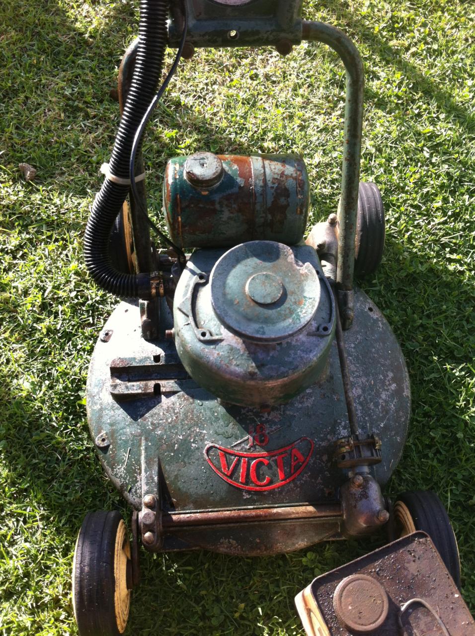

Hi Jeffrey, just for clarification, I put this machine as the 3rd version, you put it as 2nd....Jeffrey, this is how I rate them, please tell me where I am going wrong... wink
(1) 1st Model 5.....used original Model 4 base, 4 side skirt holes (2 on each side), edger slot, height adjuster extensions, (in other words a carry over from the Model 4 Standard, but with the Model 5 Special badge, using up the stock of parts that existed at the time.)
(2) 2nd Model 5....2 side skirt holes (right hand side only), edger slot, retained the height adjuster extensions.
(3) 3rd Model 5.....2 side skirt holes (right hand side only), edger slot, no height adjuster extensions.
(4) 4th Model 5.....No side skirt holes, no edger slot, no extensions.
Store brand....no Victa logo, different colour.(pseudo 5th Model)
Using my method, it places this machine as the 3rd version....Comments please, as this is how we learn new things here wink
Hi once again, the badge alone is rare....and collectable as they are made of alloy....this can fetch considerable $$ on eBay...the wheels may be of value to a collector...but since there are repo's available probably not as much...it all depends on what a person is willing to pay. wink

just one more question.....i can't work out why any1 would put a different badge on it and the colour all seems to b the same as the frame is it possible that it was a model 4 and the engine has just been replaced due to blowing up or dying??? from what i can gather where it came from was possible a old mans shed as all the other stuff they were selling seems to be from around the same era and it's a young fella selling it might have been a family members deceased estate i'm not sure but it looks to b that way.

i'm confused Deejay as mine has 3 holes 2 on one side and 1 on the other...
Hi helpwithmy victa, how the badge come to be there is a mystery....but a lucky outcome for you as they are a highly collectible item. wink
Your machine is definitely not a Model 4, it does not have the axle cover or height elevator extensions for the "Predicta" flaps used on the Automatic, or the screw holes on the left hand side for the side safety rim guards that were fitted to all Autos, and a completely different base to the Standard 18 which had a 'safety ring' instead of the rim guards. wink

UPDATE....that hole in front of the right hand rear wheel in definitely not original....the original screw holes for the safety rim guards were on a small raised platform ..the same as the ones on the right hand side near the edger slot. wink
BTW, all Autos came with a recoil starter.
