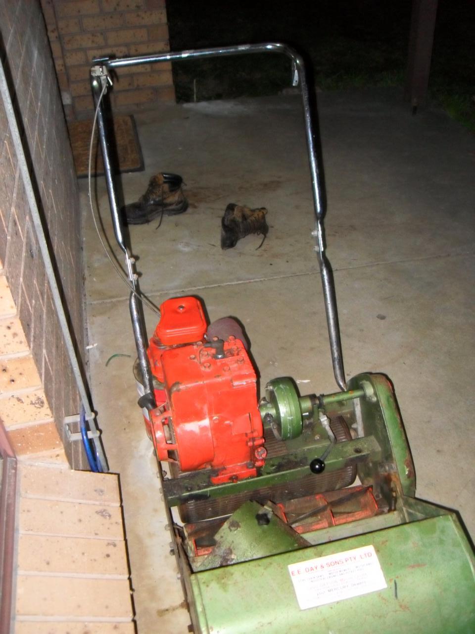

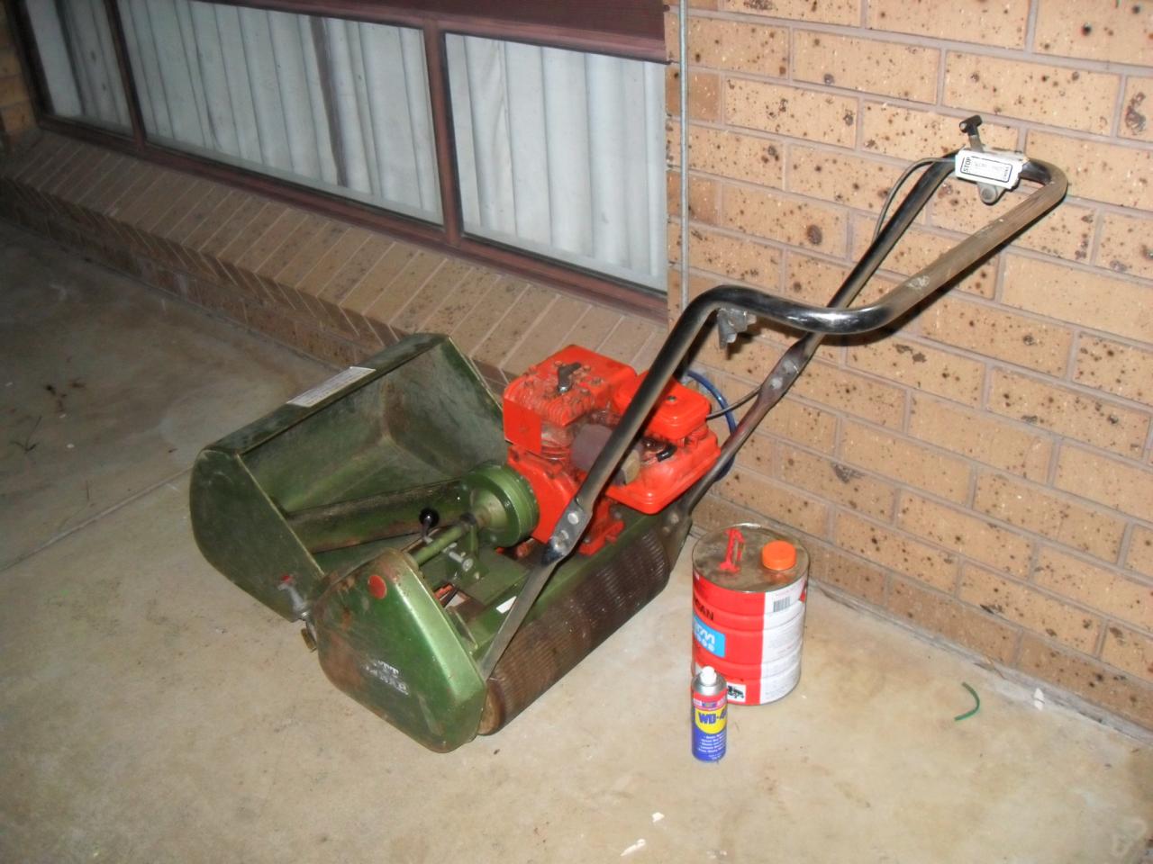

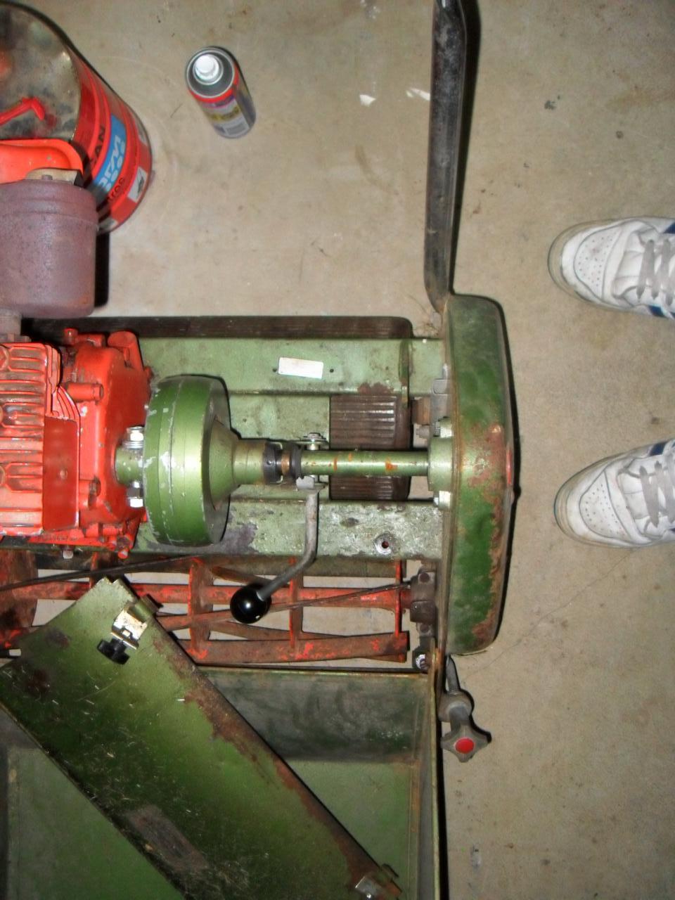

Hey there all, New to the forums and new to the delicate world of Scott Bonnar laugh. I was lucky enough to pick up a machine for $90 but have a couple of questions. Firstly this thing hammers, when i engaged the clutch with the lever i have to just about run behind it to keep up. Strange thing this is happening with the throttle right down and i have no real idea how to slow it!
Also ive been having a look at as many pictures as i can and have found that the mower i have dosnt have the clutch lever or cable attached to the handle bars, i was wondering if that could be an answer to my problem?
Thanks for your help in advance, I've posted some pictures Hoping this helps...

From my observations, I have noted the following;
(1) What you have there is a genuine Scott Bonnar Model 45, 17" machine and from the pics, is a fairly late model.
(2) The original Scott Bonnar ID plate, normally affixed to the rear rail of the engine deck has been removed...you will notice the 2 holes where the plate was originally riveted. This plate carried the model number and the mower number....This removal is unusual....
(3) The handle bars are not from this model of machine; they are from a Scott Bonnar Lawn King, a very early model of SB 45, painted in a hammertone cobalt blue colour.
(4) The inner cutter clutch housing is suffering from "Tenants Improvements" (the previous owner) and has been radically modified; I think a hole has been drilled through the cutter clutch housing and perhaps right through the engine shaft, and a crazy nut and bolt set-up fitted frown It should contain a captive cotter pin.
(5) The cylinder reel looks in great nick....maybe never re-ground....but it will need re-sharpening, as will the bottom blade. At that time you will need to remove the cylinder reel and sole plate complete with the bottom blade (bed-knife)and take both to the engineer who will do the grind for you....See this thread....Click HERE
(6) Considering the overall condition of the machine, at the time of the reel and bed-knife sharpening, you might consider replacing the reel bearings, as they are critical to achieving perfect reel to bed-knife clearance adjustment when the assembly is re-installed. wink
(7) You are correct, the roller clutch handle, cable and associated assembly is missing, as you guessed is causing the over-speed problem...these parts can be easily sourced and fitted...the condition of the roller clutch will have to be ascertained at the same time...but may be perfectly serviceable....hopefully. wink
To enable us to assist you further, can you please post the complete string of numbers stamped into the air cowling of the Briggs engine. From these numbers we can tell you the date of manufacture of the engine, and grumpy, our resident Briggs and Stratton guru, will be able to give you advice on getting the engine purring like a kitten! grin

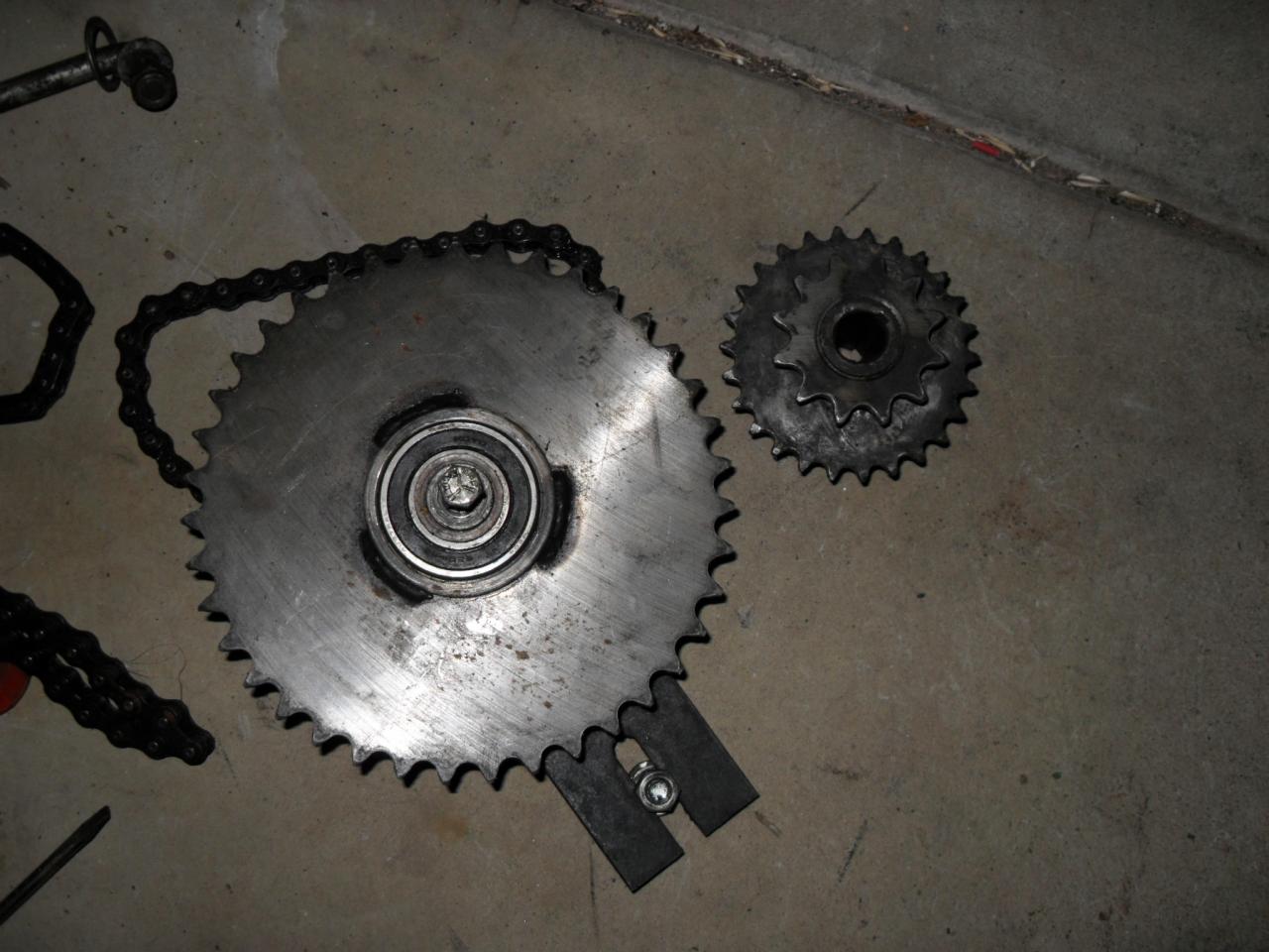

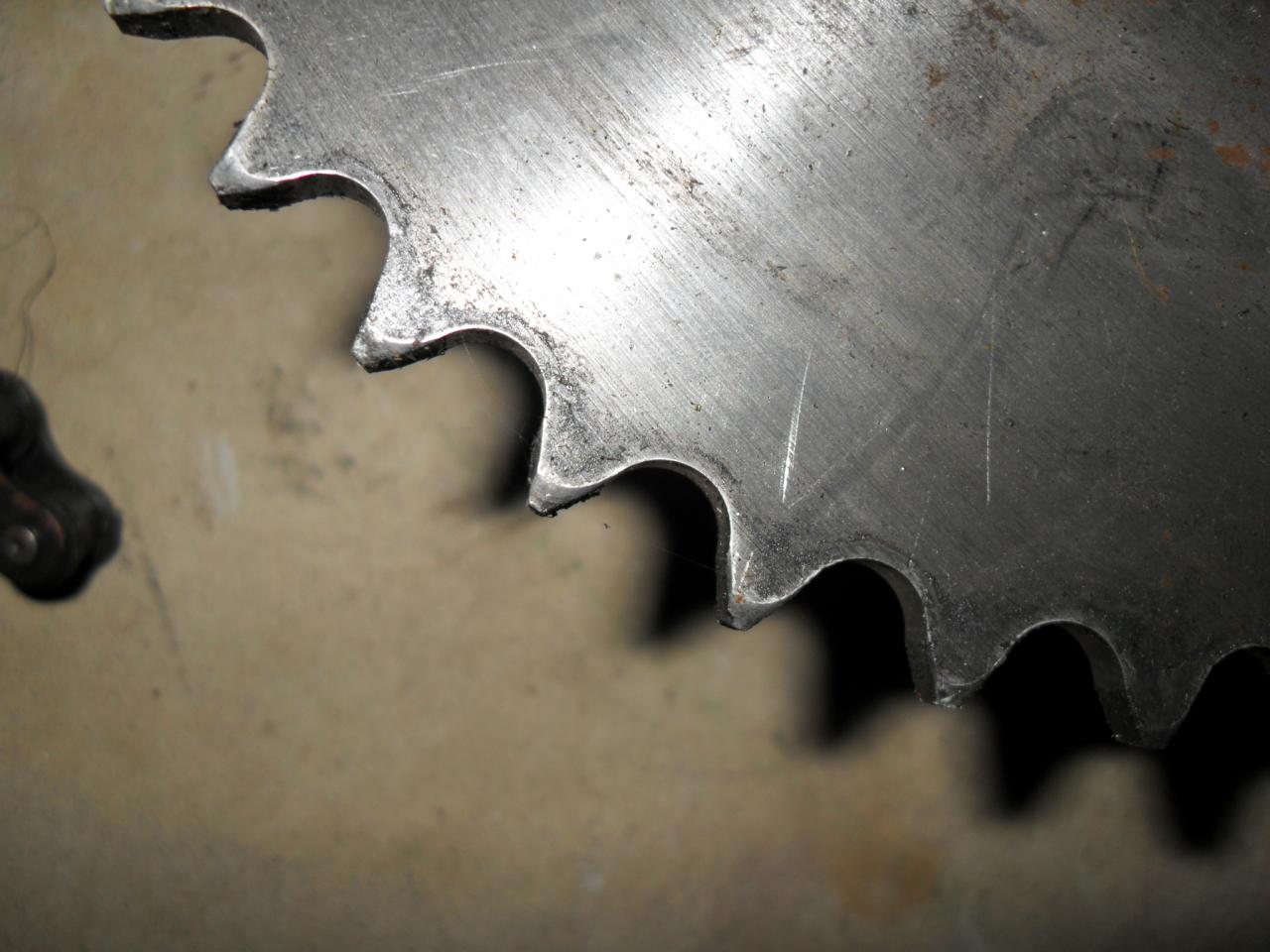

Can you please also remove the chain-case cover on the left-hand side of the machine, and take some close-up pics of all the sprockets...particularly where it is not covered by the chain....from this we will be able to advise on the sprocket and chain condition.

Thanks so much for your help so far, The id plate was replaced for some reason with a stickered version, and i wiped it to see the numbers better and must have wiped the dirt that was making the numbers visible lol so i cant see what it said at all now!
I thought so about the handle bars they threw me at first but then i when you replied it made a bit more sense, im currently chasing down another set in pretty good condition.
I'm not sure what to do with the clutch? It seems to be working fine, but if its going to cause more harm than good i guess im forced to fix it.

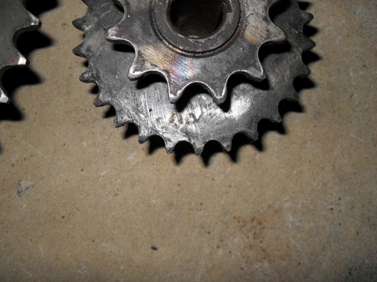

Here are the pictures as requested, im currently pulling the 45 apart for a good clean, re-paint and replacement of all the rusty,stripped,crossed threaded bolts and nuts that are throughout the mower!
Thanks again, Daniel
Those sprockets are fairly worn, but not as bad as many we see. Whatever you do, don't replace a chain or sprockets without replacing the mating parts: replace a set of meshing parts or keep using the old ones. If you clean your chains properly, then keep them clean and oiled, in normal suburban mowing you may get a number of years out of those sprockets and chains. Just remember, degrease and re-lubricate the chains regularly. When you can see or feel just a bit of grittiness on the inside of the chaincase cover, it is time to service the chains again. By keeping the inside of the chaincase as clean as the chains, it is easier to tell when some grit has got in. By persevering with those fairly worn ones, you can learn good maintenance habits without risking an expensive set of new parts.

Re: the sprockets, as a Model 45 owner myself, I feel replacing them at this time would be over-kill, mine are over 34 years old and have never been replaced...admittedly there is some wear...but not causing any probs at the moment....save your penny's and replace them down the track...Just keep the dirt out, and grease regularly...Yours are particularly in good nick for their age! wink

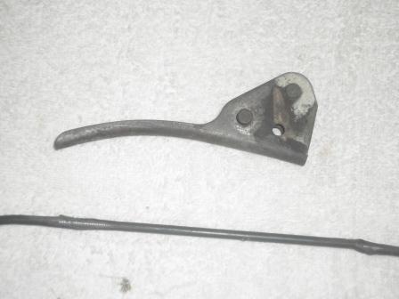

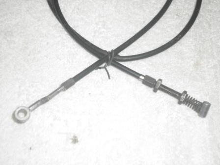

Please see attached pix of parts which are available.
Handle comes with the two pins and clips. One to attach cable with and the other is the pivot pin.
The clutch cable is complete, although has some damage to the rubber outer casing. It is still fully functional and could be patched up with some electrical tape or heat shrink. You can see the damage to the black casing in the first pix. The cable is still straight and not kinked.
Price $15 which includes postage. Brought these as spares for my old mower and the new one has cables, which are like new. Selling for what I paid for them.
