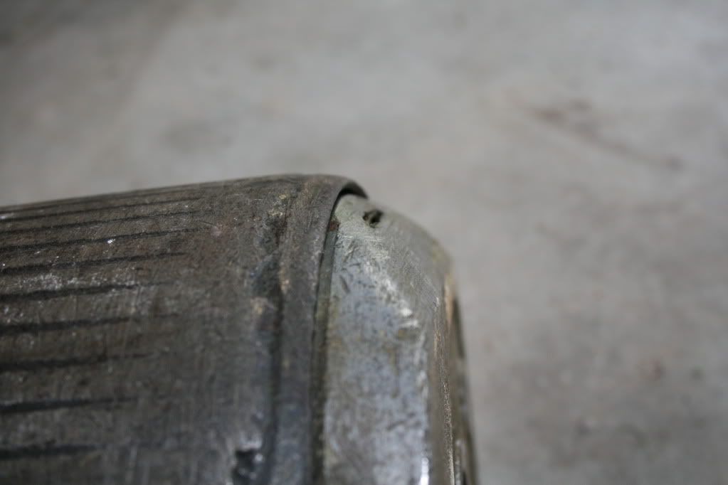

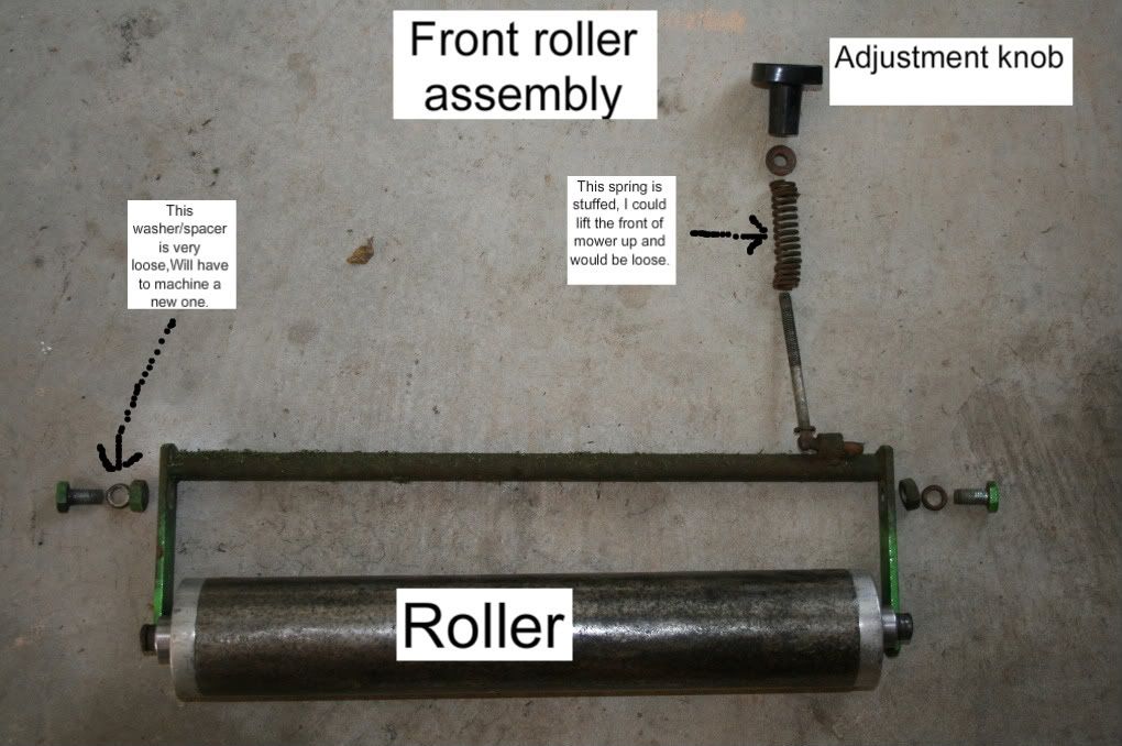

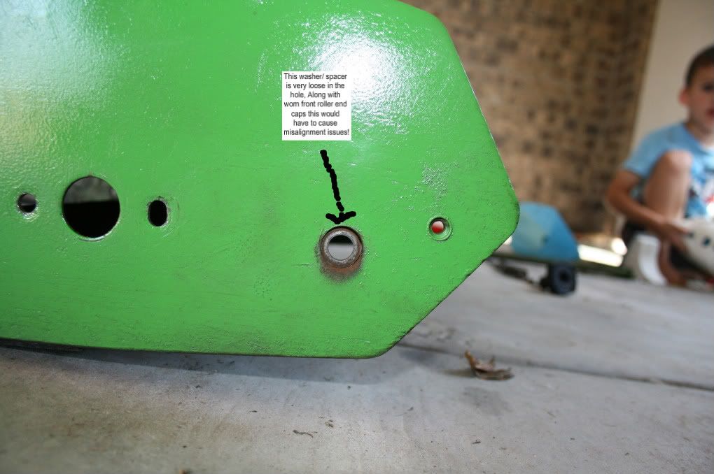

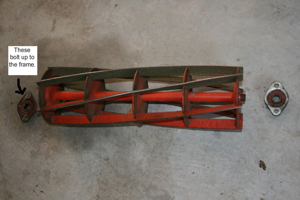

I pulled apart my SB430 so I can get the reel,bedknife sharpened. I pulled apart the front roller assembly and it has pretty bad wear. Could have caused the alignment problems i have been having. The rear roller has no adjustment. Thought I would post some pic's so poeple can get an understanding how its setup..

Hasnt got the fine adjustment screws like Model 45's. As you can see its harder to adjust the reel, bedknife. cheers2
Hi Jason, thanks for posting the pics, it gives us a clearer picture of what is happening in the front end of a Diplomat....I think that you might have found the cause of the misalignment....not just the end caps (as I suspected) but in the assembly itself.. wink
I now know the reason that a lot of dealer workshops don't like doing the reel/bedknife adjustments....there is no fine tuning....In my opinion, Scott Bonnar really lost the plot with this method. frown
I don't think reel adjustment needs to be difficult, Deejay. You can just put a piece of 0.002" brass shim in between reel and bedknife at each end, press the reel against the bedknife, and tighten the screws. Then rotate the reel to remove the shims. You will probably ruin the pieces of brass shim each time but it wouldn't hurt the steel reel and bedknife, and the pieces of shim can be quite small - perhaps 1 cm square. This is very similar to the procedure for adjusting the clearance between coil and flywheel.
That seems easy grumpy, but you would have to agree that the bearings would have to be in perfect condition, and the reel perfectly square to the bedknife which in itself would have to be true and aligned correctly to achieve the desired result....plus you can't work from the front on a Diplomat as you can on a SB45....because of the rear grass throw design... wink

What I didnt really mention properly is when I lift the front of the mower up the roller was all sloppy and loose. Like that spring is no good. The SB45 I had done it too.
Thanks for that idea grumpy I will try that! I'm getting the blades done so I will soon find out how hard it is to align. Just read a "toro university basics to reel mowers" PDF file off google. I enjoyed reading it very interesting! wink

Heres anather error with SB430..
[Linked Image from i304.photobucket.com]
It really becomes a problem when you mow long grass if you keep the lawn short its ok. Its worn though the housing I cant weld cause its diecast so epoxy might be the go.

Deejay, I think you only need the two reel bearings to both be in the same condition rather than perfect condition, and you have to be consistent between the two as to whether you push them down or lift them up to take up the clearance. If they are a bit worn, you might use a thicker shim than 0.002" (or better still, replace the bearings), to make sure the reel does not contact the bedknife. Obviously you also have to check that the bedknife is square to the frame, with the usual alignment tool, to get even cutting depth across the mower. Since you adjust clearance by moving the bedknife, if you find the knife is out of square to the mower frame when it has even clearance to the reel, you have to move one side of the reel with the slotted adjustment on one of the reel bearings, but that should be a once-and-for all alignment adjustment until the next time you have the reel ground. I think by the second or third time you did it the process would not be much harder than adjusting an SB45, but I agree you would not get quite such a precise adjustment by using a shim as you can get by feel. However, remember that John Deere recommends the shim method for their greens mowers.
Jason are you sure that roller-end is zinc, not aluminium? From the look of it it could be either. Epoxy will work on either one, but there should be a more permanent solution.

The soleplate is not adjustable other than on a pivot, so if it's not aligned with the frame, the bottom plate needs reground.
The cutter is fixed at one end and adjustable at the other.
Lets assume the bottom plate and cutter are perfectly ground.
You loosen back the 2 lock bolts and 2 swivel bolts on the soleplate and swivel it into within 0.002" of the left hand side of the cutter (pulley side)
When done tighten the 4 bolts.
You then loosen the 2 bolts on the non pulley side of the cutter and adjust the cutter to within 0.002" of that side of the bottom plate.
Tighten the 2 bolts and check.
In practice it's quite easy

Any movement at the front end is probably coming from elongated holes in the front roller arm assembly where the roller shaft goes through.

Grumby, From what I can gather it looks like the rear roller end is diecast. I've tryed welding diecast before it just burns up. It's like the two piece clutch diecast thing ( the one that stops the blades) that the SB45 has. They crack and all you can do is replace it.

When people say "diecast" they usually mean diecast zinc, but the two metals most commonly cast in a permanent mould (i.e. die) are zinc and aluminium. (For some mysterious reason Americans call zinc "potmetal".) The two metals look rather similar, but act differently. Zinc can't be welded, but can be soldered, with special solder and flux. Aluminium can be welded, with argon-arc equipment (Americans use helium instead of argon), and in a limited fashion can be soldered with a really special solder covered with an even more special flux. I think your roller-ends are probably aluminium, but can't tell from the picture. So, it may be that filling the hole with body-filler is the most practical solution available to you, unless you know someone with the right welding gear.

I didn't do anything to the front roller assembly and its still leaving lines so might try replacingspring in front in the assembly to help firm it all up. The front jumps up and down on the bumps I try to slow the revs down but these damn diplomats go a bit fast I think. Motor doesn't like going slow either..

I replaced the front roller spring, I didn't realise that when I started mowing the height adjustment was slowly coming loose so the lawn got a nasty crew cut. But its come good now I just fitted a longer spring.
