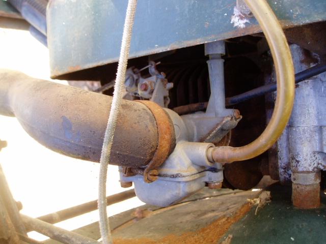

I'm not so sure it was a G3,it took the same carby as what my Cortina 2 has.Which is more like the 3L carby.Sorry this is the best picture I have at the moment.
You can clearly see it isn't a G3.

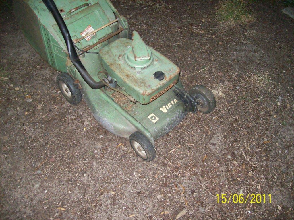

I'll have to get some more pics of it on here. I must admit that I have done anything to it except a quick clean with the Gerni. I know it's been repainted, but would that green be right? It's still got the decals under the paint too.
You've got me all excited now, might have to see what I can do with it before the Engine Rally at Easter!

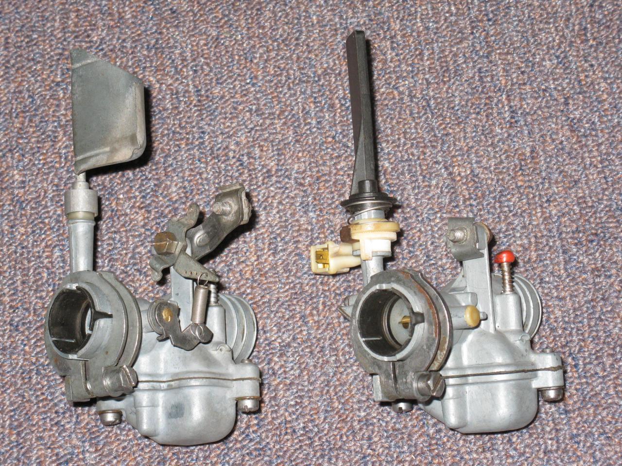

Here's some more pics of it. Slow and tedious getting the paint of the decals with as little damage as possible though.[Linked Image]
Alloy bowl G3.
NO!
That's a bloody lot rarer than a G3, that's the G2, there a damn sight harder to find!
Big metal flap, different jet and linkage system!
I'd better look back over the books, I may gave misread that!

Pretty sure I have another one or two of those carbs laying around here somewhere, even my old orange utility has one on it, unless G3's came out with an alloy bowl too. It's got plastic pieces on the top.
The G3 also came out with an alloy bowl, the difference is in the governing system.
The G3 has a plastic arm around the post, that the cable hooks into, the G2 has a metal lever system away from the post.
The G3 has a plastic "Flag" while the G2 has a large metal one.
In this photo, the one on the left is a G2, the one on the right a G3.

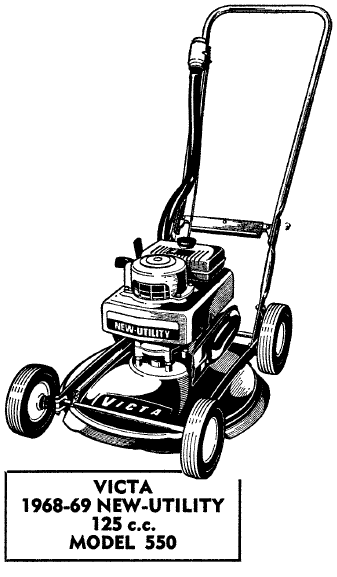

I have none of the toe guards though, and would that be the original air filter? The drawing you posted earlier has a different one.
