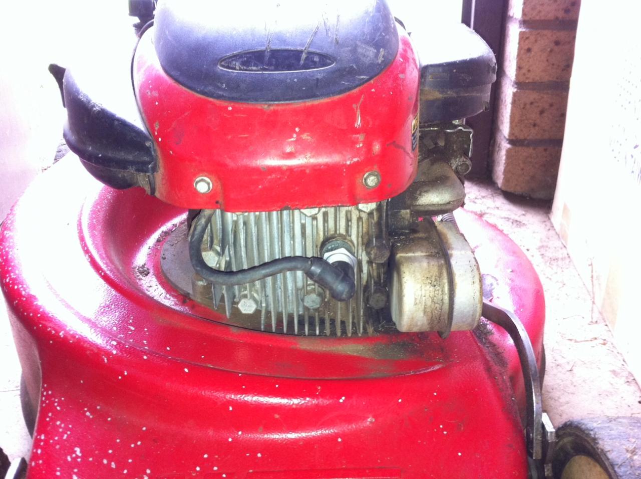

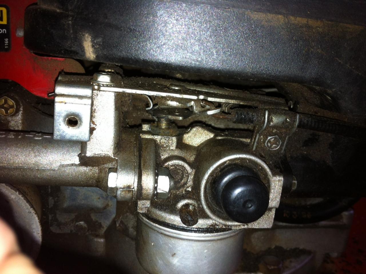

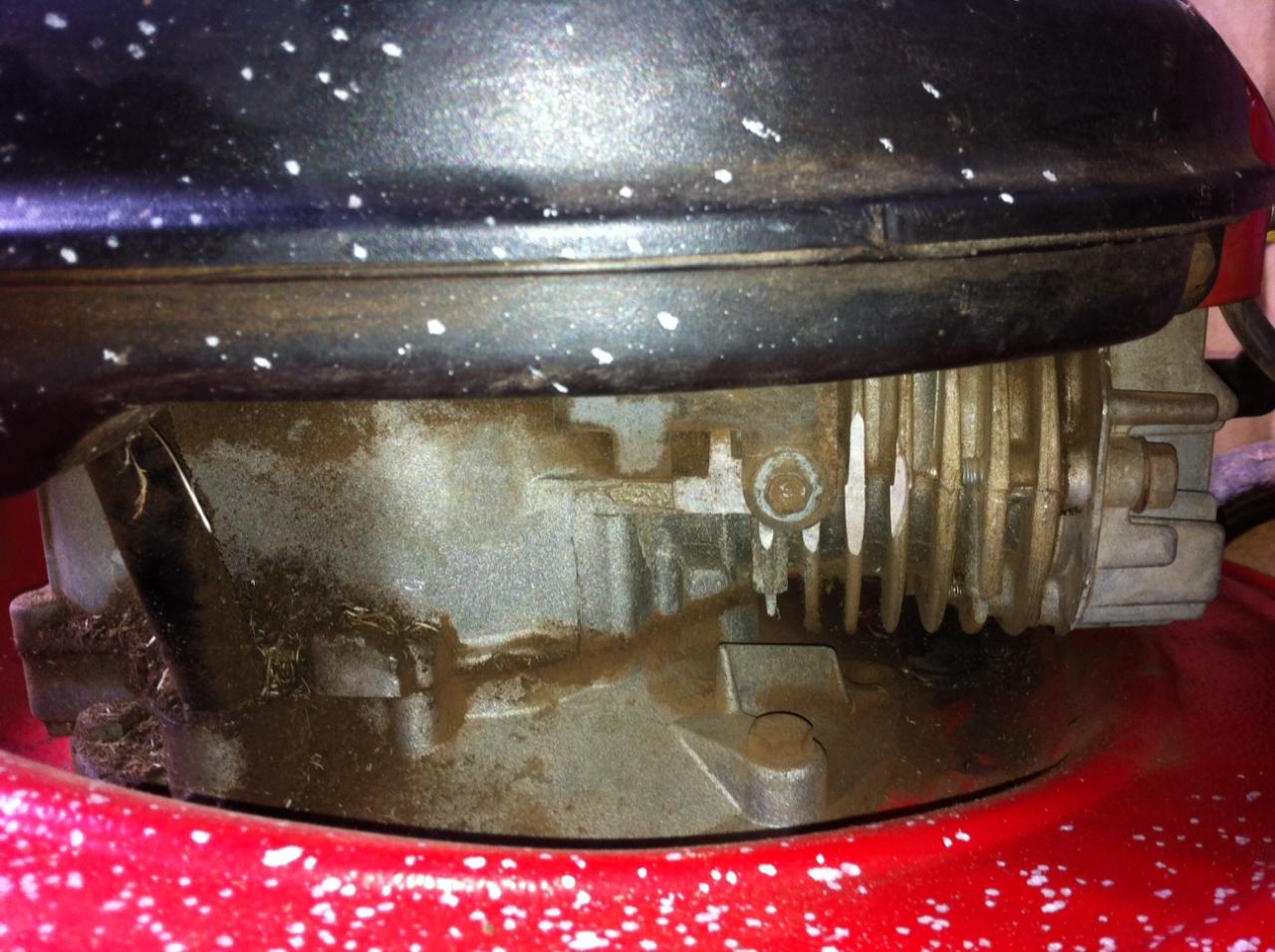

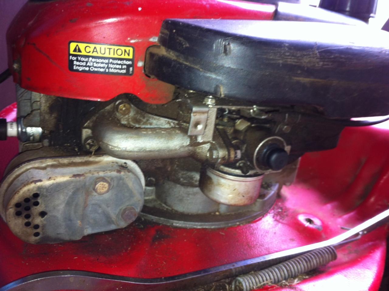

I stopped and tried starting again, though it did start it is taking couple of tries. Can this be improved? I am thinking of changing the dirty filter and blades since they seem to be worn out a bit. But not able to get the nut bolt ..just too tight. I am attaching some pics of the mower. Please let me know the basic step by step guide to service the mower.

How old is your fuel also? tipping it over might have richened up a stale fuel mix enough to get it fired up, I had a honda with similar issues in a while ago. I will hazard a guess and say the engine is a TVS90.
That is a Tecumseh engine.
Thats just the inlet manifold part number.
The Tecumseh motor just has a sticker on the metal cover. Yeah stupid i know, dumber than the stamped on a briggs cover which is a bit silly as well. How hard is it to put it on the engine block.
With the Tecumseh at a glance you cant tell a TSV90 from a TSV120 if its not all dressed up.

I would remove the carb and manifold.
Pull the carb off and clean it out. Before you do, crack the head of the main jet that holds the fuel bowl on. Or you can tip the carb upside down and hold it in the vice using soft jaws.
Looking at the pic i think someone has messed with the fuel bowl, the gasket does not look right.
aerosol of carb clean is handy. So is compressed air.
Pay attention to where the linkages etc go, take photos.
