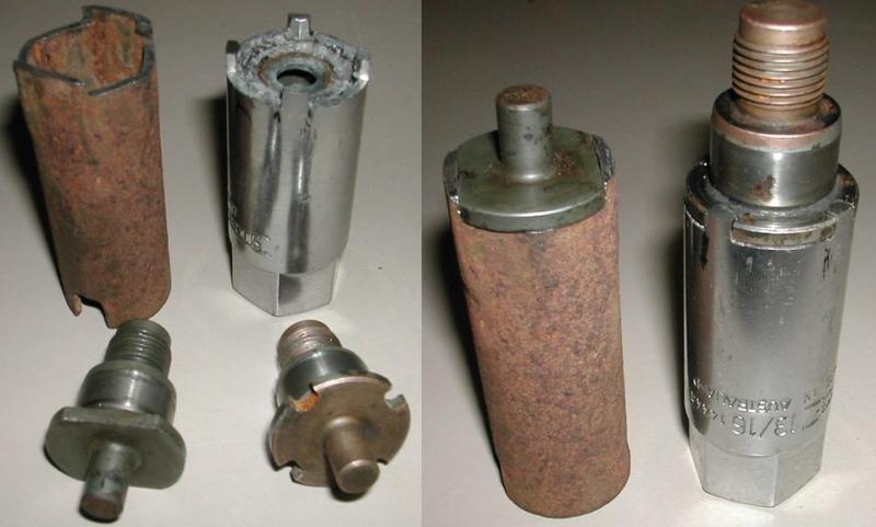

Power torque tools.
Crank Pin.
The genuine tools for undoing the Power Torque crank pins are expensive.
You can make your own out of a couple of ordinary sockets for around $20 each. I used 3/8 sockets as thats the set i mainly use and thats what my torque wrench is.
For the early model with the for slots you need a 20mm 12 point socket, i bought mine from bunnings.
Mark it so you leave points at 4 even spots around the socket and get into it with a grinder. A 1mm wide cutting disc and a steady hand is all you need. i suppose a dremel would be good too. You may have some luck fine tuning it with a file toward the end.
I started out with a crappy tiawanese socket, but it broke so i bought the kingchrome socket. Had no trouble since but i have not used it much.
For the later model with the two flat sides you need a single hex 21mm socket. I special ordered mine from the local bearing supplier. Remove everything but two sides of the socket. Most sockets have a tapered leading edge, i ground mine down a bit so the edge against the socket is a square corner.
This one is a bit more tricky, to locate the socket on the pin, i got a bolt with a 21mm head and drilled a hole in it so that it will fit nicely over the pin. It does work, but its not central, probably not square either, thats a bit hard in a drill press, especially in the vice i have, I'm going to get a friend to do it in his lathe for me. Once i have that done i will pein it over or something so the nut is permanatly fixed into the socket.
I will probably do the same with the one above for the early models. They can be very tight. If thats the case i advise hitting the conrod with a hammer to break it, removing the crank and then using other means to remove the crank pin.

Rodeobob,
I would be very careful using the sockets that you have made because you would have reduced the hardness of the sockets when you have cut them down, just make sure that you DO NOT use them on a rattle gun. cheers2
I wish I had of known that I could have made them sockets a few months ago.I had to throw out an engine that would have been fixable.Only due to I couldn't get the crank out.I didn't think it would have been that easy.Oh well it's gone now.Thanks Bob if I have to do it again I now know how to do it.

Hi All,
I also believe in "the right tool for the job", but at the price now being sought for these special tools, for the home handyman that likes to tinker (as we all like to do here)
being able to make the sockets yourself is a viable alternative. wink
As Bruce has said, the case hardening would have disappeared due to heat in the grinding process, but, with care, and no rattle gun...should do the job adequately taking into account the number of times the tools would be used. grin
Provided it started out as a high quality socket and it didn't get hot when it was ground to shape, I think the 20 mm one should be just as good as a purpose-made bought one. I'm not so fond of the 21 mm one, I'd do that one differently (use a flat piece of carbon steel, end mill a slot, weld to the back part of a socket, harden and temper with a gas torch). My reason is, to make the flat parts that do the driving massively resistant to spreading. If the torque requirement were high enough, Bob's would spread.
If you don't have a milling machine, you can do the same job with a drill and a file, it just takes a bit more time and care.
If the torque requirements were that high...I would bet that you would normally use 1/2" square drive sockets rather than Bob's 3/8" set.... wink
I agree, Deejay, I generally only use 3/8" drive when there isn't room for 1/2". Because I don't know how much torque is required for this job I'd seriously consider 3/4" drive - the main concern is that 3/4" drive sockets are much more expensive and a lot less common in flea markets.

Point taken Bruce.
I suppose i should have put a disclaimer in there somewhere.
$40 vs $180
I did take care not to put too much heat into them. No blue bits.
They are vastly stronger than the modified to 4 point Tiawneese socket i started with. It did 5 engines then i had to re do it, then it did 2 more until i came across a pin that would not come out.
Broke the socket again, nothing left to make points out of while still having the square drive hole, so i broke the rod, got the crank out and threw it in the bin.
Hence the advice to put a bolt head in the socket with a centered hole drilled in it. Help avoid failure due to lateral instability IE: keeping the socket square to the 'face' of the bolt.
I did cut a bit deep on the 21mm socket there in one spot. Spreading was a consideration as that is what happend to the 13/16 tiwanese socket i started with first up. Didnt even undo one pin with it.
See how that socket last.
If i have a failure i will be sure and post it up. I would use these sockets more than most who would be looking for the same solution.
At the end of the day, the time and effort is worth nothing. At $20ea for a donor socket i can chew through 4 home made ones before i have spent the $90 they want for the real deal.
Vastly better idea than screwdriver and hammer.
Anything shy of a single hex on single hex i would not use an impact gun on anyway.
I went 3/8 as i only have a 3/8 torqe wrench, and i usually use 3/8 stuff.
Most pins are way less than 55nm to undo. Some are way way tighter.

Recently started fiddling with Victa PowerTorque Mowers. Special tools $87 each... no way. I bought a couple of large nuts from Bunnings and hack sawed and ground them out in a similar way as has been done with these sockets. Then bought 1/2" drive sockets for the nuts. Used a rattle gun for the first - no worries but after reading warnings on this forum I have found I can easily remove the crankpins with my 1/2" tension wrench. (tip is leave the engine in the chassis so you don't need to stop it moving.) I removed the head first and put a snug fitting piece of softwood in the bore with the head refitted to stop the engine turning.
Joined: Feb 2011
Posts: 510
My versions[Linked Image]
I've often used the old screwdriver and hammer cheat with the 4-point crank pins, and for starter bolts a large shifter in a vice get's me by, but I am keen to make u some of these to make life a little easier, and remove risks to the engine!

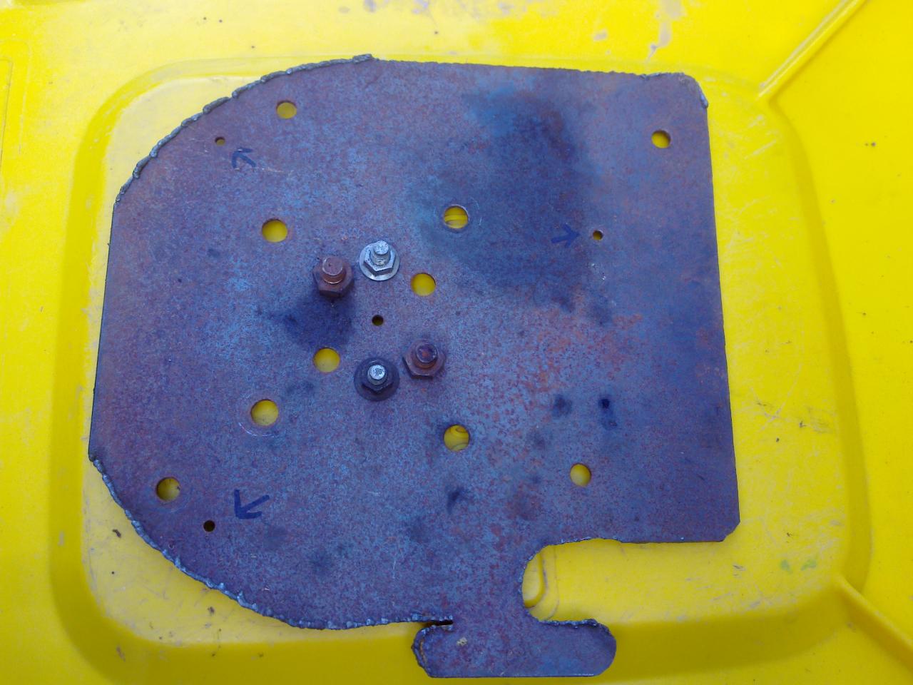

I was going to put this as its own topic, but here will do, unless anyone thinks it should be on its own.
Cant get enough rust free Victa Power torque bases??
The older victa full crank bases are made from a way thicker less rust prone steel. Reuse one of them.
I made this up.
Power torque is the same mount pattern as a Briggs/Tecumseh/Honda etc just with an extra hole/bolt under the carb.
Take your plate of steel (you could use alloy) and shape it on a regular Victa power torque base, Mark the engine mounting holes, find centre and drill them. Find centre in the plate and drill a hole here. You can refference the next steps off this hole.
Use the metal plate from under a power torque on a Full crank steel base, set the plate out on the base and measure a million times to make sure its concentric/central. Mark and Drill it out for the full crank.
Then put the plate on a dual drilled Victa base and you can mark up the forward facing holes (the ones with arrows in the pic)
For the middle step above you could also use an alloy mustang base, some of these had the lugs underneath that just needed drilling, but beware some were full crank or 4 stroke only. No power torque.
Now you can get a steel base victa with a dead full crank on it and redrill it to take another motor. I havent actually tried it on an alloy base, havent had the need as yet but I assume it would work fine.
Bolt your plate to the base and if it has the dimple, drill it for a power torque, or no dimple, a 4 stroke. Depending on the motor you might be able to mount the 4 stroke sideways or forwards. Then out with the plasma cutter to do the muffler cut out and cut out the centre hole to the bigger diameter, ive got a template for that too, its just a trimmed down cut out from another base. I suppose you could jigsaw/recipro it out too if youve got good blades.
P.S. Its a handy thing that plasma cutter. If you have a compressor you should put a plasma cutter on your to buy list. Way less heat than an oxy. It leaves a nice oxidised coating on the cut so that if you dont paint it it wont rust away. You can easily cut all sorts of shapes a grinder wont do.
Only bad thing is they do use a bit of air, like an oxy cutting freehand can make a fair wobbly mess.
Oh and I probably should have got some shots of it on an actual base.
