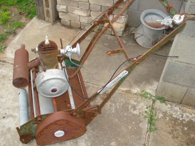

Found this ripper old mower at a garage sale and would dearly love to know what it is, Model, age.
Any info much appreciated.
It has Scott Bonnar Ltd Adelaide on the catcher, Villiers motor.

Hi Paul, and a warm welcome to the forum. grin
It's great to have another Scott Bonnar owner on board.
Your mower is a Scott Bonnar 'Centenary' model, first introduced in 1936,
and came in 16"and 18" cutting widths. Not much is known about this mower but the original Centenary was a 16" and had a cooling shroud on the right hand side over the cooling fins of the Villiers, and some sort of vertical plate, hinged in front of the motor, maybe to cover the opening of the grass-box whilst mowing, to stop the clippings flying everywhere.

Paul, could you please take some more pics from all angles and post them here, it would be great for the forum archives.
Also can you please post what's written on the brass mower ID plate, fastened to the machine, just above the engagement end of the crank handle.
Once again Paul, :welcome:
I'd certainly like to see more pictures. At the moment I'm guessing that the crank handle fits into the end of that shaft on the same side where it is stored, below the bottom of the flywheel, and drives the opposite end of the crankshaft. I don't see a ballrace at the end of the shaft, so there may be a ratchet involved. This seems a bit exotic, but after all the machine is British. Now that I've guessed, naturally I want to know if I'm right.
Hi grumpy, it fits into the dog that is on the end (red shaft) of the 'counter -shaft' that would (I'd guess ) have a sprocket and chain drive to the engine crankshaft. They work well. There is a bearing on the inside of the chassis side rail, fastened as you can see, by the 2 bolts, either side of the dog. wink

Thanks Deejay, I missed the 2 bolts and thought it just had a location collar. So you tend to have an exciting time snatching the crankhandle out of the socket after start-up? I can't see an over-running arrangement that allows the handle to disengage from the socket. A spring-loaded pin in the socket would do it, if it has one.
I can remember having to do a precision job of making a crankhandle for a Lister once: it had a spring-loaded pin that engaged a keyway in the end of the camshaft, and pushed out on overrun, but if the crank was slack on the end of the camshaft where it engaged, they were reputed to grab and spin with the camshaft. Since it was a big two-handed handle with a long overhang, having it spin would be more exciting than I preferred.

Hi again Paul, Thanks for posting the pics.
Yes mate, yours is an 18" later model "Centenary" from the late 30's and a really great score, mate!! good1
