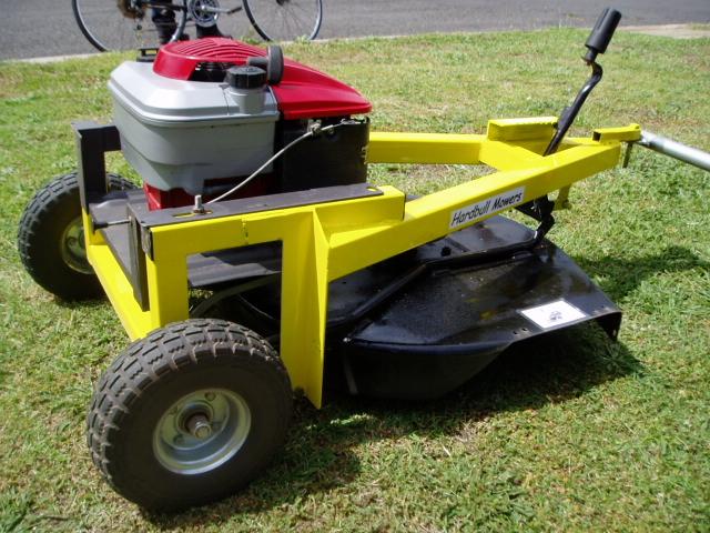

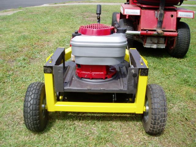

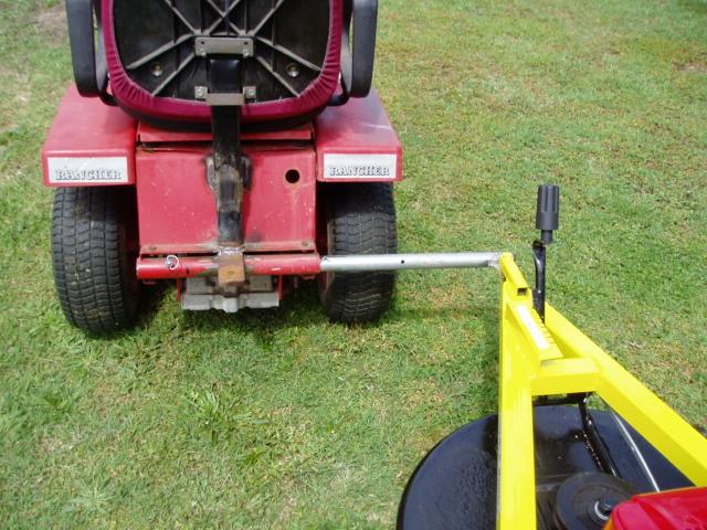

Hi all. It's been a while since I've put much on here, it's a bit of a silly season this time of year!
But here is one of the machines I've been working on, the idea came when the girlfriend suggested about mowing her 8 acre paddock! She's got a 27166 Rancher, her neighbour's got a John Deere LX172, and I've got a 1755 Rancher. Still a big job for the three machines, so I got to some designing, and this is it!
I've designed it to be fully self contained so it can be towed by more than just a ride on.
It's powered by a 5 HP Briggs and Stratton and has a 24 inch cutting deck running at 2/3 engine revs, (my spare Mobilco deck actually), 4.10 x 4 solid rubber tyres, and an 8 position height adjustment, (matched to the 8 height positions on the 1755 Rancher). Bear in mind this is the prototype, so some refining and safety guards etc will be on subsequent machines.
I've had a lot of interest in it so far, quite a few customers have said they would much prefer to buy one of these to add on to their existing machines, as opposed to buying a bigger machine.
The engine can easily be removed for servicing as it is contained in a cradle that is adjusted for belt tension. I'm planing for the machine to be supplied with the tow bar modification so it can be towed on either side of a ride on too. I'll end up with a few diferent kits when it comes to that.
But anyway, feel free to leave your comments, and be critical if needed
I have a suggestion and a question, Greg. First, the suggestion: I think you may need caster-type dolly wheels on the main frame, positioned in front of the cutting deck. Otherwise when the front wheels of the tractor tip up on a grade or bump, the front of the towed unit might dip down far enough for the deck to dig into the ground. I know this effect won't be all that severe because the tow bar on the tractor is up close to the rear axle, and the dip of the towbar therefore won't be all that great, but sooner or later someone is going to try it with a home-made towbar that sticks out further. A dolly wheel would also keep the front of the deck out of the mud when the unit is parked, not connected to the tractor. Second, the question: does the fitting at the end of the extendable boom have a simple lift-off towing pivot, and is there another similar pivot at the center of the tractor, so you can tow the unit to the mowing area with it in line with the center of the tractor? Then you could pass through gates on the way, and just pull the tow point over to the end of the boom when you are ready to start mowing. This seems like less of a hassle than sliding the boom in every time you come to a gate.
Joined: Apr 2011
Posts: 346
Likes: 3
Thanks Grumpy, input appreciated. I did consider the option of having a wheel, or in fact two, at the front. The issue I had to weigh up was do I keep it as simple as possible with like you said the shortest possible drawbar, or do I put wheels at the front which would inturn require another pivot point in the drawbar, in the horizontal plane above the front wheel mount to allow for undulations. I also considered a king pin steering type design as well. However in the end I went with the KISS principle, (Keep It Simple, Stupid!), hahaha.
As for the tow points, Yes, the slasher is of the fixed pin type hitch, and the towbar boom does have a single eye tow point at one end. Hence the reason for having it removeable so it be utilised on either side, and yes, the ride on does have a tow point in the centre for the very reason you suggested, (although I also have a 50mm tow ball for it too). When in this position, the towbar boom can be slid in and located in the centre position, so as to eliminate any protrusion on either side.
When in this position, the ride on cutting deck is the widest part of the whole configuration. This allows for initial clockwise travel around a particular area, then travelling anticlockwise with the slasher trailing to the left leaving an even spread of clippings over the mowed area, or it is possible to begin in the centre of an area, with the slasher trailing to the right, and clear the mowed area of the clippings.
The ride on and slasher combined give a total 52 inch cut.

Thanks Ty and Joe, after giving it many trials, there isn't an issue with the front edge or the blades digging in. Even with the slasher at it's lowest setting, the front wheels of the ride on need to raised 6 inches before the slasher blade touches the ground.
If I put them into production, they wont be leaving here until I have fitted the towing boom to ensure it is done correctly.
And Joe, yes, you're correct. However it's the cowling cover only. I just thought it looks better the standard Briggs variants. It also got a coat of paint as well to pretty it up.

Thanks Bob, I've set it up so that when it's at it's lowest it cuts at the same height as the 1755 Rancher, 15mm. I have been thinking about a modification for it though, although more the towing boom than the slasher, although the slasher will need a longer drawbar to allow for turns. That's to have the towing point in line with the centre line, both vertically and horizontally, of the drive axle. That way, the drive wheels will act as the front wheels of the slasher, and it will give the slasher approximately the same wheelbase as the ride on. The ride on doesn't seem to scalp anything out of the ordinary, so therefore the slasher shouldn't either. Thanks for your input here Grumpy. As in the drawing below.
As for it cutting, it's no great drama to monitor it. Apart from doing the ol' head turn, you can easily hear the engine, so if it stops cutting for some reason, like a belt breaking, the engine revs will increase. Also, The height adjusting lever is within easy reach of the operator's seat, so you can feel it too.
Good question about the clutch and brake, I have contemplated that as a future mod. It wouldn't be hard to hook up an electric clutch that is linked to the seat switch to stop the blades when you get of the seat. I also have all that's required to make the slasher engine electric start too, all it would need is it all to be connected to the ride on via an automotive trailer plug / socket, and all the controls could be located on the ride on and utilise the ride on battery. Even the throttle could be operated by means on an electric solenoid. After all, it just needs Idle, and Run (with the primer bulb setup), and an ignition switch for the start / stop.
I've given it some pretty rough treatment before the paint, hahaha, don't worry. Full noise in top gear over some pretty rough ground to see if anything was going to break. I think the only thing that broke was my back! hahaha. It bounced a bit, but no-one should ever be mowing like that.
But thanks for the input Bob, cheers.

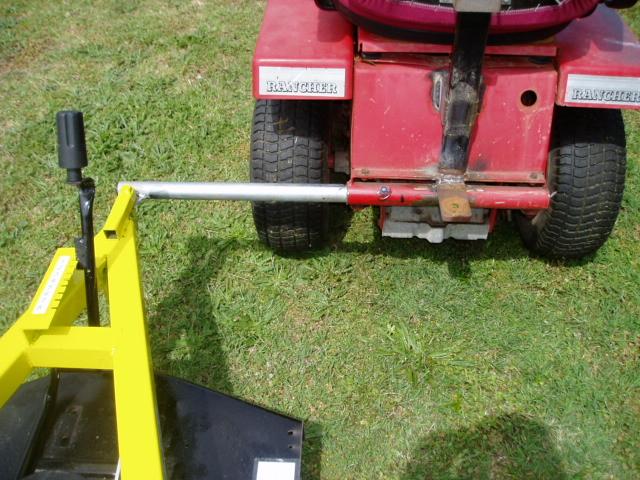

But anyway, after a couple of hours work, more the whole day actually, lol, I've come up with this...... Deviated from the KISS principle a LONG way!!!!
I think it was a bit of an exercise in futility looking back on it now it's finished. While the slasher blades don't touch the ground in any position, it's introduced quite a few more failure points in regard to all the pivots, three axis. But oh well, you get that on the big jobs! lol
Next episode.... King pin steering with a floating drawbar! hahaha

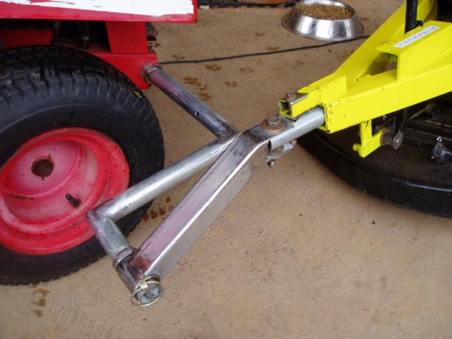

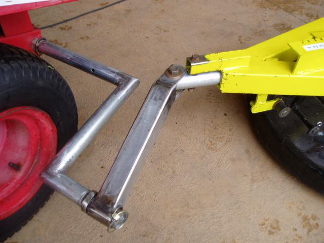

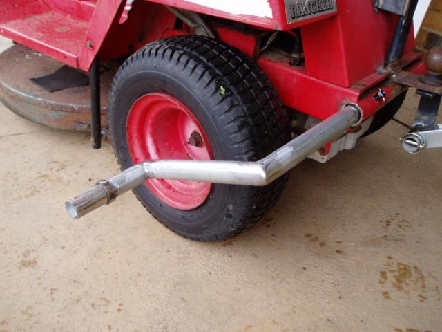

You can see by the pics how I have achieved approximately the same wheelbase as the ride on, yes, centre to centre, as per my sketch.
The forward of the two vertical pivots is for left and right arc's, (I placed it here to retain the same track when cornering as it was previous), the rear of the two vertical pivots allows for about 5 deg radial movement in each direction from centre.
As far as a support for when it is seperated, a simple landing leg is all it needs. Once I have achieved a more succesful tow / hitch arrangement than my original design (I still prefer it actually), I can then locate a landing leg in a place that will not interfere with any of the slasher's operation. Electrical controls, utilising the ride on battery, not it's own battery (as I suggested earlier), can well be an option and not standard equipment. It would take nothing to wire it up, even with a 100 amp plug for the starter cable. I've used it quite a lot without electric controls, and without hassle.
I don't believe that the way I have the towing boom tow points, and the centre tow point to be an issue. Either in the previous design, or this one. It simply doesn't take much to get off and manhandle to a diferent position.
Bear in mind also, one of my aims is to make this able to be towed on either the right or left side. This is why I've designed the latter version the way I have. I know the pics don't show it, but it works exactly the same on the right hand side.
