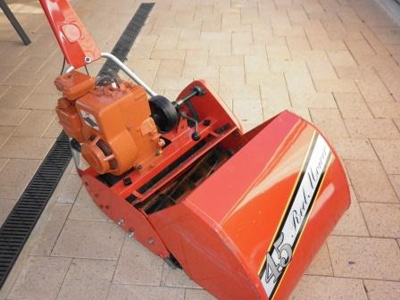

Just a picture, for those interested. Few dents and scratches in catcher from previous owner, but not worth worrying about.

Having studied your pic Jarrad, I can tell you all is not what it seems....I presume this is the machine without its Model ID plate and I think I now know why...You can't really lose one, as they are pop-riveted to the rear chassis rail.
I believe this machine is an imposter....I'll give you my reasons and with your help Jarrad, we will get to the bottom of it. It has been made to look like a late model Rover 45, but it is a Scott Bonnar Model 45.
Here are my reasons:
(1) It is fitted with a late model Rover catcher in the correct Rover colour, with a correct Rover decal.
(2) It does not have the Rover handle bar round decal
(3) The ID plate that should state Rover-Scott Bonnar is missing.
(4) The engine is the wrong colour for the Rover 45. It should be black (same as the cutter clutch and shaft and bearing carrier.
(5) The reel has reached the end of its life, possibly the bottom blade as well..
(6) ***If you can post the whole string of numbers on the cowling of the Briggs we can deduce the engines actual age....this will give us an indication of the age of the chassis.*** We do know when Rover took over SB Ltd.
(7) the chassis and the handlebar plate have been resprayed in Rover red to look like a late model Rover, thereby hoping to increase its value when sold.
If it had had its ID plate intact this would have blown its cover immediately.
The good news is that I'll bet dollars to peanuts it is a genuine Scott Bonnar!! grin
Please let us know what you think Jarrad. wink

Hi Deejay
The machine is definately a SB model 45. I wish I had some pix of when I purchased it.
*It had the Rover Catcher and Red Rover handle bar trim on it when I brought it.
*I made the decision to paint the chassis red to match, the good condition Rover catcher.
*The handle bars themselves and the chassis are Scott Bonnar. The engine was originally orange and re-sprayed in orange engine enamel, although the colour didnt come out as close to the original as I would have liked. Id did not paint the engine black as I am certainly not trying to pass this machine off as a Rover 45.
*I will post the numbers of the engine, I assume its 1970's vintage. But would like an indication of age.
*The bottom bar looks OK and I had it sharpened when had the reel done. But will get a new one when replace the cylinder early next year. It is still cutting fairly well at the moment.
The guy I brought if from purchased it from a mower shop and it appears to have had a rough patch up job. I dont know why I did not have the original SB ID plate. It is certainly a well used machine, the carby was cracked through where it mounts to the head, reel at end of life etc. But the chains and sprockets were in very good nick.
At the end of the day it's going to owe me close to $1000, but given that is what good condition SB sell for here in WA, I would not loose money if I sold it.

Hi Jarrad, how more off track could I have been!! lol
I would still like to know where the ID plate has gone, as they a fixed to the machine after painting at the factory.
I don't know where you would source another for it Jarrad, as they were not sold as a spare part. frown
