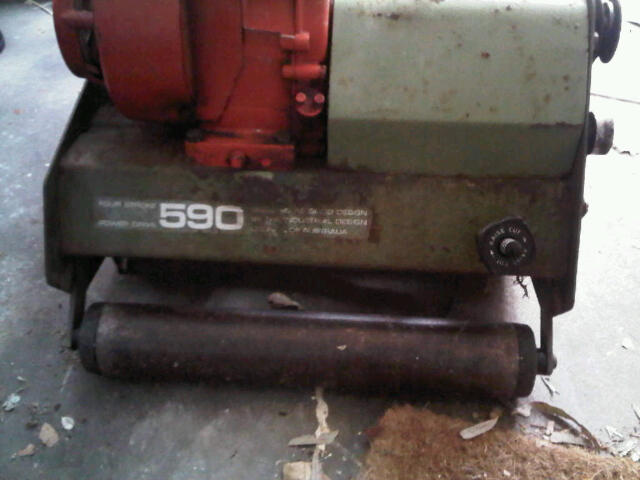

above pic shows the front sticker which is slightly different to the ones ive seen in various posts.
The first problem I seem to see at the moment, is that there appears to be, in effect, no automatic belt tensioner. The belt is tensioned manually with the screw and nut. To fit a new belt you'd need to slacken the manual tensioner all the way, then fit the belt, and adjust up the screw and nut again. Then you'd have to keep watch on the belt tension, adusting it as necessary. This is the system that cars used back when they had V belts driving their accessories, before serpentine belts with automatic tensioners were adopted. It can work, it's just an extra maintenance item.
The second problem I believe I see at the moment, is there does not seem to be any way to stop the reel when the engine is running. I would regard that as dangerous. There may be a clutch in the engine output shaft, but if so it is concealed by the safety cover in the picture above.
Can we please have a pic without the cover....It seemes that this is an entirely different set-up to the Model 430 Diplomat, wink
Hmm so on these there is a second lever to drive it? I think mine is missing the drive one, perhaps the ring gear in mine isn't dead.... I will save that for another thread. Once you get this sorted can you put up a couple of pics of where each lever directly connects to?
Joe, as I understand it, the belt drive SBs have a handlebar lever that operates through a Bowden cable to engage the clutch that is built into the drum drive pulley. The 430s at least, also have a "Park-Drive" lever that tensions the drive belt. The lever sticks out from the top of the drive cover. So for the 430, you start the engine in Park, shift to Drive when you want to start the reel rotating, then squeeze the handlebar lever when you want forward drive of the drum. Of course for close manoeuvreing and backing up, you just push it with the handlebars without engaging the drum clutch.
If some of the mowers don't have a "Park-Drive" lever, it seems like they must have a lever operated clutch in the engine output shaft, like the chain drive SBs, or there would be no way to run the engine without running the reel. I don't know about you, but I'm not going to tune up a mower with the reel running.

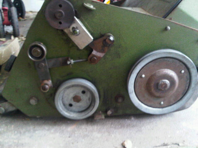

Hi there, sorry for the poor quality of the photo but is my belt / clutch setup. It has the handlebar clutch setup which when at rest (deactivated) the drive and cutter drum is disengaged.
According the engine production (99% sure its original) date it is circa 1980 model. [Linked Image]
Hi fritzymark, and a warm welcome to the forum. Its great to have another Scott Bonnar owner on board. We all like to learn new things and tinker here. grin
Thanks for posting the photo of your 590...its easy to see how yours works because of the Bowden cable and the tang welded to the chassis frame to support and adjust it....if you compare that with the pic on page one of the topic...the belt set up is the same except there is no tang on which to support the cable....its got me tossed how it can drive. crazy
Once again, fritzymark, :welcome:
It could work just as well if the crank pulled by the Bowden cable in fritzymark's machine is actually a bell crank in the original machine, with the operating lever on the opposite side of the side plate.
Hi Grumpy, that's just the thing....the Model 590 doesn't have a lever on the opposite side.....how does it engage the drive?
Deejay, I was wondering if it had the Bowden cable termination on the other side, rather than the long hand lever that the 430 has. In other words, a bell crank, but a short one.
