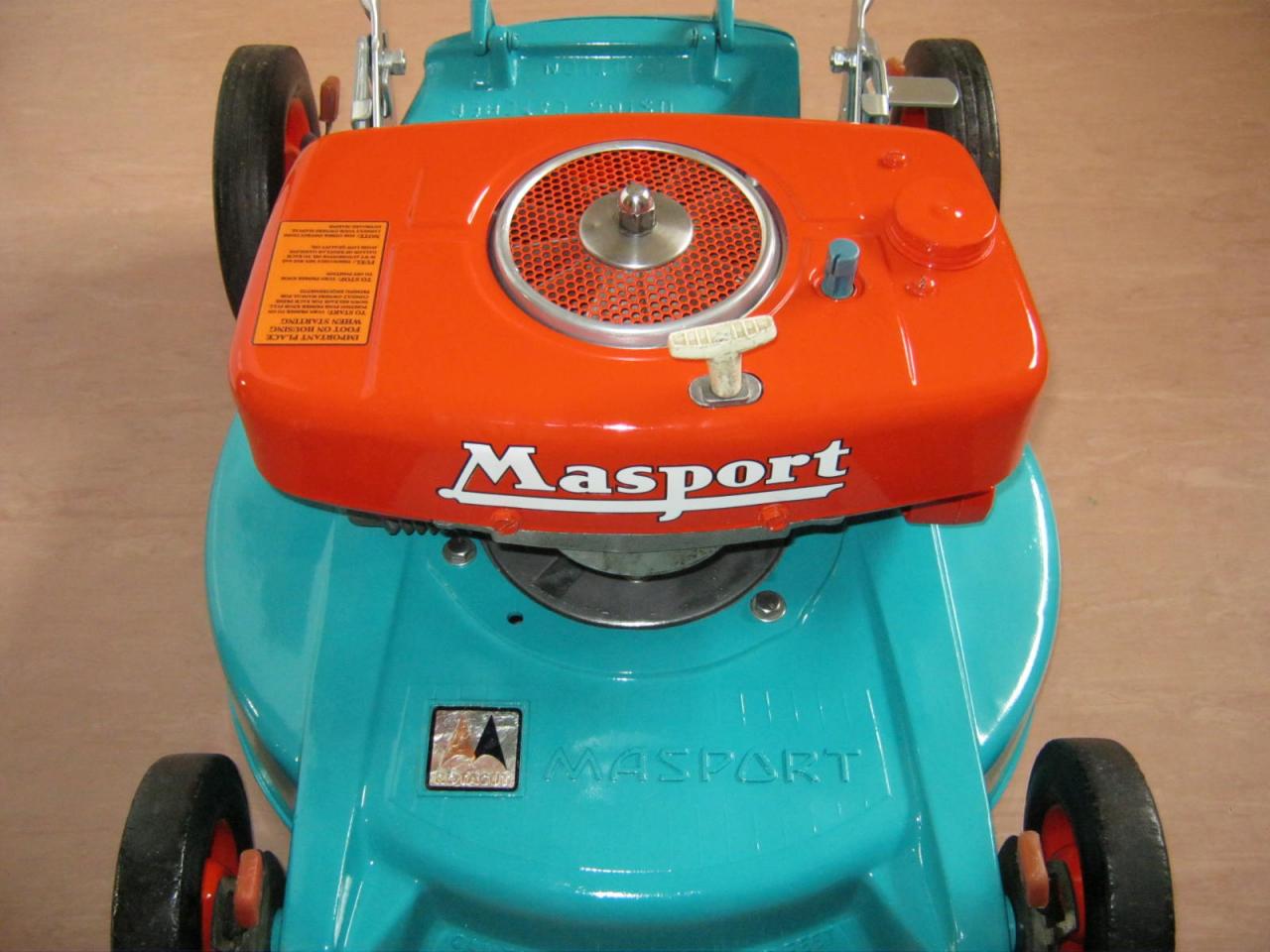

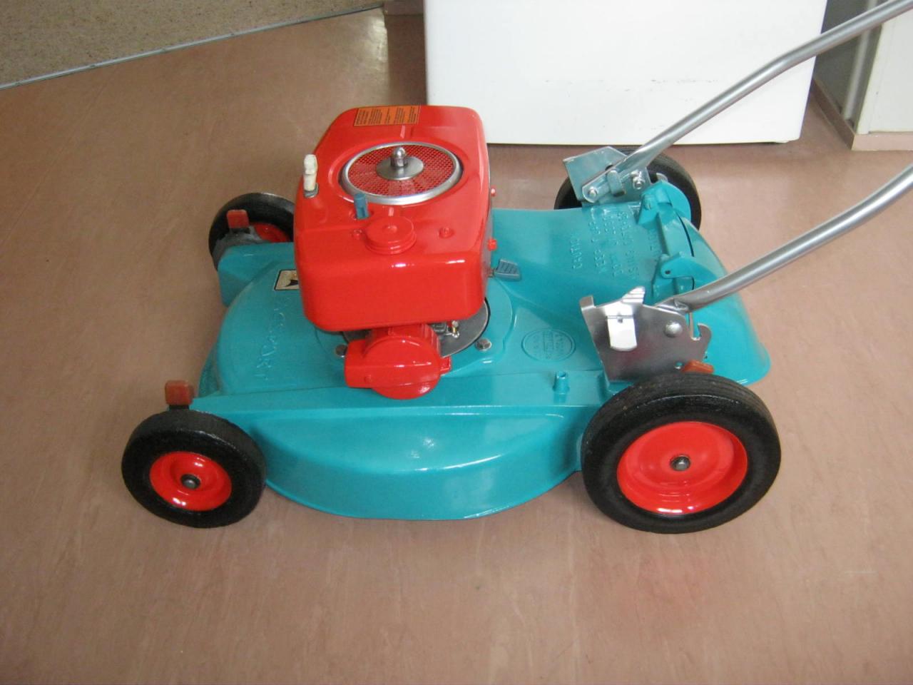

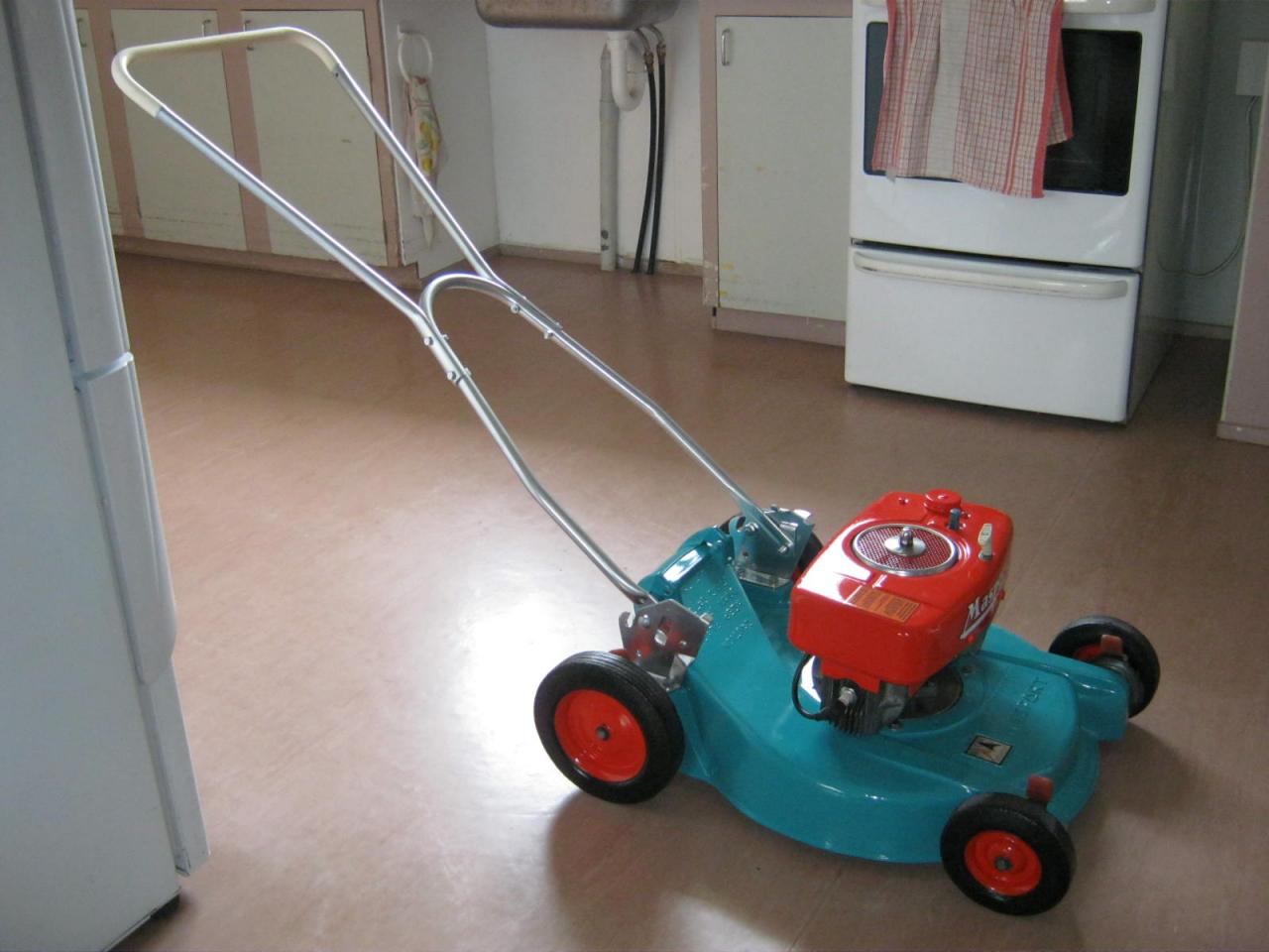

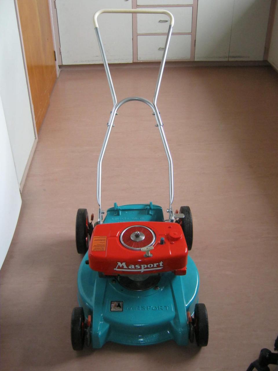

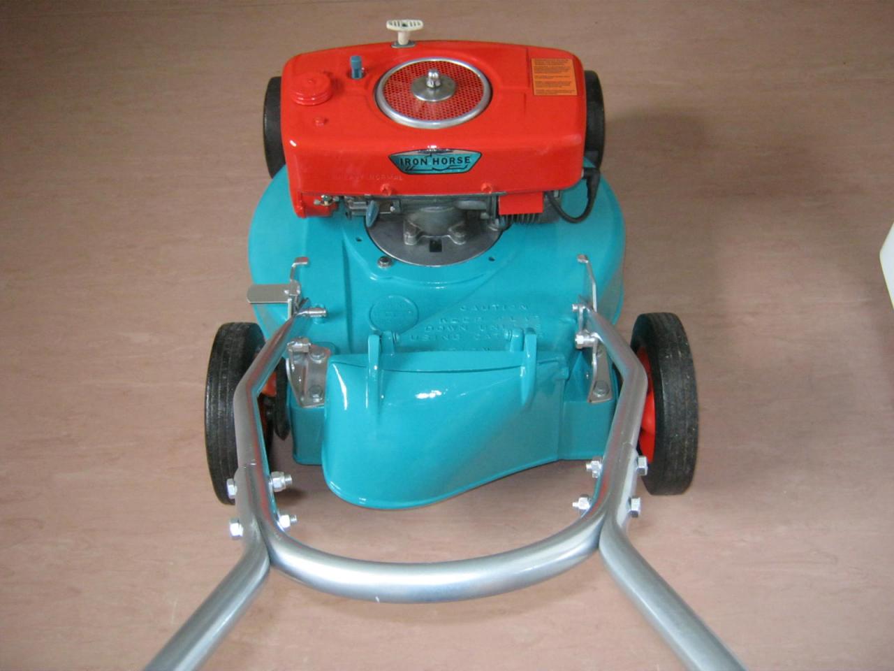

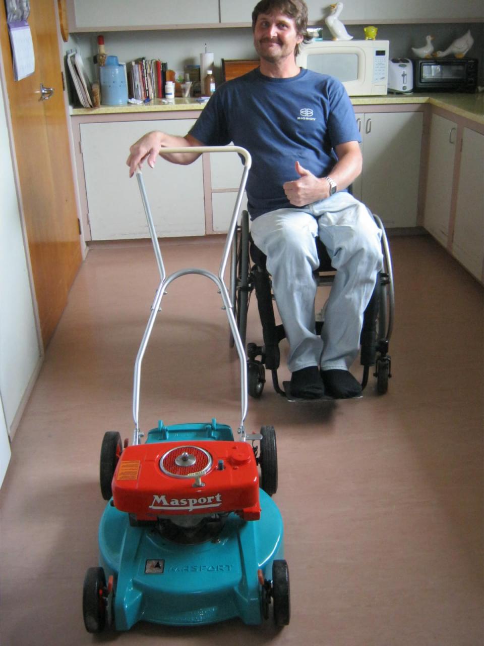

Well guys it only took 6 months but I've finally finished the Renovation
Well it looks magnificent, Pete. Does it run as well as it looks? Are those the original colours? And didn't it originally have a speed control on the handlebar? (Some mowers don't, they just run at maximum speed.)
A detail: if you can get wheels or tyres for it, those bald front ones are the only weakness in its appearance I could see.
Well done. For your first lawnmower restoration project, it is a remarkable outcome, especially considering how complicated that engine is, and that it isn't a mower that existed in any numbers in Australia. I think our most experienced restorers would be proud of it.

Hi Grumpy,
Thanks for the kind words, and yes she does run as well as she looks.
Originally it was just to get the engine going, but one thing led to another and i wound up doing a restore, To be honest Grumpy I think this has been good therapy for me in the way it helped me through dealing with the loss of my wife.

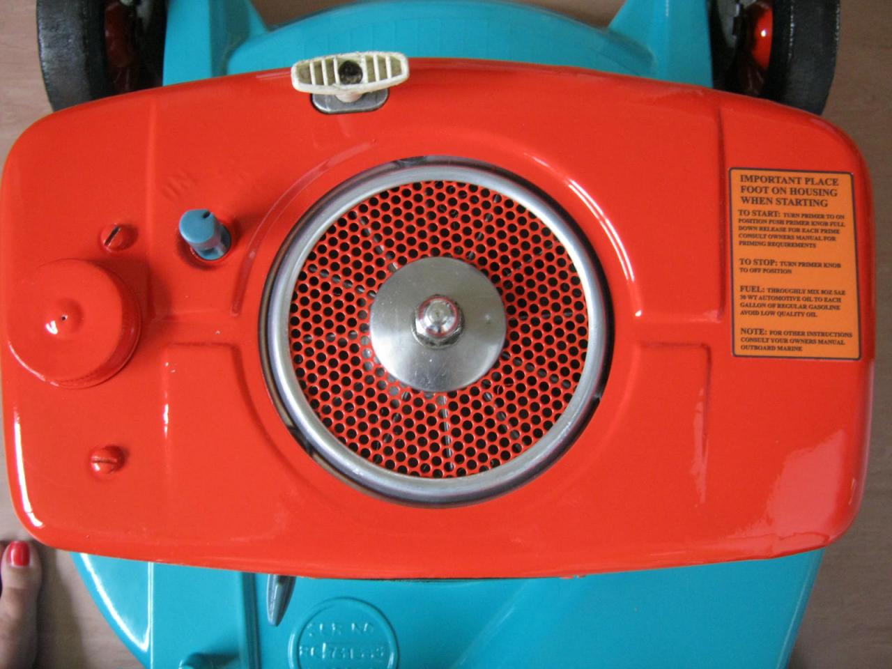

I think you might be getting this Iron Horse mixed up with My Kirby Lauson which has the speed control on the handle. this too has a 2 speed control which you can see in photo 5 its a blue lever on the back of the motor.
The Kirby is my next project, now that i have a manual for it, i can at least have a go at getting it going.
I'm moving up in the engine dept from 2 to 4 stroke, you may be hearing more from me with questions about the 4 stroke engine hahaha
edit:
Forgot to mention the Orange is Chevy orange by 3M which is as close as i could get to a match for the orange parts.
The body i took the grass flap to get a paint match as i couldn't find anything close that i was happy with.
the handle brackets, Handle and the silver center on the flywheel i used White Knight super Chrome in a spray can and was really surprised with the outcome, couldn't afford electroplating and the handle chrome was flaking off, chrome splinters are no fun lol

i definatly agree, youv'e done a great job and have a magnificent looking mower, cheers
Thanks for clearing up those points Pete - so it is an authentic full restoration. I have trouble believing it looked that good when it was new.
Of course we hope you'll keep us posted on your Kirby-Lauson restoration if you go ahead with it. We don't have much in the way of Kirby-Lauson threads, so it would be a valuable addition to the archives. Up to now we've had an assortment of questions on them, but not so many answers.

Hi Deejay, Yes I remember your input, thanks very much to you and Grumpy on your help and support through this rather long Restore.
And thanks for the kind words on the finished product

On the front wheels, a man of your talents could regroove the front tyres. Not new, but looks almost like it and essentially free.
Not sure how you would actually do it but im sure you will work it out.

Thanks Rodeobob,
That's an interesting thought, re grooving the wheels, I'll have a think about that.
I'm thinking my next project is my Kirby-Lauson that's under the house it's a 4 stroke but the body is exactly the same as the one I've just finished, different colour though it's a greeny colour.

Hi Cosullivan,
Thanks very much.
That's basically what happened to me, i just started trying to get her going again after the starter spring unraveled next thing you know I'm doing a full restore.
Tips on painting: I sanded all my parts for painting back to bare metal including the body. Then primed everything with rust protection primer. Then put 2 coats of Enamel paint on the parts and finished with a clear coat after i put the decals on, i thought it would help protect the decals and the paint job and it has. the orange enamel i used was a 3m product i got from super cheap auto it has a good heat protection, which is important for the engine cover and air filter as they are close to the engine you don't want the paint melting off when the engine gets hot.
for the body i got a paint match done at a paint shop this was also enamel.
I hope this helps you.
Good luck with your restore, this mower thing can become addictive lol
