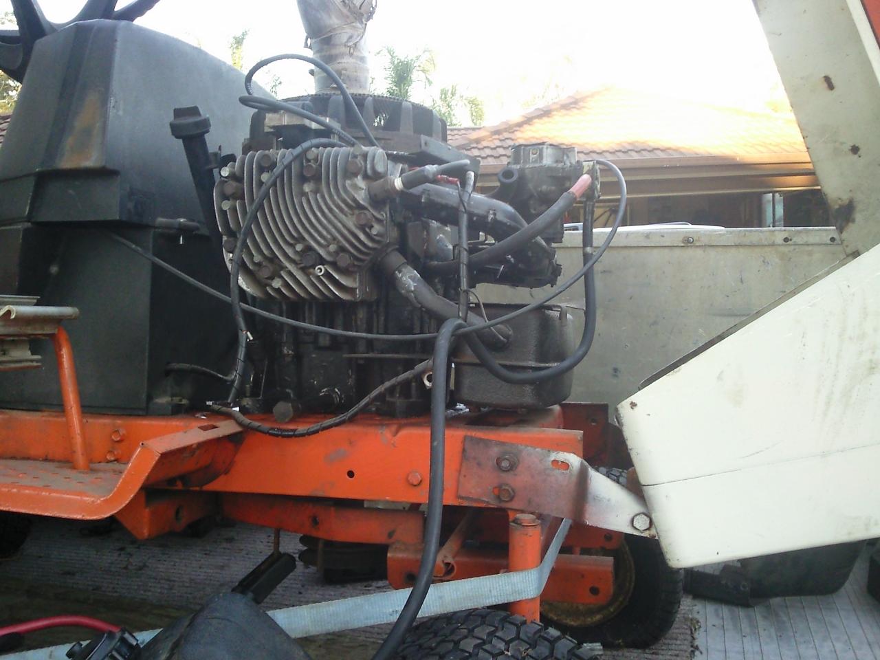

well i have it home now and i will unload it tomorow morning.i checked oil and turned it by hand and all was good i then put a little fresh fuel into the carb and it fired but wouldnt keep running as if its blocked.i will have a look tomorow. at a closer look it looks like it will slot right into the toro without mods to exhaust etc i still need to check shaft size etc. [Linked Image]

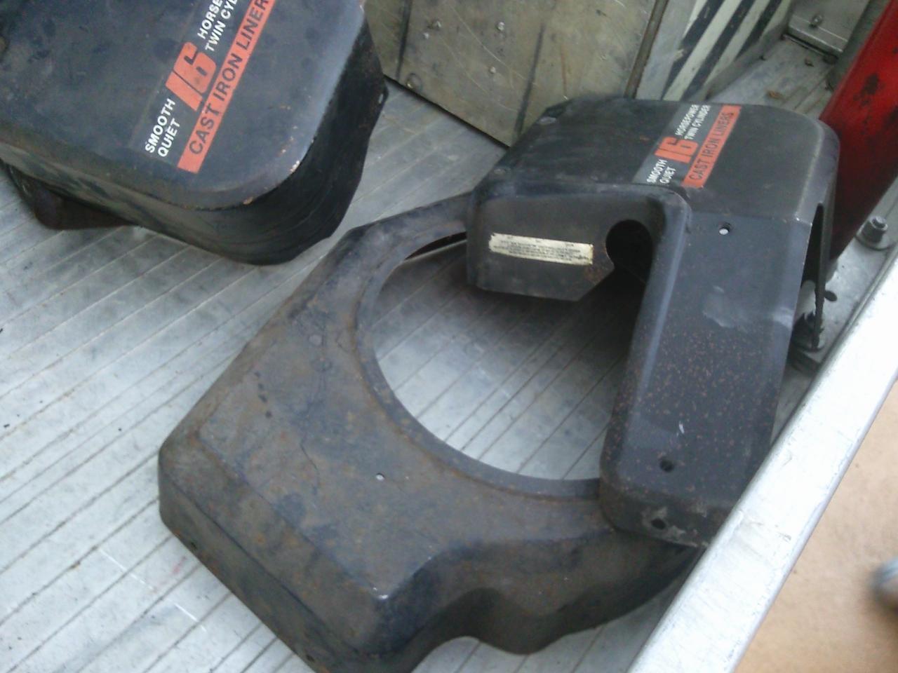

Sounds promising Mike. I see it is an I/C (industrial/commercial model, with cast iron bores) as I'd hoped it would be, and the muffler arrangement is rather neat. The inlet manifold, on the other hand, is horrible and isn't likely to be well-suited to cold starts in very cold climates. The oil drain looks a bit cobbled, as if the mower manufacturer did a very crude adaptation of Briggs' design, but I can't see it very well. If it really does extend the drain plug by screwing a long pipe into the aluminium crankcase, let's hope it fits better on your chassis and you don't have to do anything so obnoxious.
As you said, your starting/running problem sounds like a fuel blockage in the tank, line or carburetor and will probably be easy to fix. It doesn't have a fuel shut-off solenoid in the float bowl does it? If so you might not be activating it with your temporary set-up.
Please keep us posted on this. Hopefully you'll end up with a better mower than when it was new.

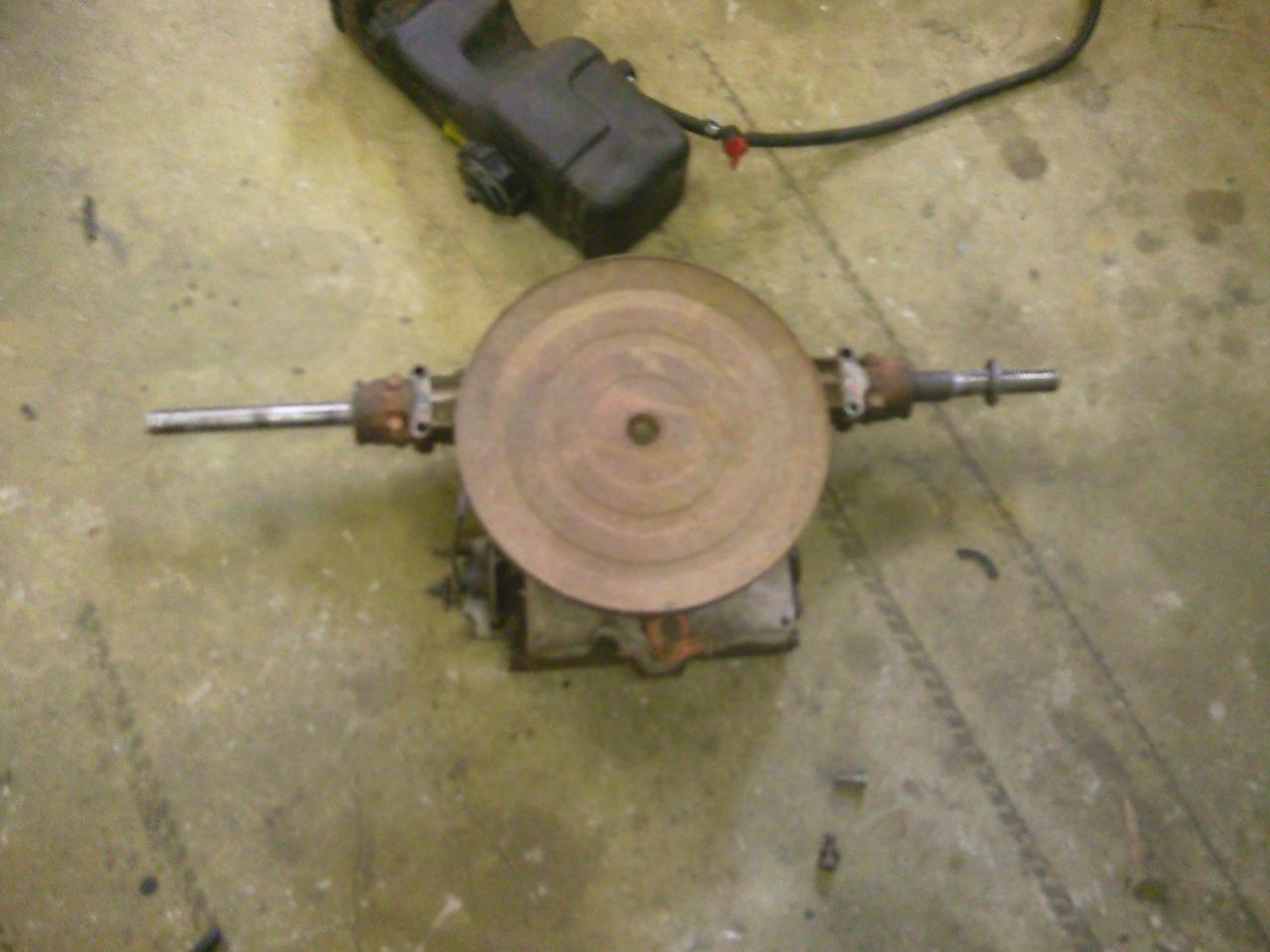

well its been a busy day i had a close look at the mower itself and decided it was a tip job so i stripped her down and kept the wheels with brand new tyres and the gearbox 5 speed the bonnet and engine and seat.the seat is a beauty its off a komatsu digger lol fabric and comfy just needs a clean.as far as the engine is concerned i think the fuel prob was because the twit had conected the supply to the return line and the return to the supply.i will confirm this later when i play next.thats all for now peoples [Linked Image]
gotta be worth the 103 dollars i paid
Thats a simplicity, is it a PTO trans???
Bob.
Posts: 70
not sure .the belt ran from fixed pulley on engine.it has 5 speeds and reverse.i didnt test it by riding but seems to work by spinning the pulley when in the gears

well i was rrrrrrrrrrrrrong and should have listened to the gurus .the oposed twin is tooooo tall for the torro i can make it work by removing the bonnet but i think ill wait for a v twin to turn up or a good 16 plus hp single.on the bright side i have run it but it needs a carby kit was not smokey etc so i may even build a racing mower out of it .
