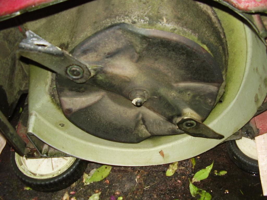

Hey guys I got a couple of old victa 160cc 2 stroke mowers both are the series 70 mark 4 with the alloy base and g3 carbs. now the main one i use has had a fresh piston / rings put through it, a little of the head on some glass with some grinding paste and a hone by hand with some sand paper. This thing revs its ass off....
but the only problem I'm having is its chewing through blades like no tomorrow, especially on one side. Is it possible I have lined the base plate up so on the exhaust stroke is coming out onto the blade? It seems I'm only getting about 10-15 lawns out off a set and one side is always worse than the other one. Any ideas would be great, Thanks.

here are the pics mate, these blades were new and all it took was 15 lawns to do this to em

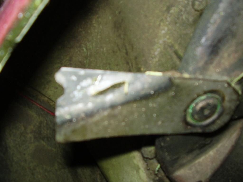

here is a close up
to me it looks like there burnt hence why ask about the exuast heating them up
is it posible im running mower to hard?

That hasn't been caused by exhaust heat. When the engine is running the blades are cooled by air movement.
It looks to me as if the blade may have been damaged by cutting something other than grass. You haven't been hitting some sand have you? That might grind through the blades.

i have been over a few pacthes of dry sandy dirt that gets thrown up everywear when you go over it i supose that might have the same afect as sand but would all that friction grinding on the blades cause that heat damage? it is an old victa mustang too by the way
Hi All, it seems strange that just the upturned tip appears damaged...and does look as if a lot of heat has been applied; grumpy, I agree with you, sand could be the culprit...but why is the underside of the deck and the rest of the blade not appear sandblasted....Real mystery here.... confused

is it posible the base plate may be slightly warped or a little bent on one side the is no noticeable viabration like un balenced blades or any thing and it still gives a very nice manicured cut i do have have another base plate ill give that one a go and see if it changes anything and ill let yas know

The underside of the body looks clean and sorta sand blasted to me.
Ive seen blades like that here.
Crap quality blades??? They are not the JakMax blades are they??? If they are go get some BPL blades from Bunnings and see how they last.

I would try a different brand of blades,my mate goes through a set of blades on his ride on after 4 mows (2 acre block)so i told him to try genuine blades and it worked a treat...ken
