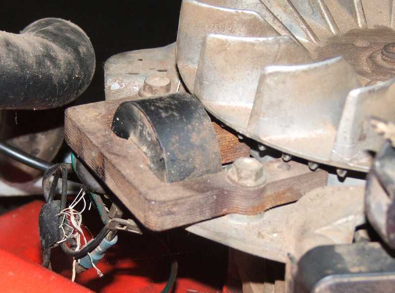

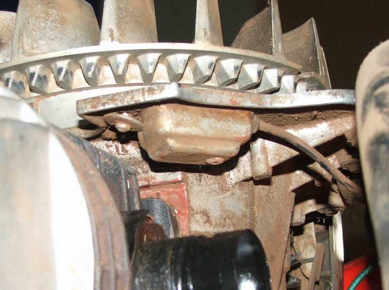

Well if that worked, there should be a pic of my module and another of the actual coil.
I'll post this to see if it worked and then do another post as I have more questions to ask.

Thats the old style module.
The issue you could be having could just be bad earth.
Drill out the rivets, clean up all the surfaces and re-attach the module and try that. Might save you the $$$$ a new one and post would cost.
Cheers, Bob.

Looking at the pic after I'd taken it I had the same idea but have not tried it yet. Quite amazing what you can see in a pic and miss in real life - could just be that my eyes are getting a bit older frown

I'm also ordering a new electronic ignition module, silencer and a few other parts and will fit new fuel and vacuum lines when I do the job as well as (again) new "O" rings. If that does not sort the problem out then I will be very disappointed. I know that the internals of the engine are good - apart from the seals which I have not checked yet but will do very soon.
Thanks again,
Jerry

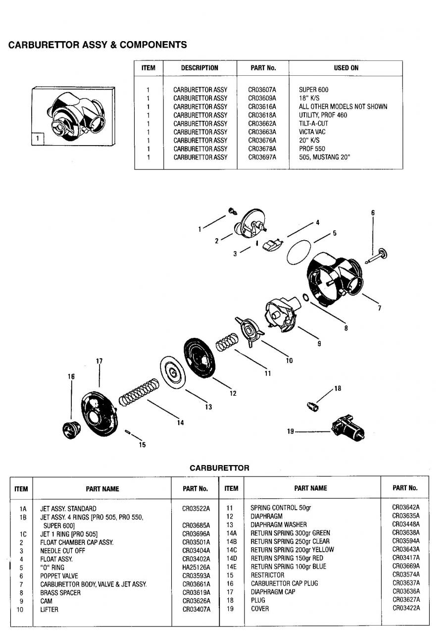

Put the needle in and put the float on, if the needle is too long when you push the float up the curve on the bottom of it will barely be in past the edge of the primer cap where the O-ring goes.
Black needle works best ive found. Yellow ones are longer than the black ones. as are the white ones.
