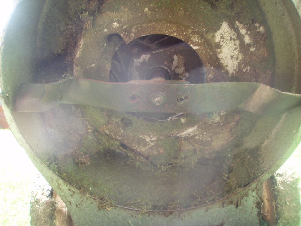

Ok, I just took a photo of the blade setup.
The crank diameter is 25mm and there is a steel boss with keyway that sits on the shaft. The boss has two locating lugs to position the blade. A single bolt takes care of securing the blade & boss to the the crank.
Well, it seems you need a blade plate that takes a one inch crankshaft extension, and has either two or four attaching bolts. The most important dimension is the exact distance between the two attaching bolts (that is, the pitch circle diameter of the attaching bolts). However you also want a blade plate that has the correct size holes for the attaching bolts, if you don't want to have to drill them out.
Fitting a blade disc is feasible with a new disc and blades from a mower with the same cutting width and the blade boss.
The problem I see with doing this is the mulching function will probably no longer work well at all. While they are not the best the blade bars are not that bad, they are thick enough you can sharpen them many times and long lasting.
As to your vibration I would be checking to see if maybe the crankshaft is slightly bent, to cause noticeable vibrations you should be able to visibly see it by comparing the height of the blade as compared the the mower deck on one side, turn the engine over 180 degrees (SPARKPLUG LEAD OFF) and comparing the other side of the blade to the same spot on the mower deck.

Thanks for the advice, as I mainly use this mower with the mulch plug fitted, I guess I will have to stick with the blade bar.
I will check the crankshaft tomorrow, hopefully it's not bent.
