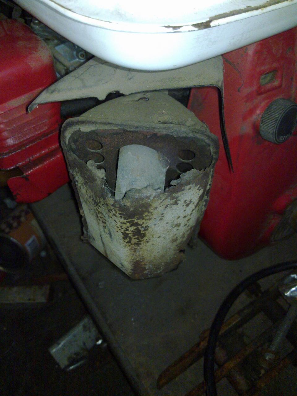

I will try to upload a pic of the old muffler as well - it has a big rust hole in it. I didn't realise it was so bad as it was covered by a chromed heat guard. Ho hum.

pic of muffler

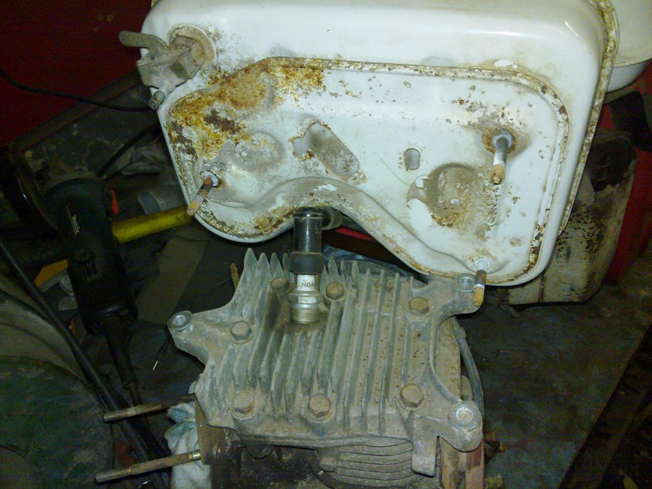

Theres a guy on eBay that has a G200 tank.
Im thinking i will buy the rest of the motor off him, mine had a rusty flywheel. I dont think the reduction drive off it will fit on the GX140

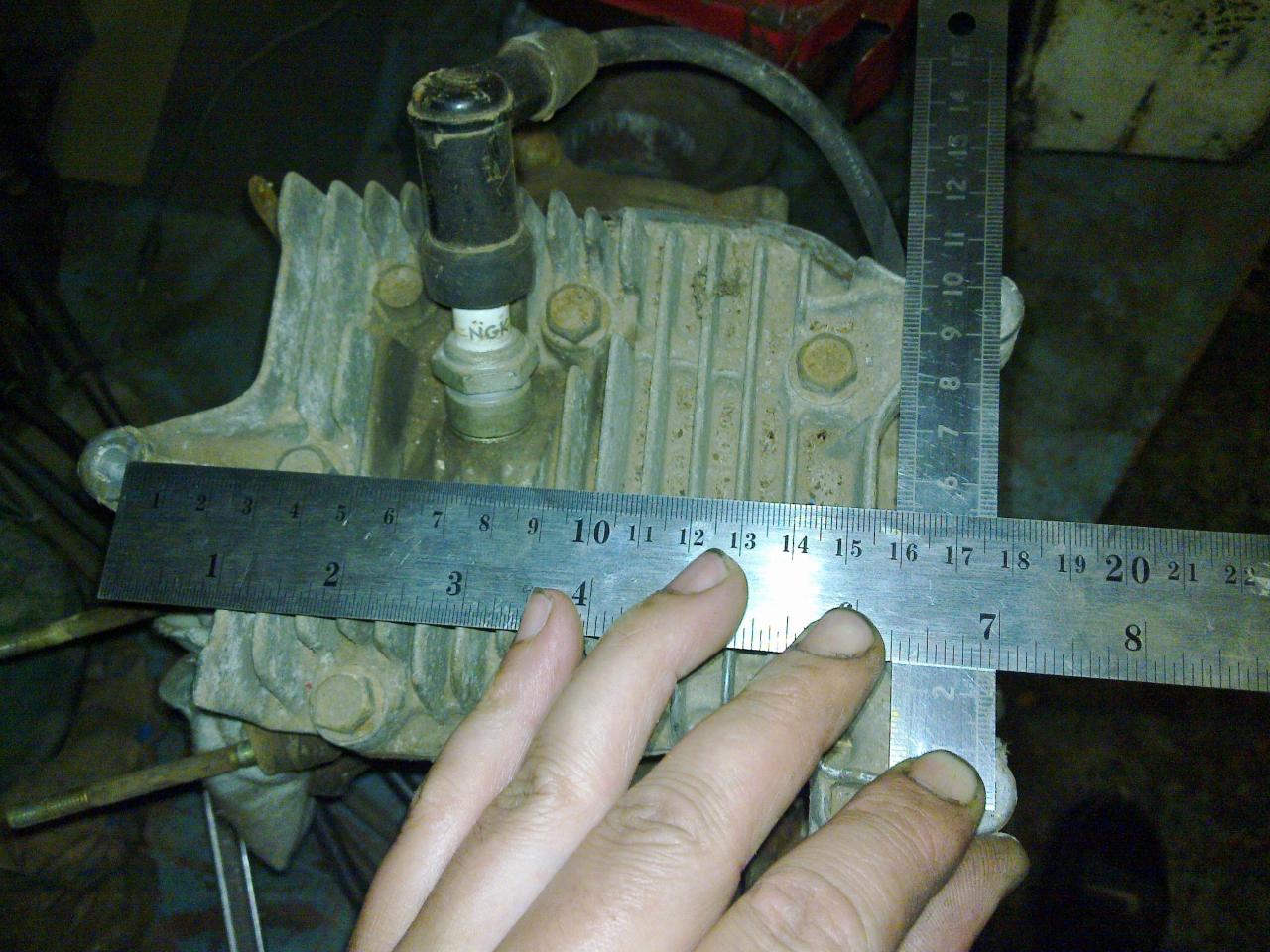

Heres a pic of mine.
Rough idea of the measurments.

I was suggesting the tank on eBay. Mine is for a reference to see if it will go close to fitting. Bolt spacing and fuel tap location.

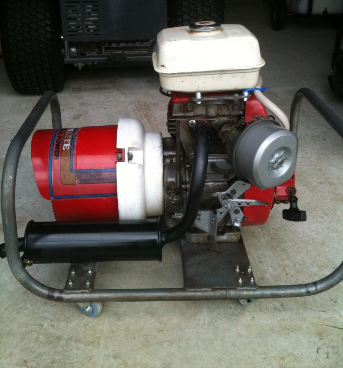

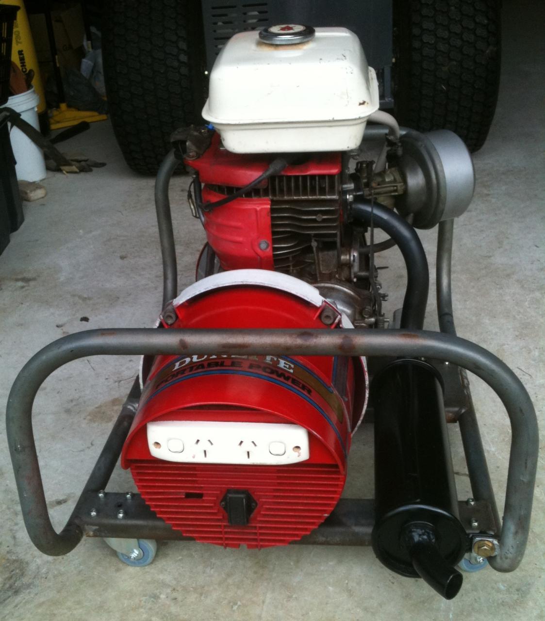

Thats what has been done to my G200. It has had a long Briggs muffler welded to the pipe/manifold. I did not think to take a picture of it, i took one of the G65 as i had to move it out from under the bench to get the G200 out.

Tank 1st - G200 tank duly arrived and with a bit of fettling with the mounting bracket, its on and looks right. Slight problem, the orientation is opposite way round so in order for the underneath indentation to sit on the spark plug, the petrol line outlet is opposite side to carby. So the plastic fuel line has to travel under the tank on its way to carby and sit on the red metal plate covering the cylinder head . Thus it gets pretty hot, so I will need to get some heatproof sleeving - I hope it is easily available.

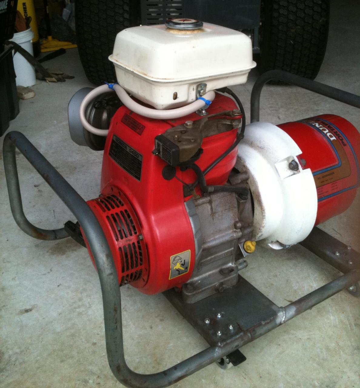

As you have been good enough to have so much input, I thought you might like to see the finished product.
My worrying brain had already decided to re-route the plastic fuel line and I managed to get hold of some small bore hose as sleeving. As you csn see I made an add'l bracket to tie the line up to.
The new fuel tank looks pretty good - you can see that it is undersize for the G400 and does not span both the engine brackets which would normally hold it. However my bracket attached to the engine cover plate looks ok and there is minimal vibration. The new tank holds just under a gallon so I am happy with that.
You can see that my muffler problem was fitting it between the air filter and the throttle linkage, still ensuring it was adequately fixed so it wouldn't rattle itself to bits. As I have no welder, I gave in and went to 'Macs mufflers'. They used my old exhaust flange and made up/welded a new muffler (fibreglass wrapped) and brackets. It cost $150 including some repair welding to frame. I think they have done a smart job but its blown the budget a bit. If anyone in Brisbane North would like to be hired to give me mig welding lessons I will jump to it.
The finished article starts first pull, has plenty of compression, runs smoothly with no smoke. I have set the throttle so the generator pushes out a constant 240volt. The whole job owes me about $400 which is pretty good for a 5kva Dunlite generator - I think!?
Many thanks again Bob.[Linked Image]
