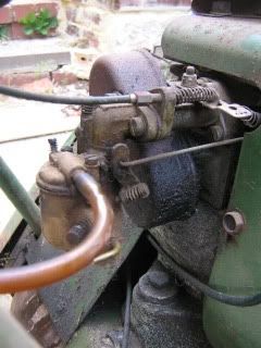

We need to see a picture of your carburetor to get the starting routine clear. There is no priming bulb, but most of them had a flood button on the lid of the carburetor float bowl for starting enrichment. If it has the button, you just hold it down until fuel squirts out a tiny hole in the side of the lid. If it doesn't have the button, it will have a choke lever.

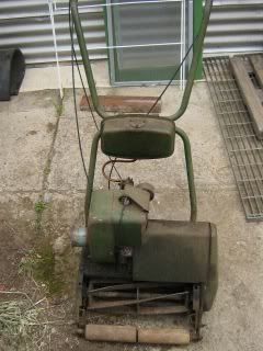

OK, thankyou for the prompt replies, i have (hopefully) included some photo's, i measure the blade width at 14 inches. I was a little overwhelmed at the complication of procedures but hopefully some pics will help you to see what i see, and no doubt you fellah's could rebuild this in your sleep!! I find this forum a bit complicated compared to my usual forum at my vintage fan site, but endeavor to grow accustom to it...... let me know if you need more info and i'll get it for you..

That is a relatively modern ATCO, nothing like the one I was guessing you had. There appears to be a spring-loaded button on top of the float bowl for flooding it, which would be the way you get cold-start enrichment. I suggest you trace the Bowden cables from the two clutch-type controls to see where they connect - most likely one will be an engine clutch (drives everything) and the other a rear roller (drum) clutch. The engine clutch would be under the tin cover over the engine output shaft. A drum clutch (if that is what the other control does) would be inside the left-side chain case, but the cable would probably go into the case from the right side of the mower's side-plate.
If you find out which handle does what, you will know how to disengage the clutch(es). With them disengaged, you start the engine by setting the throttle about mid-way, flooding the float bowl, winding the starting rope around the pulley on the right side of the engine, and pulling. If all is well it should start immediately.
The mower badly needs cleaning. If you do that you will find out more about what goes where and what it does.

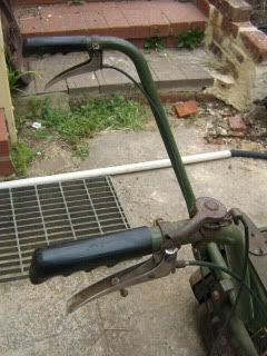

Excellent!!!... thankyou for that info, i'll endeavor to give it a cleanup on the weekend, this data plate that should be near/on the motor i presume will give me model/identification?...i haven't seen any i.d. on it yet, unless it's under the covers....... forgot to mention the right lever has a smaller lever inside it with a (not factory, i'm guessing) nut and bolt in it, to act as a locking device? And a friend pointed out that the plate over the spark plug is to earth it, thus turning off the motor?.........makes sense but that's a new one on me!!
Using a flexible spring-steel plate above the spark plug as an engine stop control is a standard technique - Briggs and Stratton were doing it by the beginning of WW2, and perhaps earlier. It just short-circuits the magneto secondary. Unfortunately depending on the quality of the earthing of the spring steel, you tend to get a high-tension electric shock when you use it, which is annoying. Note that it does not prevent the engine from re-starting, so it does not meet modern safety standards.
Not sure yet about that screw and nut on the right side squeeze control. I noticed in the photo. It may be a stop that you adjust, setting how far the handle moves when you squeeze it. It may be original.
