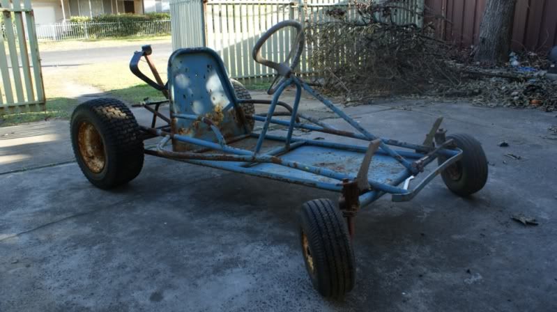

They seem to be hard to get! Here are some pics of the beast in all its... glory... lol
[Linked Image from i31.photobucket.com]
It has ride on mower wheels and a ride on mower steering setup on it Which will be replaced once we can find out what wheels it ran and the steering setup.
At this stage we think it is one of the earliest Karts in Australia. It was painted bright yellow and had a round dome fuel tank mounted to the rear of the seat.
It will be used in Vintage displays and as a static display showing just how far Karting has come.

Either can i if we could find out what it is! We think it is a 'KK Special' made by ' General Engineering Sales ' in Mascott.
It looks like it is one of the earliest Karts in OZ.
If you have any pics from Back in the day and dont mind me sharing them with the Vintage Website it would be much appreciated!

Still have this old girl, no work has been done on it lately as i've been busy working, Will be Victa powered, although the Victa will be worked! Was originally bright yellow so i'm thinking of taking it back to that colour instead of the baby blue.
The hardest bit will be the fuel tank, it ran a half dome tank that bolted to the back of the seat, the frame itself is rather small for me but i'll still give it a go at flogging it around a track, dont think it will give me a massive thrill like my old kart did.. i mean 117kph in a go kart is a pretty good feeling lol
But i'm sure it will still be great fun driving one of australias first go karts and driving it in period correct clothing etc will be a sight i'm sure lol
