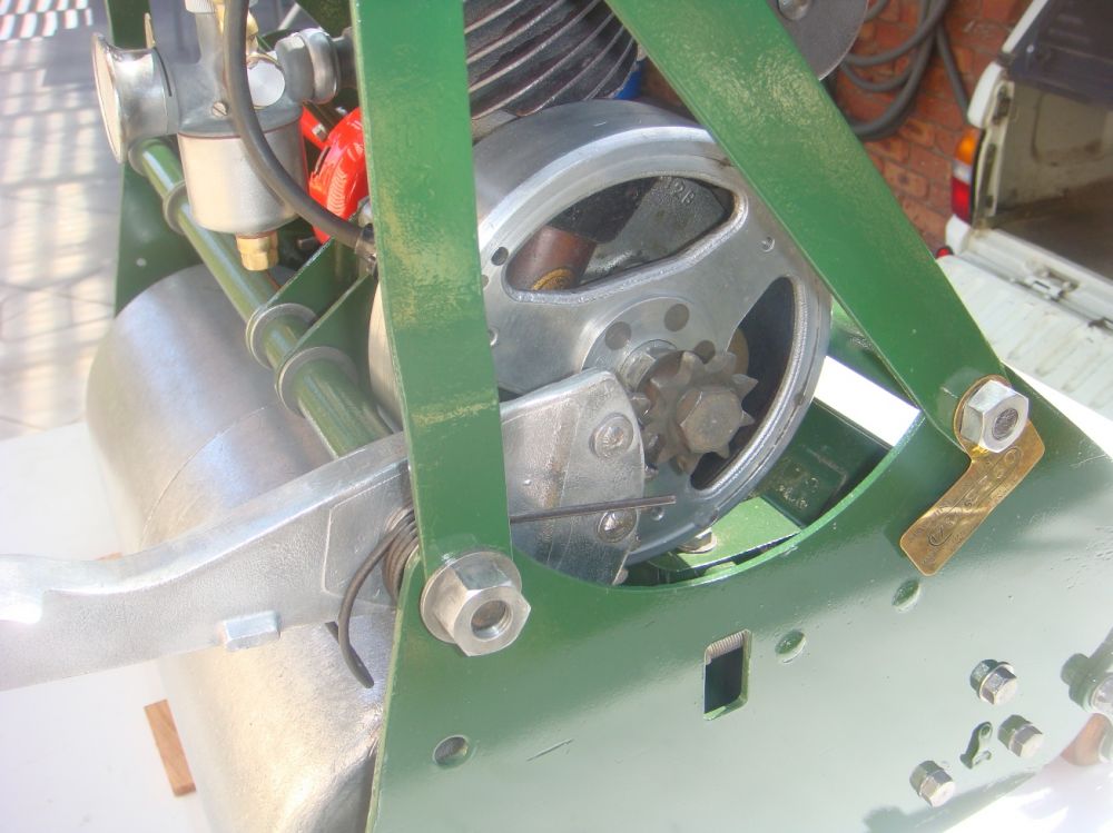

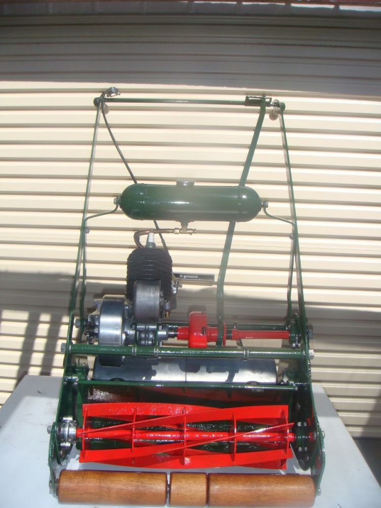

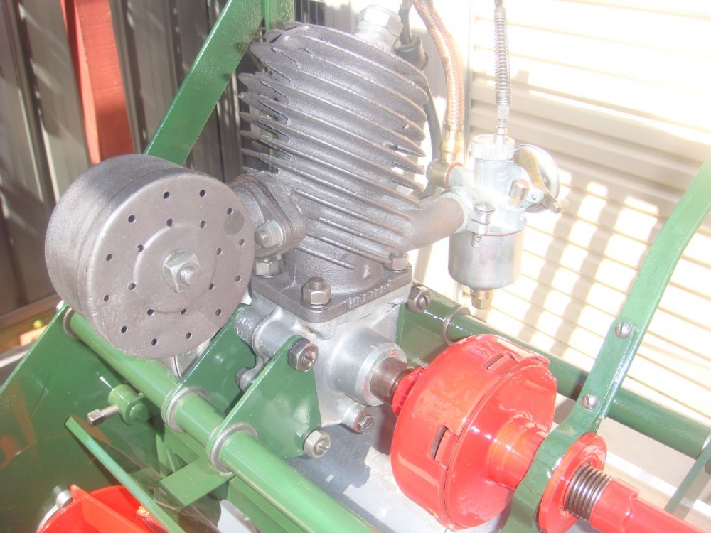

Hi Guys you may recall my atco collection photos back in sept, here's one almost full restored rgds Peter

very nice peterrm what type of wood is used for the front roller? i have 1 of those engines in my shed regards steve...

I had a 12" that looked extremely similar except for the muffler, which is entirely different: mine was a typical vintage job: a long black cylinder with hemispherical ends, one of which had a short exhaust pipe sticking out from it. My flywheel was just like yours, but seemed to need a cover to keep dirt out, and had a spigot and 3 tapped holes for holding one on, so I cut an aluminium disk and fitted it. There seems to be something amiss with your kickstart return spring, and the chain cover and drives don't seem to be fitted yet. Otherwise it looks a lot better than any near-new ATCO I ever saw back in their day. Incidentally I considered mine a pretty horrible mower: the 1940s Villiers engine vibrated excessively at idle, and the clutch was purely in or out which made starting off from stationary a fairly messy business. However it was totally reliable with negligible maintenance, and it cut a really fine lawn.

g'day grumpy, thanks for your comments, i have plenty of flywheel covers but looked so good without left it off. as for kick start spring , chains, cover etc all parts will be fitted this weekend to make complete.To be honest do not want to use it, too good to use on lawn besides ive got another 10 atco, rgds

g'day steve, i've used tassy blackwood for rollers. I've actually got 12 atcos in various condition, i've produced about 5 sets of rollers ready for resto. rgds peter

Hey Peter, that restoration looks quite incredible to say the least....well done. I'm curious as to how you got that finish on the top half of the Midget. Have you gone back to the bare iron and sealed it or sprayed with a cast iron shade of heatproof....it looks damn good.

G'day Craig thanks for your comments,yeh went back to bare metal with electrolysis and sprayed with hi temp paint made by white knight, it's ok but stays tacky for a long time probably needs to be heated to harden. i.e. once engine runs for a while rgds Peter

Hi Greg, with regard to rollers I am a novice with turning and bought a cheap lathe,pretty simple hardest part was drilling hole down centre. With regard to mufflers varied depending on model/year. best source for all parts is buying more atco's on ebay, I've got 14 average price $40, problem ow is where to store. I've just started dismantling all to save space, good luck Rgds Peter
