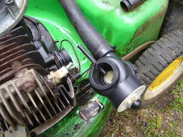

Drilled out the hole where the stub was and stuffed some irrigation tube in so that I could hook up the de-compressor again (see pic). Unfortunately I managed to crack the carbie housing near the connection point - I think crack is cosmetic only, annoying.

BTW - To anyone with a similar carbie problem (broken vac stub) I don't recommend drilling out your carbie (see pic above). The tube that I put in has to be cut flush to the carbie and the hole overlapped the main o-ring used to seal the carbie. I ended up plugging the hole that I made with some Aluminium tape and will probably look at either a new de-compresser or running a plug :-)
