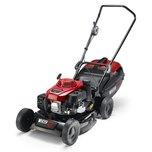

In the early 2010's, Victa was offering the Pro 19-inch. Again, these were short lived and I've only spotted a couple over the years. Based on the 19-inch Mustang chassis and using either Briggs or Honda GXV160 engines, Victa also fitted the pro-grade wheels and chunkier side wear strips.

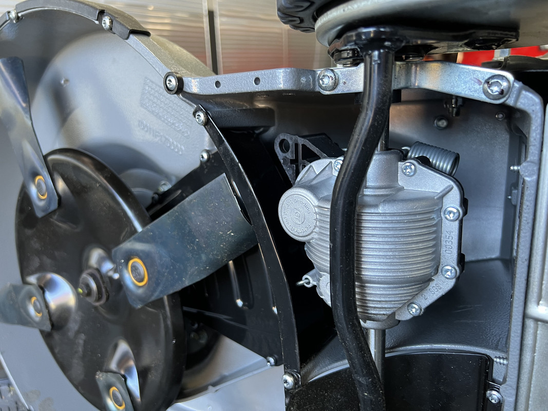

- Heavy Duty Gearbox (as used on the MulchMaster)

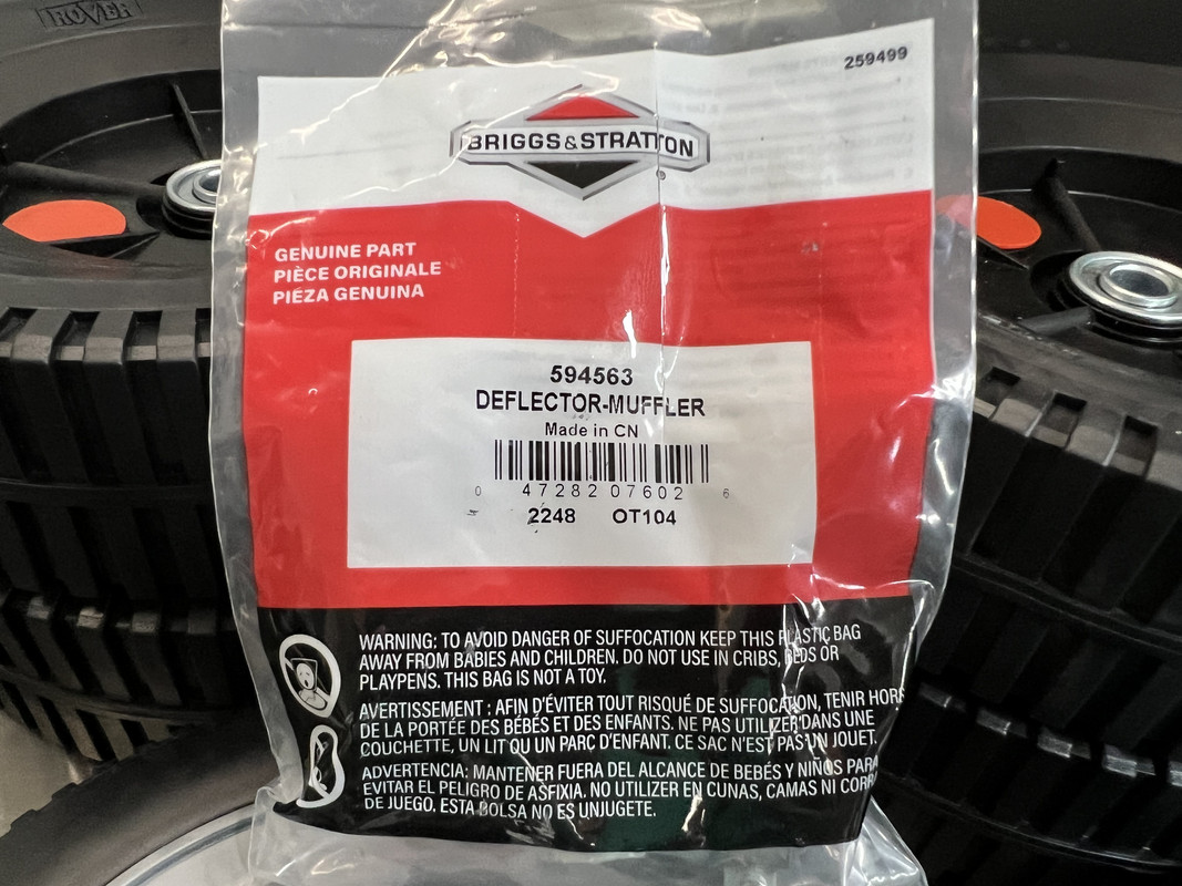

But there is no such thing as a perfect mower, so there are some compromises. The chief of which being the half rear chute. In the end, I sent an email to the supplier and kindly asked for images of the chute, which was promptly sent. From this limited information, the chute appeared to be slightly wider than the Bushranger, and certainly bigger than the Honda’s.
[Linked Image from i.postimg.cc]
Another thing to note, the belt rather than shaft driven gearbox is also a single speed unit, but the 5 kph speed is actually faster than the Bushranger’s 4.6 kph in top gear. And the Victa's catcher only holds 50 rather than 70 liters.

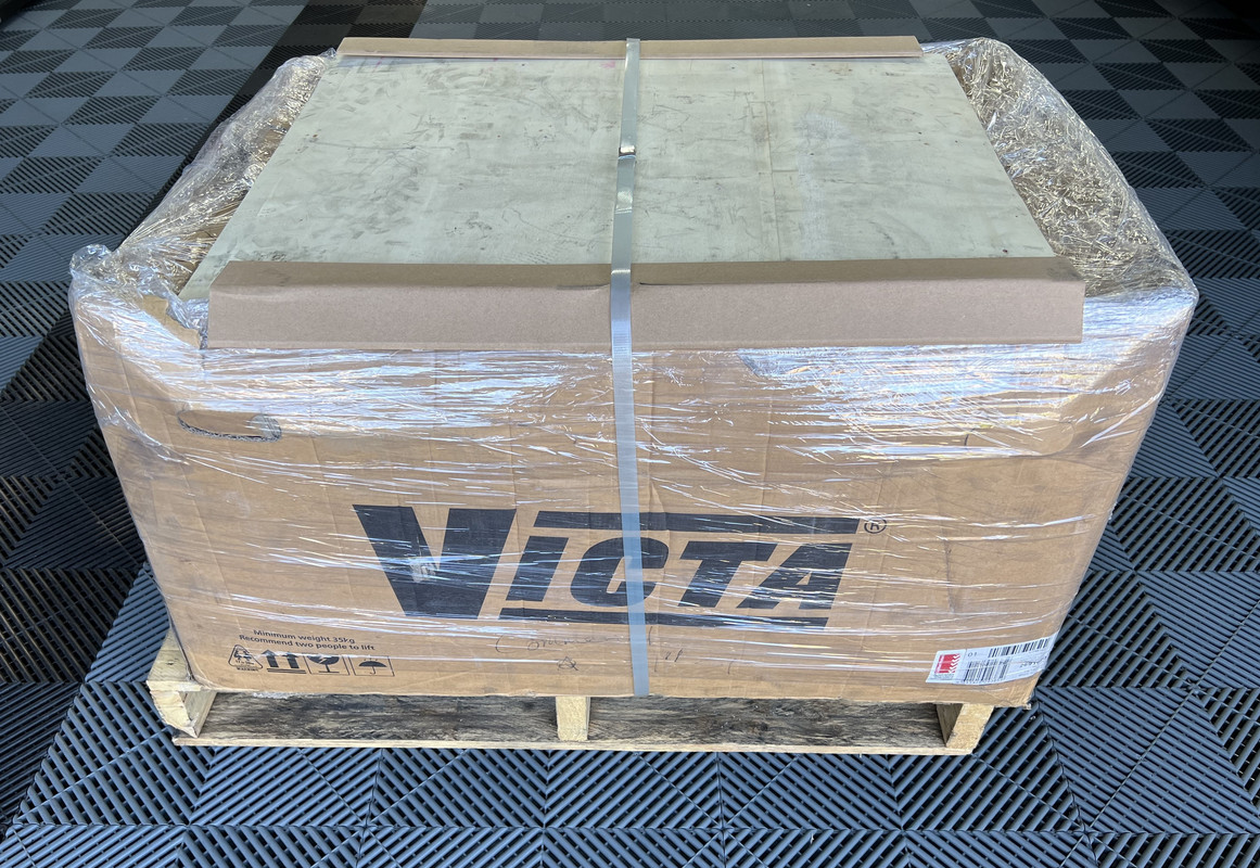

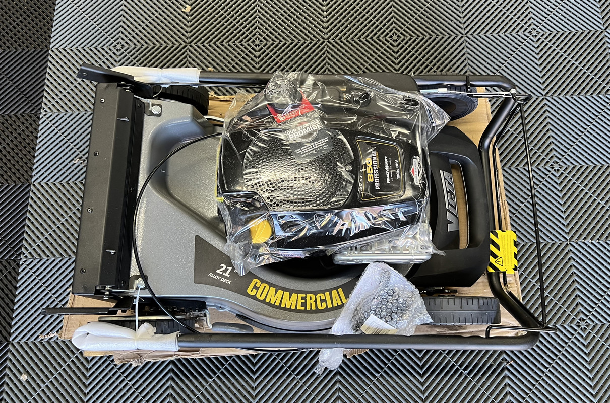

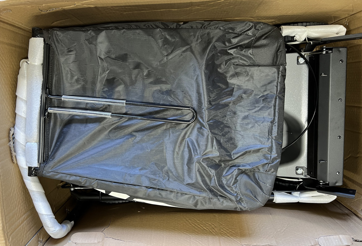

Un-boxing, assembly and fluids!
Victa’s are all semi-assembled and shipped in a singular large box. If bought from a mower shop, they will finish the final assembly as well as adding oil and fuel, an initial startup and inspection. In my case, having blacklisted the local shops, and no other neighboring towns stocking the Victa Commercial range, I bought this online from a vendor, which means I get the honor of getting the new toy up and running.
So, so satisfying.....................

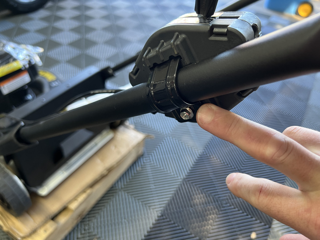

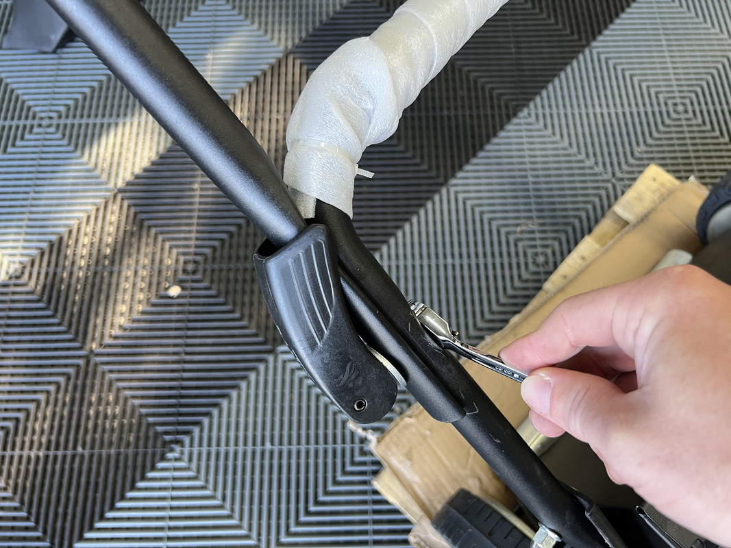

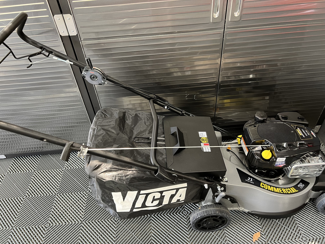

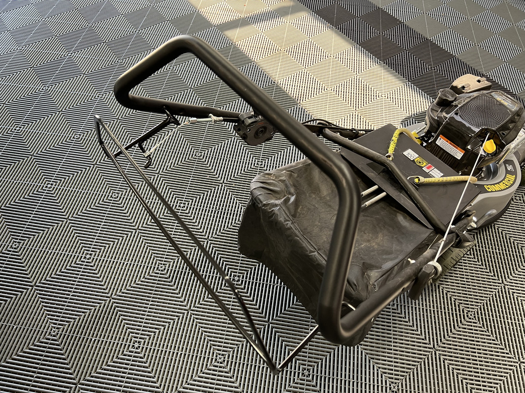

First step after opening and unpacking the box is to install the lower handle, angled side pointing up...........ask me how I know this............ rolleyes
Next, the upper handle is secured using the locking handle cams.

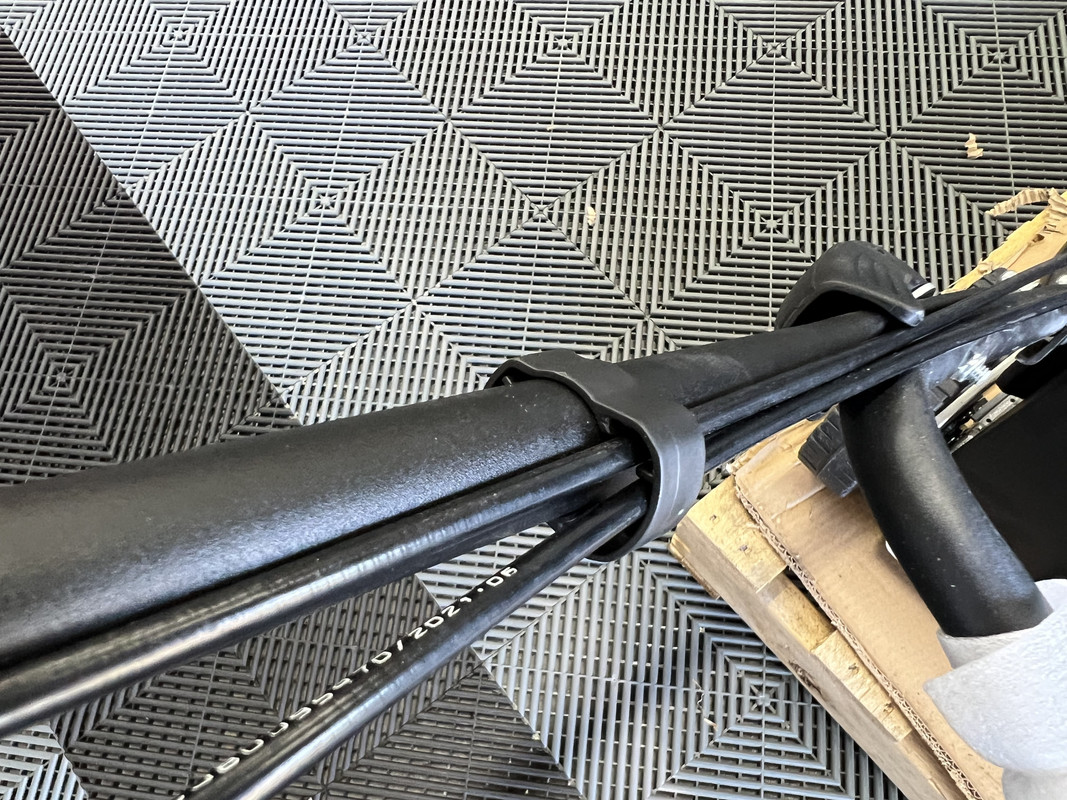

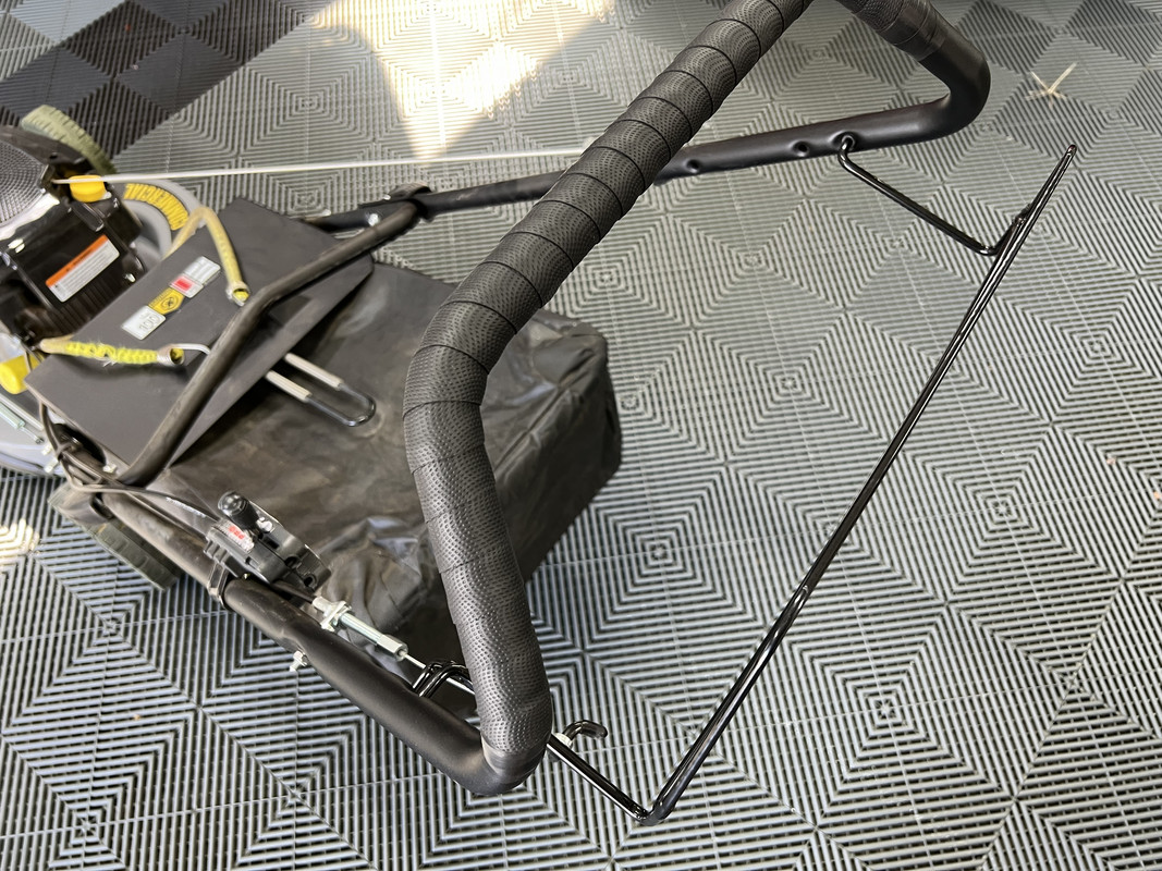

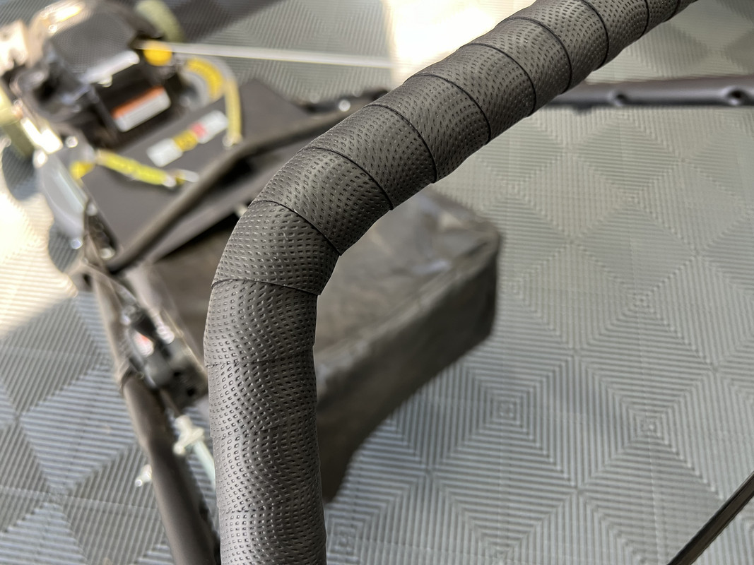

Throttle and clutch cables are pre-installed, but the throttle control needs to be secured to the handle.
At this point, you will need to make sure the cables are routed cleanly and without the possibility of rubbing on the catcher flap. Both cables are then secured with a plastic clip.

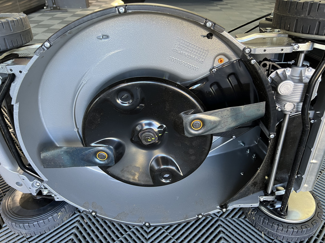

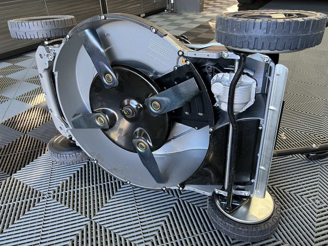

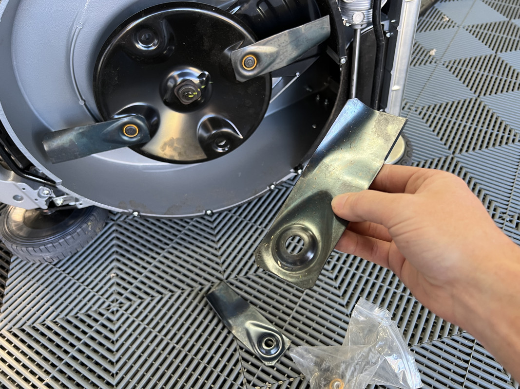

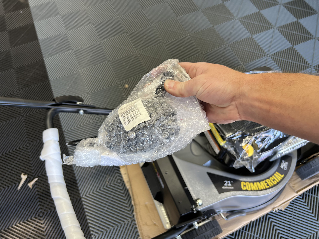

The catcher is supplied pre-assembled.
For some strange reason, Victa only fit two blades to this model, despite the unit shipping with a four-blade carrier. I'm not sure if this was the seller or Victa, but there were an additional two blades included in the box. I don't have a firm reason why they do this, all I can think of is the fitment of two blades would slow down the discharge of clippings into the chute, perhaps making it more manageable for the half-chute arrangement? Either way, I decided to fit the additional blades.

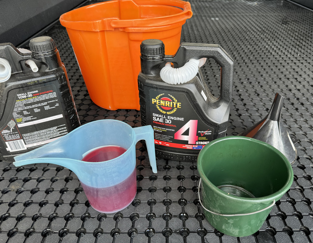

It’s then time for the vital fluids. Now, I typically use Penrite 10w30 semi-synthetic oil in my mowers. The exception to that being my older Briggs engines, where I use the SAE30 monograde mineral oil to help reduce oil consumption. For a new engine, its generally recommended to use mineral oil for the initial fill, before swapping to synthetic after the first 25 hours. In this case, 600ml of Penrite SAE30. Then a full tank of 91-ron unleaded petrol (I don’t bother with 95 or 98-ron).
Assembled, oiled and ready to go, the engine fired right up. This is the first 850 engine I have had with the newer plastic carburetor, which seems to idle a bit lower than before. As I always do, I'll run the engine in, change the oil and then up the revs to about 3600 rpm.

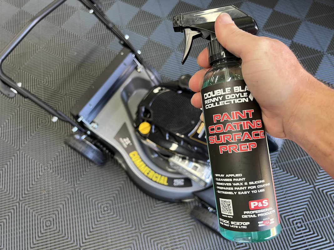

With any coating, its success relies on proper preparation. Prior to application, I gave the mower a thorough wipe down with IPA-based prep spray, in this case P&S Paint Prep. The coating was applied to all accessible surfaces including the deck, handles, throttle control, engine cover, valve cover, wheels and rear flap. Working in sections, the coating was applied, allowed to flash / sweat, then levelled with two towels.
https://detailingshed.com.au/products/p-s-prep?_pos=3&_sid=08ec4164f&_ss=r
As is the case for this coating, it's then left to cure for 12 hours before use or getting wet.
A seemingly pointless endeavor, but one that makes me happy. Actually, the coating has proven its worth in preventing dust build up, it also adds some additional depth to the silver paint and black plastics. So I guess its not so pointless after all. grin

Commercial grade gearbox -

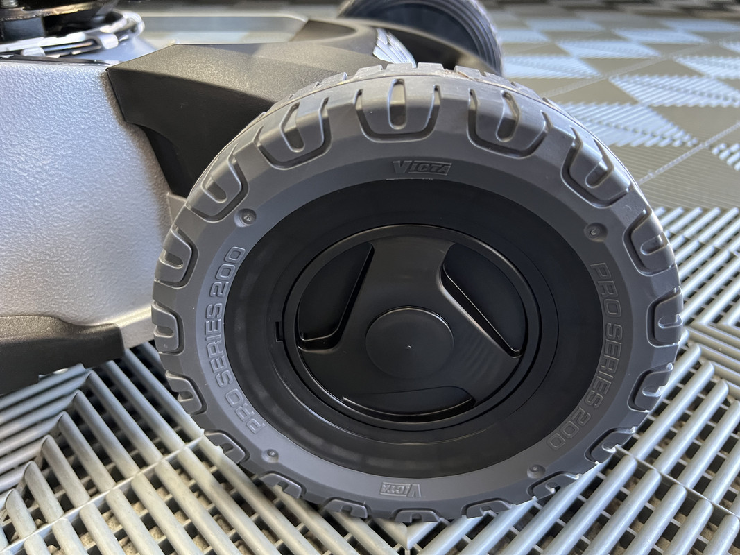

Commercial grade double ball bearing 8-inch wheels -

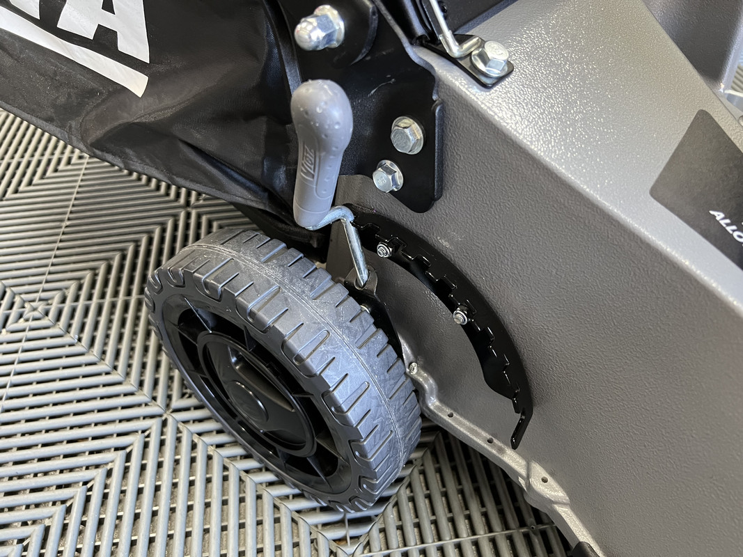

Steel height sector plate with 10 positions, ranging from 10 to 70 mm -

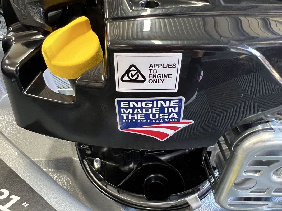

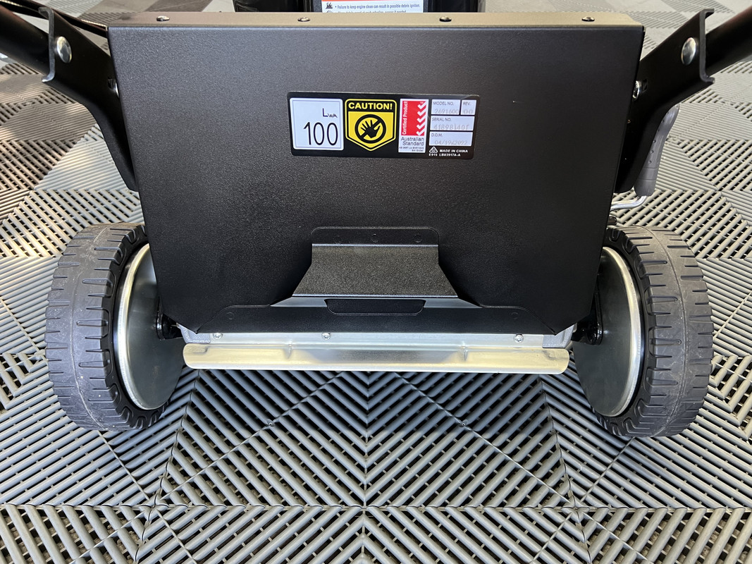

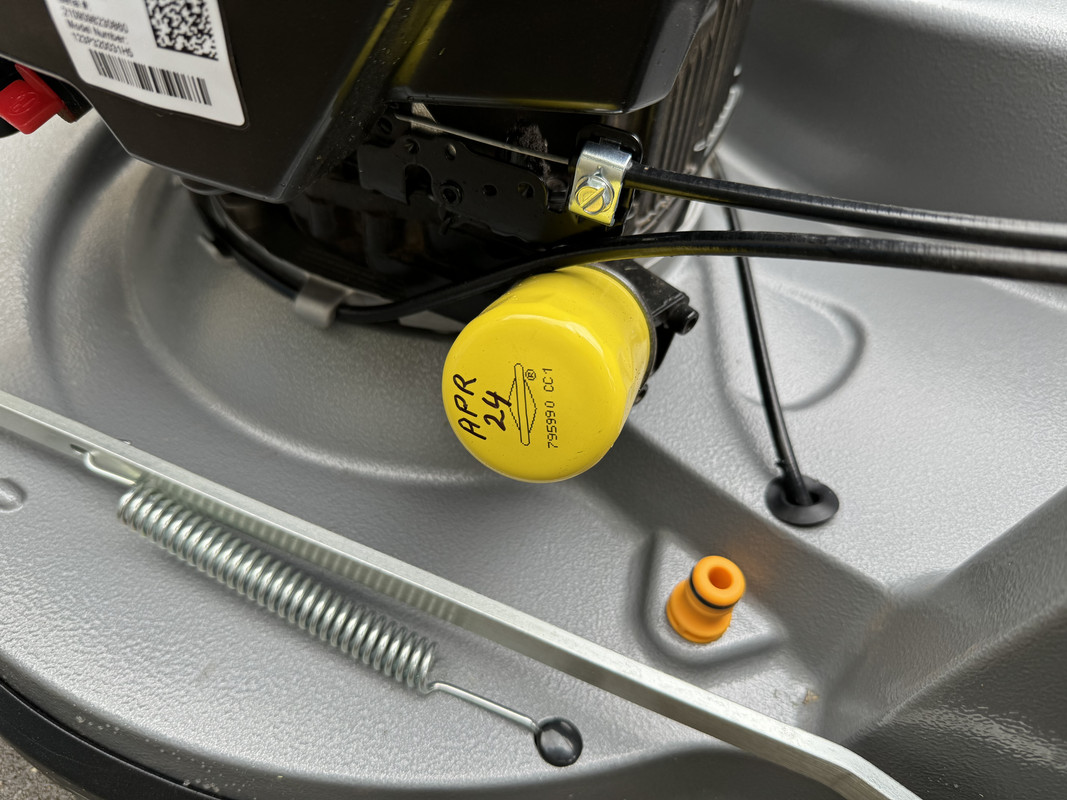

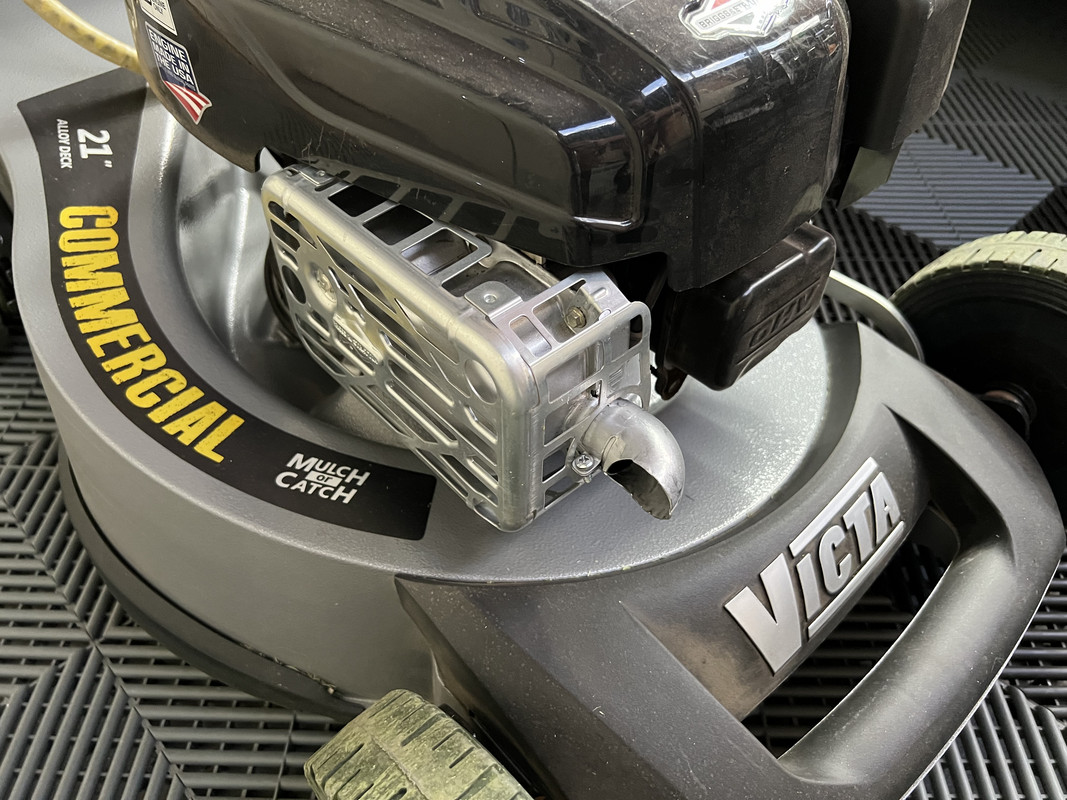

US-made Briggs & Stratton engine, 190cc, cast iron bore, automatic choke, spin-on oil filter and 11.5 Nm of torque -
Heavy duty front bumper -

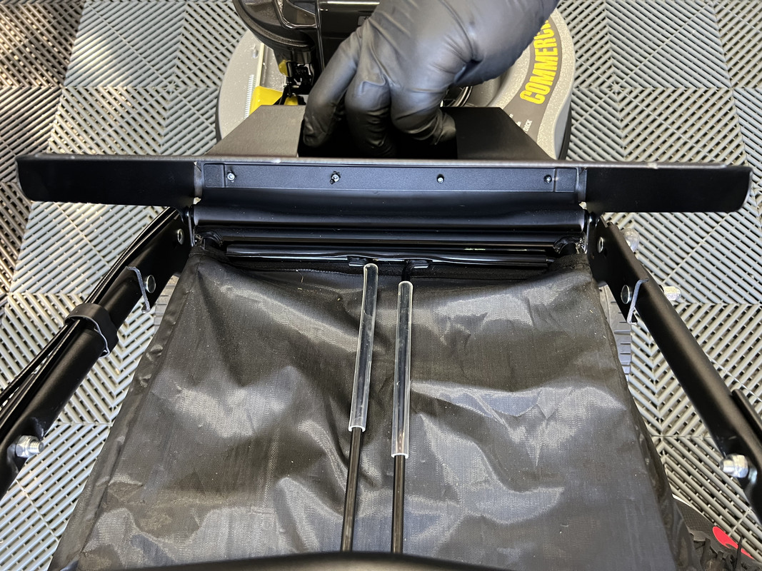

50L fabric grass bagger with heavy duty steel frame, double layer dust deflector and leather wear points on rear corners -
Steel catcher flap -
To be continued...........................

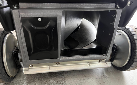

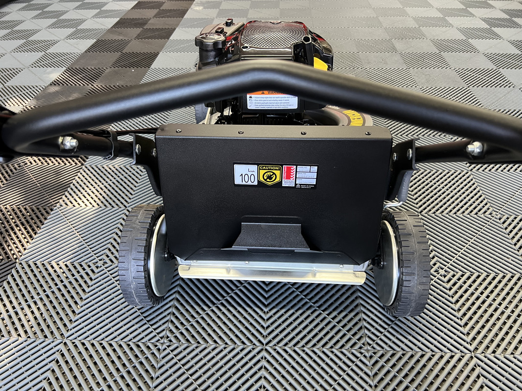

Rear discharge chute. I can say this is wider than the Bushranger -

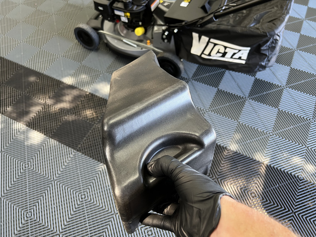

Plastic mulching plug -

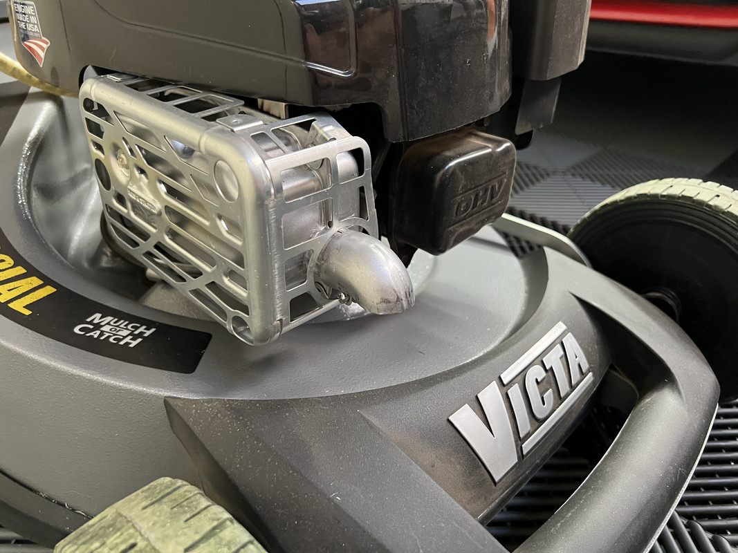

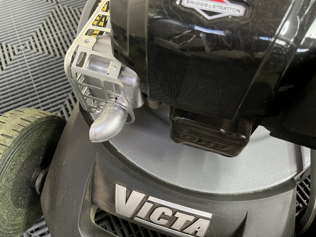

I have to say, these are a good-looking mower! The lighter grey deck, white Victa logo's and blacked out engine, wheels and trim look fantastic. I know this is just a lawn mower, but like any consumer product, it still has to look good in the showroom or brochure to attract your attention.

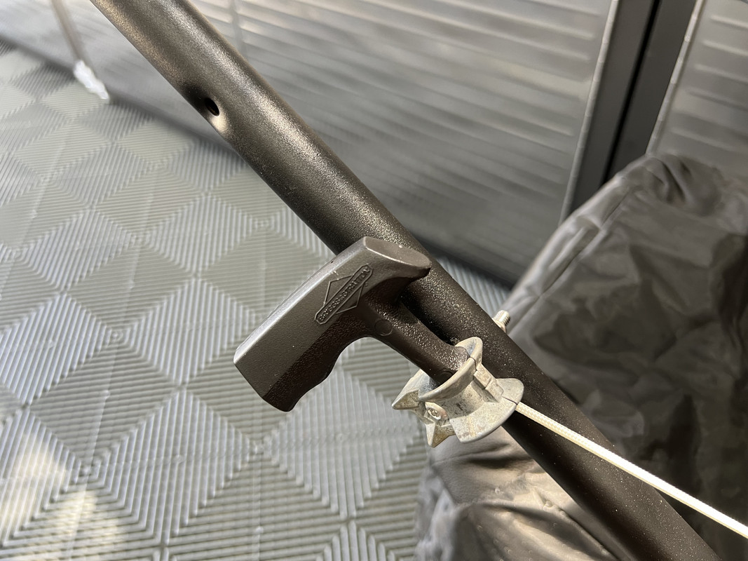

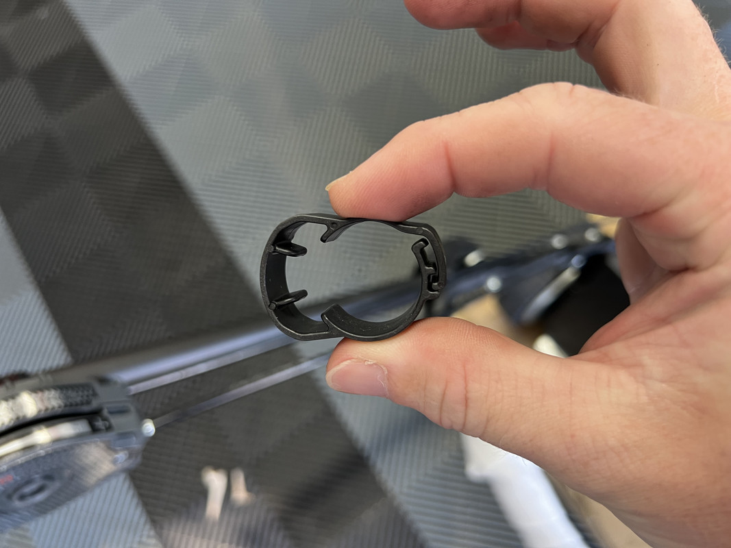

Missing from the spec list is a zone starter mounting, which I remedied with a clip I had in stock. Compared to Honda engines, the Briggs has a long enough rope to make this possible -

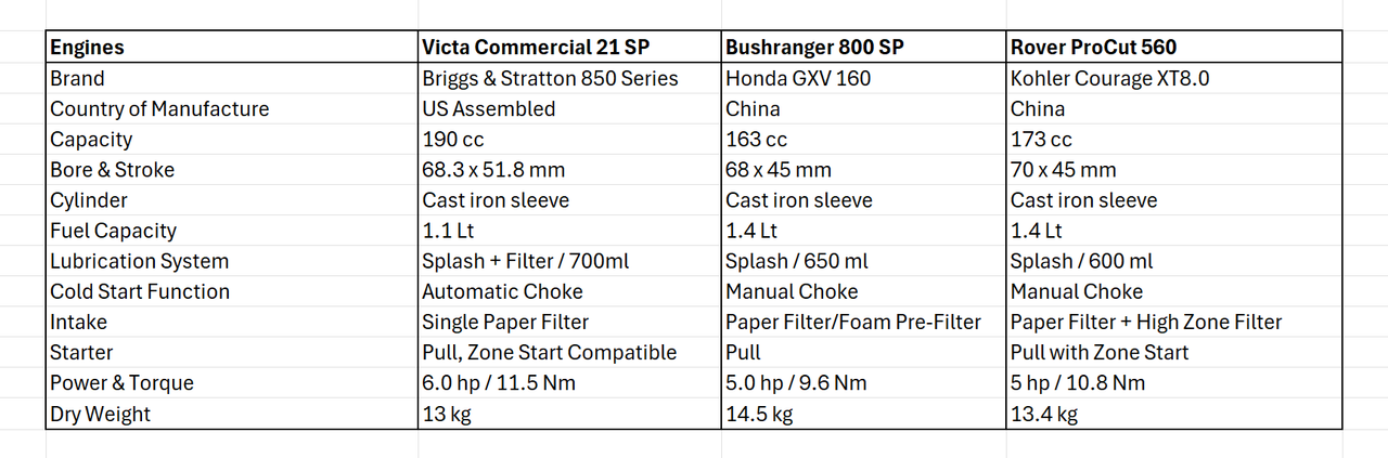

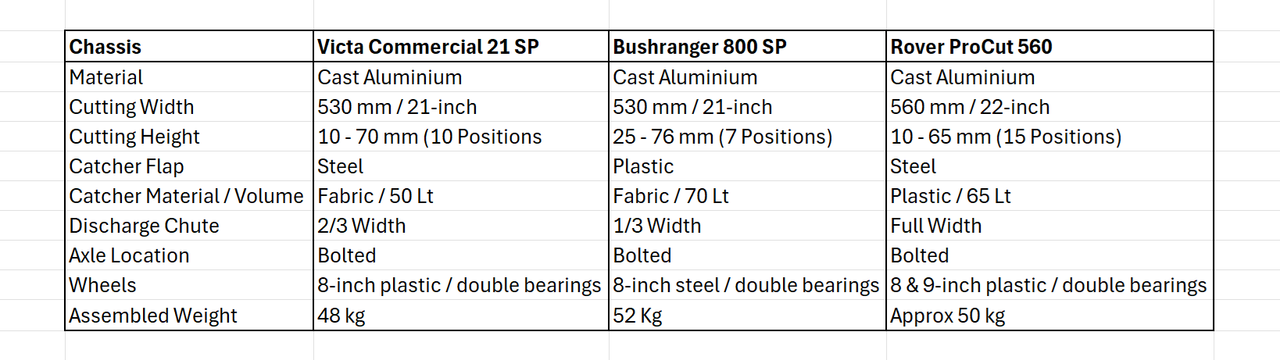

Who doesn't love a good spreadsheet!!!
This is a comparison between Victa, Rover and Bushranger's commercial grade mowers.
The above dry weights for each engine confirm what I have suspected for a while, the Honda GXV 160 is a heavy beast. That's not a bad thing, probably explaining why they live so long. The GXV 160 has always felt nose heavy to me as well.
Looking at the performance numbers, I would take those with a grain of salt. While the Krohler appears to have more torque than the Honda, in the real world the Honda is much stouter than those numbers suggest. However, the Briggs is in another league.
Fuel economy has the Honda first, closely behind is the Krohler, leaving the Briggs as the thirstiest, exaggerated by the smallest tank capacity...........its a big block after all. The Krohler is the easiest to fill, owing to the largest tank opening here, followed by the Honda, with the Briggs bringing up the rear.
I have always hated Honda's method of measuring oil on the dipstick as it makes accurate readings variable. The Krohler's dipstick has always been hard to read. The Briggs has the best dipstick here, easy to read, easy to remove and install. The oil filter on the Briggs is a nice touch, but largely unnecessary.
The Honda is also the quietest and smoothest running, the Krohler is easily the loudest of the trio with insufficient muffler performance, the Briggs sits somewhere in the middle.
And finally, the Rover's High Zone / Snorkel filter arrangement is a worthwhile addition, and a disappointing omission on the Honda and Briggs.

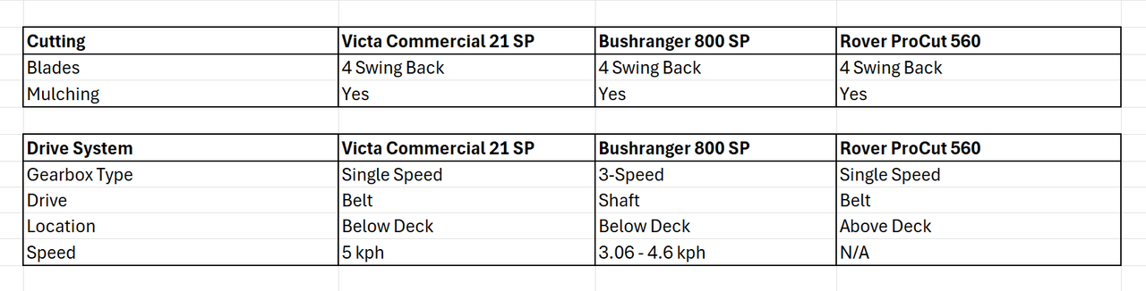

The Victa here has the widest range of cutting height, with the Rover offers more finite adjustment. The Bushranger has always annoyed me with the large gaps between positions.
I have always preferred plastic catchers, which the Rover therefore stands out in that category. The Victa's lowest capacity is disappointing but has the superior dust cover, extending further down than the Bushranger and has leather corners.
Weight wise, the Bushranger's ultra-heavy-duty construction is easily felt in use. The Victa seems noticeably lighter.
The shaft drive on the Bushranger gives a much more abrupt and audible engagement but does at least mean no belt changes in the future. Speed wise, the on-paper figures don't mean much as all three have had the engine speed lifted, which in turn speeds up the drive system. ( NOTE - I did that after running in the engine and changing the oil)

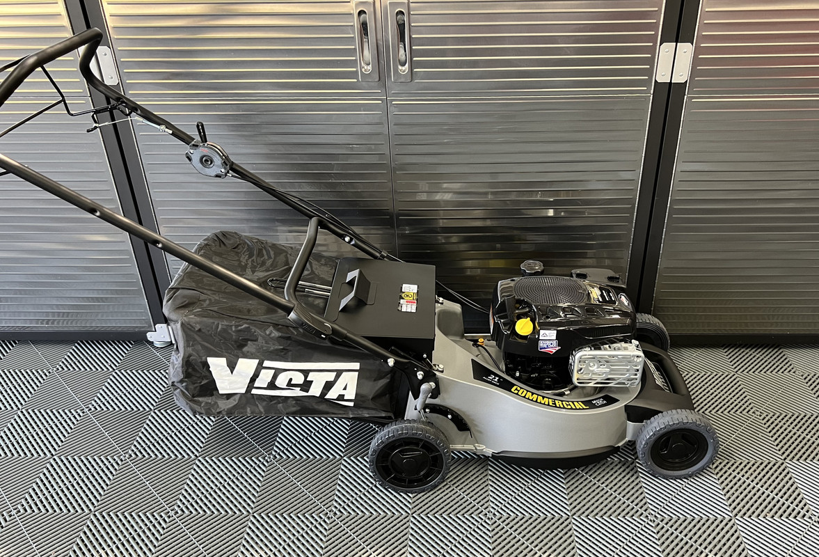

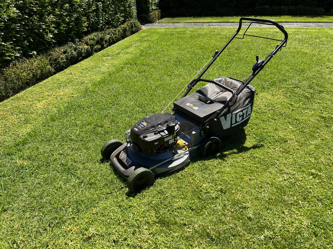

The First Mow -
Apart from a quick run over my front lawns, this was the first mow. In this case, I didn't catch, hence the grass sitting on the deck.
Walking speed was about what I expected. The drive bale could probably use a redesign, it's angled just a touch too low. Having said that, at the time it was more of a case of being used to the right-hand bale on the Rover, so it was a matter of getting used to the Victa. I also prefer the plastic tread wheels on the Victa, the rubber tyres on the Bushranger were prone to wear and would occasionally come off the rim. The Bushranger's fabric catcher is superior in design, being easier to remove and install. WIth that said, I much prefer the solid plastic Rover catcher.
The engine turns over much easier than either the Honda GXV 160, and especially the Krohler. That's one of the things that has always annoyed me about the Krohler, its unusually hard to pull over, like there's no compression release. The Briggs 850 proved superbly torquey out of the box, but it felt stilted. I hadn't put the tacho on it at that stage, but it was sounding like around 2800 rpm, which is just too low. Upping that to around 3600 - 3800 rpm is completely safe, makes for superior cutting and speeds up the self-propel too.
Tweaking the governor is not as easy as the earlier versions of this engine with the metal carb. Briggs have hidden the adjustment tab behind the air filter housing, but its easy when you know where to look. wink

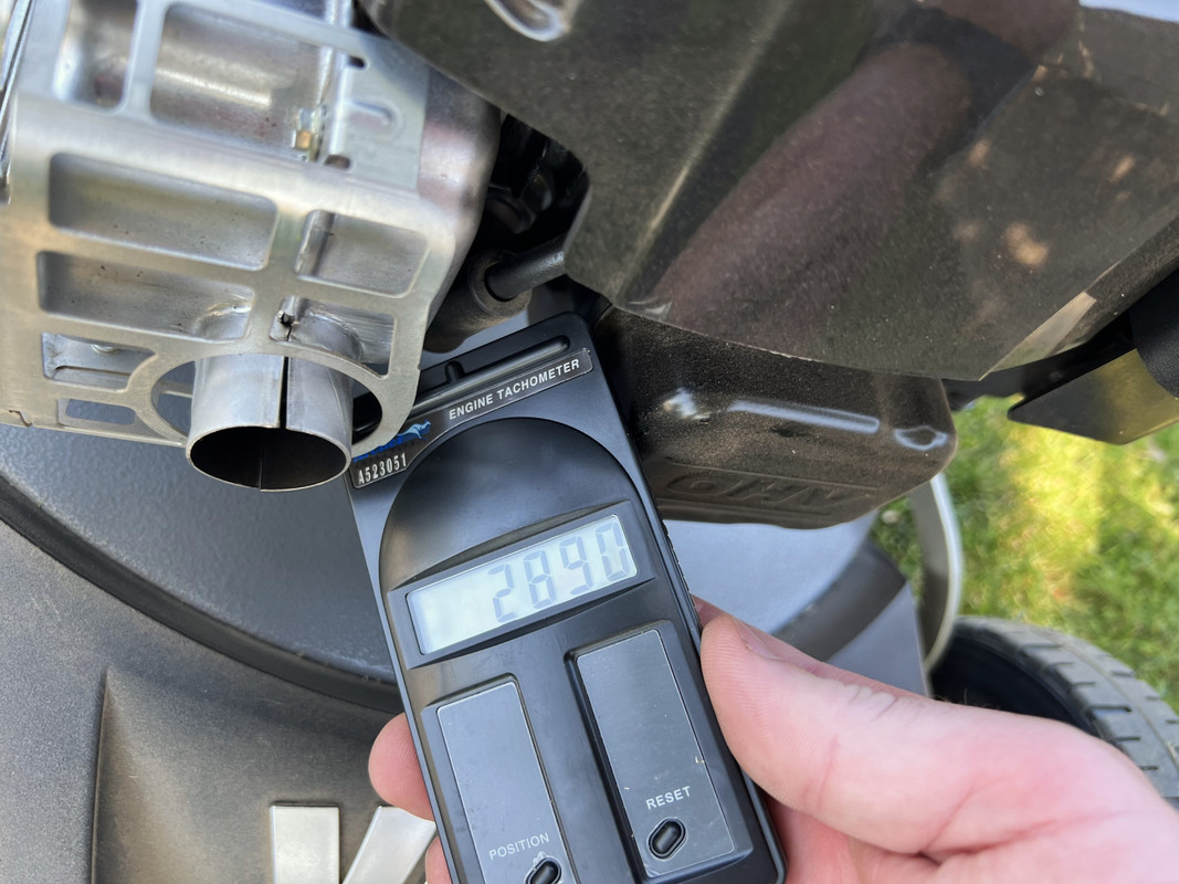

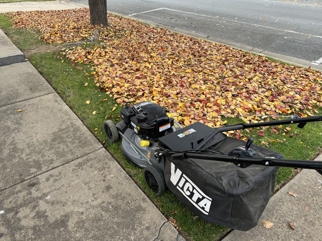

It wasn't long before the Victa C21 was being put to work dealing with two weeks of summer Kikuyu growth. I wasn't sure how the new unit would travel, so I took the old Rover with me as well.
After starting the run with the Victa, I then switched to the Rover at the next stop which is notoriously thick and tall after two weeks. Annoyingly, the Rover was not driving properly, I got through the job but it warranted investigation. That sort of meant the C21 was thrown into the deep end!
It's at this point I decided it was all or nothing! As predicted, the shipped governor position yielded about 2800 - 2900 rpm................
Two small adjustments to the spring tab had it running at above the 3600 sweet spot.
Now, before this adjustment, the engine would grunt through thicker stuff, but it wasn't powering through, and the walking speed was a touch too slow for my liking. After the adjustment, now we are in the ballpark!
The engine is now powering through thicker grass, which improves catching ability, which in turn clears grass from the deck and prevents the engine bogging down. The walking speed is now much better, not running speed but a decent brisk walk.
Now, just because I have the full throttle revs set at 3600 rpm, that doesn't mean I need to run the machine at that all the time. But the good thing is, I now have options. On lighter growth, run it at half throttle. On thicker grass, go full throttle and get on with it!

The Krohler? I've pounded that thing for years now and it's been extremely reliable................but I've always hated it! As mentioned earlier, its always been hard to pull over, often needed a second or third pull to fire. The thing has used oil from the beginning, never in a smokey way, but it just seems to consume it. The muffler is too small and makes it very noisy at full tilt. The dipstick is hard to read and made from nasty plastic. Overall, it just looks and feels cheaply made. But to be brutally honest, I'm surprised its lasted this long.
Anyway, here is a shot of the Victa Commercial 21 tackling one of my most challenging lawns. And the half chute? No blockages!

A Few Mods -

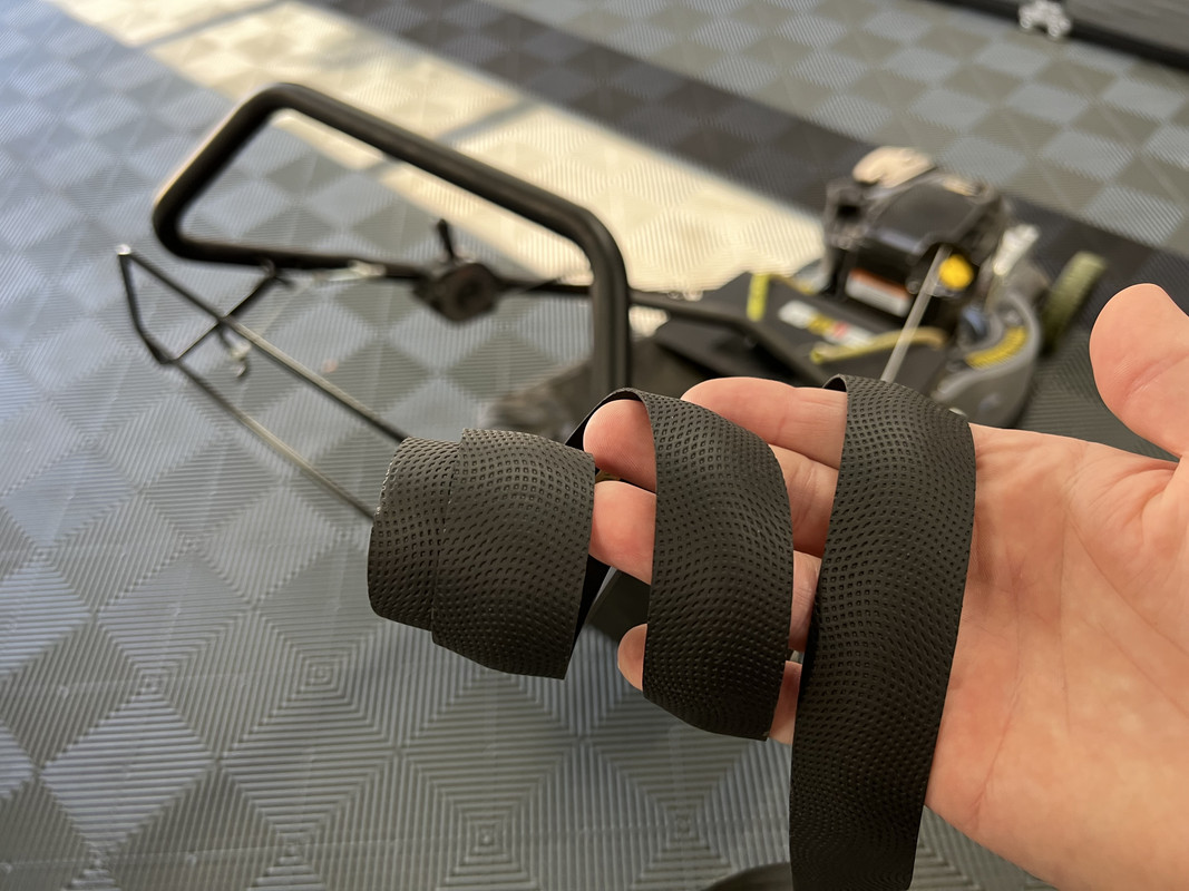

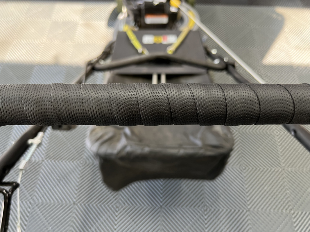

Something I have never understood, Victa don't fit padded soft touch handles on commercial grade mowers. This is despite the majority of the domestic models having this feature. On the Commercial 21, the drive bale was actually rubbing the paint off the handle, so this modification addresses two things.
As I did with my Mulchmaster, I decided to wrap the handles, the same stuff used on road bikes. In this case, the wrap is protecting the paint on the handle as well as providing a softer grip to grab onto. This stuff is readily available from bike shops or online, mine was from Amazon. I typically get a couple of years out this type of wrap tape, but its easily applied and removed.
https://www.amazon.com.au/dp/B07B21JF1R?ref=ppx_yo2ov_dt_b_fed_asin_title&th=1

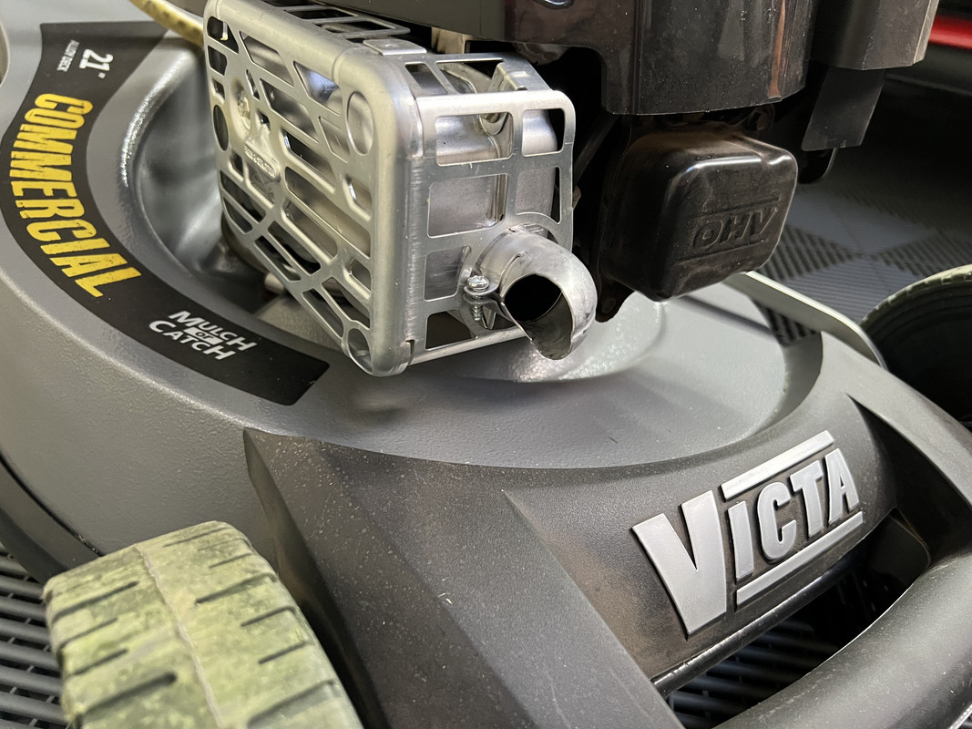

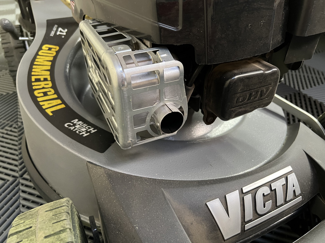

Just like the ceramic coating, the next "modification" is completely pointless, but oh so necessary for my enjoyment. grin
Yes, that's a muffler exhaust tip! Briggs and Stratton fit these depending on what the customer is asking for. For example, a lot of Masport's with the earlier version of the 850 came with one as standard.
The one on my Mulchmaster has been on a few mowers now, I grabbed it off a Masport before I traded it in.
Briggs and Stratton also sell these as a spare part. There are now two versions of this tip, the earlier example above has a smaller diameter outlet, the latest is much bigger and fits the newer engines. This larger version will also fit the domestic engines with the QPT muffler, mostly the 163cc variants.
Briggs & Stratton Part Number - 594563
Facing down, it reminds me of those dump pipes fitted to old muscle cars.

As I had intended, I'm trying to get some content out there on this mower. There just isn't much available, be that images or video. This thread is part of that, and so is the video below. It's pretty primitive, but it's a start...................
In this case, I'm mowing two Kikuyu nature strips, both with 2 weeks growth without irrigation. So, hardly its ultimate test, but at least gives an example of how the engine grunts through under load. I'm also running it on full throttle with the revs at about 3600 rpm.
I'm not one for pushing YouTube videos, I detest the whole "like and subscribe" thing. Rather, I use the platform to put some of my words into action. Having said that, this video is the most viewed video on my channel by considerable margin, proving what I had suspected in terms of a lack on content.
More to come.

The First Oil Change
Contrary to Breaks & Scrapem’s advice, you actually DO need to change the oil!
Some time ago, Briggs & Stratton determined that consumers don’t like changing the oil on their gas-powered lawn equipment. In fact, I would be willing to bet that 90% of gas-powered lawn mowers never get an oil change in their life. According to Briggs and Stratton, because of the advancements in oil technology and engine design, the engines run cooler and negate the need for regular oil changes. Those changes include improved air filter and oil filler seals, which limit the chance of debris entering the oil system. The subsequent tag line being “No Oil Change Required, Just Check and Add”.
https://www.briggsandstratton.com/eu...check-add.html
Briggs & Stratton even make note of the environmental savings made by not generating waste oil. I guess they have a point, but if the engine blows up because of degraded or a lack of oil, then I can guarantee Briggs’s would happily sell you another engine that took a lot of energy and natural resources to manufacture. Go figure.
Needless to say, if you want the engine on your lawn mower to go the distance, please change the oil!
NOTE - The above information applies to the consumer-grade EXi OHV engines. This includes the 150cc and 163cc engines fitted with the paper cartridge air filters. Also included, the 190cc 875 EXi, which is the same engine as the 850 fitted to the Victa Commercial but doesn't come with the cast-iron bore, hence being considered consumer-grade.
https://www.briggsandstratton.com/e...es/lawn-mower-engines/625exi-series.html
https://www.briggsandstratton.com/e...es/lawn-mower-engines/675exi-series.html
https://www.briggsandstratton.com/e...es/lawn-mower-engines/875exi-series.html
When I first took delivery of the Victa Commercial 21-inch, I filled the engine with the recommended SAE-30 mineral oil.

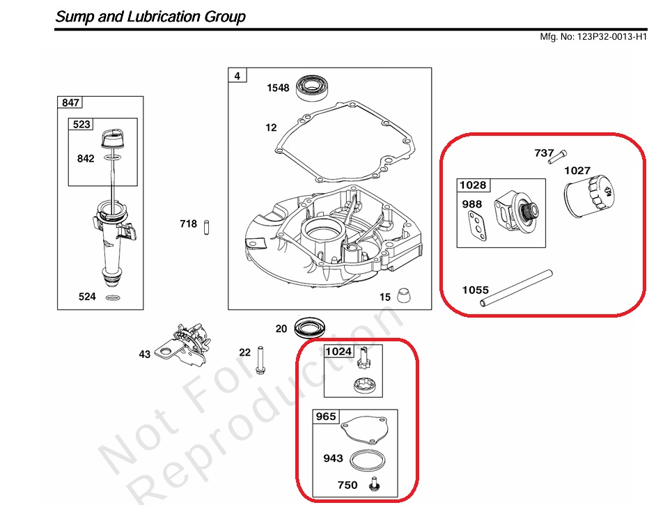

Having outlined the "No Oil Change Required" above, that actually doesn’t apply to the 850-series engine. I would suspect that relates to these engines being primarily for commercial users, meaning they are being used far beyond the average domestic lawn mower engine. As such, Briggs recommend the first oil change on the 850-series be at 5 hours of use, then every 50 hours or annually going forward. The oil filter replacement is also at 50 hours.
After the first oil change at 5 hours, I go a bit more conservative in doing oil changes at 25 instead of 50 hours. I would normally switch to 10w-30 semi-synthetic at the first change, but I've decided to run SAE-30 mineral for another set.
For oil filters, I do them every second oil change for a couple of reasons. Firstly, the filters are $20 each, which is quite expensive for such a small filter. Secondly, I just don't see the need considering the frequency of oil changes.
Engine Oil Capacity – 540 to 590 ml (wet fill)
Oil Filter P/N - 795 990
These engines can be drained from above or below, but I have always drained them from the dipstick tube to avoid taking off the blade carrier. I've recently invested in an oil extractor to hopefully make oil changes quicker and easier.
Either way, make sure to clean around the dipstick tube beforehand, which you should be doing anyway when checking oil levels. All waste oil is put in an empty bottle and disposed of at the council collection point. I actually rinsed the mower down prior to the oil change, the ceramic coating easily shed the dust debris that was clinging to the deck. See, there was method in my madness! grin
Once drained, the mower is flipped back up and the new oil added, reserving about 100ml. I then check the dipstick, adding the final 100ml in steps to the correct level is achieved. If the oil filter is changed, make sure to check the oil after a quick test run and add more oil if needed.
As a way of keeping track, I put the date on the oil filter to indicate when the last oil change was.
Something I only just now realized, the 850 engines fitted with an oil filter actually have Pressure Lubrication with an oil pump instead of the splash type lubrication on the rest of the Briggs push mower engine lineup. I've had a few 850's over the years, some have come without the oil filter, some have, including this Victa and also my Mulchmaster. I thought I knew everything about these engines, clearly not.

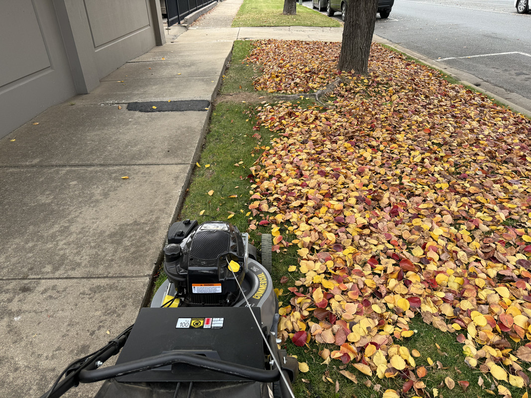

Leaf Vacuum Duties
The following is from Autumn last year...........................
Despite appearances, the above and below image is before I started cutting. The technique I use is to blow all of the leaves from the gutter and paths onto the lawn, in the process clearing a path around the perimeter to avoid the mower blowing leaves back onto the pavement. I then get to it...............

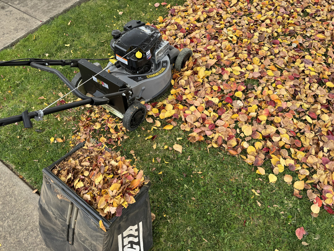

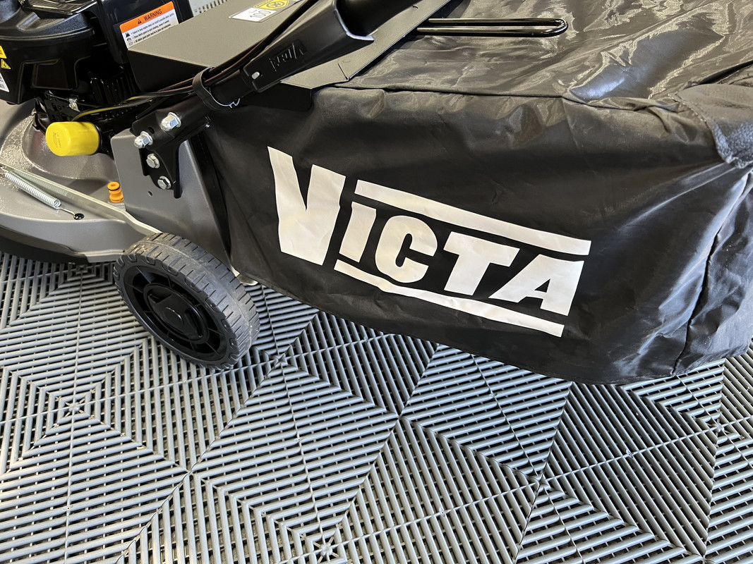

The machine has no problem packing the catcher full. I have found this particular fabric catcher to be harder to empty than Bushranger's similar arrangement, the opening isn't as wide and requires quite forceful shaking to empty. The lack of a rear handle really hampers your progress here.
Bushranger for comparison, note the rear handle that is missing from the Victa............................
Returning to the Victa, this is after the initial cut.....................
From there, most would be happy, but I then go around with the blower again and re-cut the area to suck up any remaining leaves. With so many more leaves yet to fall, it's probably a waste of time, but I have high standards!
For leaf vacuuming, I would normally be using my Rover ProCut 560 or a 2-stroke Victa for this role, the Rover for its full width chute and massive catcher, the Victa 2-stroke for its sheer power. The Commercial 21 with its partial chute did surprisingly well in this case, the engine barely raising a sweat.
A few additional notes on the 850 engine -
1 - It’s easier to pull over the Krohler or Honda. The Krohler feels very heavy, like it doesn’t have a compression release. The Honda’s rope is too short, meaning it doesn’t permit a zone starter and reaches the end of the travel on each tug.
2 - It can power through thick Kikuyu that has the Honda or Krohler bogging down.
3 - The quick release air filter cover allows for more convenient filter cleaning. I like to tap the filter out after a big day, something that is discouraged on the Honda and Krohler arrangements with the wing nut style fasteners.
4 - Even though I have it revving harder than standard, the 850 is quieter than the Krohler and Honda, in particular producing less high frequency muffler noise across the rev range. The Honda does idle quieter, but only because of a slower idle speed. This will sound deranged, but I actually love how this engine responds to a rapid full throttle action, it has such a rorty sound to it.
The 850's only major failing is its thirst for fuel, exaggerated by the extra revs I have it at, but in every other way it’s the perfect modern lawn mower engine.

Ive adjusted the governor, to give a bit more speed and stop it bogging on long buffalo. Its was a lot slower then our old one.
