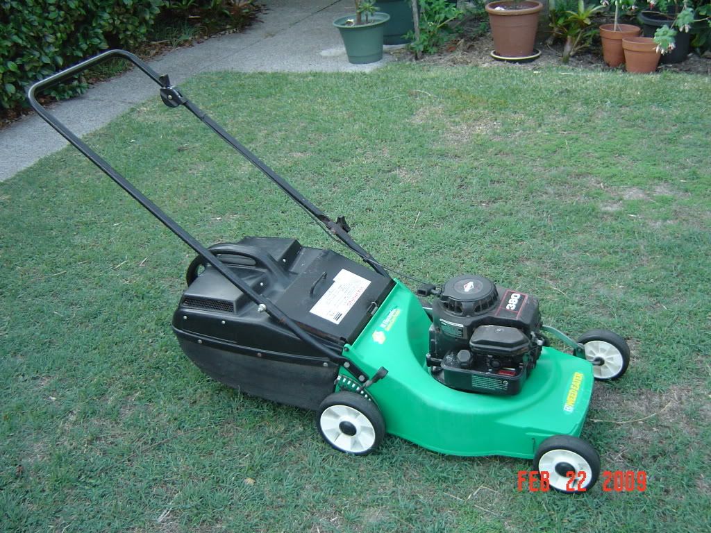

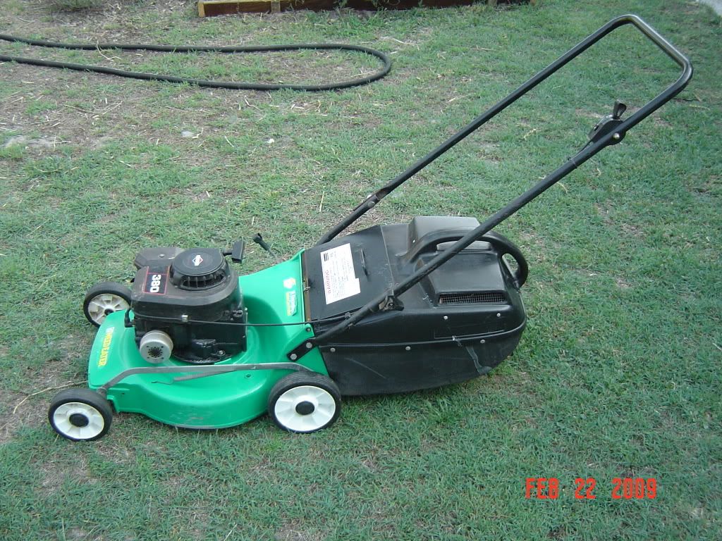

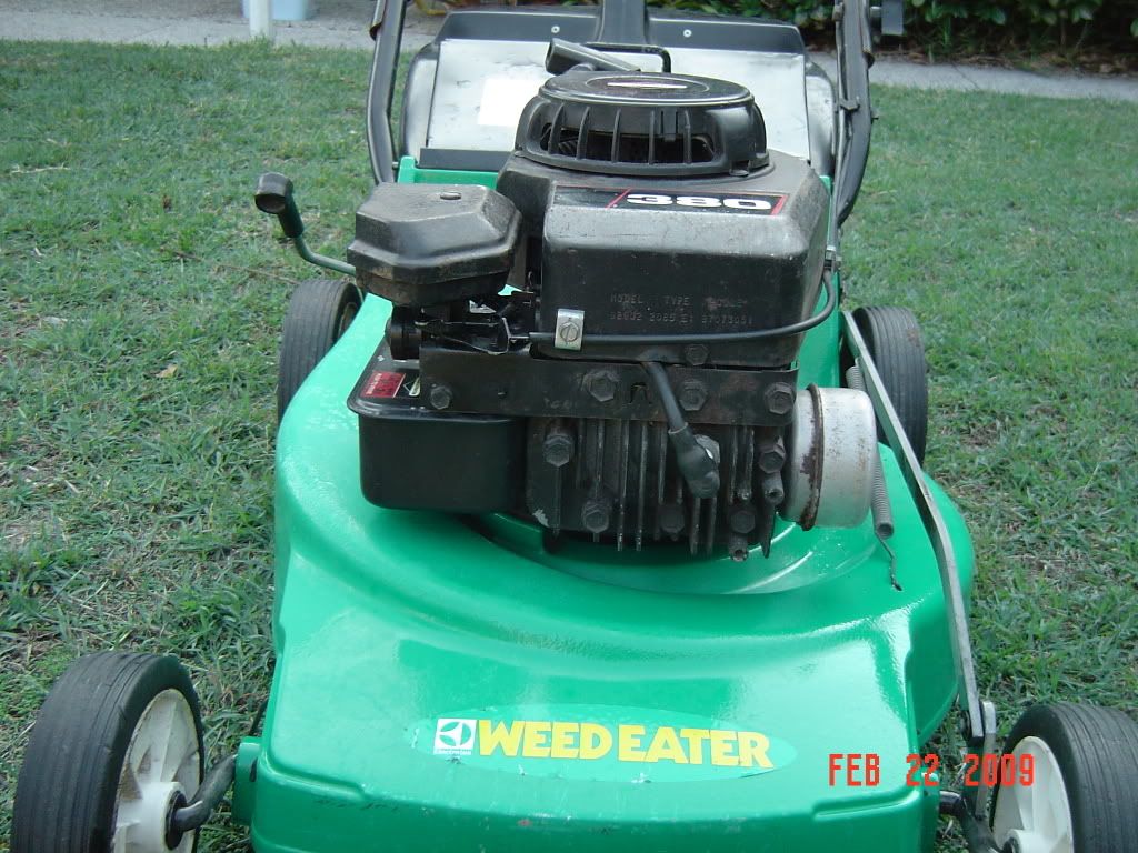

Was driving past a house near my place during a council cleanup day and spotted this 4 stroke, so I walked back and grabed it since it looked very good! B&S motor etc.
I went outside my rules (Victa 2T's only).
Got it home cleaned the air cleaner, carby and the fuel tank (was full of mud) and it started first pull! I reckon it still has the original blades, and they are still ok!
Very unusual carby setup, but it works.
[Linked Image from i256.photobucket.com] [Linked Image from i256.photobucket.com]

This is the same lawn mower i have in our shed but it has carby problems and the local mower shop tells me you can only buy the diaphram for them. They run small ball bearings around the carby in various spots and it will only keep running if i push the primer. Otheriwse the revs slowly drop and it dies. Is a great mower apart from that.

Can't pull the carby apart really. Its one piece plastic. I spose i will have to keep looking for a new one. Do you know if its possible to remove the little ball bearings? Mower shop told me they are pressed in. I think they are the problem.
Once off the tank you can get at the main areas to be cleaned, the primer bulb is easily removed by pressing in the little plastic tabs on either side of it.

I have tried to clean the carby out. Took the primer off and blew it out with some air. It does have a problem priming too. i Have to block the vent holes in the fuel tank to get it to suck fuel into the primer bulb. Would be much easier with a carby that can be taken apart. But it will only run for say... 30 sec to a minute before the revs slowly die and it eventually cuts out. However if i keep hitting the primer it will keep running. Which makes me think maybe its sucking air somewhere. What are the points of the Balls anyway? I can't see any explanation for it as they can't be removed at all.

I have had the carby off the tank numerous times and have cleaned the fuel tank out with clean fuel and blown it clean with air. I have had the suction tube off the carby and it is clean and also the other pick up that has gauze on it is clean as well. Could the metal balls that are in the carb have anything to do with it? If so can they be removed at all? As 1 or 2 of them are pushed in a fair way.
Josh
The top one (in the pic, should return after pressing on it, as for removal I have never tried. I do know however if the top one gets stuck in it is very ******* hard to start if it does at all.
