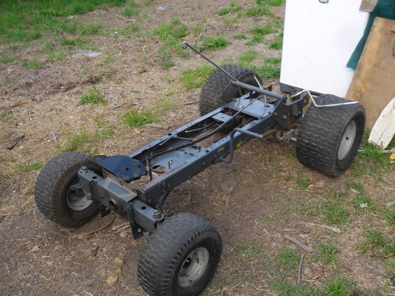

We stripped it down to the chassis.
photographing each stage to help with re-assembly and to indentify faults or things that could be improved.

We stripped the mower to just the chassis, verified all the pulley's and levers were good and stripped the steering, and most of the connections. (the previous pic shows the front end partially broken down) As it was original only to be e rebuild we didn't completely dis-assemble the chassis. It was in very good condition and would have been a waste. We did of course take to it with a toothbrush and many miscellaneous cleaning implements to make sure it was as clean as the rest of unit.
Many hours and much frustration.
Any shafts were slid out and tested, if needed greased, cleaned, lubed or spaced with the correct washers for good tolerance and minimum play.

Here's a little close up of two of the issues that we had fitting the larger engine.
Firstly the engine was longer.
Secondly the exhaust spat straight into hood. It really kills the paint.
Here I'll show the extension and later some better pics and much later (when the rain stops) I'll outline the exhaust solution.
Here you can see where the bonnet hinges and further back a bolt.
Just forward of the bolt in the original tinware was the mount for the bonnet (hood if you're a yank).
I made a pair of brackets from some scrap 2mm plate which moved the hinge point 65mm forward and 20 upward.
I used the rear bolt holes to hold the brackets to get perfect position and then welded through the original hinge holes to the brackets.
Then of course I dressed the welds and primed, prior to final paint.
In the top left you can see the problematic exhaust ('zorst if you're a yob). The small spot welds holding the baffle were dressed back clean with a Dremel (I love my Dremel) so the deflection pipe would would fit cleanly, I'll show that in the near future.
