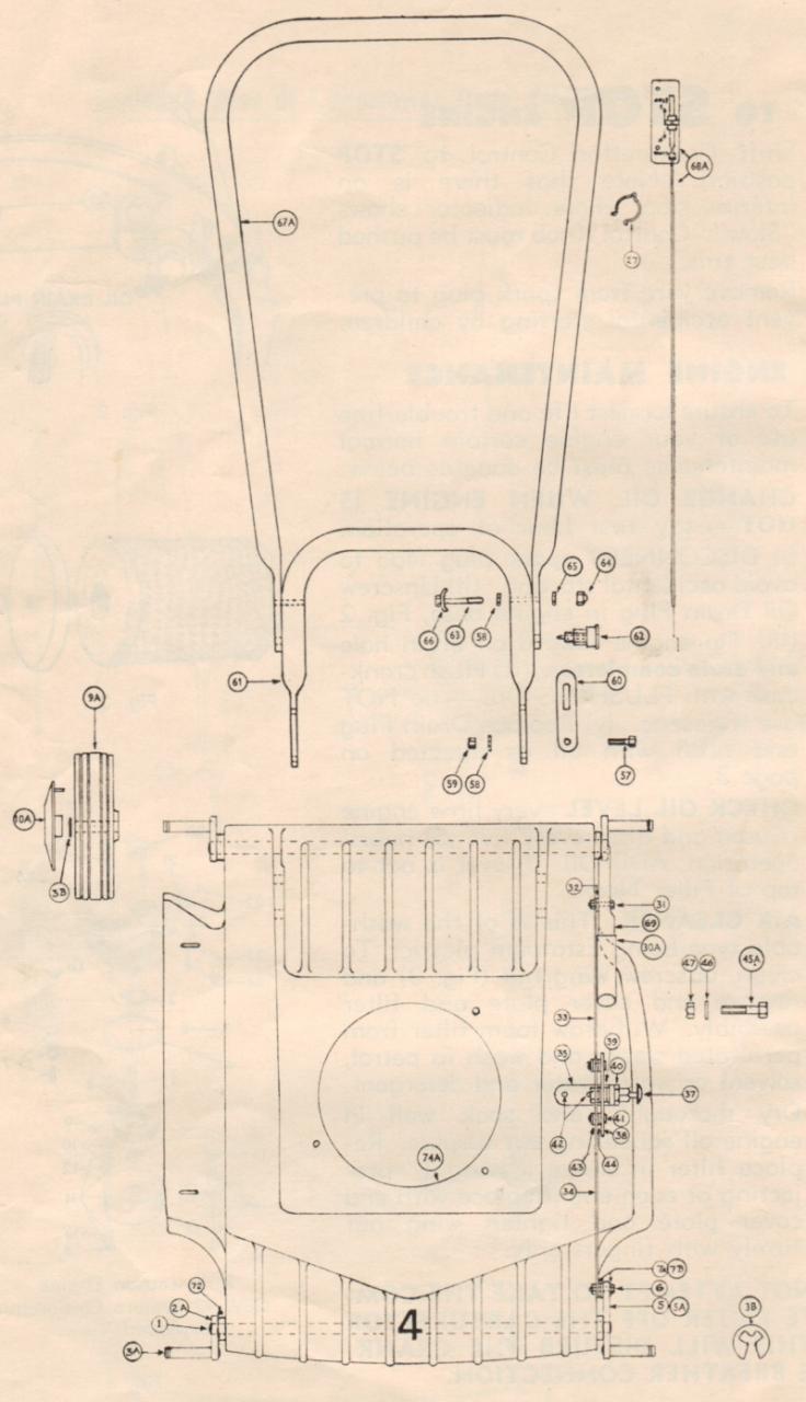

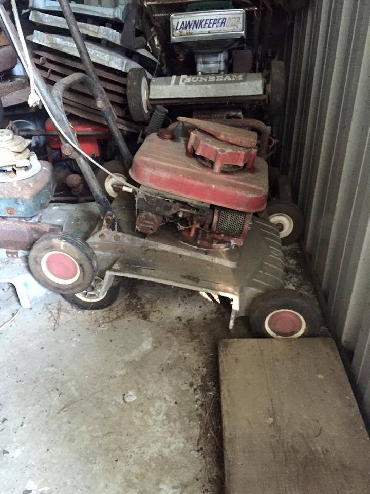

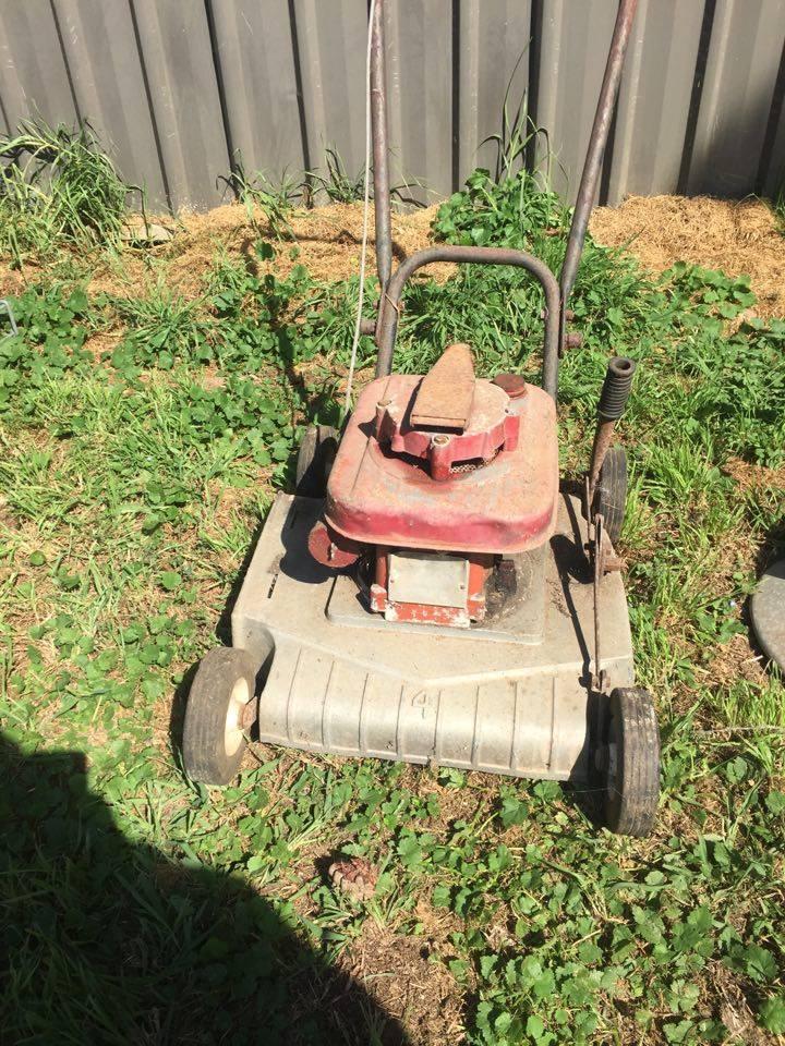

I have been asked by someone on Facebook identify there mowers so they can sell, It was an easy task, with most mowers given a name, rought date and rough price. But one mower i could not identify. I am sure someone on this page, most likely Jack, will know what this mower is. So far the only other one i have seen was on ebay, it started at $30, but over a couple months it droped to $15 and another engine was added to the sale. I did not want to tell them that that is what its worth until i knew a name and some info behind it. What i find very interesting about these mowers is the "4" on the front of the base, i have seen plenty of mowers with an "18" on the front but never a "4". I have asked the seller to get a picture of the engine plate.
Front on picture.
Side on picture.
Thanks for any info you give!

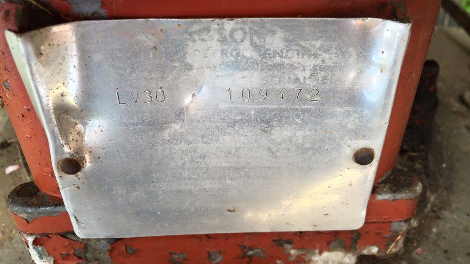

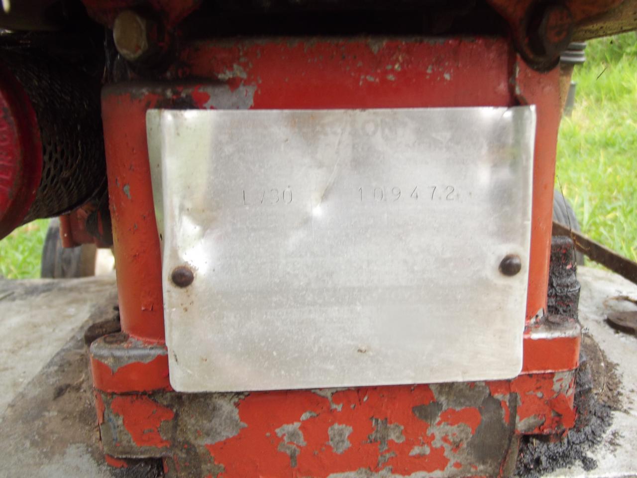

We just got a picture of the name engine plate, perhaps if we darken or brighten the image we can see if it has faded words on it. We now have some codes though.
has been cleaned up

Hello Kye
The "4" is for 4-stroke.
These bases (and variants) spawned a number of store brands across Australia.
I do believe I am the first fool to identify what it is ... [drum roll] ...
It's a Hurricane 4 (the same people who made the Hurricane engine).
Date: early to mid-1960s.
This does not necessarily mean it was sold as such.
Most interesting feature: the central height adjuster.
p.s. another one of Patrick's Kirbys.

Hi Kye and Jack,
Kye I'm surprised you didn't pick the name plate to be similar to mine!

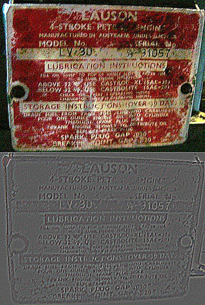

Anyway I've had a play with the image from the website, can't improve it much, unlikely to add much to what you already know:
"LA?SON" = LAUSON
"... PETRO? EN?INE" = ... PETROL ENGINE
"... SERIAL..." = ... SERIAL NO
"LV30 109472" = Model + Serial No
".... INSTRUC?ION" = ... INSTRUCTIONS
Patrick

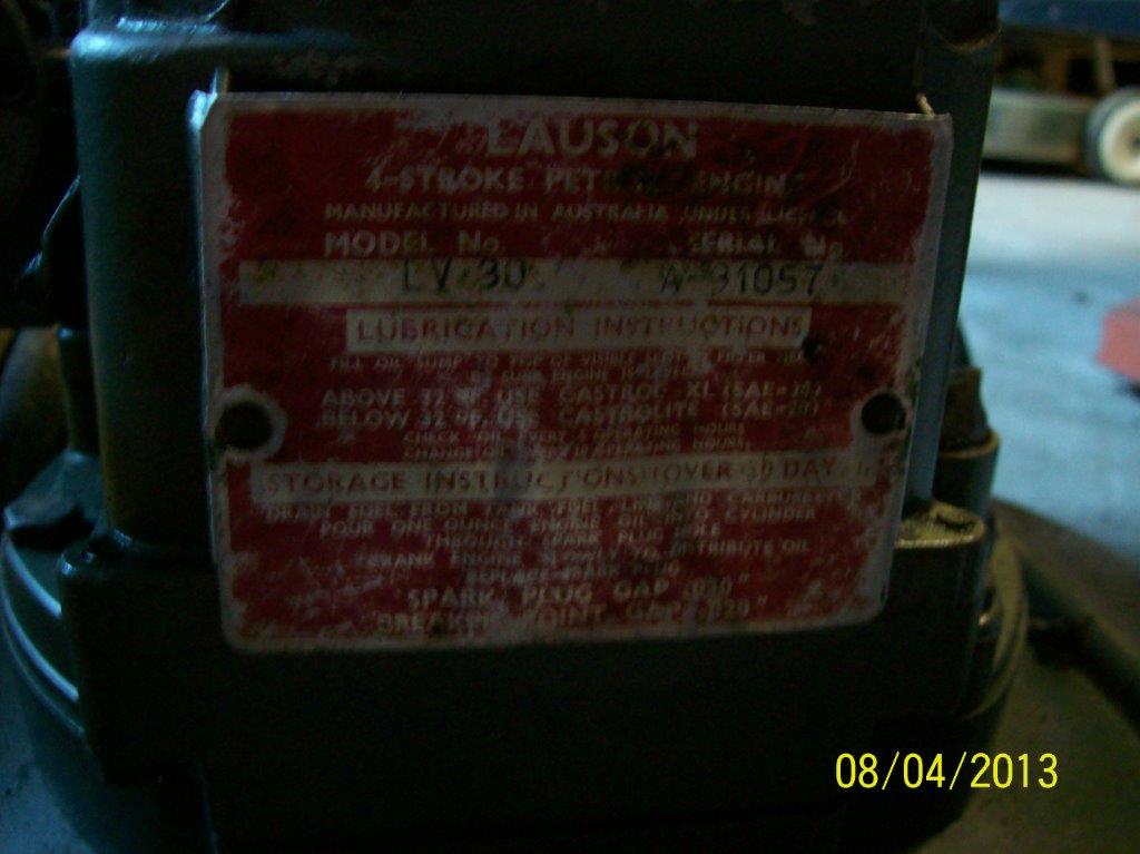

Here's a rather dark pic of an LV30 data plate, from THIS past ODK thread:
Good enough to get an idea of what info yours originally had, anyway.

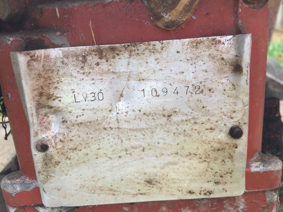

Probably doesn't add too much, but here are some 'enhanced' images of the plate Gadge posted a couple of posts up. Just some more readability/legibility.
Patrick

Gday Kye. this is the faded plate on the front of the motor LV30. 109472.
as for what i plan with this mower. slowly slowly i recon. the blade plate needs removal and refurbish. the bore looks nice and smooth(after cleaning the top of the piston) but for now i have just put a cap of oil in the pot and turned over by hand a couple of times, cleaned fueltank.and removed carby. would anyone know of a muffler that would be original? i recon i have no chance finding the original colour.

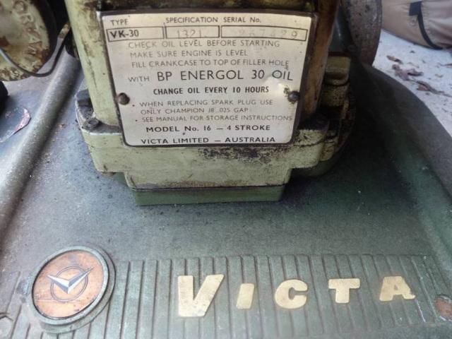

My Eric Anderson has a Lauson serial no only 7000 or so after yours. Yours doesn not seem to have had the sticker mine does, and yours is held on by screws (rusty) whereas mine was aluminium pop-riveted (I suspect).
The muffler on it is a small cylinder similar to yours but with a square aperture and two bolts on the outside face. It's a silver/tin colour, not rusted and I suspect it's not the original. But it does seem to be designed to fit and has been in use (carbon deposits around exit).
I note the engine colour of yours seems less faded than mine but more chipped.
Good luck with your restoration!
Patrick

Hi all Contributors

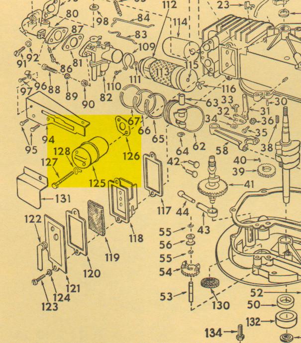

The standard VK30 (LV30) used a two-bolt hot dog job.
There were after-market ones aplenty in the day.
Patrick, This might be the closest replacement:- HERE.

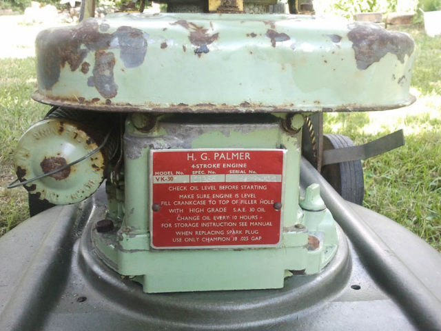

What I was hoping for was a brand name, on my Ambassador the plate said "Made for Victa ltd", or something similar.
Kye, the most common plate was as per Eric.
Kirby and HG Palmer are the exceptions because they were the
big accounts. In Victa's case I feel it was because Victa
wanted to disguise the engine - that it was a Victa-Lauson.
