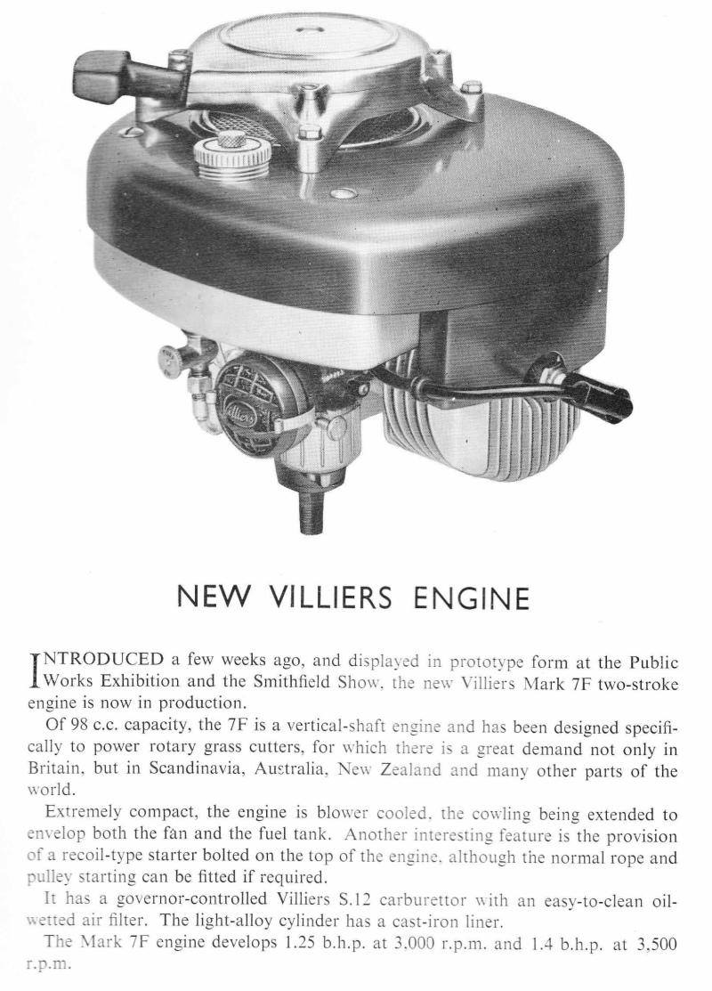

Hi Pauland Contributors, I can't believe how quick you work! Just collecting the day's mail from the letterbox is a major project for me. The new Villager decal should look awesome on the silver base. The fuel tap is a sensible approach for vintage mowers that are used. The fuel bowl style tap was always a Villier's option - the standard tap was a push-pull brass one. Here's the original UK release one from January, 1957. Villier's Australia would have them in production by late 1957. Your machine, as you know, dates from the early 1960s, when the more common engine fitted to these was the Kirby 4-stroke. Another sensational restoration (in progress). ------------------- Jack
Posts: 8,215 Likes: 235
Interesting info Jack, Villiers just releasing a 98cc motor when the Victa started as a 125cc and by 1957 they were heading into the 160cc, obviously the need for a bigger motor was there
