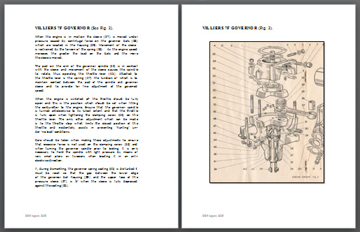

I now have a 7F auto on the Turner and a 7F manual on the Villager
The only problem I have with the Turner is that it won't idle at a reasonable speed, being an auto it has an internal governor. It idles at cutting speed, my understanding was that it would idle and increase the revs in proportion to the load. I am wondering if I have a problem with the internals governor being stuck due to sitting.
Anyone else encountered this problem ?
Likes: 310
Hello Paul
That is a nice, sensitive restoration.
The Automatic 7Fs should idle and work as you describe (I think).
They do need to be set up though. I have attached the procedure
for doing this. Maybe it will be helpful.
Jack.
VILLIERS 7F - Governor Setting
