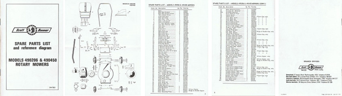

PART FIVE - PARTS MANUAL
ACKNOWLEDGEMENT: A thank you to GEOFF NOWAK for supplying this document.
MODEL 49 - PARTS MANUAL
