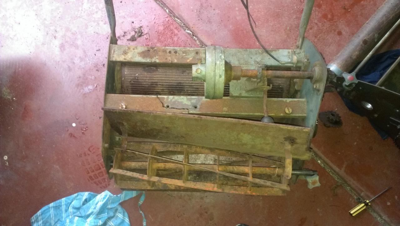

Been looking for a 20" model 45 since the last reno and was lucky enough to pick one up last winter. Condition was fairly poor and without and engine but reel and sprockets appeared to have a bit of life left in them. My son also had another 17" so we have decided to restore them side by side with a view to them both being used regularly. Have posted a couple of pics of the 20" for comment.

the front rail is substantially cracked, in fact its in two pieces!
Certainly looks that way from my eyes as well!

Will add a picture of sprockets when mower is re-assembled hopefully soon. Thanks to those who noticed the small crack in the rail. Have attached attached a pic of the fix. Would also like any ideas on a ball bearing front roller for the mowers. This is the one thing that lets down the mowers a little. Have looked at installing a conveyor roller? Would appreciate any suggestions as I think I have seen at least one on the site before. [Linked Image]

Can you please take some more close up photos of all around the repaired rail area ?

As parts are back from paint here is a better picture of the repair. A little overlap on inside edges but wont be seen from height and with engine installed.

Did you weld the cracks in the rails as well as fitting the gusset plate, or just fill them with bog?
The way the gusset itself has been attached seems to give good prospects of avoiding heat distortion of the frame. How did you restrain the frame while welding, and/or gauge the frame for straightness after the repair?

The process was to first straighten the rail as best as possible with a press done very carefully. Next the gusset was tacked into place to secure the shape. This was then followed by grinding out the crack and carefully welding them up. The gusset was then fully welded in place and some light grinding for a decent finish. Hammered paint takes care of the rest. Have to say happy with the result but haven't put an engine on it yet. The paint has been a bit of a nightmare. Its a Protec 311 hammertone mixed to a sample taken from under the handle grip of a model 38 edger. Its close but the first coat had a few runs and had to be sanded back and repainted. It also took about a week to be anywhere near hard so you could handle any parts. Wont be using it again as its too thin in the can.

Well I'd say that you'll never have any issues with those rails again as that's probably been the best remedy that I've seen done and as you said you'll never really see it unless you're a roller.
