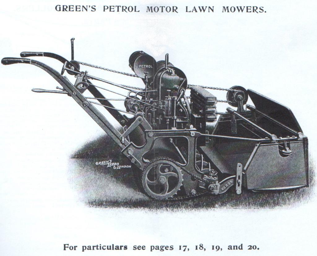

This was a Green's Patent 30in. Motor Lawn Mower.
Here are details of a similar machine from my 1910 Catalogue:-

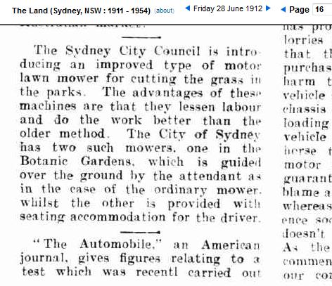

The ride-on machine was more difficult to track down and identify.
I found a couple of articles (from March and June, 1912) that referenced the use of
lawnmowers at the Sydney Botanic Gardens. The second article mentions a machine that was,
"provided with seating accommodation for the driver."

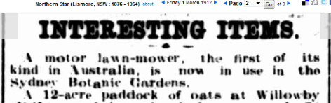

The first - the article - from the Sydney Morning Herald, described the ride-on as,
"the first motor-propelled lawn mower used in Australia is now to be seen in the Botanical Gardens."
I have written in another posting (link below) that the assertion that this was the first
powered mower in Australia cannot be true; although it could be the first of its type.

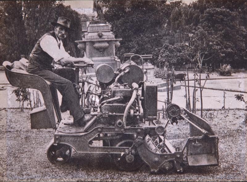

Luck has been on my side in identifying the Sydney Botanic Gardens ride-on.
A 2014 article published in Sydney's Daily Telegraph confirmed my opinion that the
machine was, indeed, a Greens mower.
The article detailed a photographic exhibition of rare photographs of the Gardens,
taken by amateur and professional photographers, that form part of that institution's
archive.
I found it amusing that one of the photos depicted cannabis plants that used to be
grown and displayed there; but the exciting find was the lawnmower photograph:-
The Article
It is well-worthwhile to have a read of that article HERE.
UPDATE 27/04/15
I contacted the Royal Sydney Botanic Gardens about this photograph.
They kindly supplied me with a larger, un-cropped image of the machine.
They also confirmed the date of the photo: 1911 (not 1900 as in the Telegraph article).
I attach a larger copy of the 1911 photograph below.
SYDNEY BOTANIC GARDENS - 1911
FIRST MOTOR MOWER IN AUSTRALIA
