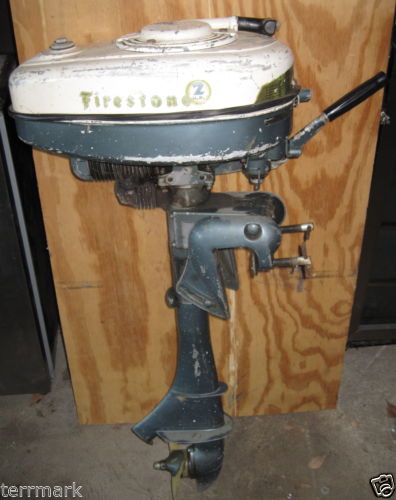

I was told this was a Kirby outboard,i have had it for years,and I can't identify it,have searched google and youtube,wondering if anyone on here can shed some light on it,thanks. [Linked Image]
Hello ton66,
I think I can supply some information.
I will also contact another member who is an outboard expert.
It won't be a Kirby outboard, but could be a Kirby engine.
But that leg does look familiar - in that it is of Australian origin.
If it is, it is very possible it will be a Kirby-made engine.
The Kirby engine was, essentially, a licensed Johnson Iron Horse 2-stroke.
I have discussed that here:-
https://www.outdoorking-forum.com.au/forum/ubbthreads.php?ubb=showflat&Number=59415#Post59415
The issue is, who made the outboard itself.
We'll just have to wait and see if a member has more information.
[the leg has quite distinctive flutes]
JACK.

A clearer image of the engine may be helpful too.
It looks like American, like an Elgin (Sears)... If it is a Kirby, id expect to see some form of Id on the engine. It also has some Villiers aspects, but unlikely.
Maybe take the Cowl off, if Jacks Outboard contact is unsuccessful in identifying it.
Good luck, I'm sure you'll get an answer here
A very Interesting machine:)

This motor has cast handle on the back of the cowl also the cowl tapers back and is rounded at the back.
Yep,
I have no doubt of the engine's origin - a Iron Horse C12B.
The three lines on the starter housing are a dead give-away.
I need to say something about the tapered cowl though.
It was typical for small outboard manufacturers to change the cowling.
One reason was practical - a larger fuel tank; the other cosmetic.
The Kirby engine was mounted transverve on the mower frame.
Here the cowling tapers - streamlines - towards the back.
So, if we can establish it is an Australian outboard, there is a good
chance the engine is a Outboard Marine Iron Horse made here under licence.
If not of Australian origin, then it will be a simple Outboard Marine engine.
So' let's wait and see.
JACK.
Id love to restore this... love the choke filter style. Seemingly has an early AMAL carby. The engine breaks down completely too. The best thing about this as it appears complete, a major plus when you don't have to chase rare parts.
Will you be restoring this, when you work out its origins?

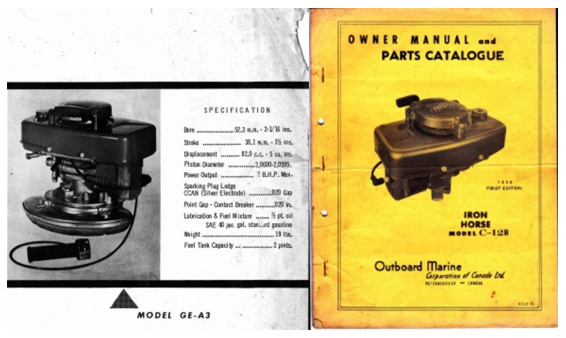

motor has external governor on top of flywheel and is a reedvalve motor,it also has a twist throttle Do you think it would probably be a 1957 GE A 3.Leg is purposely built for that particular motor with three bolt mounting and rectangular exhaust port.Do you think Kirby may have also under license outsourced the leg from Canada or had it manufactured here in Australia to tap into the outboard market like victor and Villiers.Any information would be greatly appreciated,thank you.
Hello again!
That's right: governor above the flywheel. Reed valve through crankcase.
Yes, in fact, my interest in the Kirby Hi-Torque is because it
was possibly our first governed 2 stroke to be used on an Australian lawnmower.
No one knew about the mower - No one knew about the engine.
It was original research that brought it to the light of day.
Now, I haven't heard anything from members.
I have found a close match to the outboard leg though:
To answer your specific questions: I have no evidence Kirby were involved in
outboard production. Also note that Victa were not involved in outboard manufacture
at this time. Villiers never were. However, Victa and Villiers engines were used by
manufacturers to make outboards in the late 1950s and 1960s.
That's all I have at the moment.
JACK.

To the best of my knowledge the only Australian outboard to use a 2hp Kirby High Torque mower engine was the 1958 Kingfisher.
Like so many other Australian "outboard manufacturers" of that era, Kingfisher assembled outboards using a variety of readily available components including generic legs, gearboxes and mower engines.
Kingfisher outboards were produced with Victa, Villiers, Kirby and Hurricane engines over the years.
There is also a small reference to the Kingfisher with 2hp Kirby High Torque in "The Old Outboard Book" by Peter Hunn (third edition)
Hope that helps.
AusAnzani

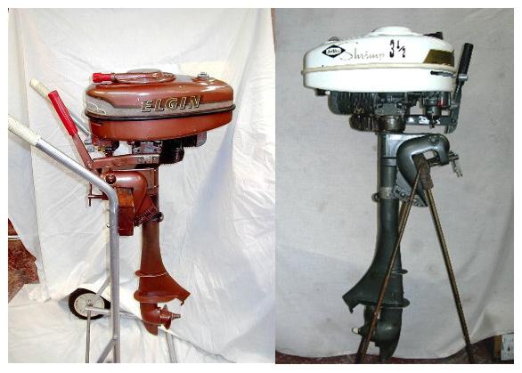

Here are another two pictures of American outboards.
Elgin on the left; West Bend on the right:-
My understanding is that West Bend made the Elgins as a store brand of Sears Roebuck.
Notice how both have similar legs to the Firestone. Was there a common supplier?
What this indicates to me is that your outboard probably had a leg of American manufacture.
The engine is known and was designed by an American company - Outboard Marine.
As AusAnzani has told us - Aussie 'manufacturers' made their machines, using available
suppliers. Everyone was jumping on board grin the emerging post-war leisure sector.
I personally feel this machine is of Australian origin however.
I say that because of the simplified cowling - as compared to overseas machines.
The best way forward is to try and find evidence of the Kingfisher with the Kirby.
