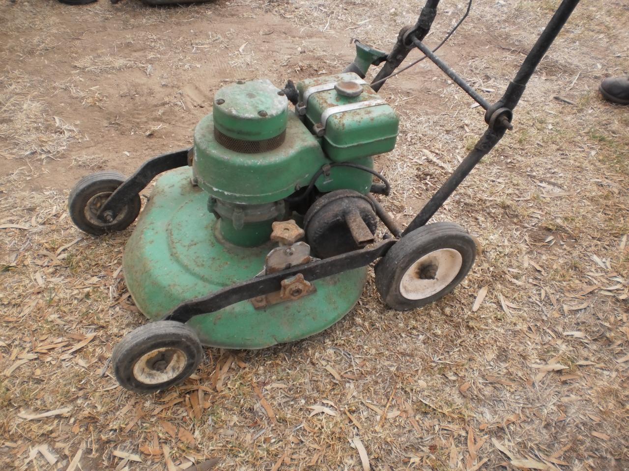

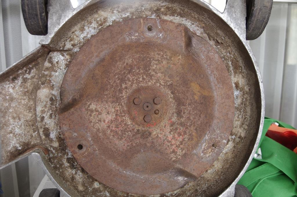

16" SPINCUT
These photos of the 16" Spincut come from member willingworker.
[The orange colour is original]

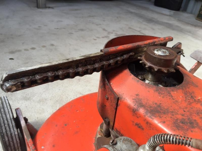

2015 Auction (eBay) photo of a Model22
[Image supplied by paul_c]
