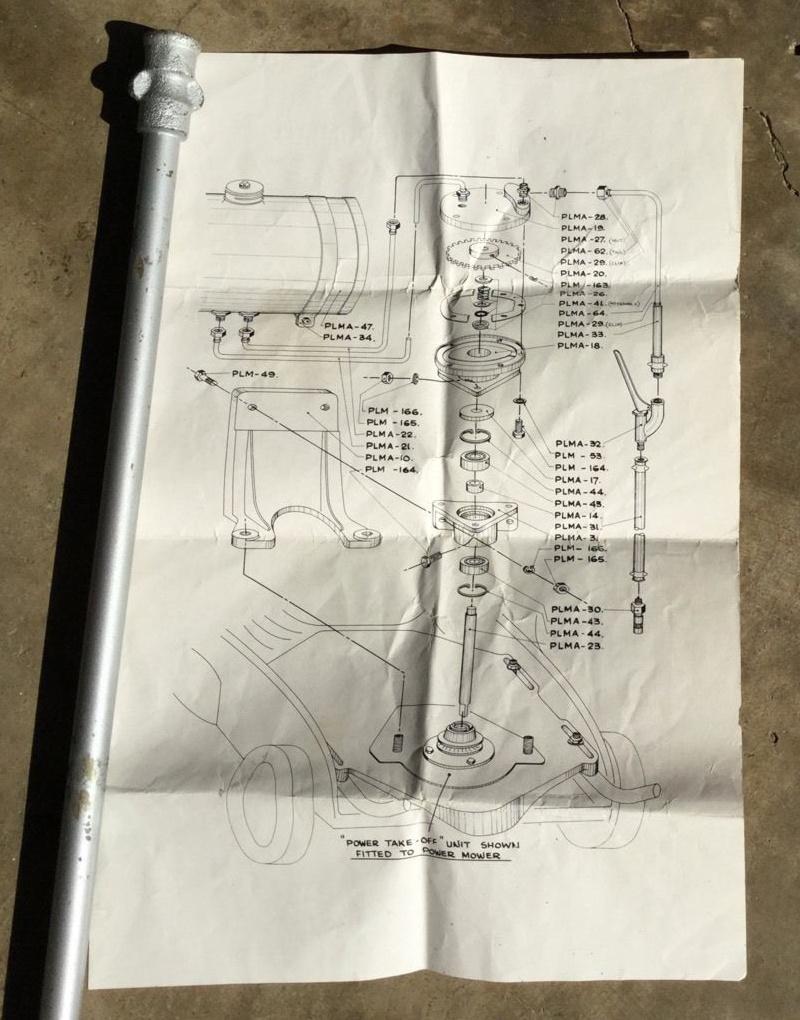

The PTO arrangement appears to have been via an engine crankshaft pulley and belt to a coupling at the rear.
The advertising suggests that both side and rear discharge mowers could accept the accessory kits.
Here is an illustration of the PTO coupling:-

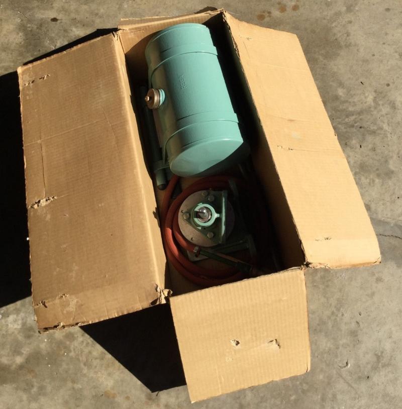

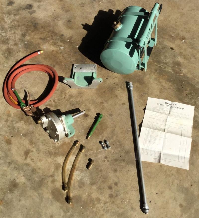

It is rare to find mowing attachments, particularly those made for rare lawnmowers.
I guess it would be very rare, then, to find a NOS (new old stock) attachment.
This is a Spray Pump Attachment for the 1960s Singer lawnmower. Brand new, still in box -
after more than half a century! It was offered on eBay in August, 2015.
ODK member IanOZ was the successful bidder and owner:-
