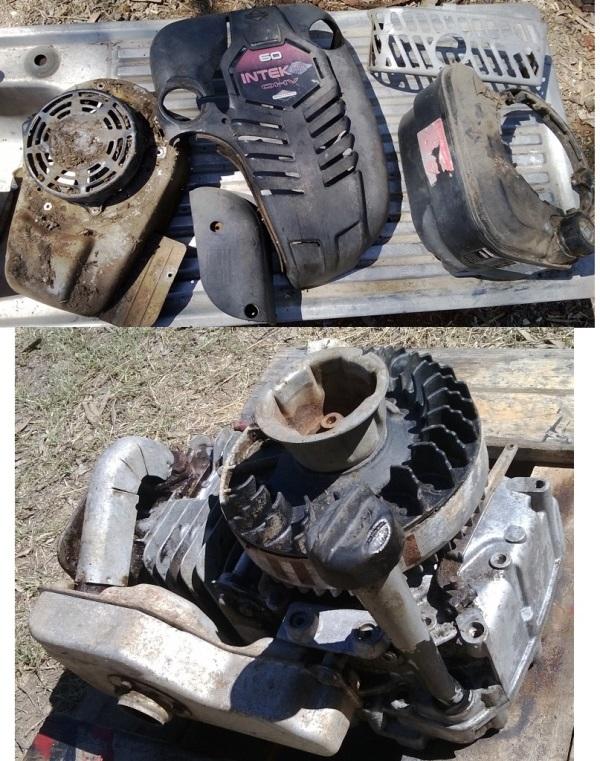

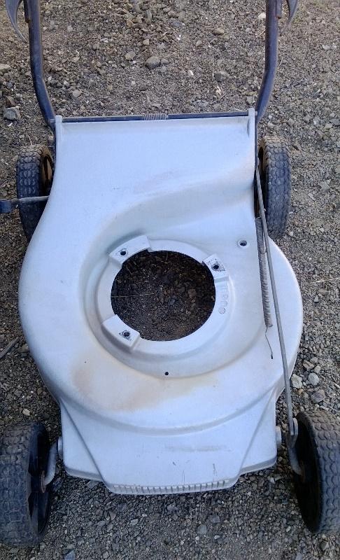

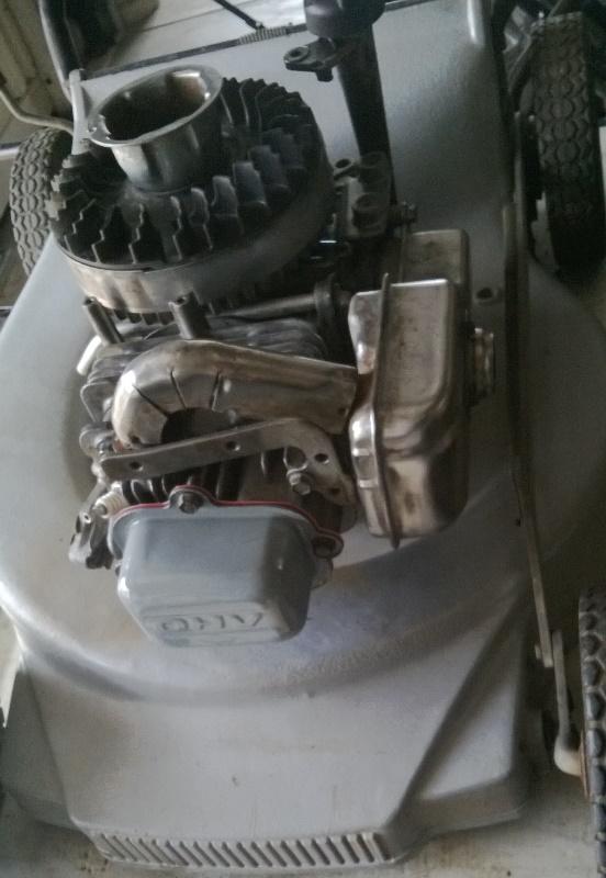

I have stripped and done some cleaning of this mower.
It came from a farm and the chickens have been roosting all over it.
Engine is turning freely.
Oil was contaminated with some water.
Air filter was still in place.
No compression, valve is not moving on intake side.
The base looks like a Husqvarna to me ??
It could be a good engine so I will strip it and see what it is like inside.

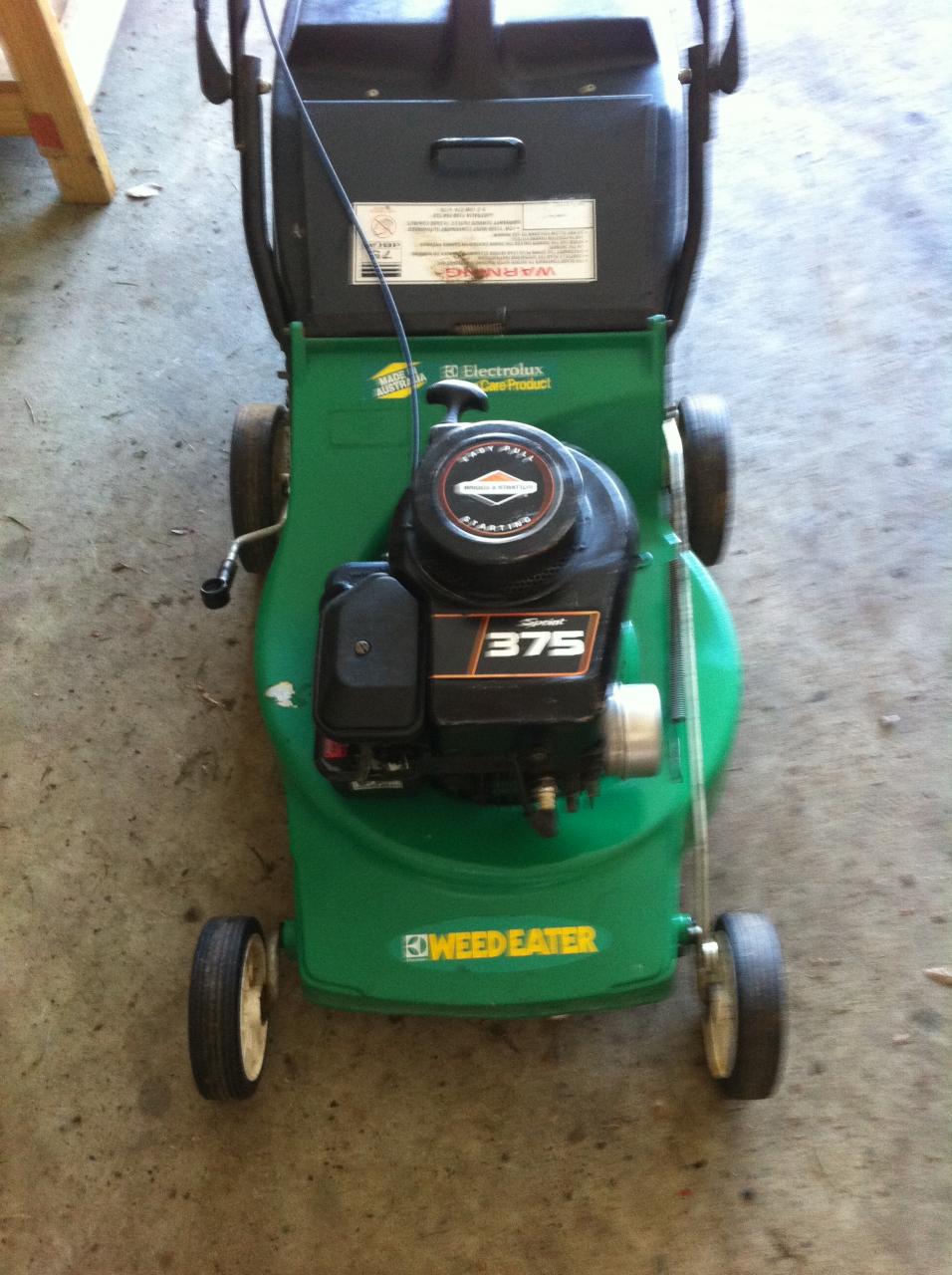

Mark, I cant be 100% sure but I am pretty sure the base is an electrolux (It came branded as Flymo (white/ silver base) and Weedeater I believe. Their might be others which I havent seen before.
As always keep your photo's and comments coming. I do like your threads.
I have included a photo of a weedeater model I recently bought back to life to explain what type of base I think yours is.. I love the older briggs engines.
Happy to be corrected if Im wrong.

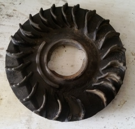

Have done a bit more cleaning before pulling it apart.

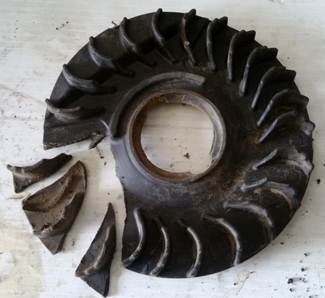

This one has a plastic fan on the flywheel that has been broken into many pieces.
Rocker cover & plate behind it were leaking, so this has contributed to all the cooling fins being totally blocked.

Just to elaborate on Jaffa's comment re: the base, Yes, flymo, husky, electolux weedeater and possibly one other that doesn't come to mind right now shared this base. Your one is the later one, note the ribs on the front and is a 19' cut and not the usual 18" version like Jaffa's.
That's my 2 cents, keep the updates on the intek coming.

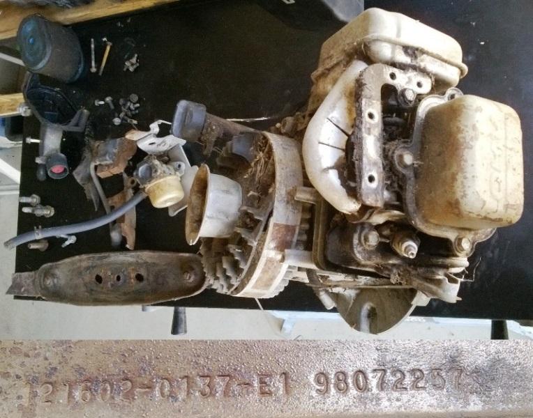

A bit more info on this mower.
Yes bigted, I measured the base, it is indeed 19".
The output shaft is 1"

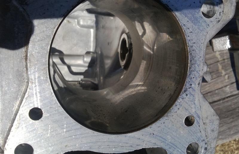

It has a cast iron sleeve in the bore. (checked with a magnet)
The bore is discoloured/stained but looks and feels good.
Also noticed on the cowl sticker "Diamond edge" which doesn't mean a lot to me.
All is looking OK, next I will rinse the engine out with fuel.
Lap the valves.
Cut some gaskets.
Reassemble the head.
Give the carburettor some attention.

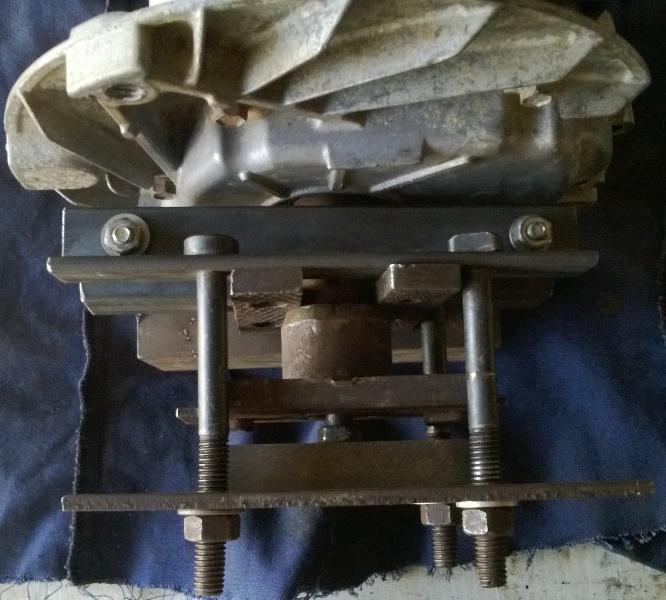

Normally don't have a problem, but the blade plate boss just wont move.
I'll keep at it.
Thanks
At this stage you'll have removed more blade plate bosses than I have Mark, so you obviously know how it has to be done.
If you don't get the decompressor working, your starter won't last long, and it will probably kick back - possibly to a dangerous extent. AFAIK all of the OHV engines have 8:1 compression and at least 20 degrees of ignition advance. On a 190 cc engine, that is not to be taken lightly.
Joined: Feb 2011
Posts: 510
Funnily enough the starter rope is broken.
My approach to finally remove the boss was to soak it, leave it under tension and when ever I walk past it give it a tap with a hammer and retention the bolts and leave it again.
Once it started to move, I went back to my 2 legged puller, it still fought me all the way, really have to be patient.
Don't want to strip the centre bolt, so wind him all the way home.

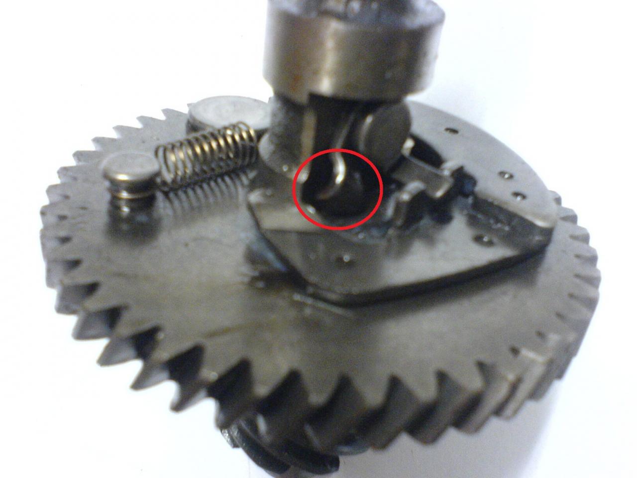

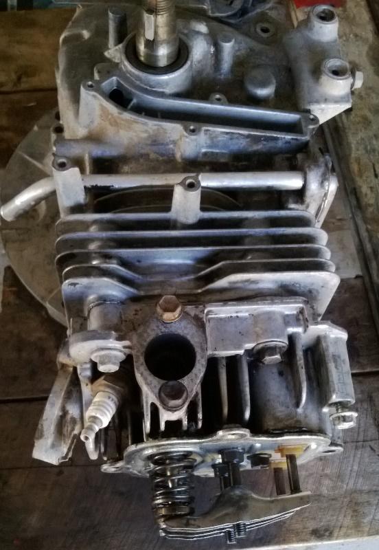

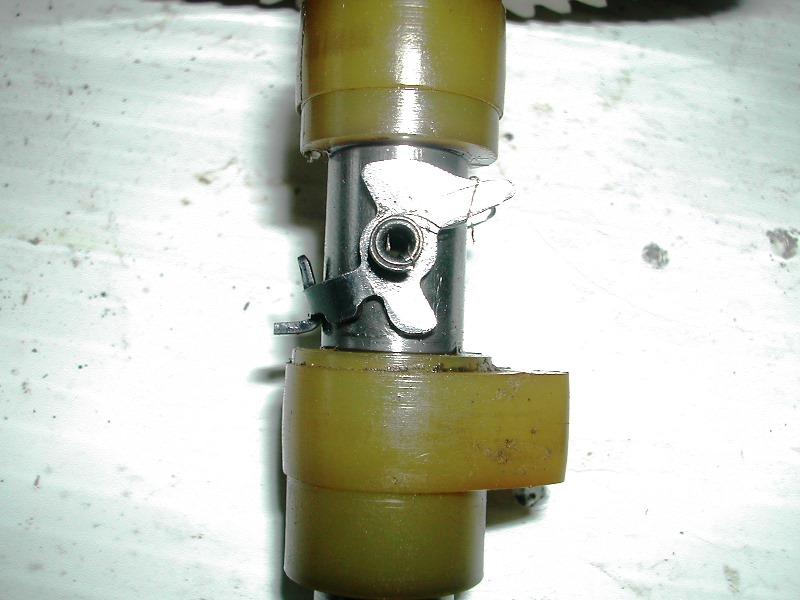

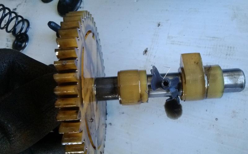

So I take it that this is the decompressor mechanism below.
I imagine it is meant to be held against the lobe in some way and interact with it as it rotates. I will play wit it and try to work it out.

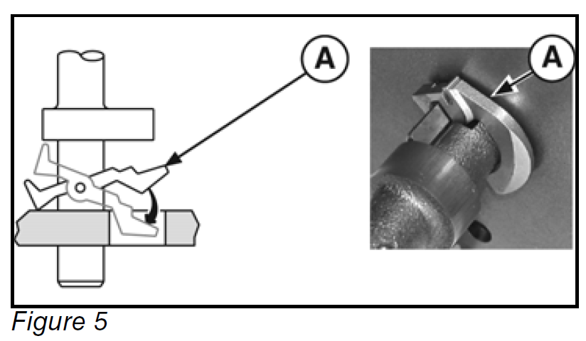

Here is the picture from the manual:
Yours seems to have a broken return spring, but I can't understand the detail of it. Can you give us some more pictures of it please? In essence, yours is actually quite different from the only one shown in the manual, so we need to get to the bottom of how it works.

Yes, return spring was broken.
I have removed and reshaped it to work again.
My understanding of how it works, so far........ is
Would appreciate other opinions.
During starting it is in the rest position as above, notice the tang is proud of the exhaust lobe (rear).
This tang pushes on the exhaust lifter to bump the exhaust valve during starting.
As below
Once the engine is running does centrifugal force act against the spring to lift it above the lifter??? I was going to put the cam shaft inside a drill chuck and run it to see if that happens. It makes sense to me, as then engine would have full compression at speed.
Delete this post if I am way off the mark here.

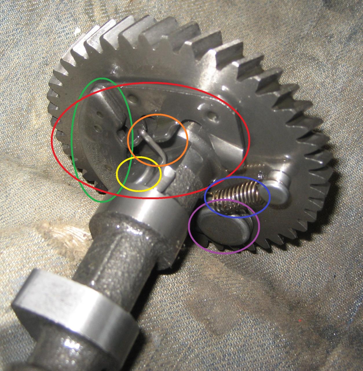

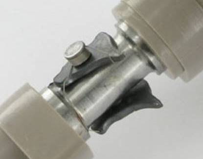

As another example see below camshaft for a Quantum engine. (the tang is broken or worn on this one)
It is far cruder than I expected, Mark, and may be a lot less reliable than the Honda one, shown here:

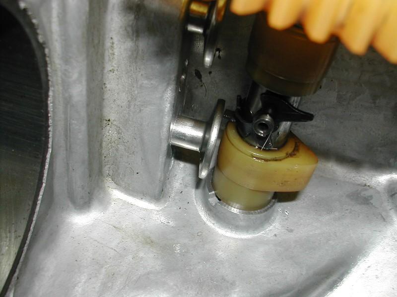

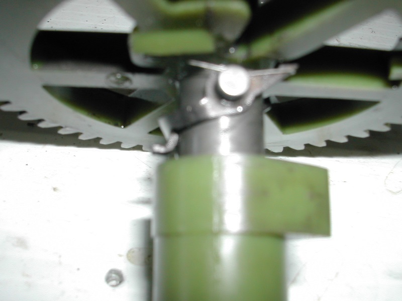

I'll attempt to explain how it works using this mark-up of the above picture:
If you look at the green oval you'll see a spot-welded weight on a long lever arm that reaches nearly the whole way around the timing gear. The lever's pivot is on the right, in the purple oval. Its return spring is in the blue oval. So, above about 600 rpm that lever arm lifts away from the center of the camshaft.
Now look at the orange and yellow ovals. A pressed steel auxiliary cam, pivoted in the yellow oval, is operated by a clevis arrangement in the orange oval, so that when the lever arm is in the rest position (engine not running), the auxiliary cam is in its clockwise position, and a rather neat cam (at the right-hand edge of the yellow oval) is in position to bump the tappet halfway through the compression stroke.
Here is another view of the same decompressor, this time in the "running" position. Note the position of the auxiliary cam, in the red oval:
This particular camshaft is from a GXV120, but they are much the same on the other small Hondas.

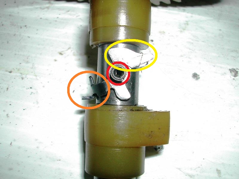

Let's look at your Intek 60 mechanism, marked up with colourful ovals:
The pivot of the decompressor auxiliary cam is in the red oval. Imagine the camshaft spinning rapidly: the side of the aux cam in the orange oval is some distance radially from the center of the camshaft, and the aux cam's pivot, so centrifugal force will tend to push it outward. The other side of the aux cam, in the yellow oval, has almost no radial distance from the pivot and camshaft centerline, so it generates very little centrifugal force. However as soon as the orange oval part pulls outward, the yellow oval part begins to be spaced out from the center and generates its own centrifugal force, aiding the orange oval part. Hence the decompressor holds in until the speed rises somewhat, but as soon as it starts to move, it suddenly snaps fully outward.
I dislike this mechanism for several reasons, one being that it uses the sharp edge of a very thin steel stamping as a cam (it will obviously wear away rather quickly, as even the rather better one on the larger Inteks and Vanguards does, necessitating camshaft replacement), it has an exceptionally tin-pot pivot, and its hairpin-type spring is blatantly a piece of rubbish.
My view of the whole setup can be summarised in this way: I've had a couple of Honda GXV120s that had been tortured abominably over many years until they were worn to uselessness, but their decompressors still worked perfectly and showed no signs of wear.

Thanks very much for that Grumpy
I put the Quantum cam shaft in my battery drill and the decompressor throws out at quite a low drill speed.
I am satisfied now with how this set up works and it will help me fault find in the future.
I now also under stand why larger ride on inteks don't start when this mechanism fails.
My spring repair has failed as it will not throw out at all, at full drill speed.
Loosing internet connection now for the day.
I think that kind of spring will have a very different "rate" (force versus movement characteristic) when it is shortened, Mark. That is probably why it will not throw out now that you have reshaped it, after it had broken.
Some of the older large Inteks lose their decompressors due to wear on the working edge of the stamped steel cam. They first become very sensitive to tappet clearance, then as wear continues, they will not decompress even when the tappet is correctly adjusted. At that point the camshaft has to be replaced.

I found an image of how the spring is meant to be held in place.
I have replaced this spring with the one I have off the Quantum camshaft.

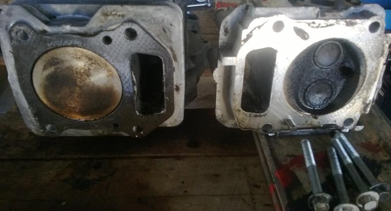

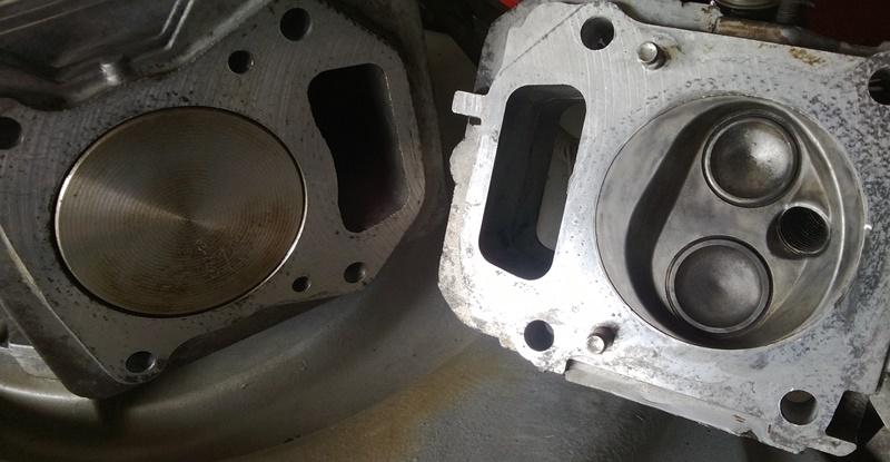

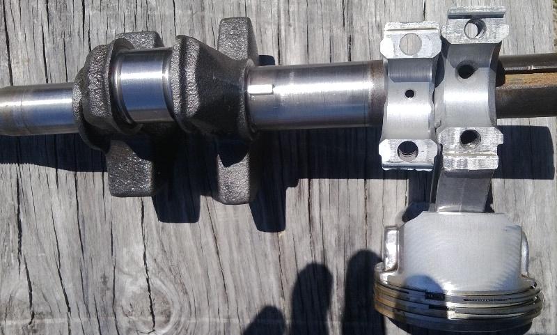

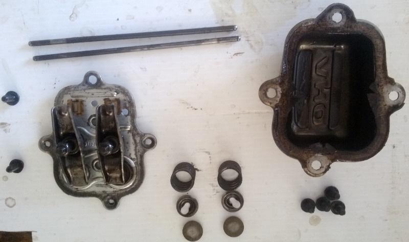

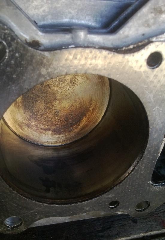

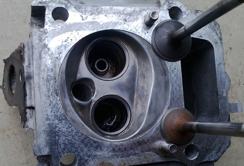

Few pic's showing the condition of the engine.
Hi Mark,
The engine has cleaned up extremely well and looks to be in great condition. wink
I hope that the replacement spring will work successfully for you....Have you given it the test will the drill yet?

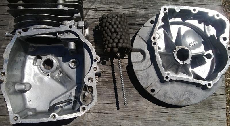

Yes, wear is minimal on the piston, bearings and crank pin.
The bore looked OK to me so I didn't hone it in the end.
All carbon removed and lapped the valves which were not that bad.
Will do some assembly today and check in again tomorrow.

Have repaired the plastic fan.

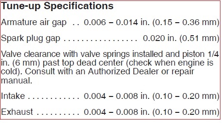

Here are some specifications from the manual

I don't know how reliable that fan repair will be, but time will tell. It will be interesting to hear how the engine performs.

Thanks, I have rechecked all the clearances and after adjusting the armature air gap down to 0.008" it runs a lot better.
This clearance is a lot smaller than my usual visitors card.
So, bit of a lesson leant there to actually look in the manual for the correct clearance and check it with feeler gauge.

I will revisit the valves, yes, I think maybe valve is sticking in the guide.

After pulling it down, the intake valve stem still had residue on it, so cleaned it off with an oily scourer pad.
I am confident the valve seats are good.
Reassembled them with assembly grease on the valve stems.
I'll start it up today and fingers crossed it will be ok.

You can actually see the decompressor through the oil entry hole, so you could inspect for a broken spring through this hole without removing the bottom plate.
Also, a theory, does the decompressor have a secondary role of throwing oil into this hole, once it flattens out at speed?
Still a bit unsure of how all of the components under the rockers get oiled.
I cant see inside the engine when its running, but imagine the oil flicker with the addition of the pressure changes inside, creates an oil mist and this area under the rockers is oiled by a mist of oil?
