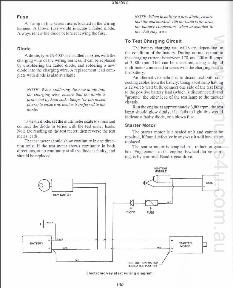

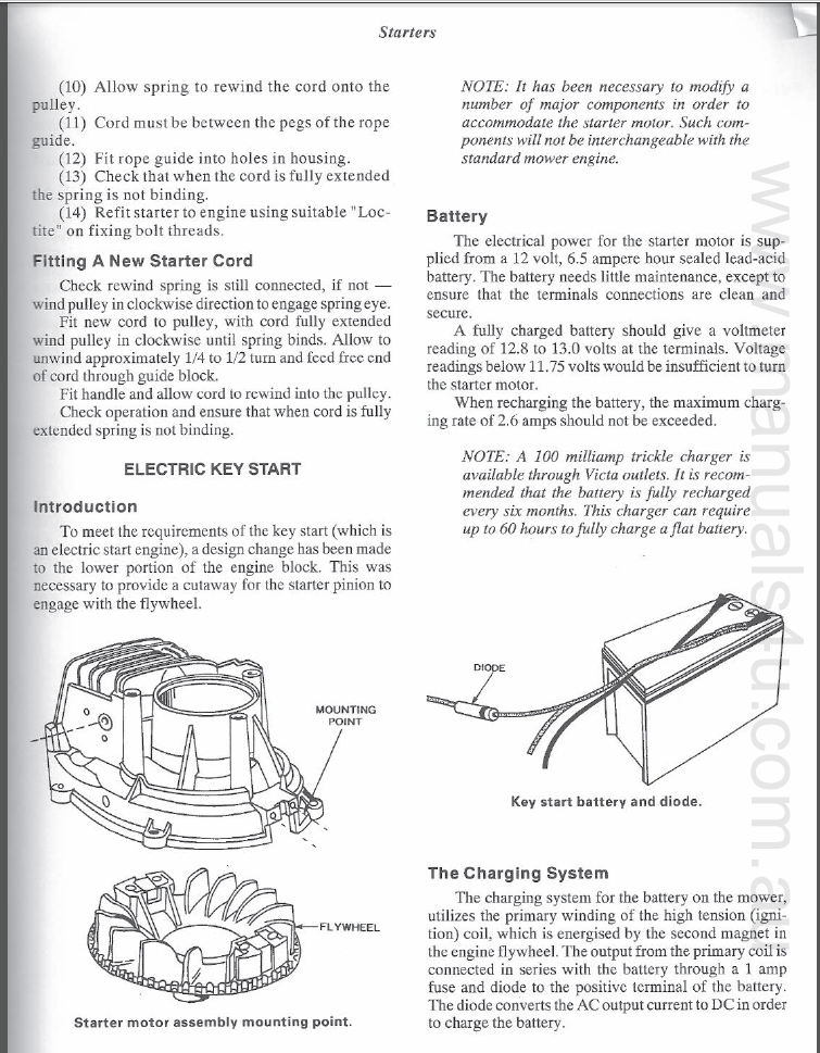

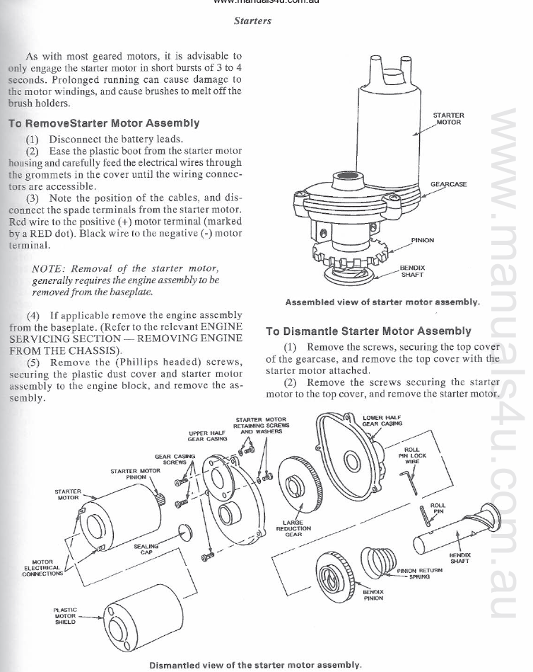

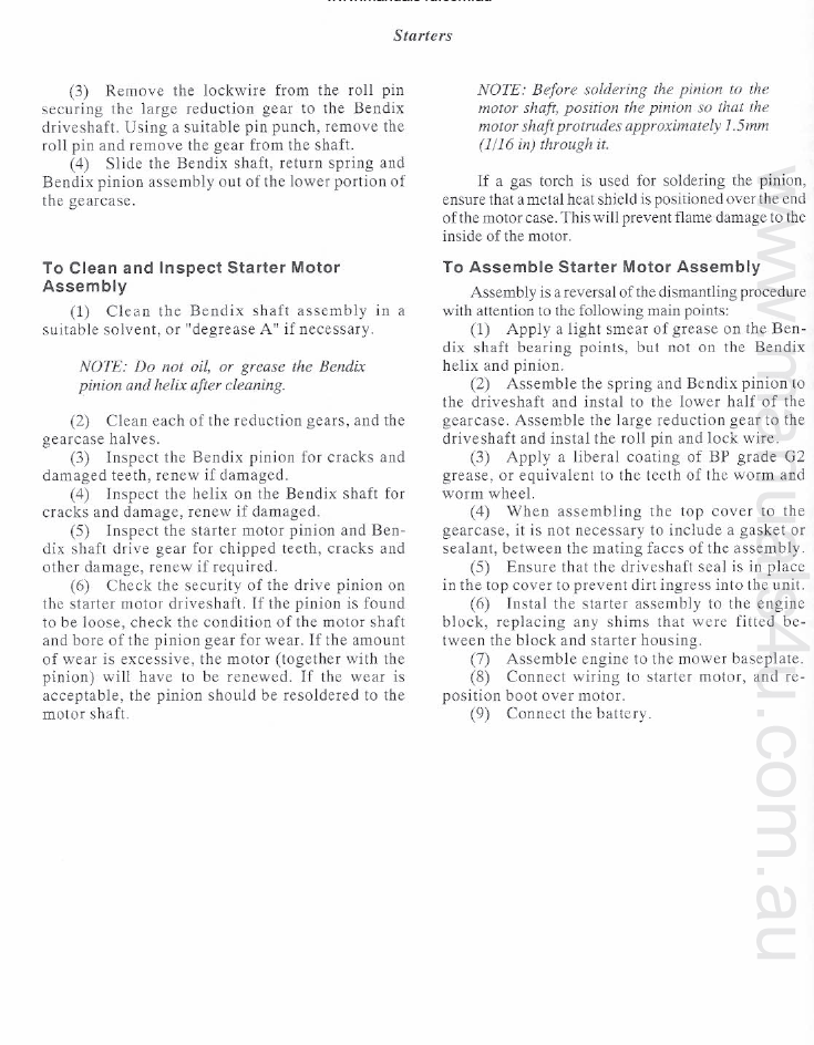

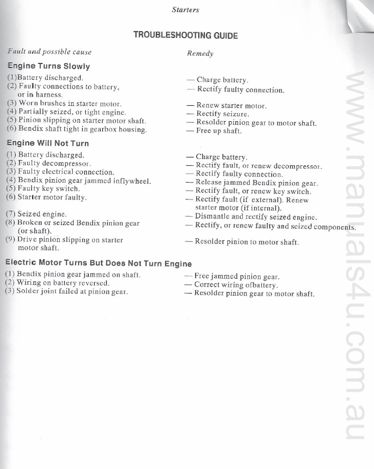

Deejay and ODK members,
I'm sure you'll find this useful, although apologies in advance for the format. It was a pdf which was password protected so i had to snip the pages and save them in order to attach them.
Enjoy

Thanks for that info Bigted, I have now learnt something else about Victa's, didn't know they charged the battery. I also often wondered about the second magnet on the flywheel of some normal Victa's.
Cool.

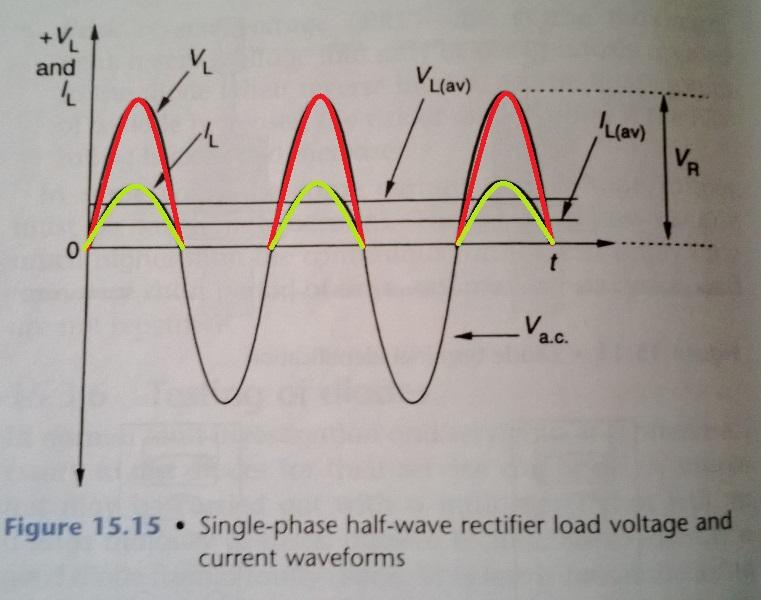

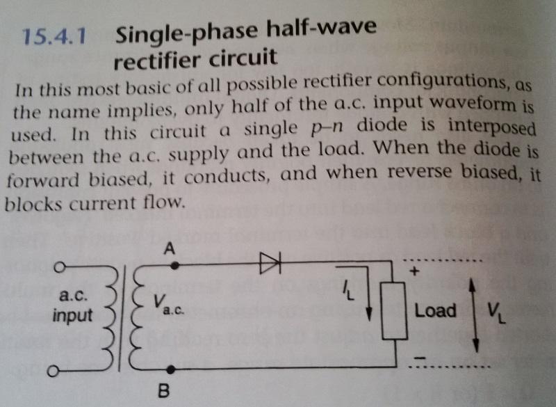

With just one diode only, I can tell you this is the simplest form of ac to dc rectification.
Hi bigted and mark electric,
Thankyou for that info, a very simple system, but obviously works very well.
This info will also help members diagnose a failed diode.
All good stuff!

well if thats the case then converting it to a full bridge rectifier should double its output.in theory anyway.would also decrease the diode load and probably stop them burning out as seems to be a problem.
however the 200 milliamps would take quite a while to charge a full size car battery. but if you weren't in a hurry it would at least boost it to cranking voltage again.eventually.
i kinda wonder why they didnt just put full bridge rectification. seems a minor expense to me?
Gizmo, yes, a bridge rectifier would nearly double the DC output - by doubling the load on the Victa ignition module. Bear in mind it was probably only designed to carry ignition current, and even the half wave rectifier might be making conditions stressful for it.
It may not matter in this application, but the bridge rectifier always has two diodes in the current path instead of one with the half wave. This reduces the output voltage by about 0.7 Volts. That is why it only "nearly" doubles the current.
