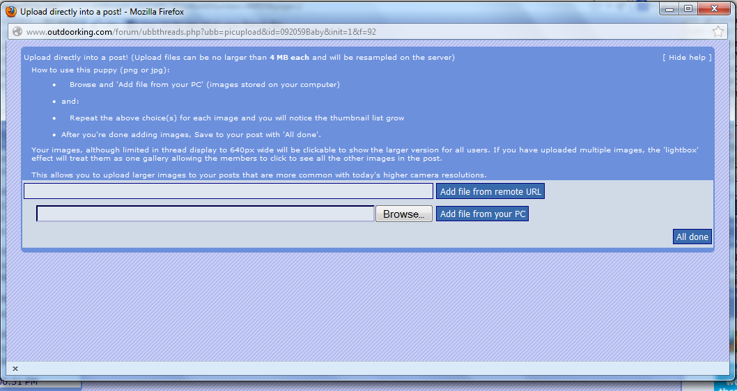

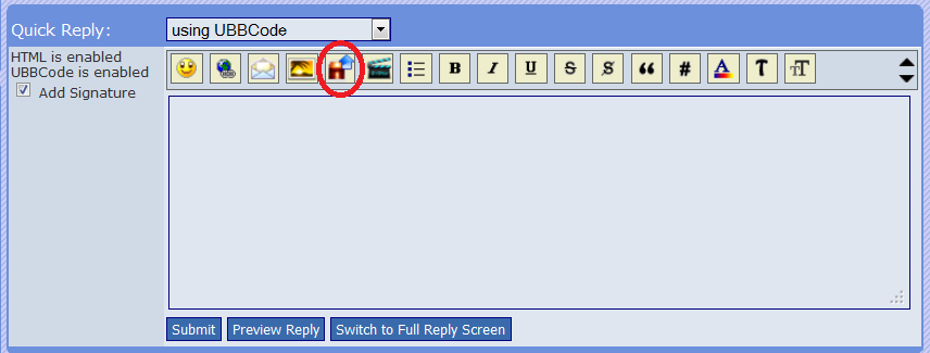

Thanks for the update Mike, we now know what is wrong and just need to fix it, but documenting the fault is very important, so we do need those pictures.
If you look at the line of icons at the top of the posting box, you should see this:
The icon you need is circled in red. If you click on it you will get this:
Click on Browse. Navigate on your computer to the first picture and click on it. Its location should appear to the left of the Browse button. Click on Add file from your PC. It should then be uploaded and a thumbnail of it will appear on the screen. Repeat the Browse and Add File steps for each additional picture, up to a maximum of ten. Then click on All Done.

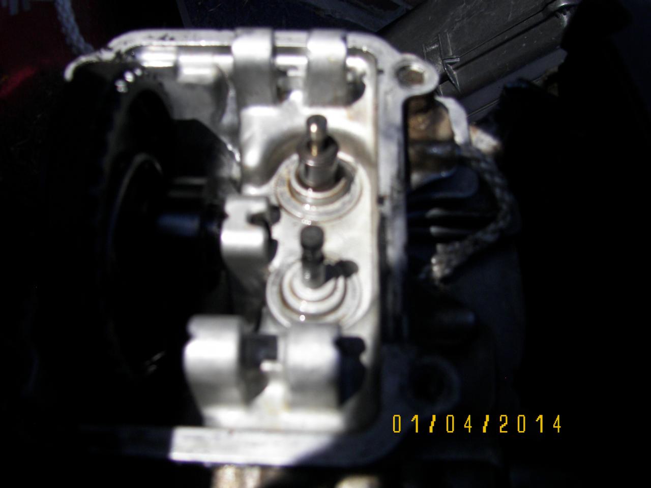

I was wondering if you got the picture? I'd like to see if someone posted a picture of the Valve area of a GCV160 with springs removed. This way I could tell if it did have a oil seal.
Thanks
Mike
No, your picture did not post successfully, and the HTML text which the picture uploader adds to your post, is not there. Did you see the little uploading box on your screen, after you clicked on "Add file from your PC"? After that box was on the screen for a while, you should have seen a thumbnail copy of your image on the screen. If the thumbnail did not appear, you would most likely have had a small message on the screen saying that the file was the wrong type (it has to be JPG or PNG), or that the file was too large (not more than 2.2 MB, if I recall correctly).
We haven't had a picture posted of a GCV cyinder head without the valve springs in place. However I took another look at an on-line illustrated parts list, and it shows the valve stem oil seal on the inlet valve only - see page B, below:
http://www.ereplacementparts.com/ho...ine-parts-c-37657_37658_37988_37770.html
It may be that the exhaust valve's stem runs too hot for a polymer-based stem seal to work.

I think I got it now I forgot the add from my PC. I can take some others and send them. I think what I will do is take one of the intake with the spring off so you can post both to the files for everyone.
I wanted to tell you that I found the drill bit and I called Loctite and they are sending me a sample of 640 hi temp Loctite which should give me enough to do the job. Also while I am waiting for it to get here I'm going to remove the muffler and examine the exhaust valve stem from that angle to see if I see anything. I will take a picture of it and send it along also. I will rotate the stem to check it completely. Oh the brown stuff in the pix is just the light nothing on the stem. Everything is nice and clean. Let me know about picture if got it and what you think.
Thanks
Mike
Thanks Mike, the picture posted successfully this time. More pictures would be good - I'd like to better understand the shape of the top of the valve guide, and the matching recess in the top of the cylinder/head casting. Because the valve guides are not replaceable on that engine, I can't find pictures of the guide on the internet.
Well done on getting a recommendation (and sample) from Loctite. 640 it is only rated for 175 degrees Celsius. I keep a pack of their 620 for jobs like that - it is rated for 230 degrees Celsius, and is "For permanent assembly of shafts and bearings". However the 620 has high viscosity and requires a thick film, where the 640 can be used between press fit sleeves, which is exactly what we have here. Most likely the Loctite people were concerned to make sure you end up with a film of the adhesive, despite the tight fit between the guide and the cylinder head.
That guide has really come out a long way. Looks like we'll be relying fairly heavily on the Loctite to keep it together in future. By the way, note that 640 is a slow-setting formulation, because they want you to have enough time to press the parts together carefully before it sets - please don't run the engine in the first few hours after pushing the valve guide back into position, so the adhesive will have developed some film strength.

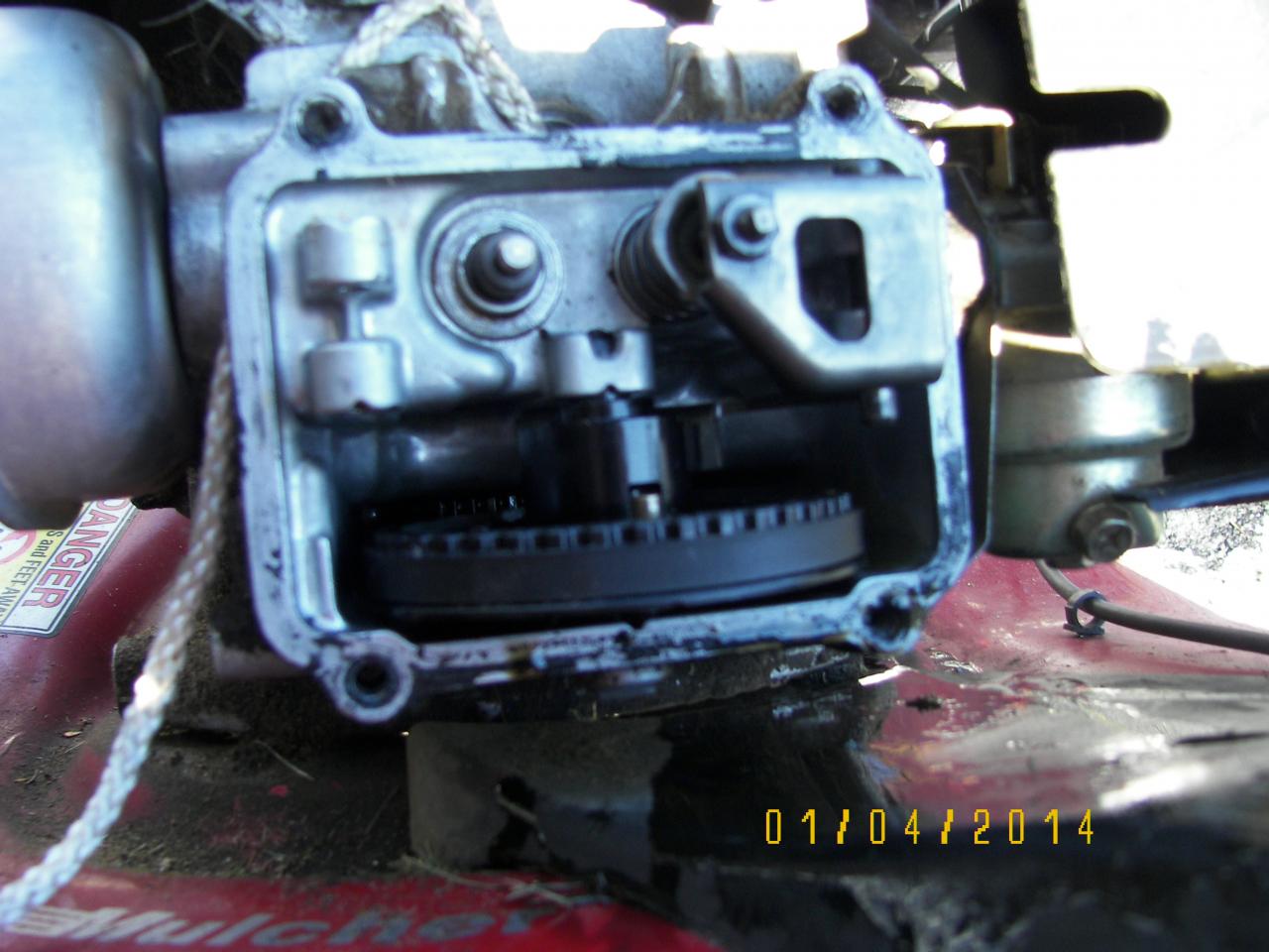

Here are some more pictures. I took the muffler off and looked inside the chamber at the value shaft and it's black and appears to be gummed up. I tried to take a picture but I can't get enough light in there to have it show anything.
I'm going to use some carburetor cleaner on the shaft by using a strip of rag soaked in the cleaner to clean shaft up and the chamber to get it clean as possible. After I get the Loctite and tap the guide back down then I will go back in the chamber and re-clean the shaft.
What are your thoughts?
Thanks
Mike
The exhaust valve will not have been opening properly lately, and because of that it will have been overheated. The valve head, and valve seat, may have become somewhat burned. However if you get the valve opening and closing correctly, this may correct itself (depending on how burned it is). Because the GCV engines are a bit of a pain to work on, and especially to lap the valves (because of the integral cylinder head), my plan has been to correct the valve movement problem then run it at light load for a period, performing compression tests occasionally. It is to be hoped that the valve is not badly burned, and after a while the compression pressure will become normal. If, however, the compression pressure gets lower rather than higher over time, it would mean that the valve is burned beyond the point of recovery without lapping or perhaps valve replacement. The engine would then have to be dismantled.
I do not think there is anything you can do to clean the valve while it is installed in the engine, which will have any measurable effect. If the valve seals immediately when you install the guide properly, the crud underneath the valve head will burn away quite quickly when the engine runs under load. If the valve takes a while to seal, so you have to run it under light load for quite a while to get it to bed in, the crud on the valve may stay there during this recovery process. It is of no importance anyway, it is just a symptom of the valve's restricted movement.
Hence I do not recommend trying to clean the underside of the valve head by putting carburetor cleaner in through the exhaust port. I do not think it will shift the crud, but much more importantly, the carb cleaner is going to get into the cylinder and interfere with lubrication.
