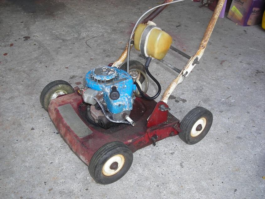

I have a Mini Master 2 stroke that I have just finished and was wondering if anyone knows the fuel/oil mix for this engine, it's a TAS 2 stroke, I assume it would be a 40:1 mix but i'm not sure. WTF
MickyD #51787 23/12/13 03:19 AM
Posts: 94
Mister Gramps
Should have added this beforehand, this is a pic of the beast originally.

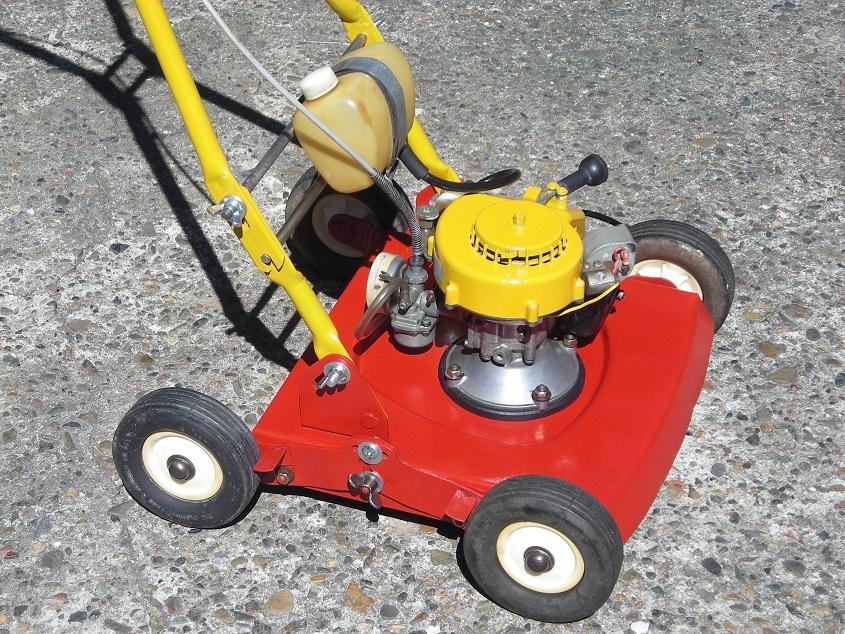

Hi Mike,
Another awesome job! I think you were born with the 'painter's touch'.

Hi Jack,
You are a legend....I did some research yesterday trying to find some info on the TAS engine, but came up empty handed...and now we now that it is a Tanaka product! good1
To Mike,
I agree with Jack, it looks fabulous mate, congrats on the restoration. I note in the original pic that seems to be a name plate on the front of the chassis, is it saveable, or are you going to fabricate another?
