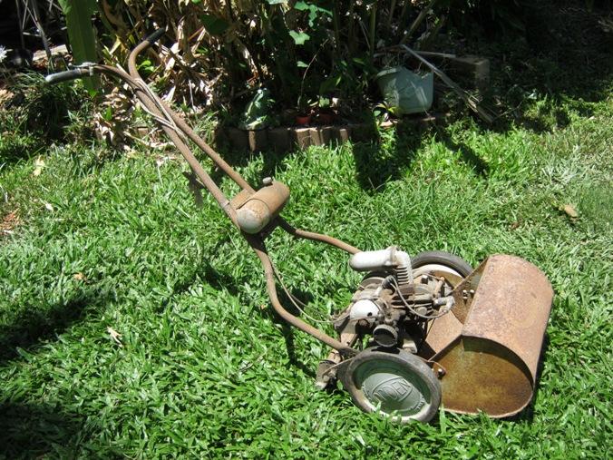

IanOZ #51838 24/12/13 08:13 AM
Likes: 8
Are you going to restore the machine?
as with everything .one day i will get to it? cheers2

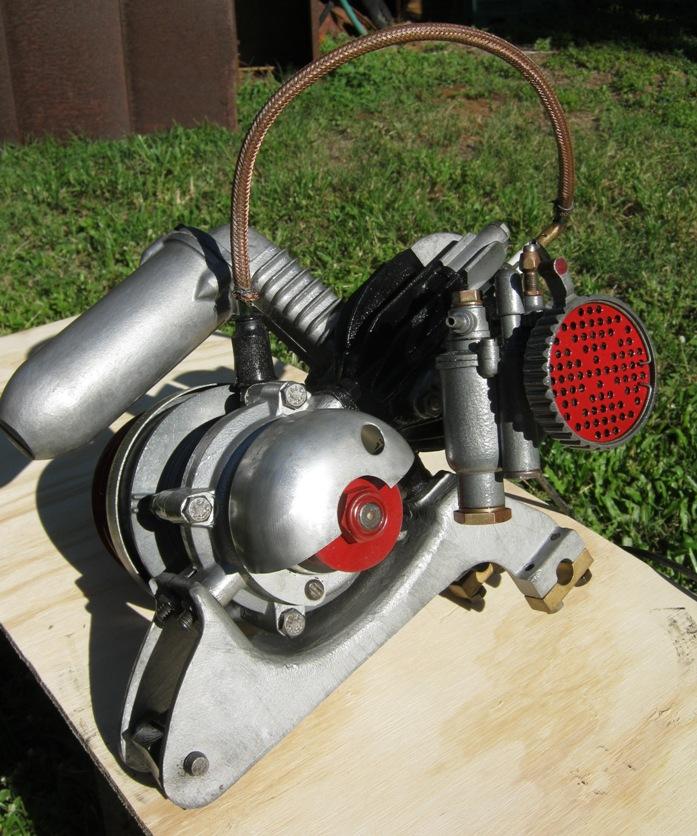

Your engine is the latter model and should have a flywheel also I think you will find your engine will only go in one direction
My has no cowl original, no flywheel original and the engine will run in both directions as there is two place to set the points CW or CCW as per picture
Ian
