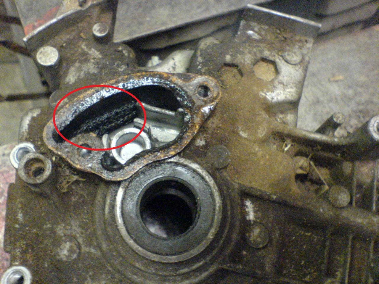

Is the oil coming from the joint between the cylinder head and the top face of the cylinder? You should be able to see that joint, with a bit of difficulty. These pictures of my spare Honda GXV120 base engine (peripheral items removed, just shows major engine parts) show the joint between head and cylinder circled in red: ![[Linked Image]](https://www.outdoorking-forum.com.au/forum/uploads/usergals/2013/09/full-2772-12722-honda_gxv120_cylinder_head1.png) ![[Linked Image]](https://www.outdoorking-forum.com.au/forum/uploads/usergals/2013/09/full-2772-12723-honda_gxv120_cylinder_head2.png) The series of yellow arrows on your picture show where that joint face is: ![[Linked Image]](https://www.outdoorking-forum.com.au/forum/uploads/usergals/2013/09/full-2772-12725-chonda_cylinder_head.png) We need to know whether that oil is coming out from the joint line between the head and cylinder, past the gasket. You can see the gasket edge-on in the third picture.

I'll offer all the likely causes of the problem in one go, rather than one at a time. You've covered the rocker cover gasket already. My previous post covered the cylinder head gasket. The simplest item it could be - it could probably be fixed in less than one minute - is that the oil filler tube could be out of position - it is shown in the red oval below: ![[Linked Image]](https://www.outdoorking-forum.com.au/forum/uploads/usergals/2013/09/full-2772-12730-honda_gxv120_underside5.png) Because the mower base has a recess running around it, leakage from this tube would result in a pool of oil where you have shown it in your picture: that is the lowest point in the recess. If it isn't that, the next item to worry about is the crankcase cover gasket, shown in the red oval in these pictures: ![[Linked Image]](https://www.outdoorking-forum.com.au/forum/uploads/usergals/2013/09/full-2772-12727-honda_gxv120_underside1.png) ![[Linked Image]](https://www.outdoorking-forum.com.au/forum/uploads/usergals/2013/09/full-2772-12729-honda_gxv120_underside4.png) The last item to worry about (other than a cracked casting, which seems unlikely) is the bottom crankshaft oil seal, underneath the mower, circled here in red: ![[Linked Image]](https://www.outdoorking-forum.com.au/forum/uploads/usergals/2013/09/full-2772-12731-honda_gxv120_underside2.png) Oil flooding out from that seal might (it seems barely possible) result in a few splashes being thrown outward by the blade plate and ending up on top of the mower base, as in your picture. Most of the oil would simply be splattered around the underside of the mower, rather than getting on top of it. So, my favourite possibility is that the bottom of the oil filler tube is now out of position, due to it receiving a bump somewhere along the line. If that has happened, chances are you just need to remove its attaching screw at the top of the tube, put it back where it belongs, and reinstall the attaching screw.

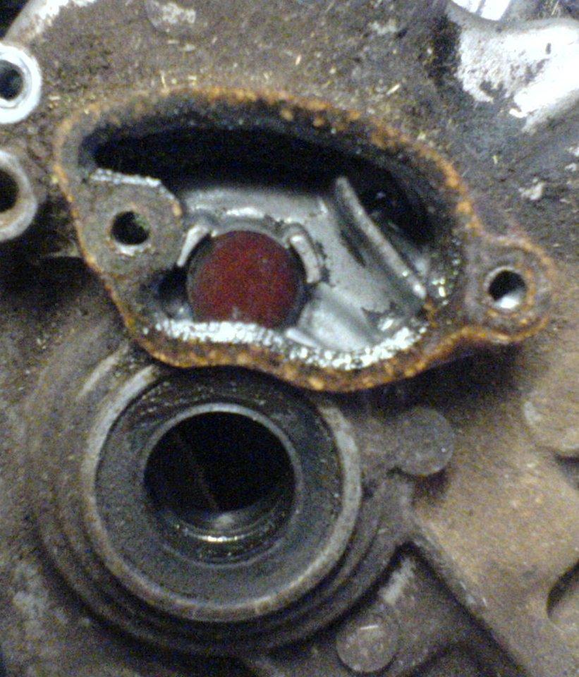

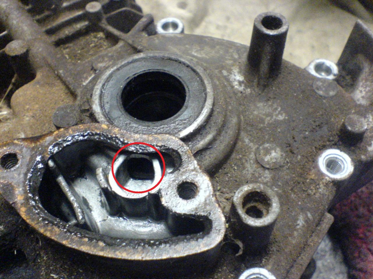

Thanks charmaine, I think I follow what you have told me - now let's look at what it means. Here are some pictures of another (scrap, temporarily removed from the garbage) GXV120 with the cylinder head removed. I have put a red arrow on each view in the same position as you had put your green arrow: ![[Linked Image]](https://www.outdoorking-forum.com.au/forum/uploads/usergals/2013/09/full-2772-12735-honda_gxv120_pushrod_cavity1.png) Note the green oval on the third picture. That is surrounding the pushrod cavity: one of the potential sources of oil which could leak past a faulty cylinder head gasket. Note also the yellow oval in the same picture. That is surrounding the oil return passage: perhaps the worst possible place to develop a leak, because it would release a large quantity of oil. All of this is consistent with your problem being a faulty cylinder head gasket, provided the oil is coming from the joint between the cylinder head and the cylinder/crankcase. I need you to look at that joint in the area in the red oval shown on this picture, and see if oil is coming out from it: ![[Linked Image]](https://www.outdoorking-forum.com.au/forum/uploads/usergals/2013/09/full-2772-12738-honda_gxv120_underside6.png) Then look at that joint in the area of the yellow arrow in this picture (underneath the cylinder head, adjacent to the oil return passage) and see if that is the source of the oil: If we can verify that the oil is coming out from the gasket-edge surrounded by that red oval or above that yellow arrow, we will know you have a failed head gasket, and that is the source of the oil leak. Here is why I have been harping on the subject of cylinder head gasket failure for some time now. I think I have already described your Rover engine as a made-in-China imitation Honda. Imitation Hondas are in some respects accurate copies, and in other respects, some corners may have been cut. Here are three replacement-part cylinder head gaskets for the Honda GXV160, which is the engine which inspired the design of your engine: ![[Linked Image]](https://www.outdoorking-forum.com.au/forum/uploads/usergals/2013/09/full-2772-12743-honda_gxv160_head_gasket.jpg) ![[Linked Image]](https://www.outdoorking-forum.com.au/forum/uploads/usergals/2013/09/full-2772-12744-honda_gxv160_head_gasket2.png) ![[Linked Image]](https://www.outdoorking-forum.com.au/forum/uploads/usergals/2013/09/full-2772-12745-honda_gxv160_head_gasket3.png) All three of these gaskets have provision to keep them from leaking gas from the combustion chamber. This is the raised-up ring surrounding the cylinder (the large round hole in the center). However only two of them have sealing material around the oil passages - the third one does not. Because of the raised-up ring around the cylinder, if there is no sealing material around the oil passages, there is a risk of it leaking oil - the cylinder block and cylinder head may not be touching the gasket anywhere except right around the outside of the cylinder.

If you can verify that the oil is coming out from between those 2 surfaces - between the cylinder block and the cylinder head - then we can talk about what it takes to fix a leaky head gasket, and you can make plans. We need to be clear on whether that is the problem, before we can go any further.

Let's be clear on which gaskets/seals we are talking about. You have said it is leaking from the cylinder head gasket, in the area I have the green oval around in a previous post. That is the same area I have shown with a red oval in the next picture in the same post. Is it leaking from there? It isn't just some splattered oil from somewhere else, it is coming out from the joint between the cylinder head and the cylinder/crankcase casting? If it is, you need to replace the cylinder head gasket, the part I have shown three examples of, some better than others. The part is not all that expensive - about $6 for an unbranded one, and perhaps twice that for a genuine Honda one. You would need to remove the cylinder head, and take it to a Honda dealer, to verify that a Honda gasket will fit. I do not recommend using a non-genuine one if a genuine one will fit: you have already been bitten once by that gasket leaking. Let's be clear on where your second leak is. Do you mean the crankcase cover gasket, shown circled in red here? ![[Linked Image]](https://www.outdoorking-forum.com.au/forum/uploads/usergals/2013/09/full-2772-12746-honda_gxv120_underside1.png) Or do you mean the crankshaft power take off oil seal, circled in red here? ![[Linked Image]](https://www.outdoorking-forum.com.au/forum/uploads/usergals/2013/09/full-2772-12747-honda_gxv120_underside2.png)

yes it's the first pic, the crankcase cover gasket, that is one spot of leak which I didn't notice until today. the other leak which I first started this post off with is (Second lot of pic's) the green oval on the third picture. That is surrounding the pushrod cavity (where I pointed out with green arrow)
